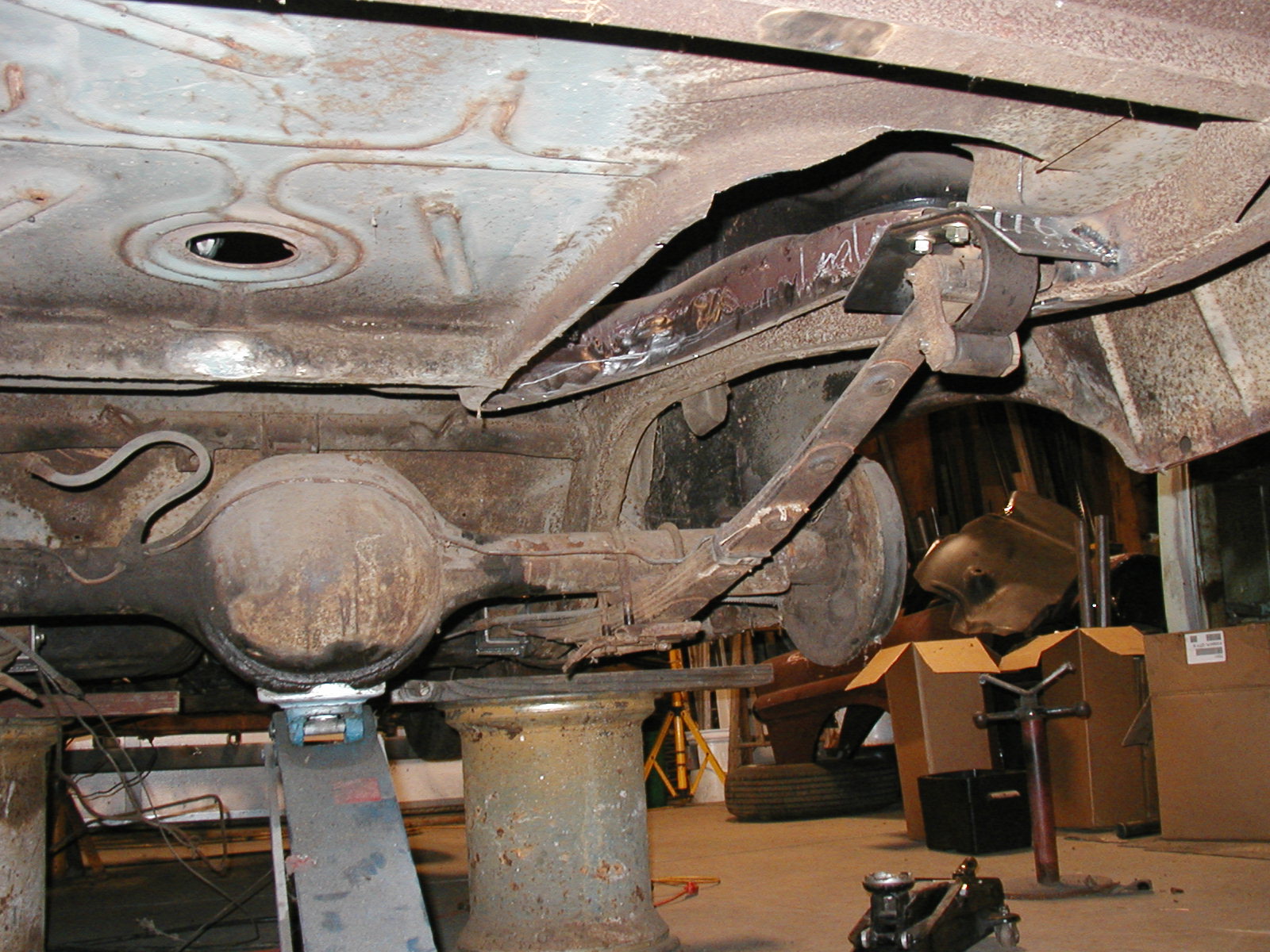

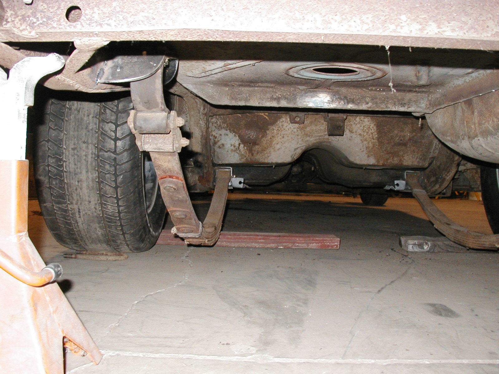

  20. I have parallel leafs-the front mounts are inboard on the frame and the rear shackels are underneath the frame rail-so to look at it from behind-the springs are not really parallel-but pointed 'inward' at the front. The front 'pockets' have adjustment in the form of 4 adjustment holes spaced about an inch an a half apart vertically to give about a 6 inch vertical ride height adjustment. No ride or handling issues at all.
  21. This method has been around for ever. A little more involved than Lowering Blocks. I've probably done it 15 times over the years. I think it was 1968 when I did my first one and an Old Timer then told me about it. On this car it involved moving the spare tire well forward. I've never done a 49-54 Chevy but would think it's very doable. Not all cars require raising the driveshaft tunnel. This one only needed it under the back seat cushion, not all the way. A little time under it with a tape measure and a lot of time eating Dirt. Other than that it's just another Job. Pay close attention to the Gas tank location. I've had issues there before also. I'm with you on the Air Bag thing.

  23. The problem is that the Top Hat style frames lack the strength of a typical box channel rail. You are puttting lots of stress on the side of the rail that is rather thin to begin with. Choprods here gave me a great tip years ago. Since the 49-54 springs are narrow and prone to breakage he uses FRONT springs out of a Dodge Ramcharger. They come in 3 and 5 leaf. They are flat and lower the car a bunch. You just need to mount wider hangers in the stock location. Remember, the stock centering pin is NOT centered but offset.

    So guys, really have been looking into options to do this easy and safely. Found this company AFCO, makes alot of race car chassis stuff. They offer leaf spring hangers for the front for $19.75 each, or could fab some up, whichever. I was thinking just flip them upside down, weld them to a nice plate and gusset it, make it strong and make it bolt to the stock bolt holes for the original front spring hanger but brings it inside of the rail and moves it up, keeps stress of the thin side of the rails and uses stock mounting location.
    So for the rear, I am playing with the idea of getting rid of shackles and going with AFCO's leaf spring sliders, lower profile and look like a real nice product. I am not sure if popular for street cars or not, still looking into that, just ike the low profile to them that will minimize cutting into my trunk to have a shacke stick up into it. They are quite pricey at $82.99 each, but whatever.
    Like I said just putting together ideas right now. Was also going to make plates and locate these inside the rear rails using sstock hanger hole on the bottom of the rail. Let me know your thoughts, headed in the right direction or just in a world of my own, I guess we will see.
