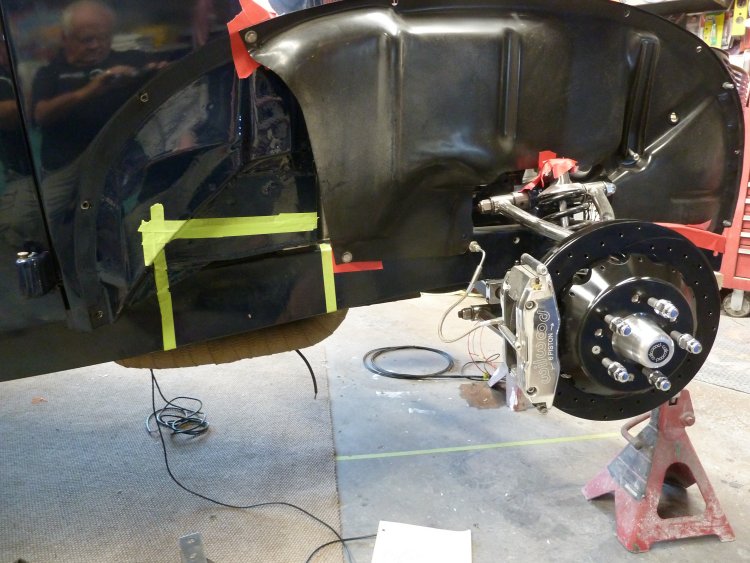

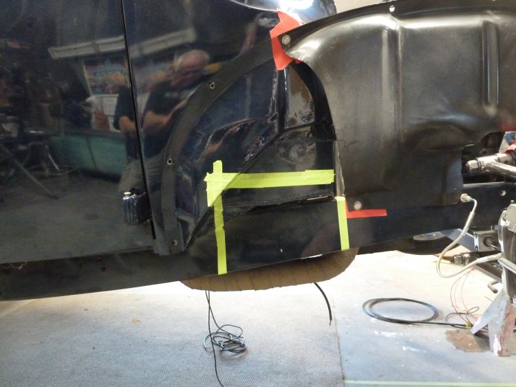

    I am having difficulty getting my questions answered from Mr 40s. The photo shows a flat plate that bolts to the frame. On my 40, if I mounted that plate to the frame then either the top of the battery would hit the lower cowl or the bottom of the battery would sit below the lower edge of the fender. There seems to be room if the battery box is moved out away from the frame so that the battery would clear the lower cowl but the battery box does not appear to be designed to mount like that.

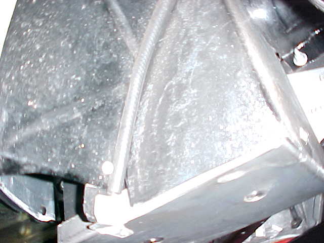

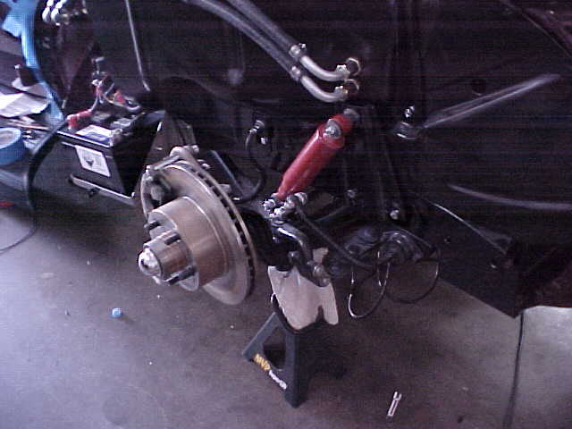

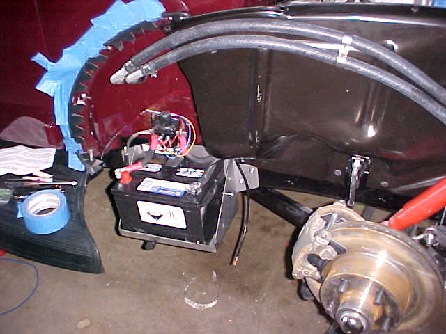

    Have installed 8-10 of these on 40's over the years. I modify the splash guard and make a panel that covers the front as well-panel drops out with one screw. They fit tight and require a battery that is a little shorter than most--have the battery number somewhere. Also made several of the same design-a little wider and deeper. Never have had an issue. A little tricky to chg battery but no big deal. Have one here now for the next 40 coming soon. My 40 has been running with one for 8 years. Some pics-this one didnt have ac-with ac it is a little busier in there. Drove a 40 with this setup around Hawaii for 2 weeks in the rain every day and the dirt too-no issues.

    [​IMG] On mine I modified the front ear to move the tray up and forward, used some of those threaded clips (retainers?) from a gauge panel to hold the Red Top lip into the tray. Then, using an hold beat up splash panel from the frame to fender mount. Nice terminal covers with liberal silicone grease. Excellent starting power, no problems, summer thunderstorms etc. Pic from battery change after 8 no touch years.

    Thanks for the pics olscrounger, they help a lot. Here is where I stand right now, I like the simplicity of the No Limit drop down box (I have one on my 56 F100) but it won't work for the 40 without extensive mods. The pics show the outline of where I can place the drop down box on my 40. I will need to space the mount out 1-1/2 inches from the frame to get the battery/box to clear the cowl. The battery is 7x7x10 so I have plenty of clearance to the fender. I live a few blocks from Direct Sheetmetal and I have Dave do much of my sheetmetal work. I mention this because he makes templates of the items I give him to fabricate so for those who may want a drop down box for their 40 they should be able to order one. Once I get a mockup built I will move on to the splash guard and fender brace. Thanks again for the inputs.
