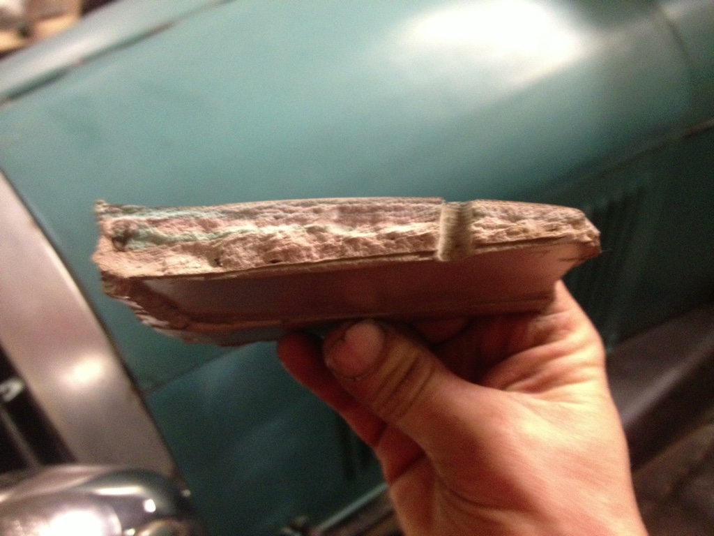

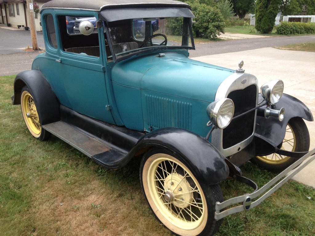

    So about five years ago I got the urge to build a full fender model A hot rod kinda like an 8vA car with some updates this is the car I started with. It was a running driving botched restoration with many things wrong with it. But the price was right. So like any good project it starts with the right parts such as a 265 small block Chevy, F-1 steering and brakes a 34 Ford wishbone un-split+ axel and a Ford bronco rear-end more to follow tomorrow [​IMG]IMG]https://www.jalopyjournal.com/mobile-gallery/acb58768dc0e28b63a07d96b35b90574.jpg[/IMG][​IMG][​IMG]

    That's what they call "Bond-oh"

    Ha! Took me a minute to figure out what you were holding. I thought is was a piece of 1/2 wood! Car must have sagged on that side.

    That was what the panel between the window and the deck lid was made of

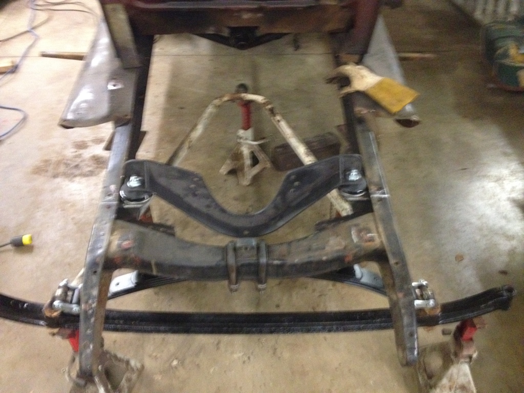

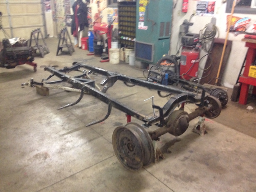

    So I am going to skip ahead because any one can take apart a model A. So here goes test fitting the motor and frame construction [​IMG][​IMG][​IMG][​IMG][​IMG][​IMG][​IMG]for the frame I wanted to use a 32 k member but that really wasn't feasible for the transmission I was going to use so I made my own version. More to come

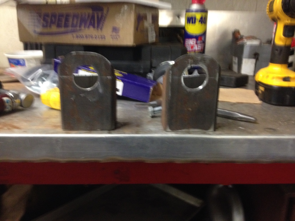

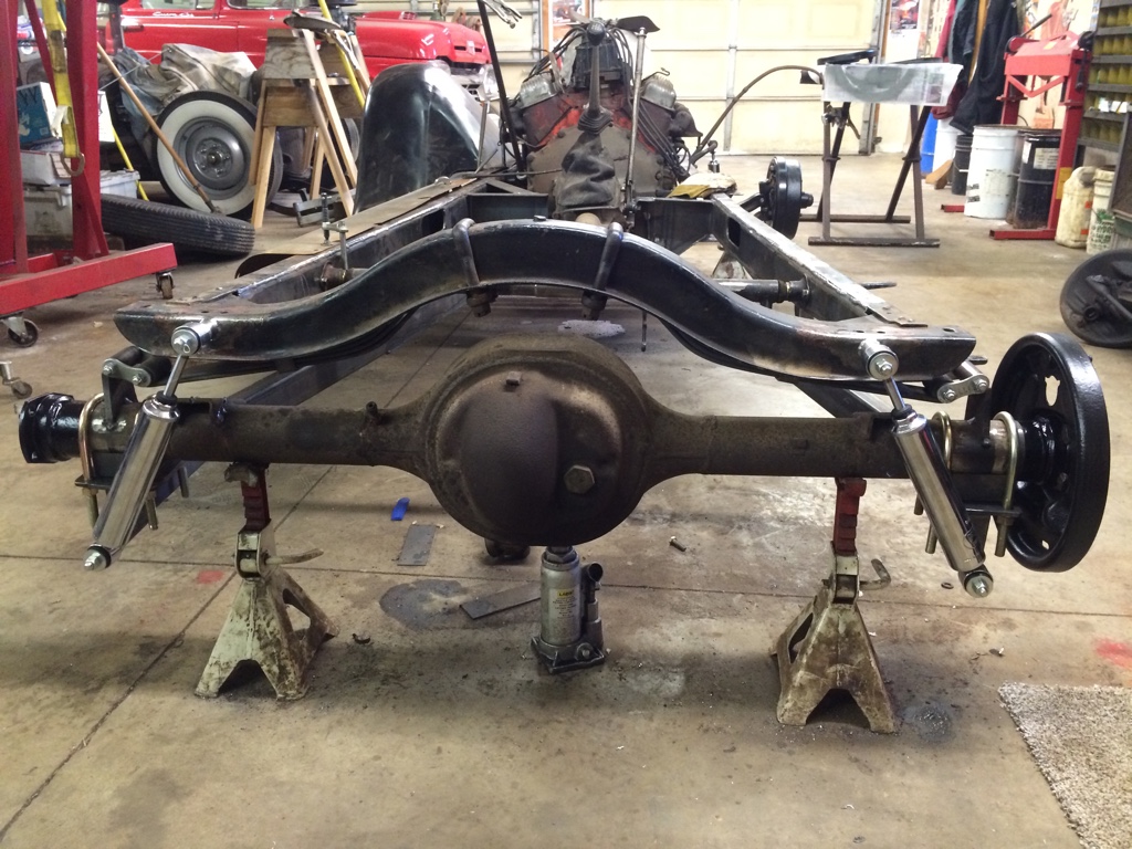

    So a few more pictures of the 32 like k member[​IMG][​IMG]And know some of the parts that make it roll[​IMG][​IMG]close up of the front shock mounts [​IMG][​IMG]and with the shock on it[​IMG]shots of the rear end set up[​IMG][​IMG][​IMG][​IMG] more later

  13. X38
    Joined: Feb 27, 2005
    Posts: 17,498
    X38
    Something to consider:
    For all the strength and bulk of the truck arm style rear suspension, it all concentrates at those two little tie rod end threads. Not to mention the little tie rod ends themselves.
    Also, along the same vein, I like your K member but have to ask whether you intend to tie it together with some material across the top? As it is, for its size and bulk, all that ties it now is the bit where the bone socket is. And it's an L section. That's where the twist concentrates.
    I'm not telling you what to do, just bringing up something to consider.;)
    I like that you've got rear engine mounts, if that's what they are?
  14. Mr cheater
    Joined: Aug 18, 2010
    Posts: 659
    Mr cheater
    Thanks for your input I will keep an eye on these things. It always good to have a second set of eyes look over your work

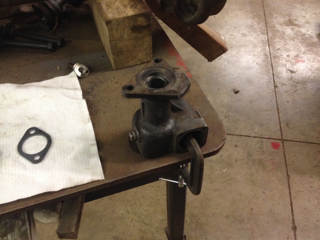

    Steering box mods[​IMG][​IMG][​IMG] bought a flange from a guy on the H.A.M.B (who's name escapes me now)

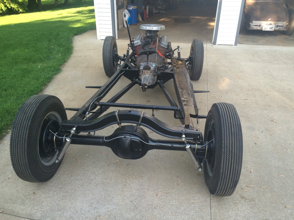

    Skipping ahead a little bit bolted some wheels on it and pushed it out for a look.[​IMG][​IMG][​IMG] In this picture we can see that my wife is very impressed with the project

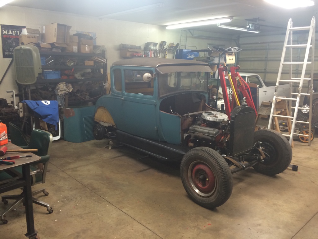

    So from there the fire wall was modified to clear the motor [​IMG][​IMG][​IMG]and the body set back on and motor in[​IMG]

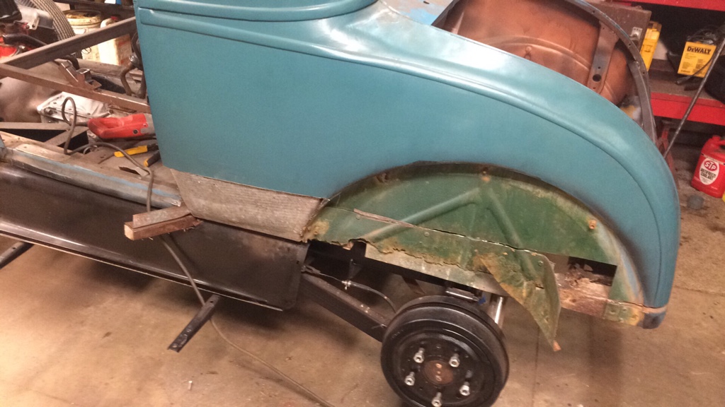

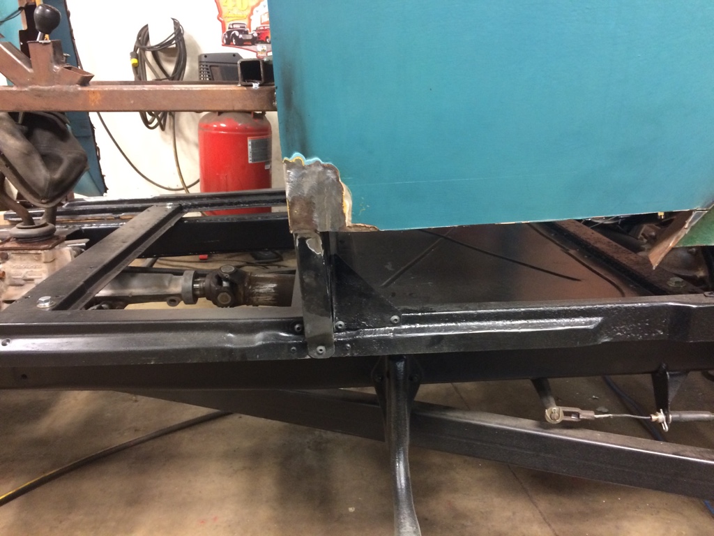

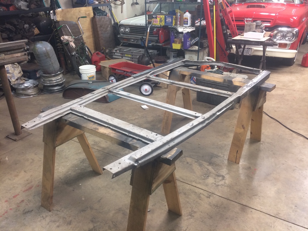

    [​IMG]Got the wheels powered coated [​IMG]messing around with a 34 truck shell. For some reason I didn't take time to take pictures of frame painting so skipping ahead I took some time to clamp it all together to see what it will look like when it's done[​IMG]also a shot of one of the grater inventions the water pump riser[​IMG]and now on to subframe repair the donor frame fresh from the blaster [​IMG]and some repair work [​IMG]and then some work on the uprights [​IMG][​IMG]some of the reason we are replacing the sub frame[​IMG]more to come

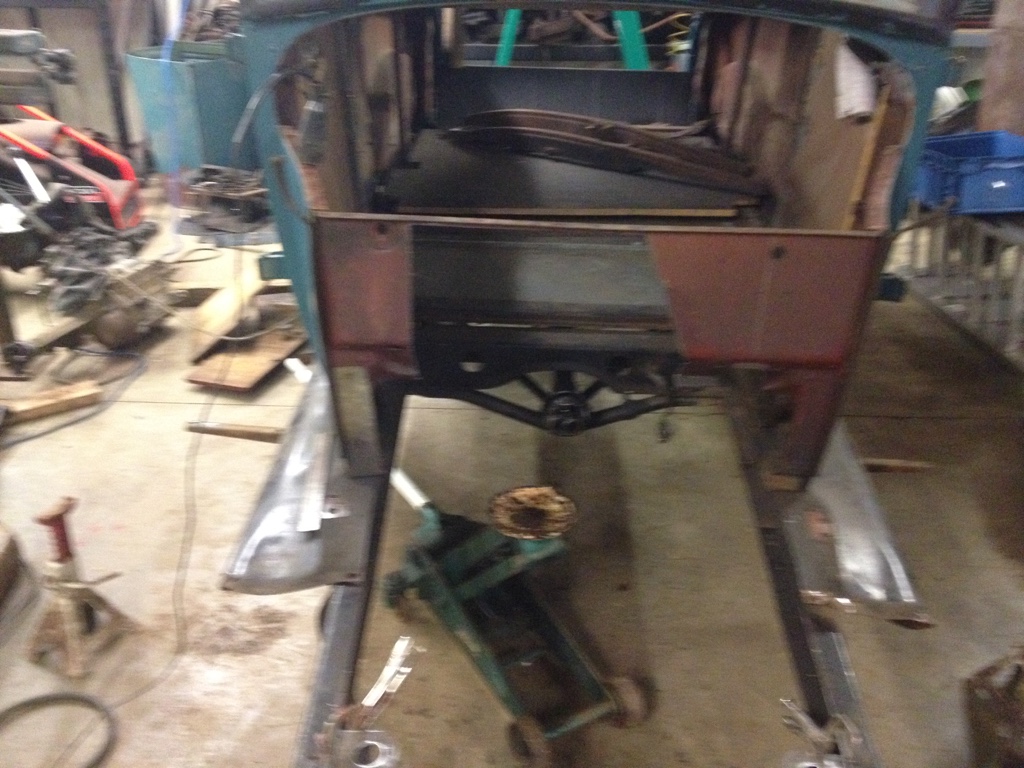

    [​IMG]cowl parts out of the mol***es bath worked out well[​IMG]got most of the parts hung on the replacement subframe [​IMG]some of the hack-a-re on the quarters[​IMG]building the rear panel below the trunk lid[​IMG]prepping for removing the old subframe for some reason once again I didn't take many pictures of the body cut free of the subframe and some pictures may be out of order. More to come later

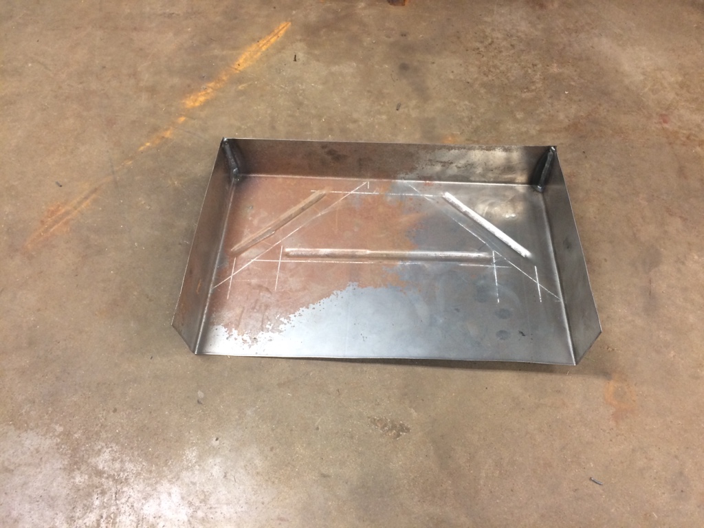

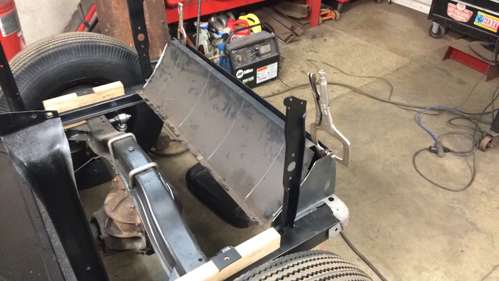

    [​IMG]making the door pillar line up[​IMG][​IMG]fixing the A pillar [​IMG][​IMG][​IMG]took a break from subframe repair to do some work making floor panels [​IMG]and the hump cover [​IMG][​IMG]taking care of the floor sheet metal chapter this is the transmission cover I made

    looking good, great progress. Be sure to put the trunk on and align the gaps before you get too far with tacking all that rear sheet metal together and I would recommend an X brace when plumb under the package tray. Those bodies tend to flex and move around more than one normally ***umes.

    That was one of the pictures I didn't take of how I braced the body and it would have helped for a lot of people who question how to swap a subframe on a model a

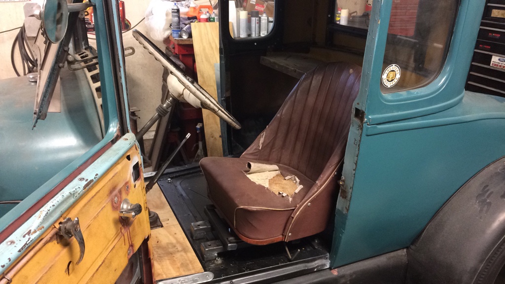

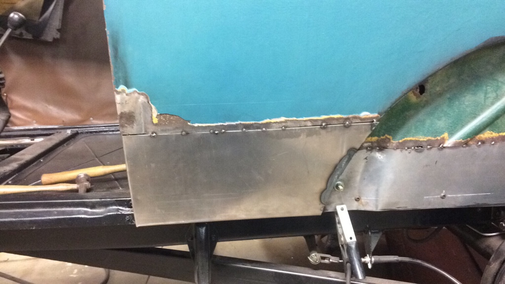

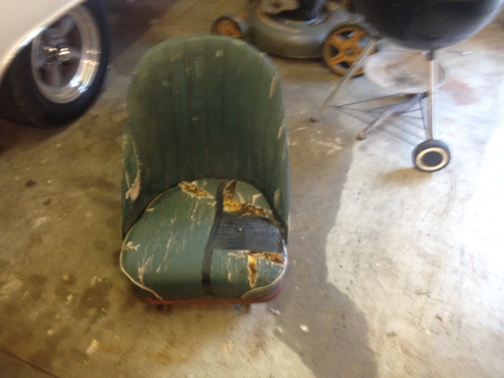

    [​IMG]got the body all put back together and the p***enger side door closes as it should however the driver side needed some work. So we had to add some metal to the b pillar remember kids take measurements before you start and write them down [​IMG][​IMG]making and installing patch panels [​IMG][​IMG]getting the fender to fit[​IMG]A tip from Sqwablow telling me how Sherwin Williams can color match paint produced a quarter panel that's pretty much the same color now[​IMG]got the fire wall painted and the clutch and brake master cylinder mounted [​IMG]picked up this sweet seat out of a Superior bodied school bus and then the hunt was on for another witch I found later [​IMG][​IMG]mounting brackets for the seats[​IMG]now we have a place to sit and make motor noise. More to come

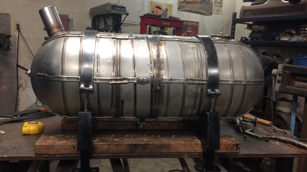

    [​IMG]used two oxygen tanks from a WWII plane to make a fuel tank[​IMG]tank welded up [​IMG] brackets made for the tank[​IMG]tank mounted in the trunk more to come

    nice tank! be sure to leak test it, I always have at least one leak when making tanks or anything that holds fluids:(
    how many gallons of gas will that hold ?
