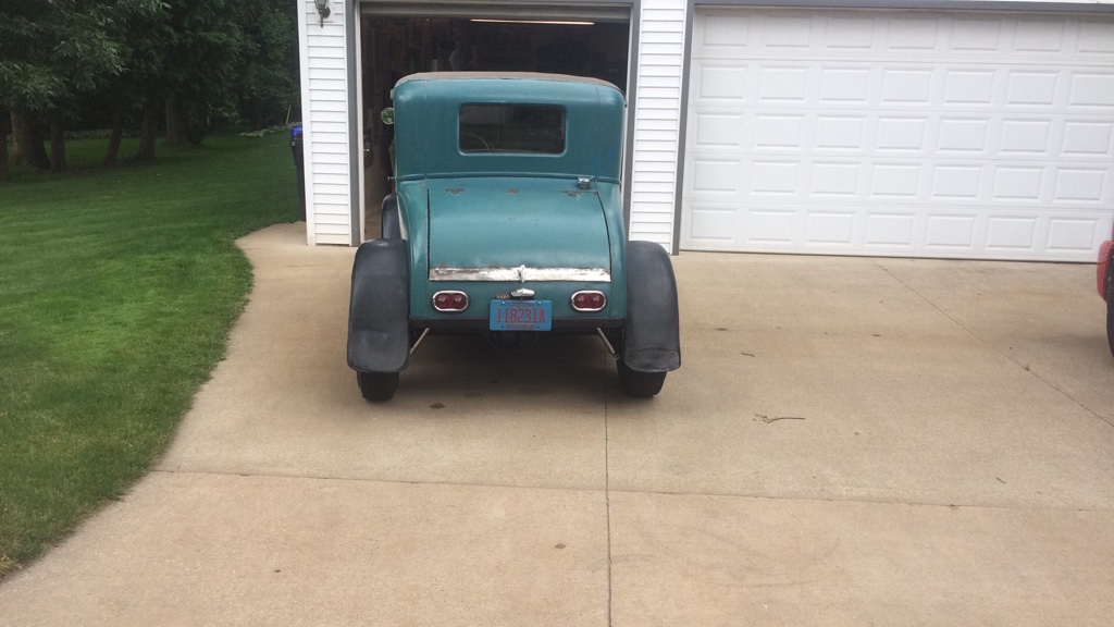

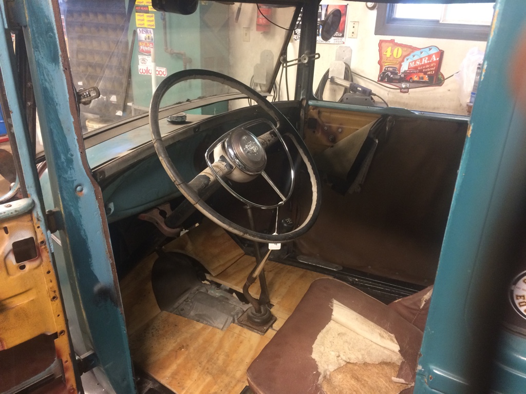

    It's been awhile since I have added to this thread so here goes [​IMG]got the steering wheel set on the steering shaft. It's from a 49 ford and it fits the spline of the f-1 box.[​IMG]the tail lights and license plate light is mounted ( I know the registration is out of date) tail lights are 52 Buick.[​IMG] I didn't like the way a model A grill shell looked on the car so I put a 32 shell on it so it looks just like everyone else.[​IMG][​IMG][​IMG][​IMG]making the hood fit. [​IMG]headlights mounted [​IMG]pushed it outside for a look more to come
