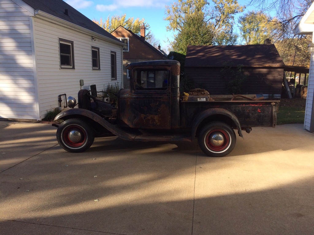

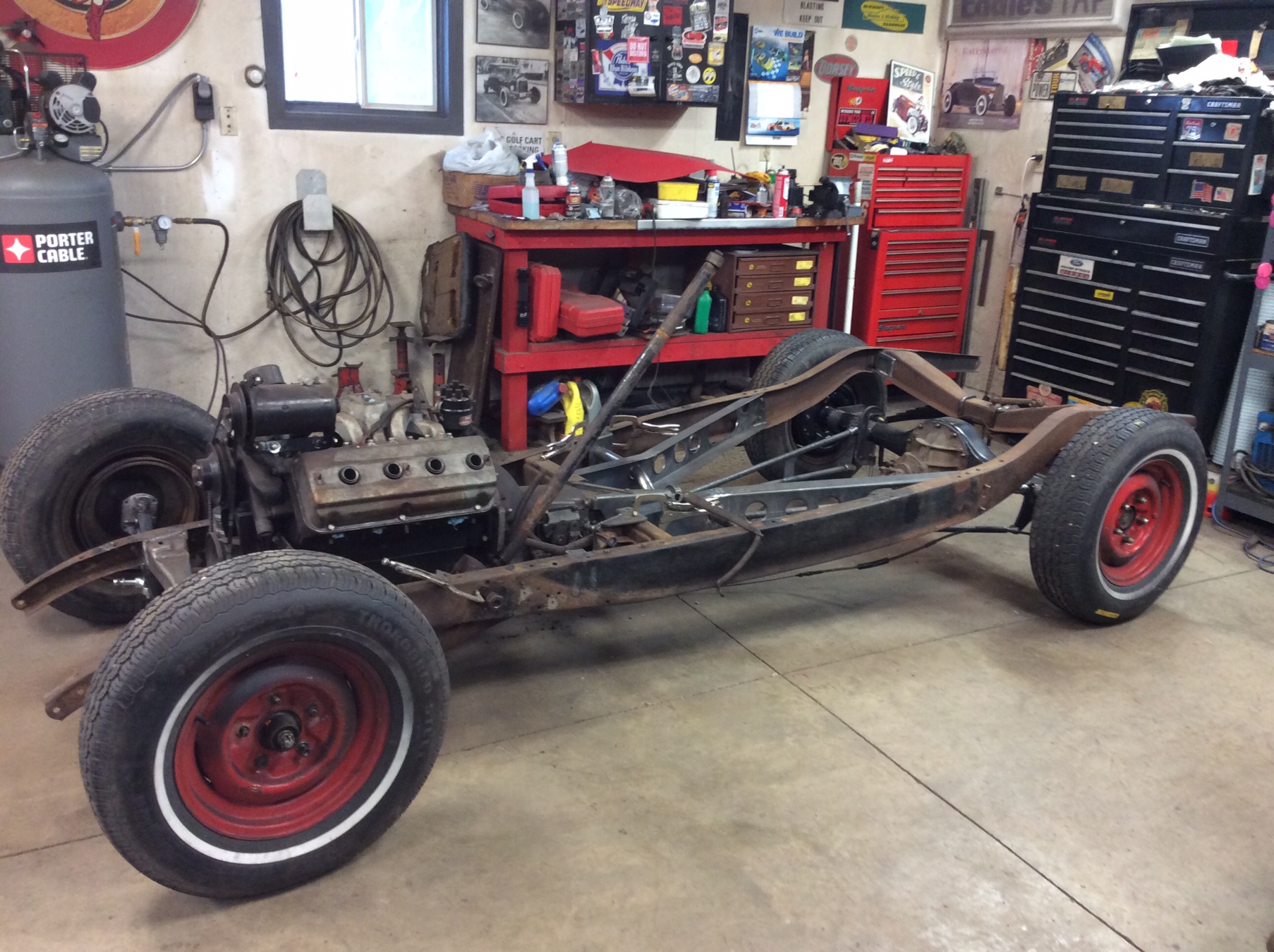

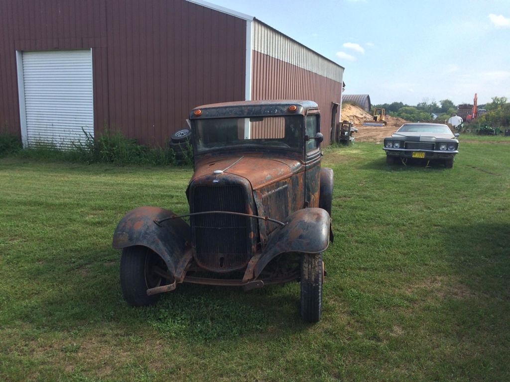

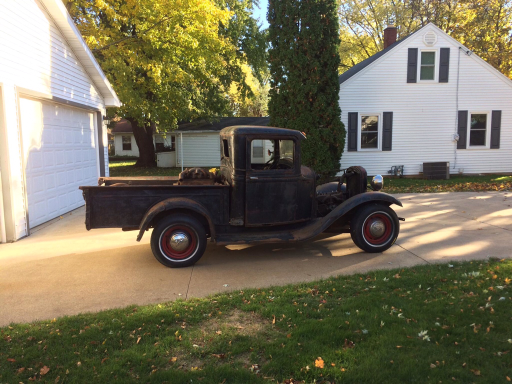

    So for a few years I have wanted a 32 to 34 Ford truck. Well one night of surfing Craig’s list we find this [​IMG] [​IMG]a three owner truck parked in 1969 after the guy I got it from drove it for a summer and then cracked the head on it.

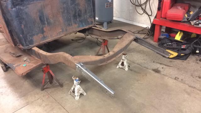

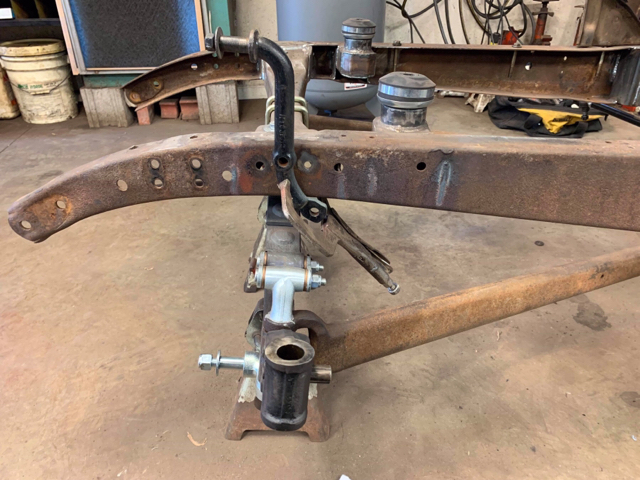

    So we begin With four matching wheels and tires [​IMG]and mocking up the head lights on it[​IMG]Next step was to get rid of some previous repairs it seems the front cross member suffered some damage so it was replaced with a model a cross member from a previous build[​IMG][​IMG][​IMG]Turning to the rear of the truck the frame horns also needed some repair work on those but I forget to take pictures of the before so here’s the after [​IMG]More to come later

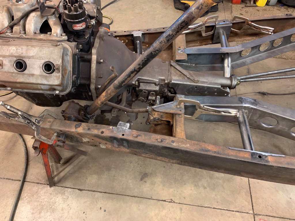

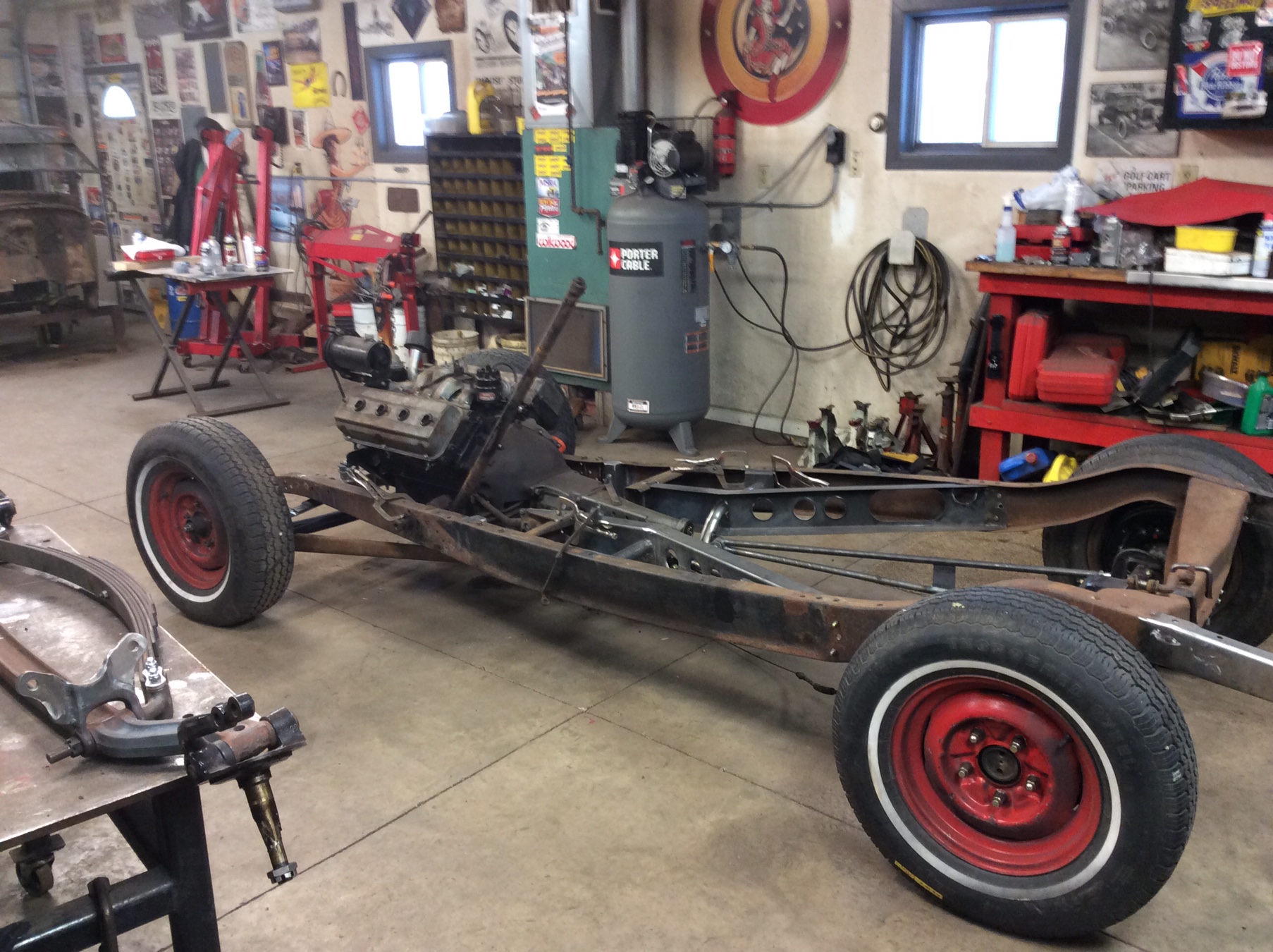

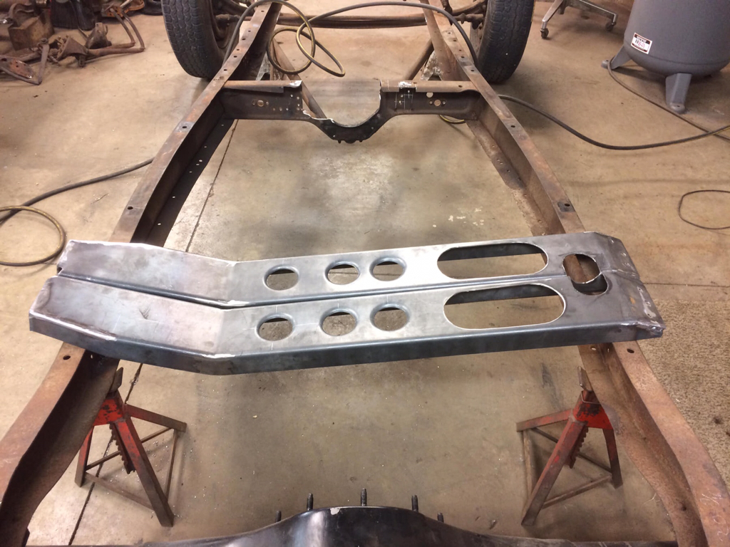

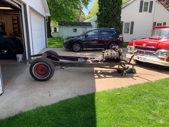

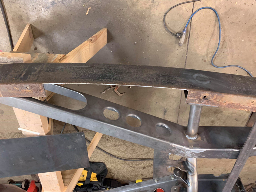

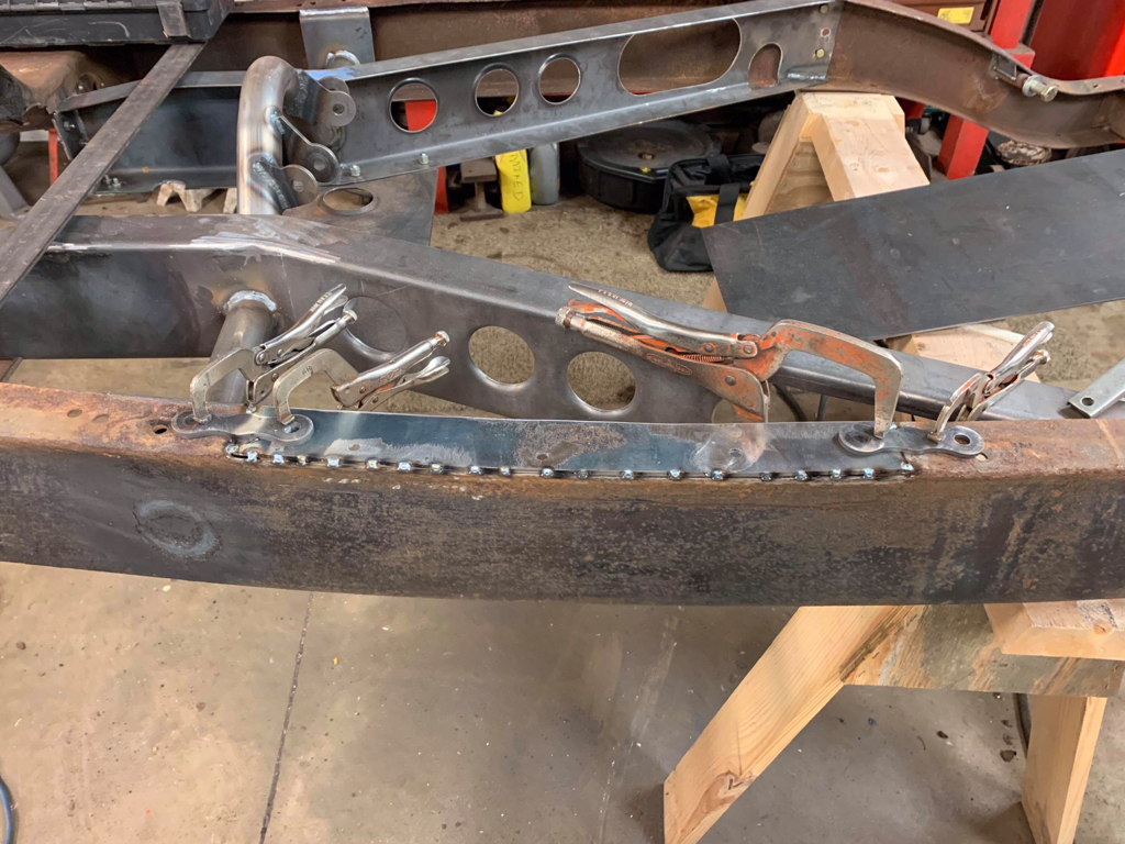

    [​IMG][​IMG][​IMG]Got the Baby Hemi set in future mods include chrome valve covers and a two two intake[​IMG]so here we see the motor and trans sitting in the frame. For the transmission I decided to use a three speed out of a tri-five Chevy [​IMG]Here we can see how the k member was cut and believe me I felt pretty bad about cutting it up but you gotta do what you have to do sometimes [​IMG]heres a picture of the rear motor mount[​IMG][​IMG][​IMG]So after butchering the K member I saw on the H.A.M.B where someone made a set of these so I thought why not so there they are later I plan to add a plate across the top to tie the frame back together [​IMG]Mounts I made to hold the rear spring on the axel [​IMG]Axel mounted in place[​IMG]So I bought a set of ladder bars for another project and thought I can make my own so I did. By the way you don’t really save any money when you do it this way[​IMG][​IMG][​IMG]So this is as far as I am now

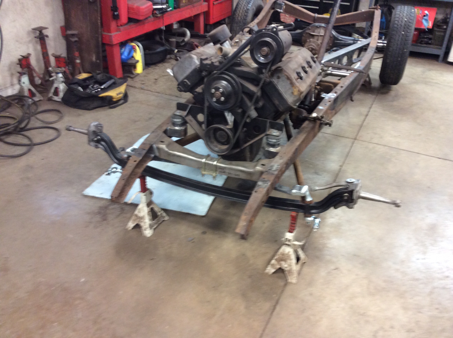

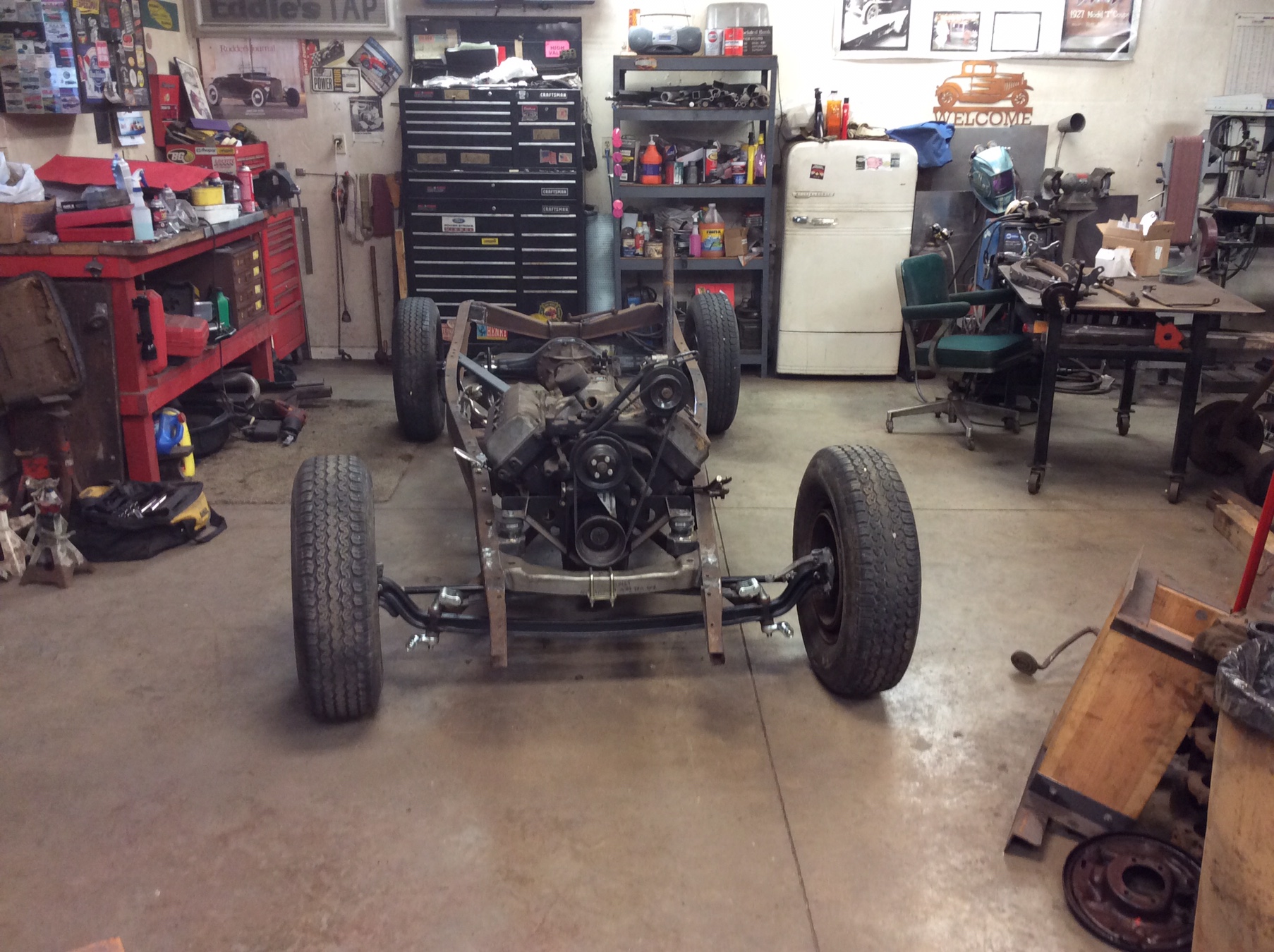

    [​IMG]so last night my dropped axel and spindles from Okie Joe showed up. So we Put it together today [​IMG][​IMG][​IMG][​IMG]And now for one of the best days of Hot rod building when you finally get to set the frame on the ground and take a good look at it[​IMG][​IMG][​IMG]

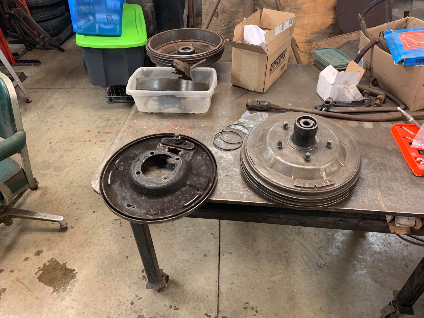

    So today I had some time to fit Lincoln brakes to the spindles it went pretty well except for breaking one of the spacers [​IMG][​IMG]before[​IMG]and after[​IMG]backside[​IMG]and the front side
  17. HUGHES AUTOMOTIVE
    Joined: Jun 22, 2006
    Posts: 73
    HUGHES AUTOMOTIVE
    You can TIG weld that broken spacer to the backing plate. I don't use and filler rod just run the puddle all the way around on both sides. Makes ***embly easier with less parts to loose.
    Stogy and Mr cheater like this.

    What thickness did you use for the new k member pieces? And where did you get the dimple dies? It came out great.
    Stogy likes this.
  20. Mr cheater
    Joined: Aug 18, 2010
    Posts: 652
    Mr cheater
    I got the dimple die off of eBay it’s the kind that does the hole and dimple all in one. I used twelve gauge steel for the new k member legs or about one gauge thicker than the stock frame

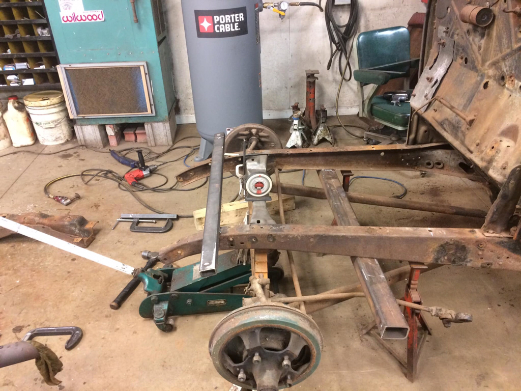

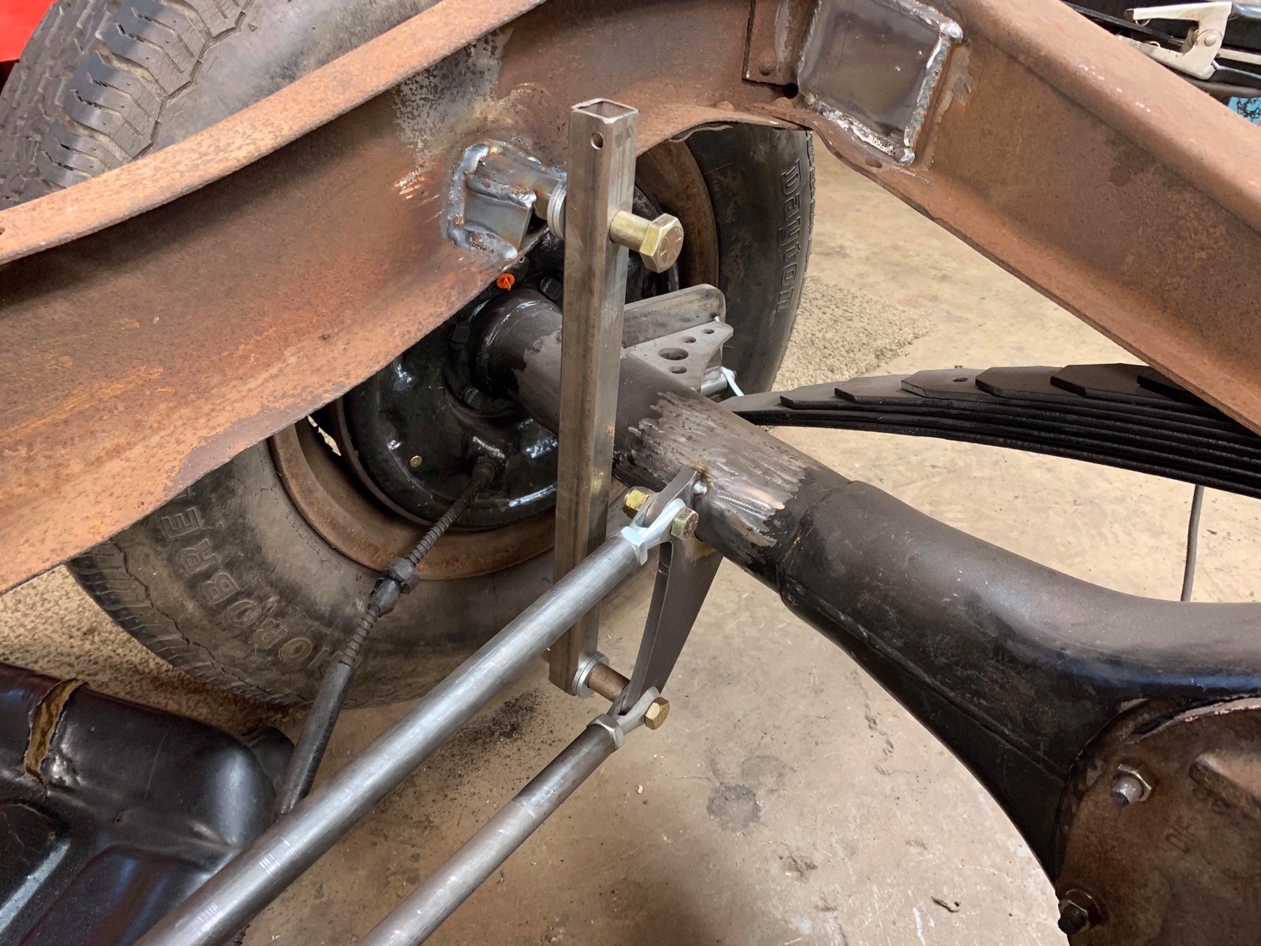

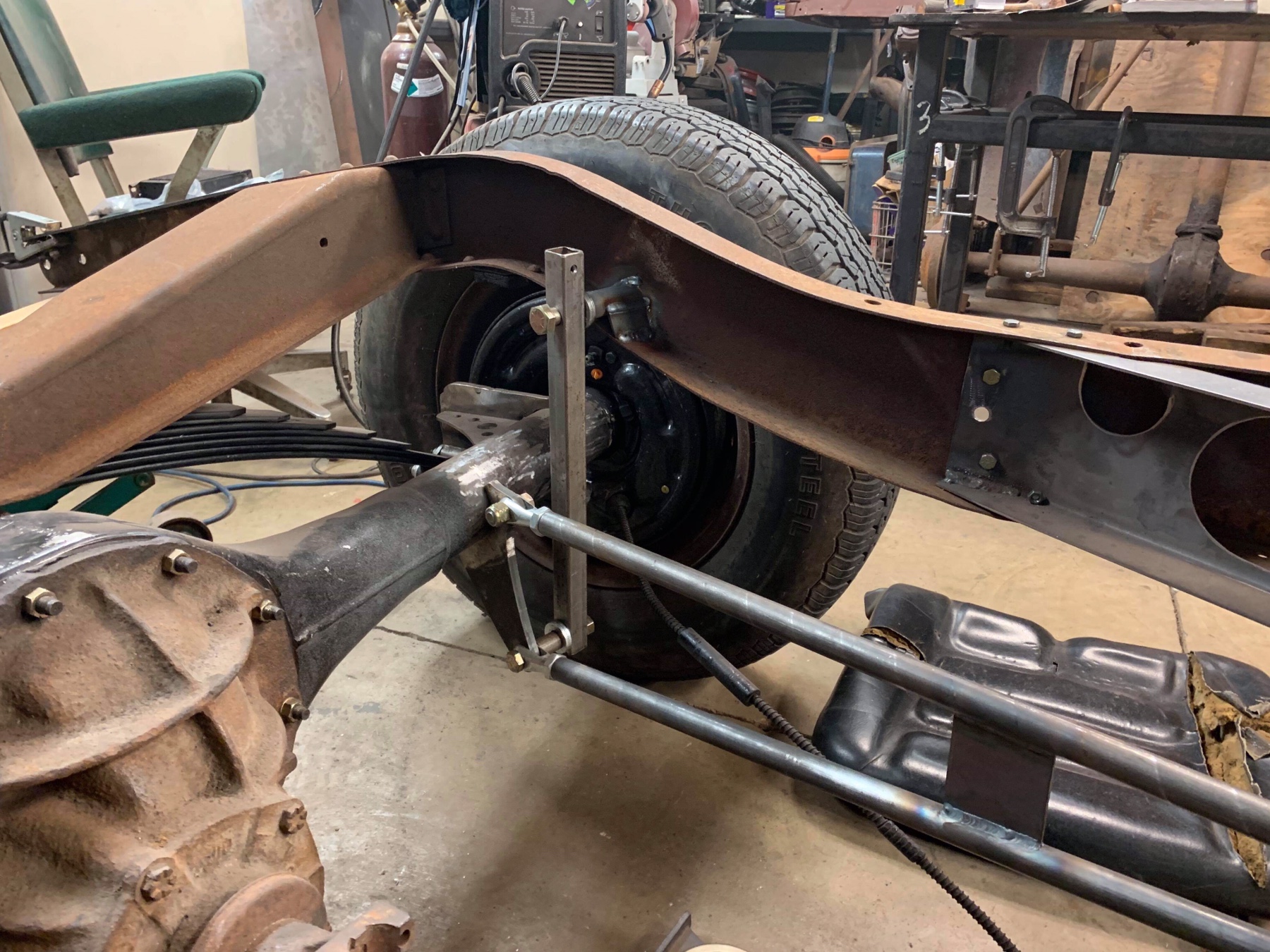

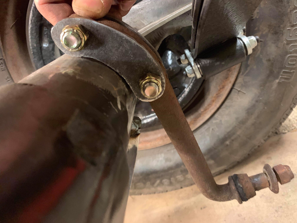

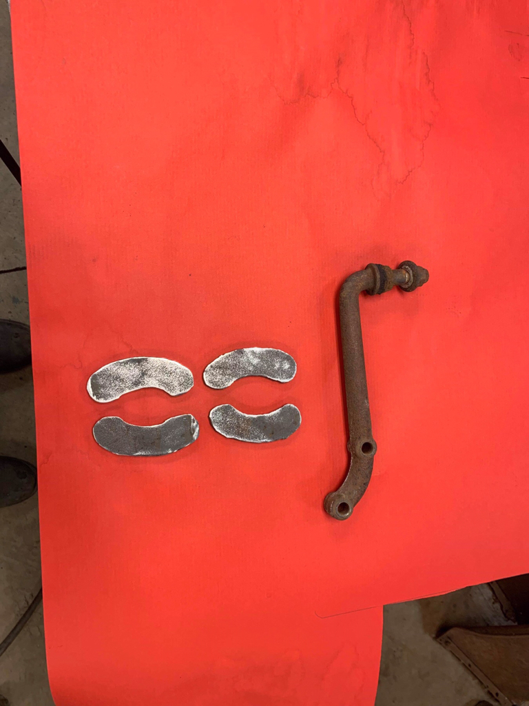

    Slow going and not much time to work on this truck lately would be how I describe my progress. This weekend I brought the torch setup home from work and bent up some what I think are 47 Dodge truck shock mounts [​IMG]here I am mocking them up to see how I have to bend them to fit[​IMG]here the mounts are slowly cooling in some floor dry [​IMG]the placement [​IMG]and then bending them to fit up with the lower shock mount and clear the fender[​IMG][​IMG][​IMG]

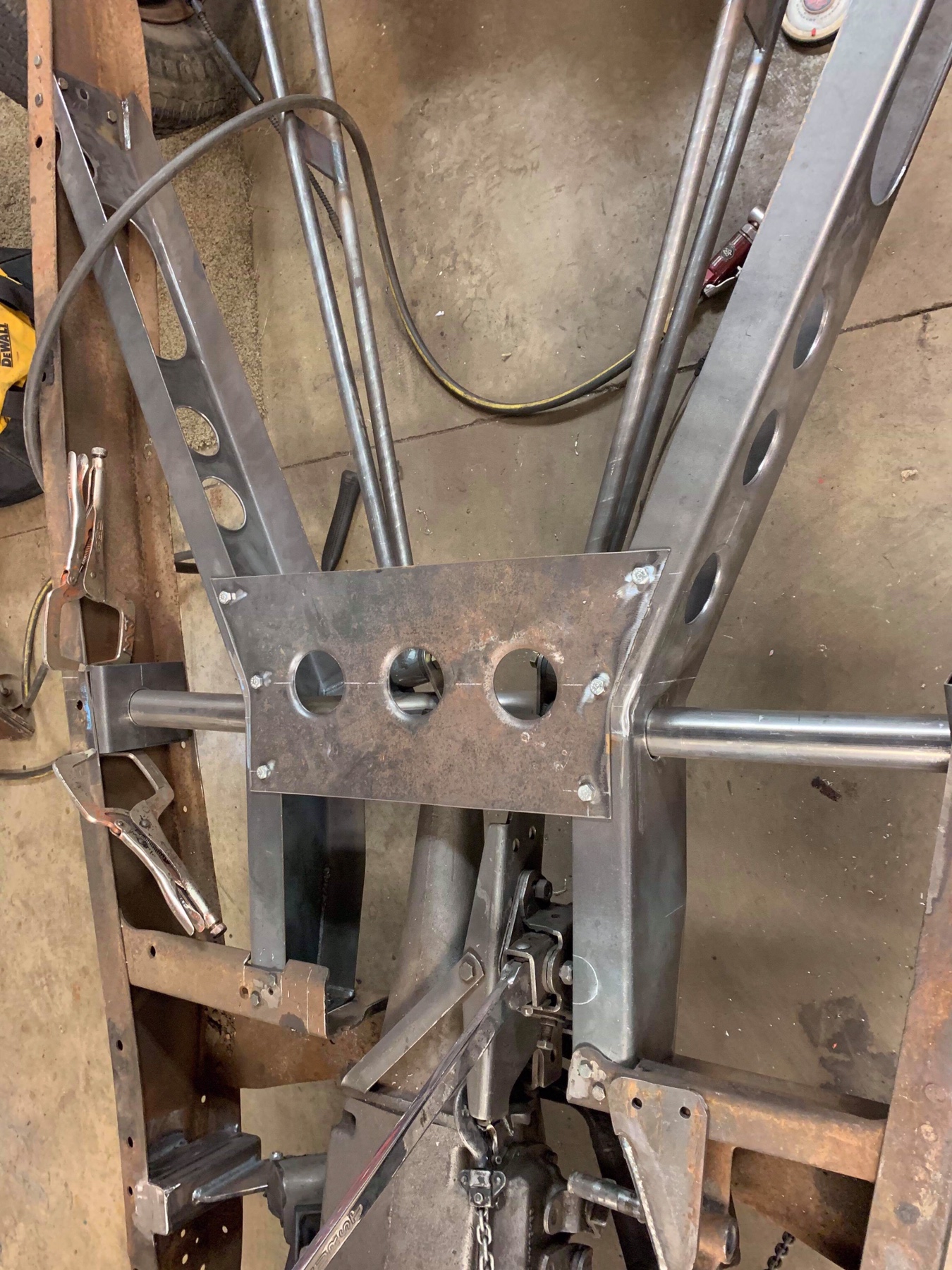

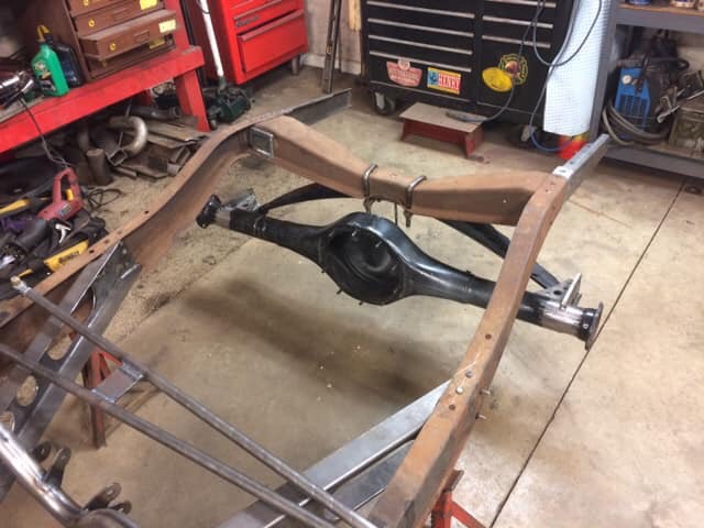

    Took some time to redo my rear shock mounts that I made earlier in post 14 for those of you keeping track at home [​IMG][​IMG]note I used the tube as a mock-up because I don’t have much weight on the frame.also I made a panel to tie my x member together [​IMG]. Also went and got some better cab parts from H.A.M.B member Rustyrods and took a drive by the boyhood home of President Ronald Regan[​IMG]

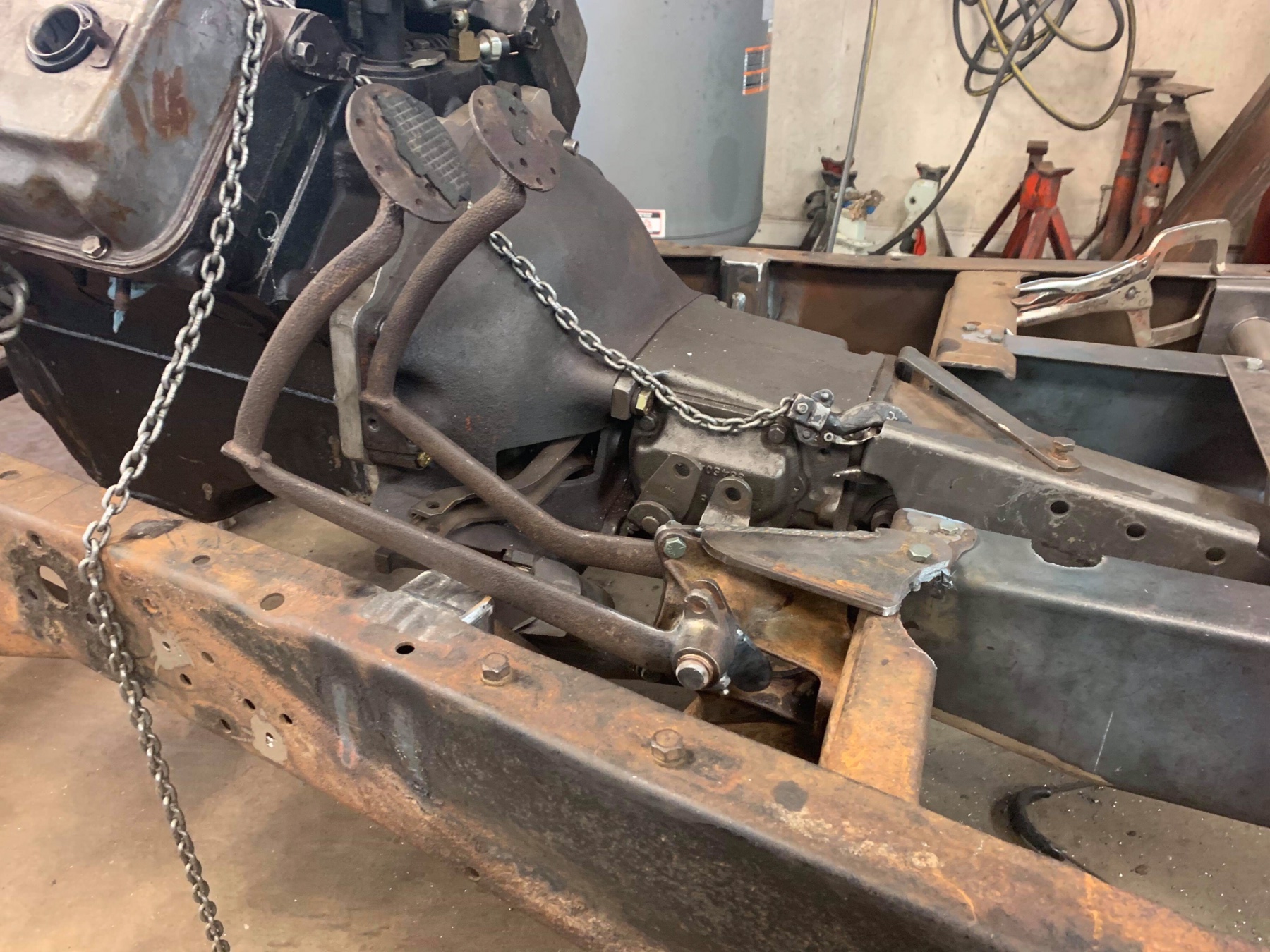

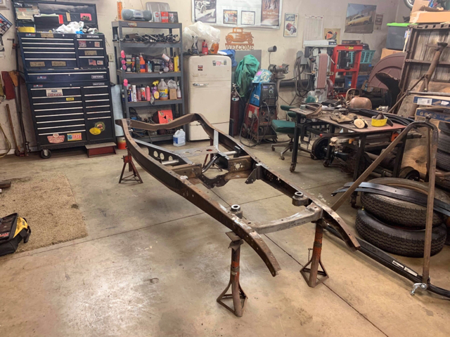

    Some pictures of the brake and clutch pedal ***embly and how they mount in the frame [​IMG][​IMG]Finally it was nice enough out to pull the frame out of the shop[​IMG][​IMG] after a little spring cleaning of the floor I pushed the frame back in to finish welding the rear end[​IMG][​IMG] And here we see the dis***embled frame ready to get cleaned up and painted [​IMG]
