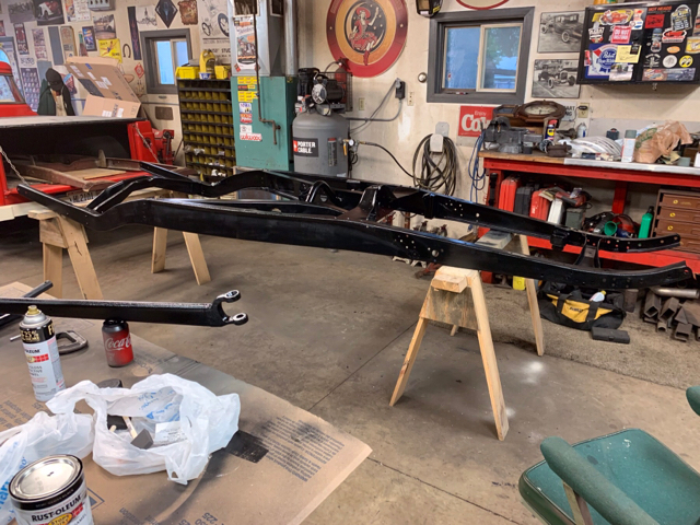

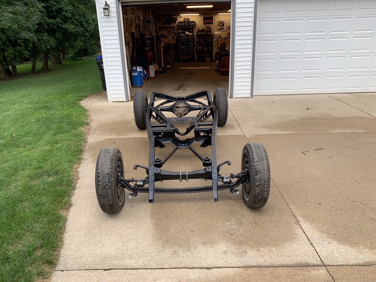

    So it’s been pretty hot here lately like too humid to be out side along with getting all my unneeded possessions ready to go to Iola [​IMG] I finally got some paint on the frame[​IMG][​IMG]

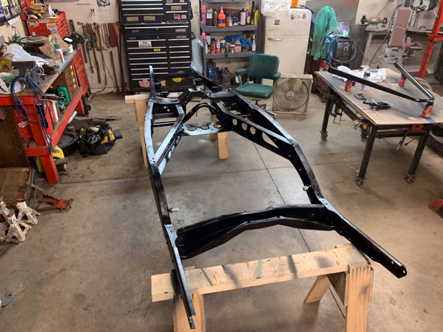

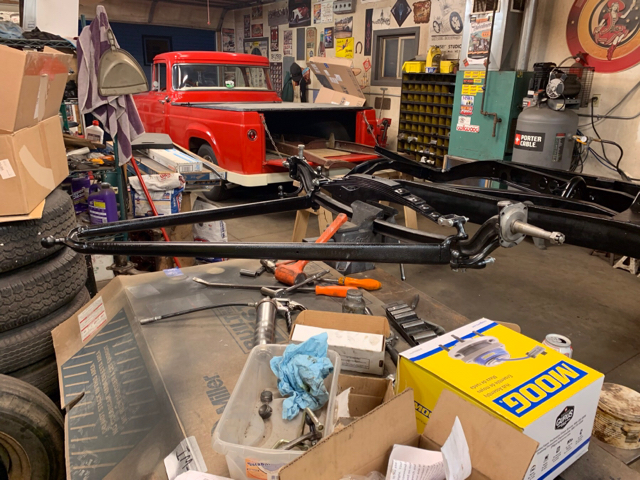

    [​IMG]Here we see Bob K’ s vice in action it’s really the only celebrity tie to this build [​IMG][​IMG][​IMG]just some random shots of the axel ***embly be sure to use caution when putting in the king pins so you don’t break the shims [​IMG]picture of the frame ready for ***embly [​IMG][​IMG]had some time to get the rear end put in

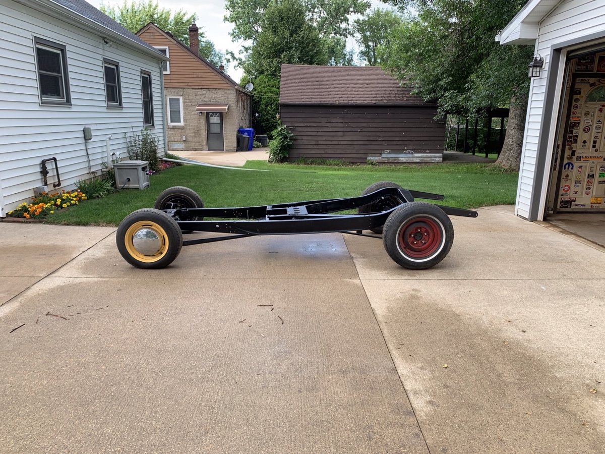

    IMG_0558.JPG IMG_0559.JPG IMG_0562.JPG IMG_0583.JPG just some pictures of where we are at now got the frame made into a roller and had to redo/ fix a few things and started to run brake lines IMG_0584.JPG had to shorten up the shock mounts because they interfered with the steering IMG_0586.JPG IMG_0587.JPG IMG_0581.JPG IMG_0592.JPG ruffing in the f-1 steering box. Up next I will mount the cab to finalize the steering box placement.

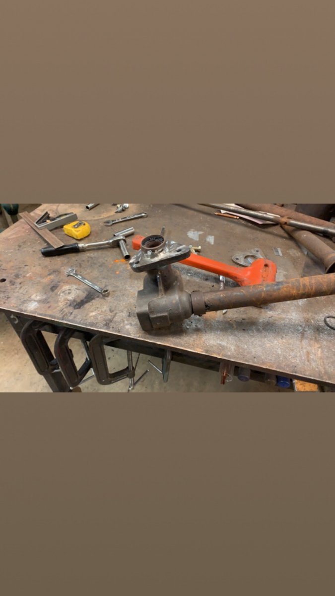

    816B344B-213B-42EF-B2C2-2D2366CBDF68.jpg CF8392AF-DA8C-4829-A102-5E4113B12584.jpg i forgot to include pictures of the modified steering box flange

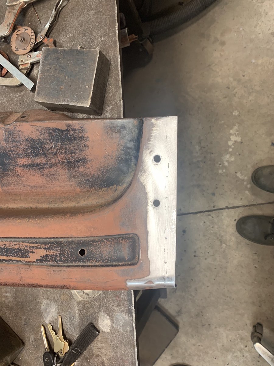

    So after finishing the doors I decided to tackle the back or the cab IMG_0899.JPG here is a picture of the bracing I put in the cab to keep everything where it should be IMG_0897.JPG the first cut IMG_0900.JPG and the second cut IMG_0902.JPG here is one corner cleaned up IMG_0904.JPG if anyone wonders about he stuff from United Pacific I’d say it’s pretty spot on IMG_0903.JPG and here’s a picture or the patch panels IMG_0898.JPG more to come later

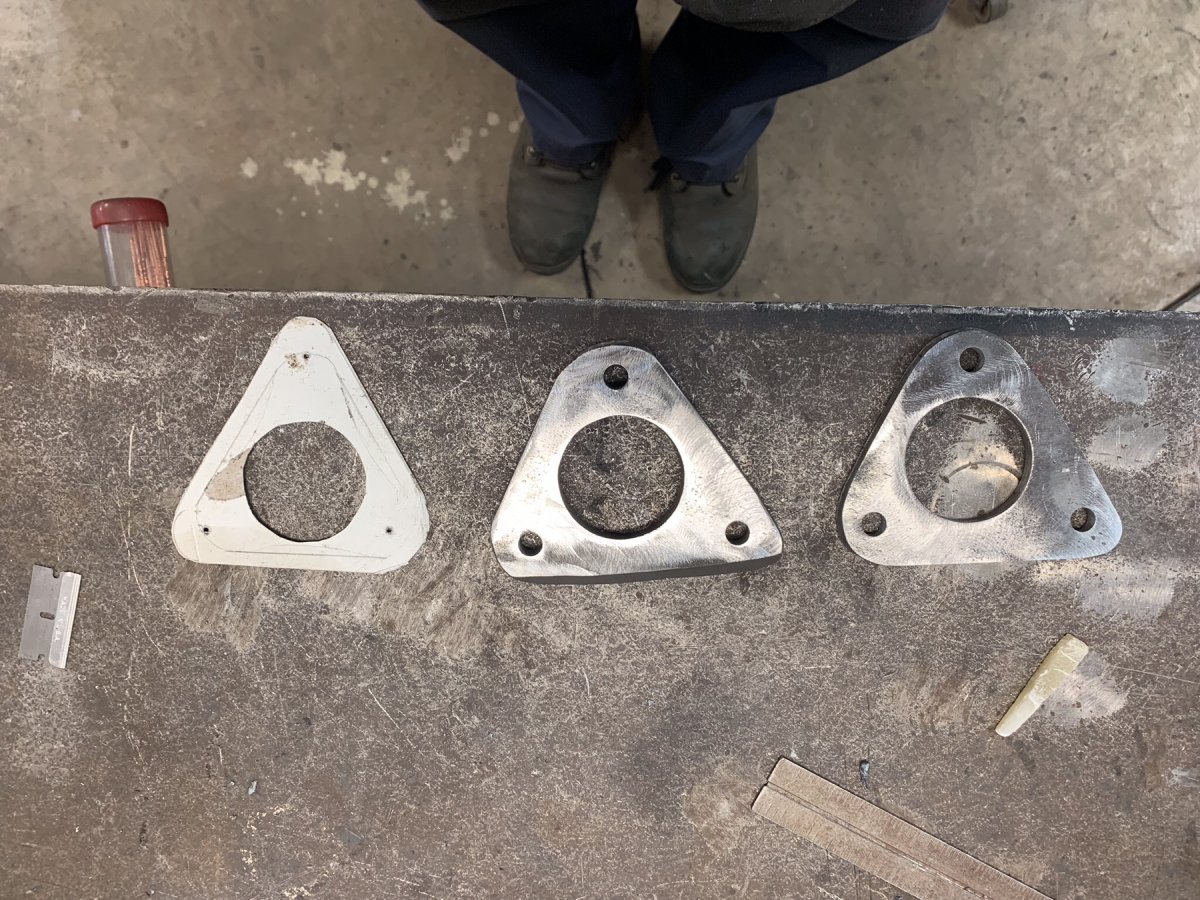

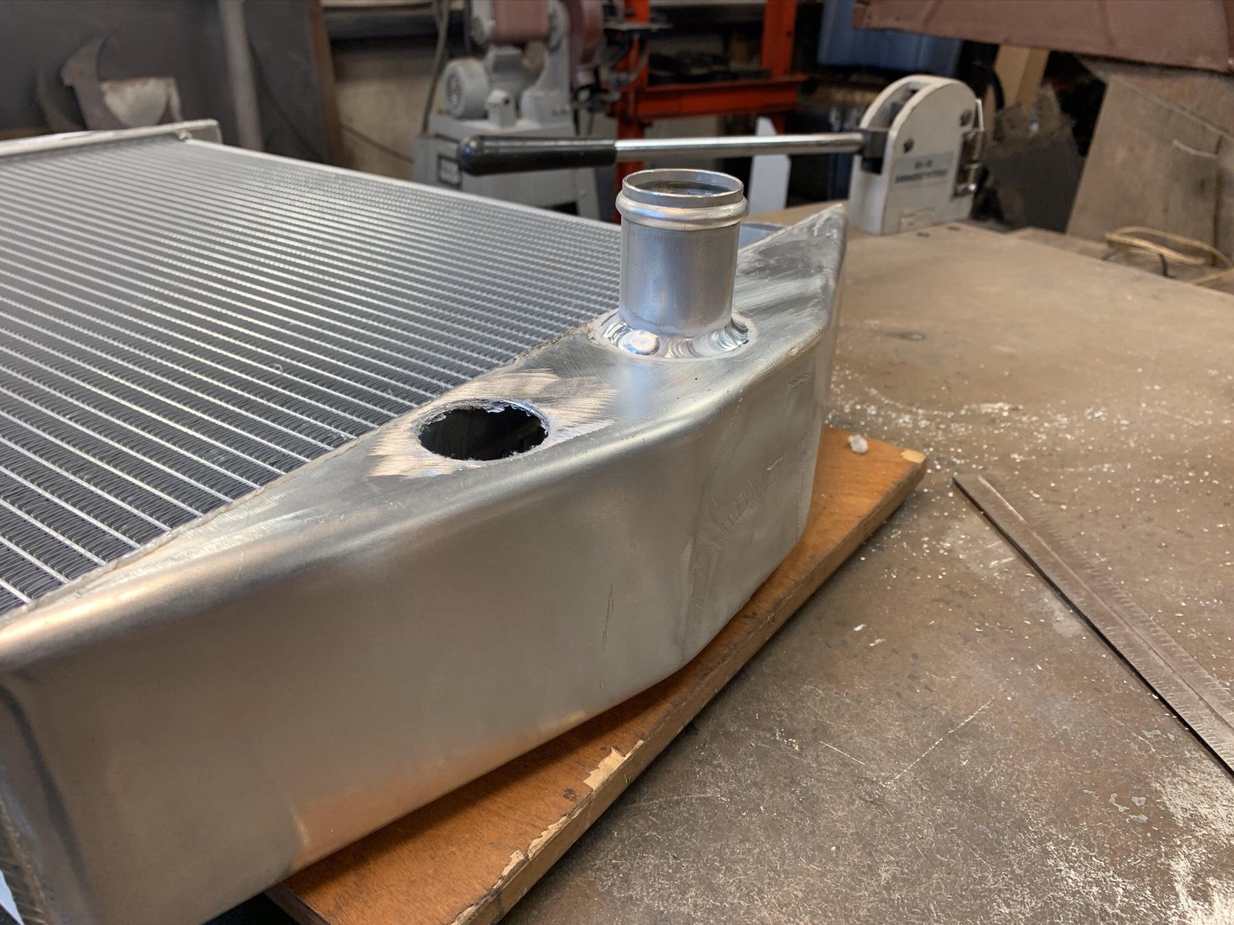

    Another part that had to be modified was the thermostat housing [​IMG][​IMG][​IMG][​IMG]took this picture from far away didn’t feel like showing my lack of dime dropping ability
