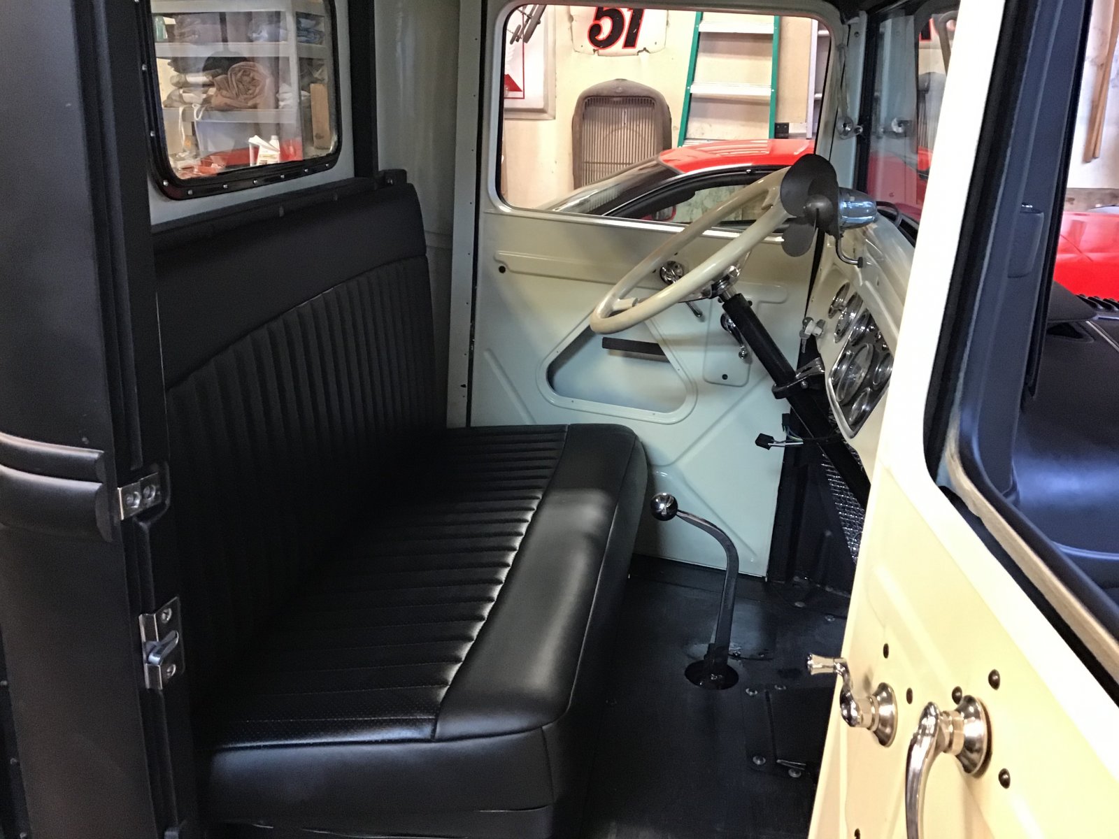

    Starting on reassembly now, took the time to slide the seat in 2BCC4094-4EDF-43A0-AC78-E7C742895145.jpeg D727860C-B1FB-459A-A0E9-E9C8D31D21B9.jpeg also we bolted on some of the things that are attached to the firewall 032B1C10-CD5E-4B36-9365-05D966C7578D.jpeg

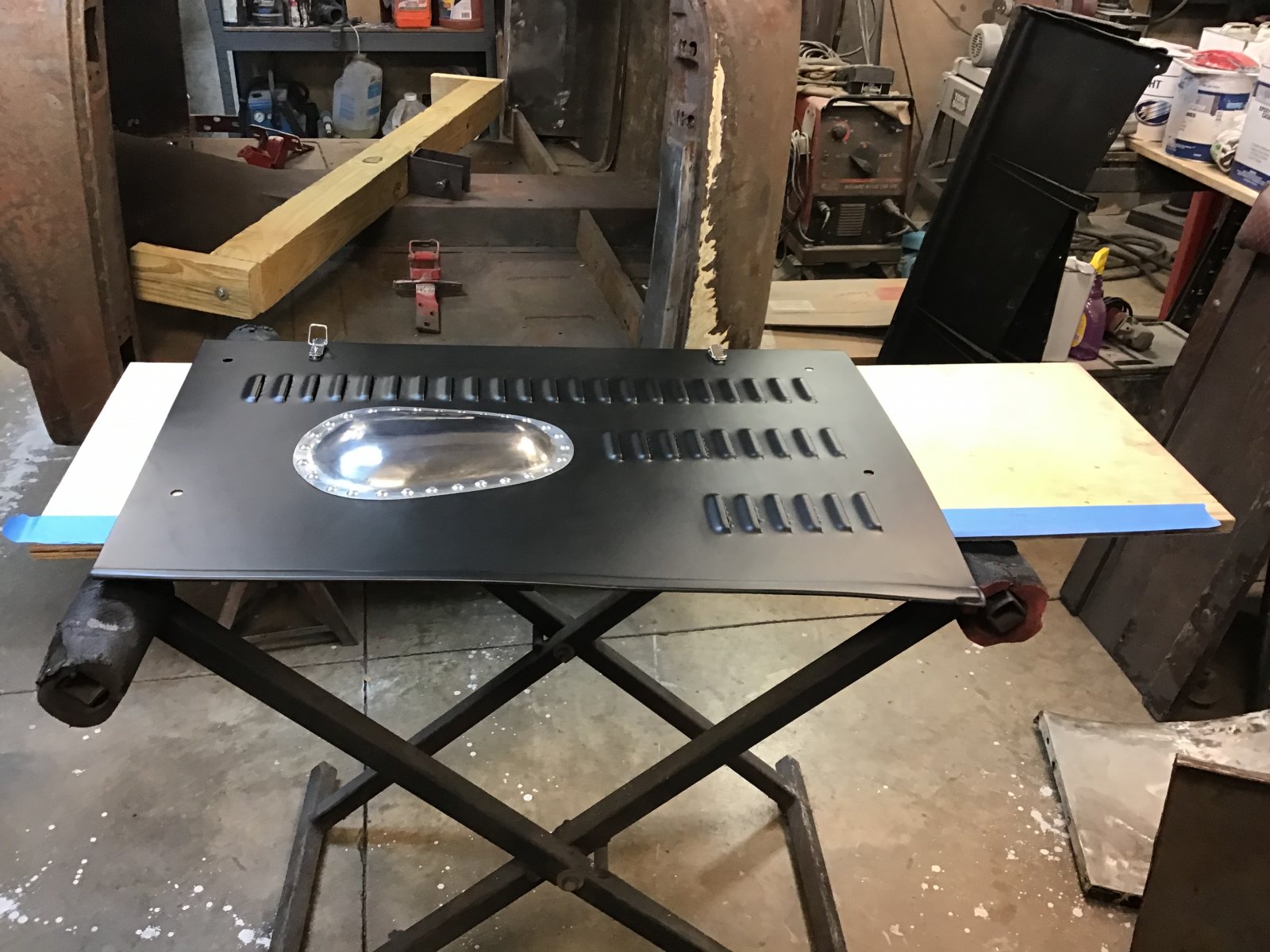

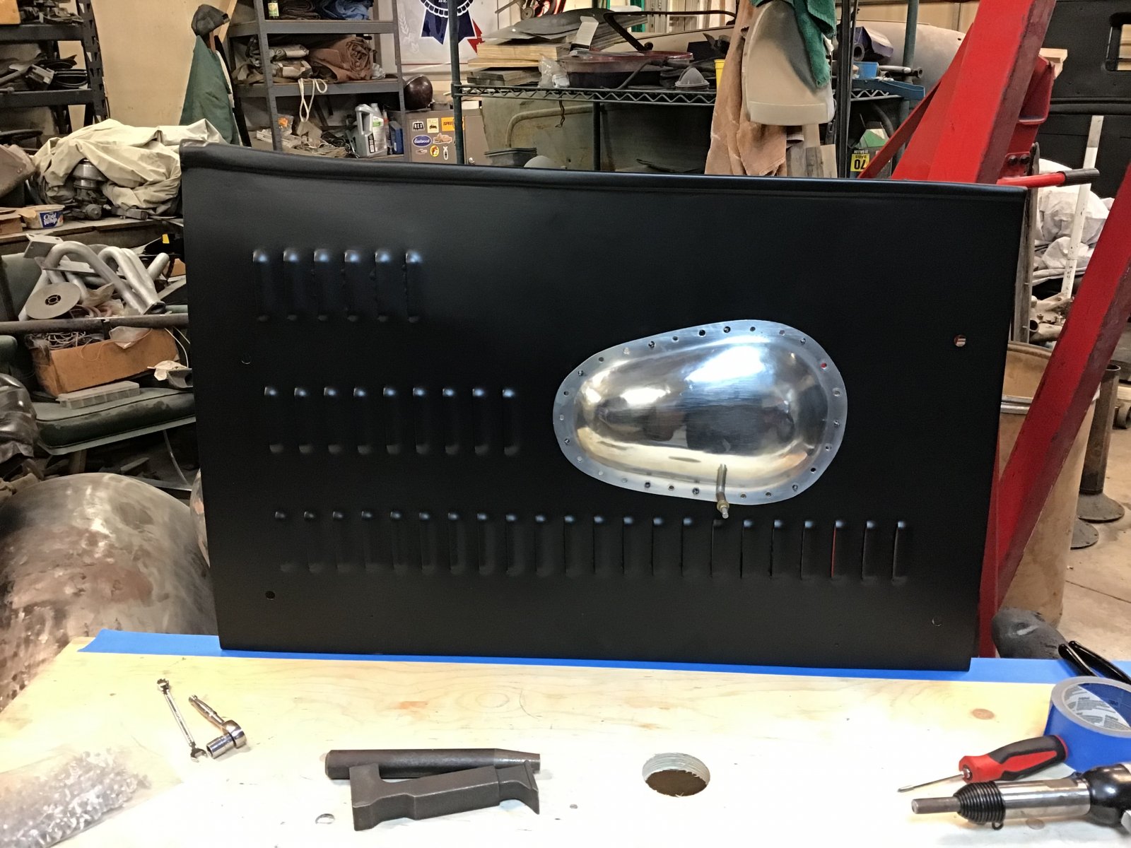

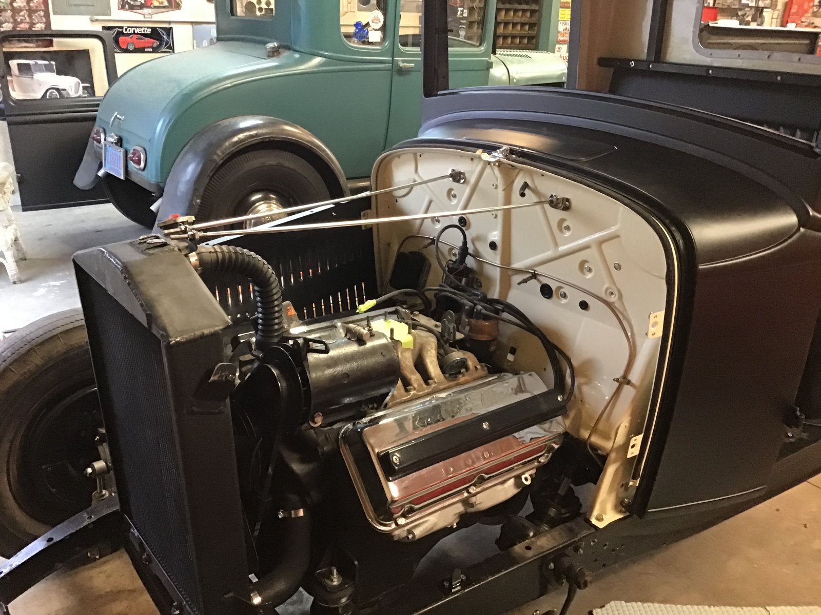

    Mr cheater

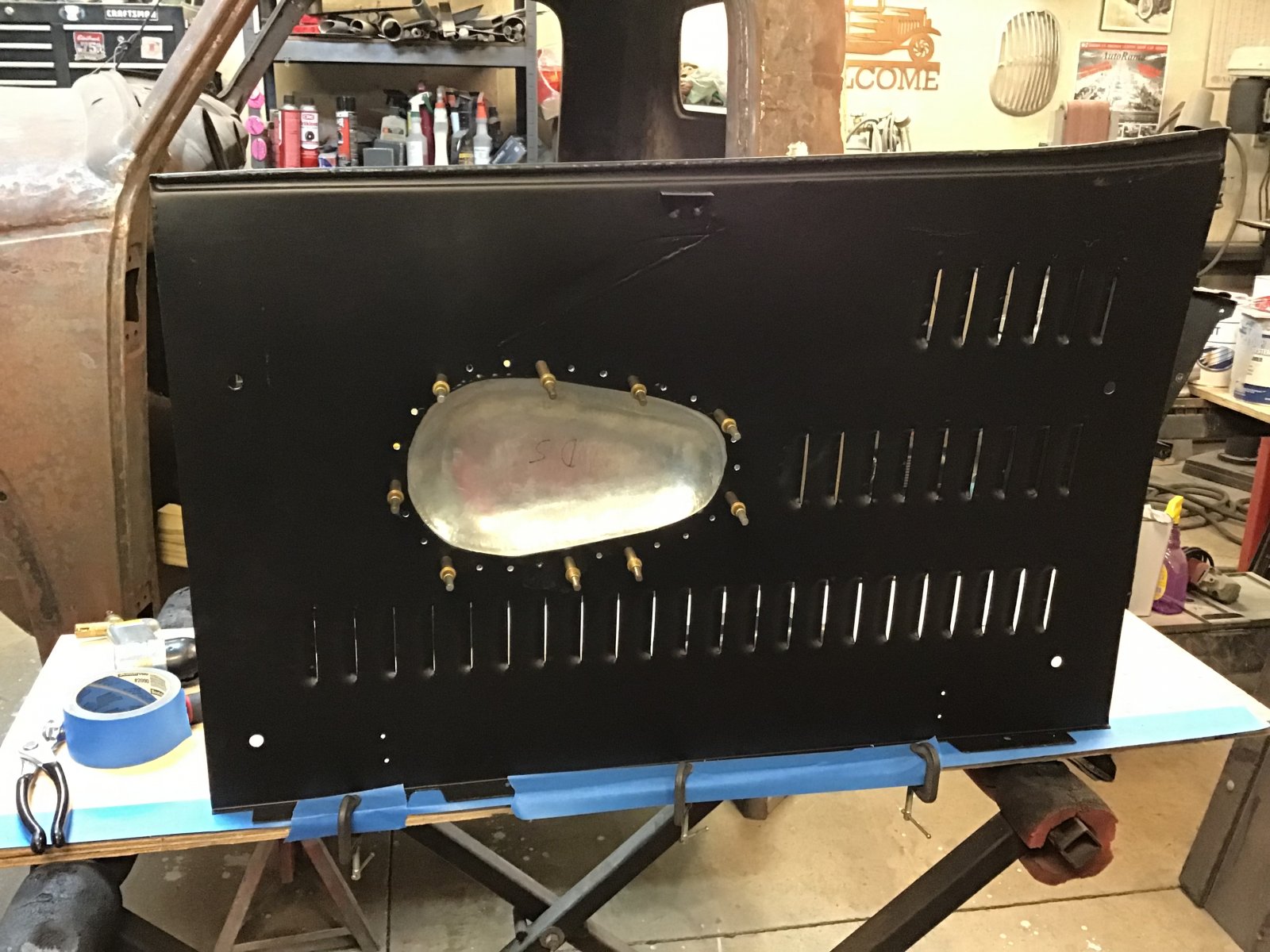

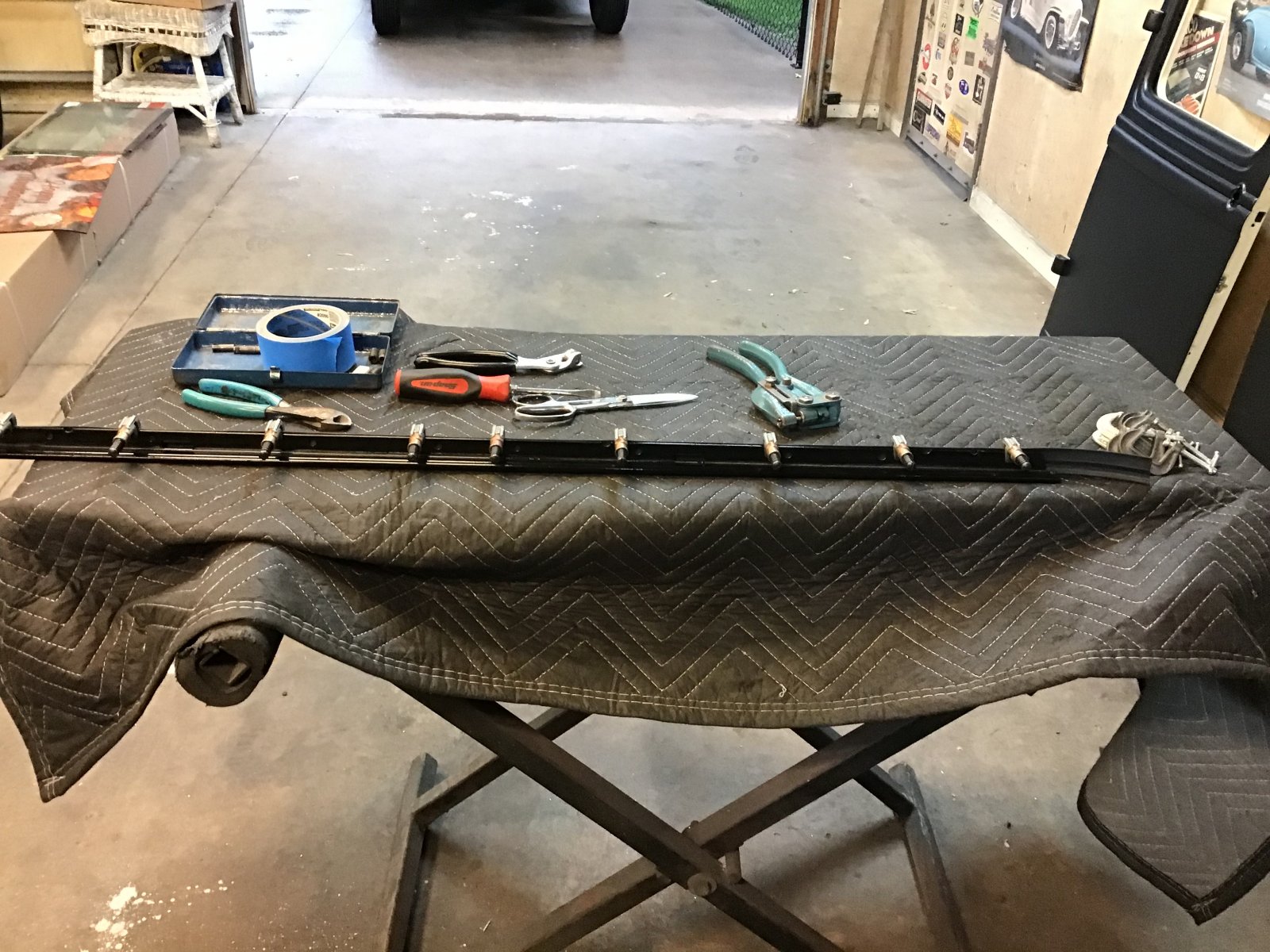

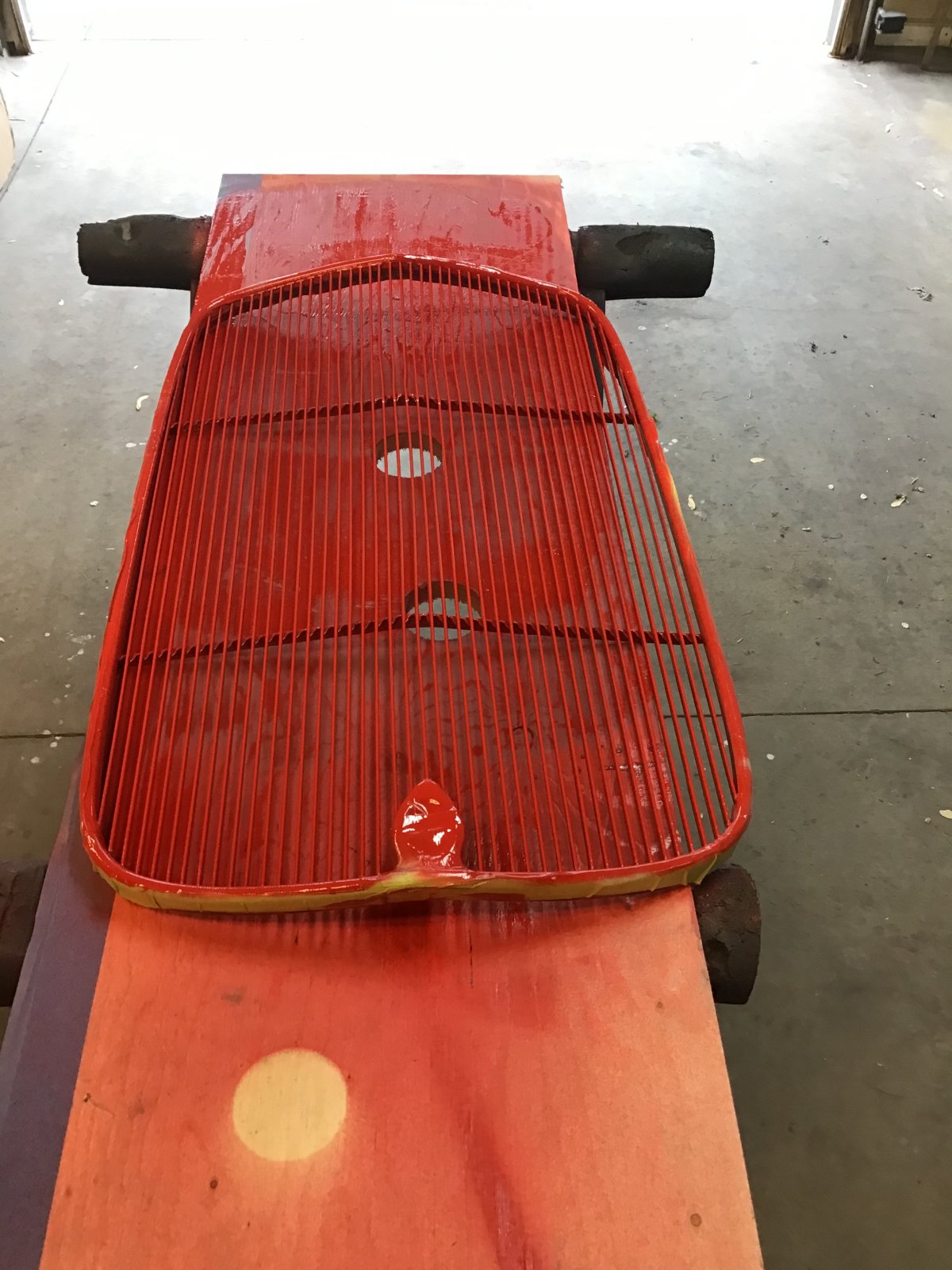

    Got the hood blisters attached to the hood and ruff set on the truck FE546962-F935-4099-A652-AD92BE0B09E6.jpeg F26235E7-F6BA-414B-9610-3285545E9AE4.jpeg 7CEA339F-3D43-4A01-9688-05085312283F.jpeg 8374FDDA-8FF4-4FC4-816C-2E0854F309E9.jpeg took some time to paint the insert on the grill today as well. When it first came out of the can I thought it would be to bright but it seemed to tone down a bit when it flashed off 1A6E7806-6E09-434E-A03F-629939DD3725.jpeg

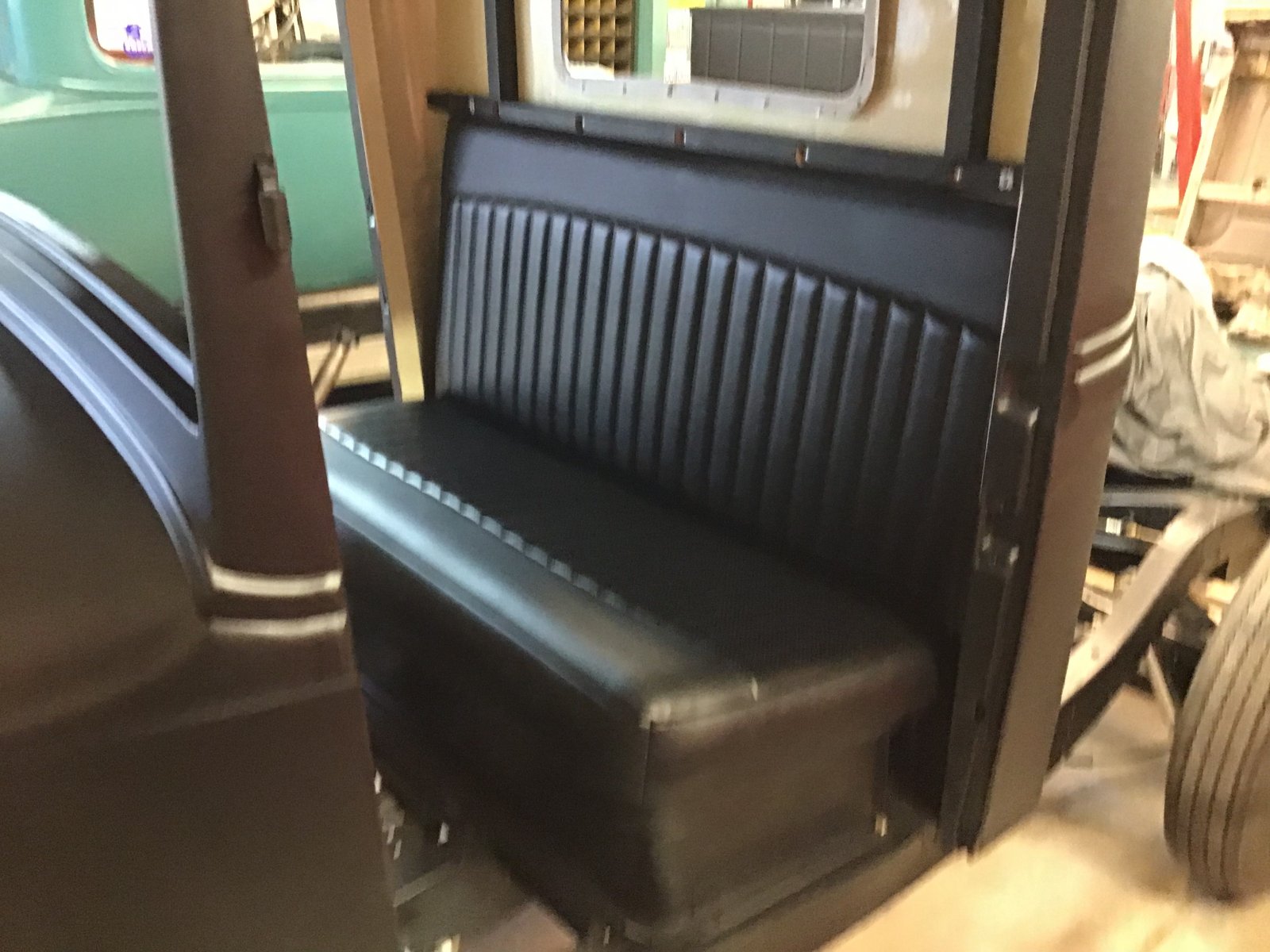

    Seat looks good, who sewed it?

    A local guy Stitch Krazy he works out of his home garage. The seats really comfy and it cost more than my couch.

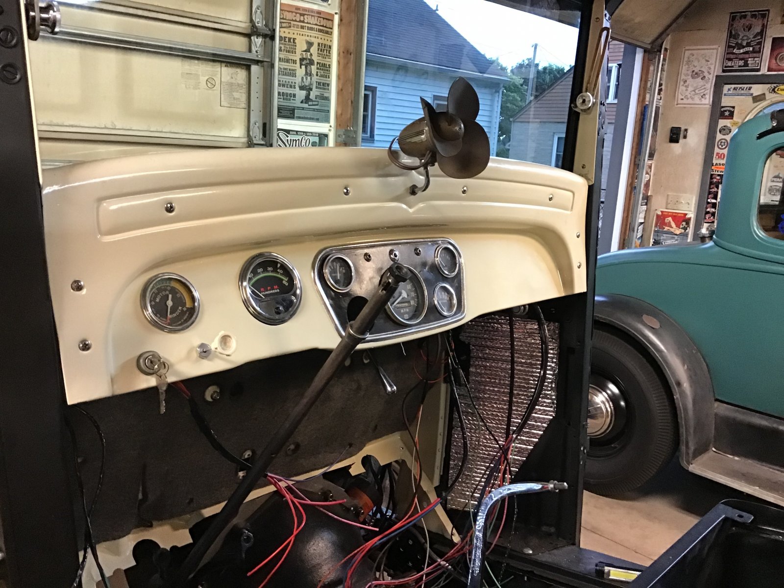

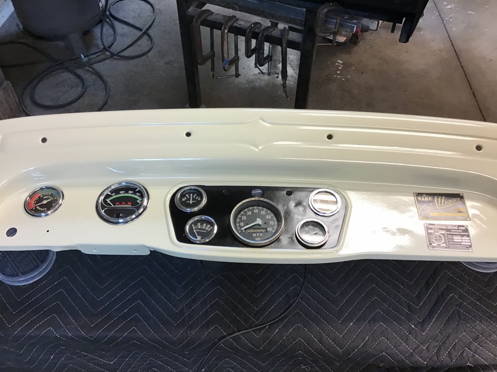

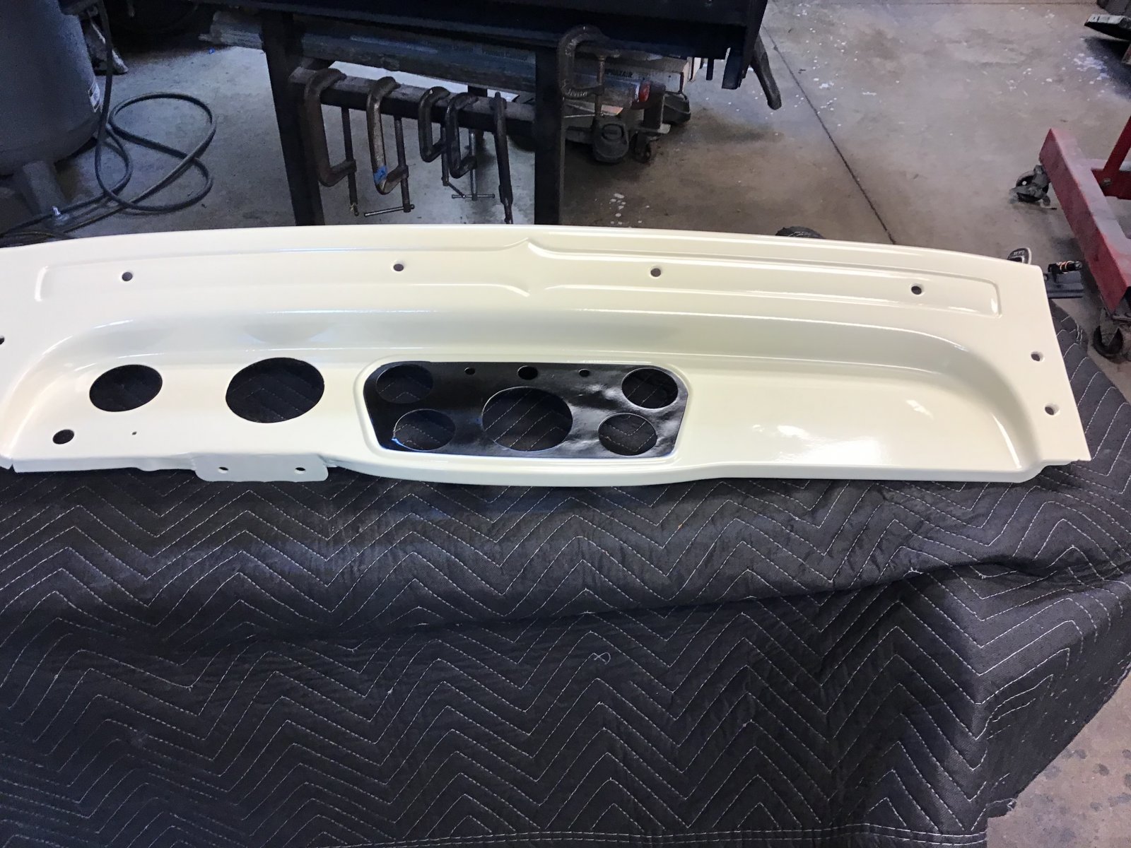

    Some of the non glamorous work. Punching holes in the windshield hinge gasket 46044BE7-E533-4AE4-ADDB-02753EFA7782.jpeg painting the dashboard insert semigloss black and playing with gage placement 9CB0ABCE-1297-4F64-8923-CD0DD088937F.jpeg 00A02EE8-CAA3-4F70-9267-B5B07C3F2B2E.jpeg 2E71497F-A813-407B-BAB6-5B125D14A6C8.jpeg

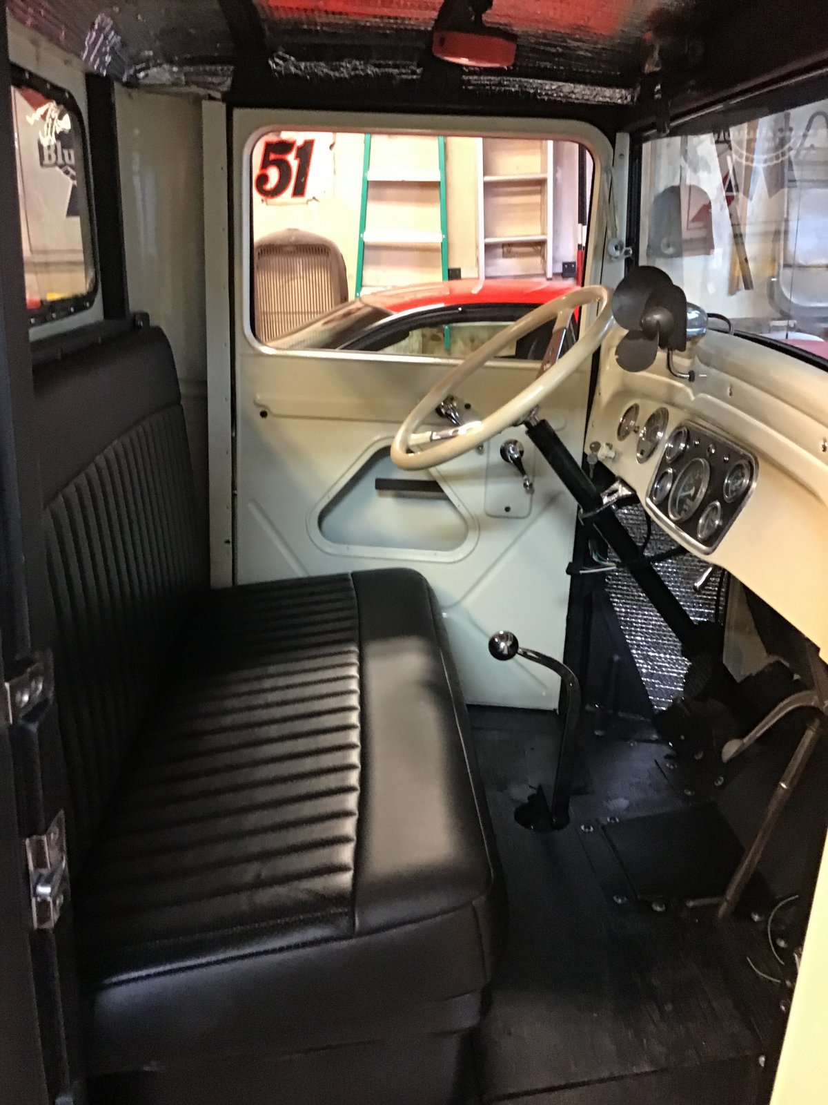

    Today was a hot one so we did some easy things. We got some insulation put in the cab 6D1588F4-B057-409C-A28B-4F521DC7D98C.jpeg and we put the dash together and mounted it in the truck hopefully for the final time 8946182E-BBC9-45BA-B1B0-1D2D6E3B93D1.jpeg F6E75E29-94EE-4681-A7EE-2294D7C14A60.jpeg As it sits now with the windshield in it 95E1D1FC-A603-4EF6-9A3D-644404E7AF4E.jpeg

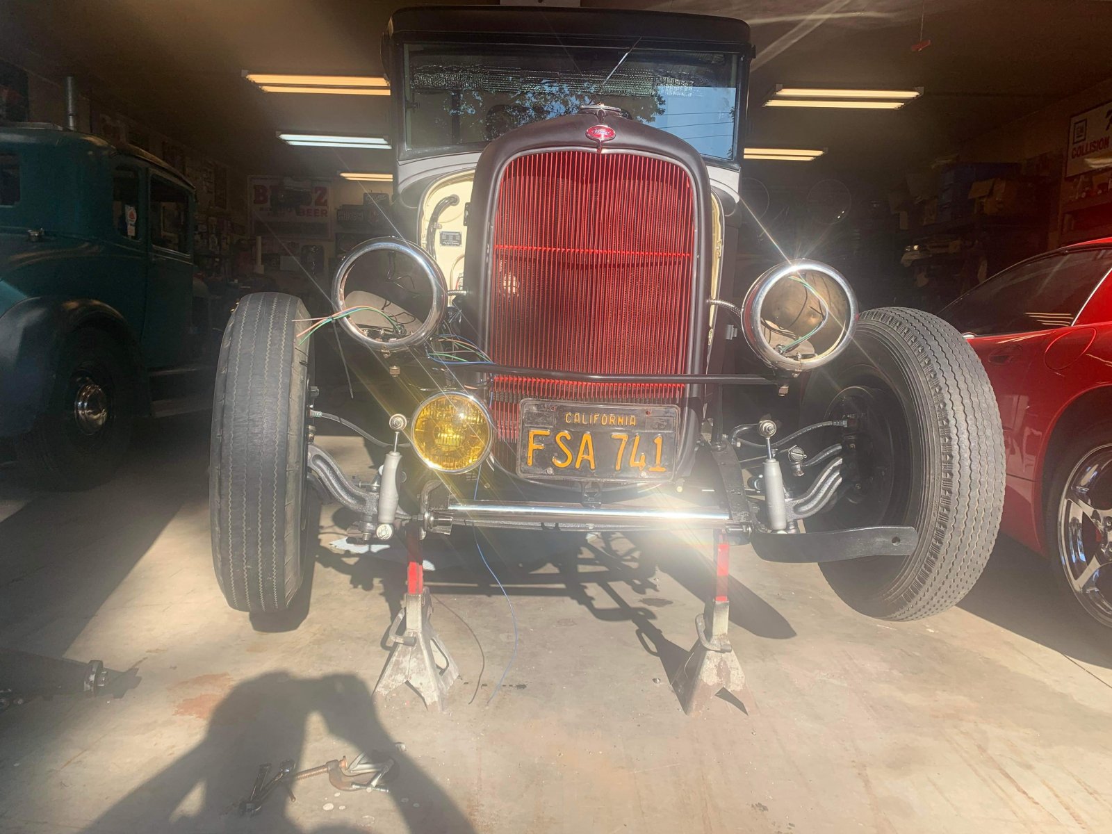

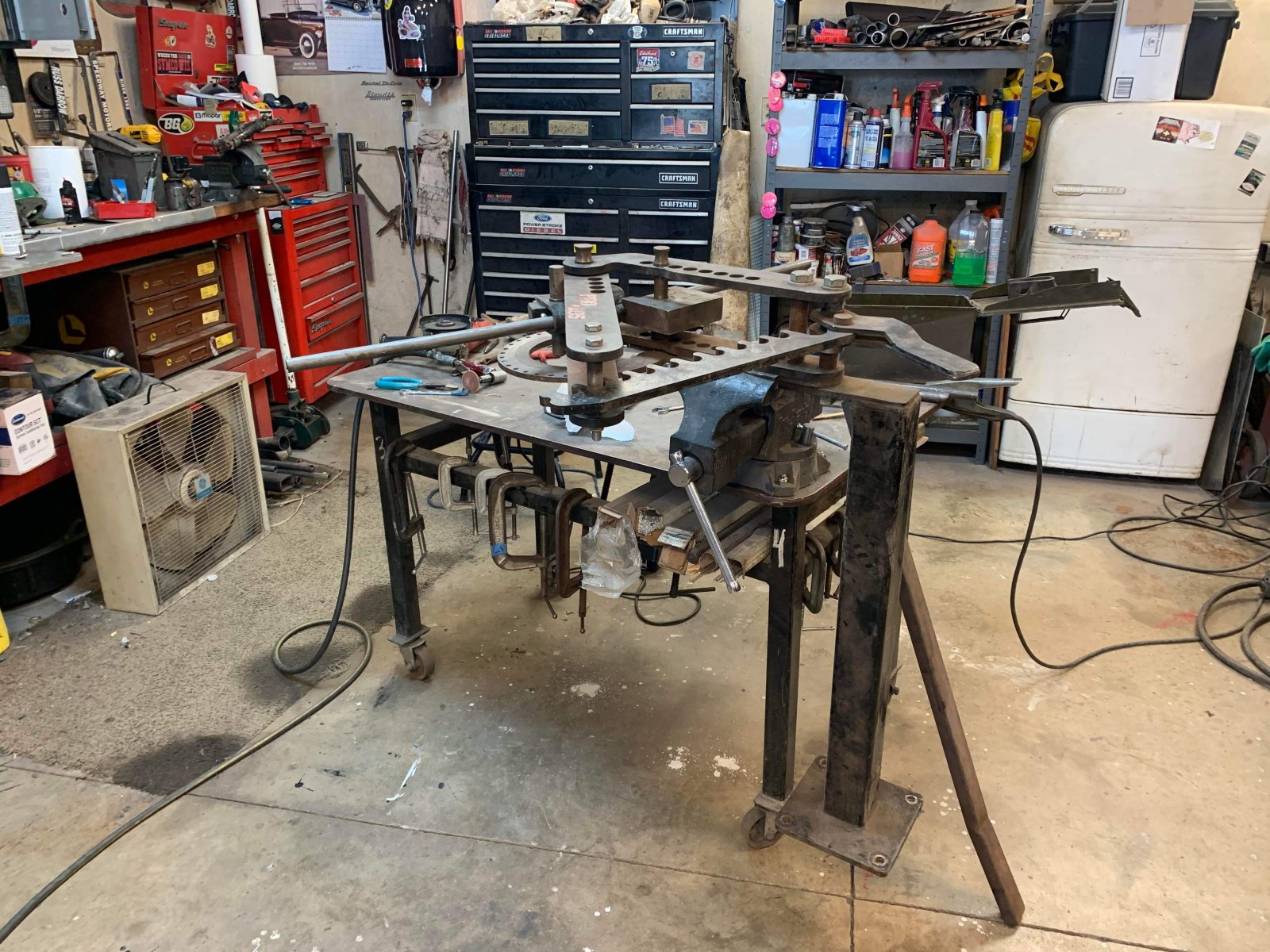

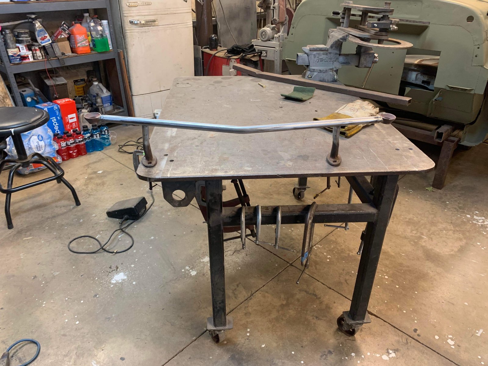

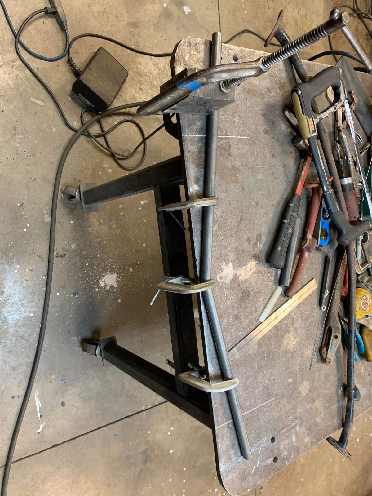

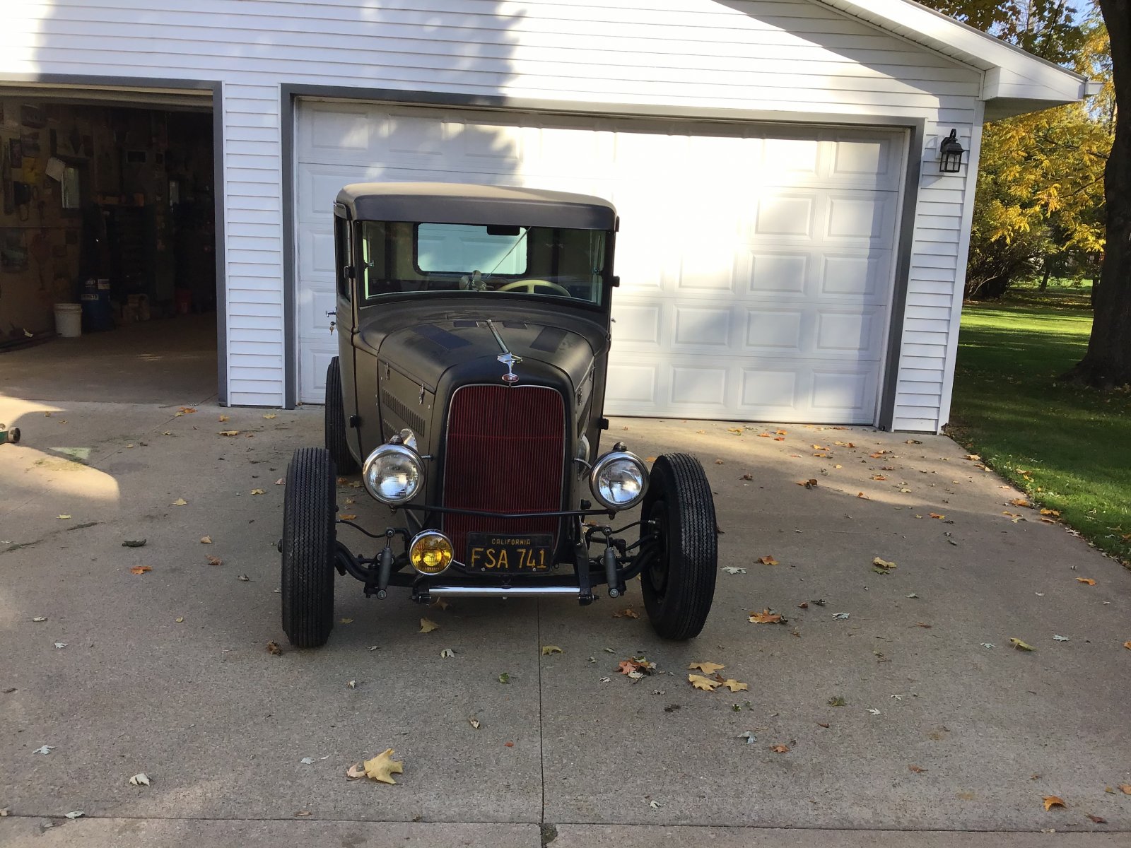

    Made a head light bar for the truck. Pictures are a bit out of order. But you should get the gist of it 59153168-7FE6-406D-B02E-852A844D0BDB.jpeg B19FB7A9-66D5-44D6-803E-81A9CC9990EB.jpeg 1F09791E-3CA9-4501-A2C5-A7CF8A8E94F3.jpeg F1475E12-4822-4BA5-831B-C3D02BA0A1FA.jpeg A88B6524-9065-4A4C-8EFB-24E56122B987.jpeg

    Looks great and love the headlight bar

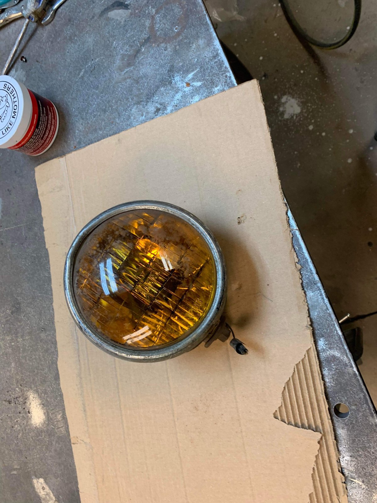

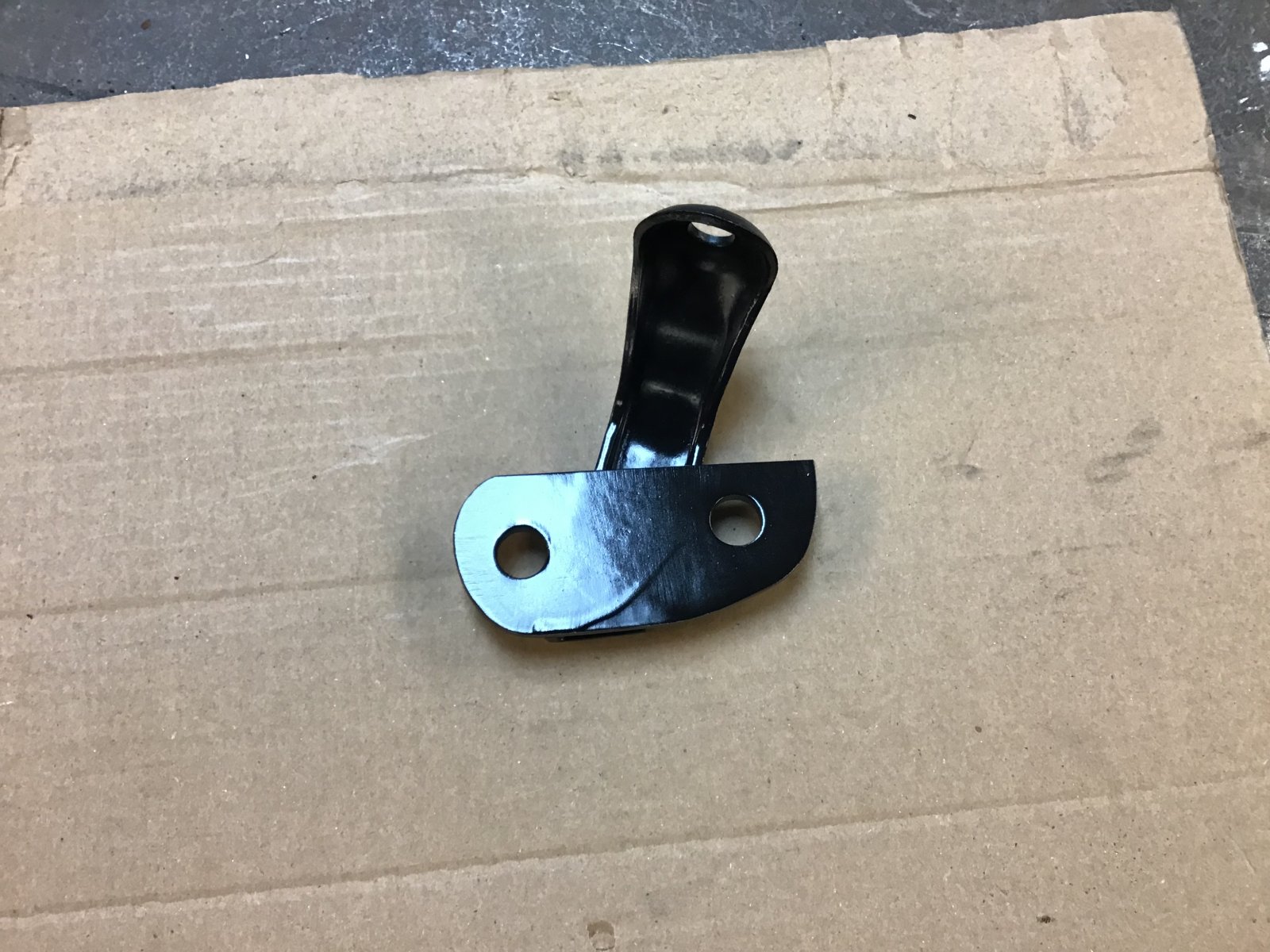

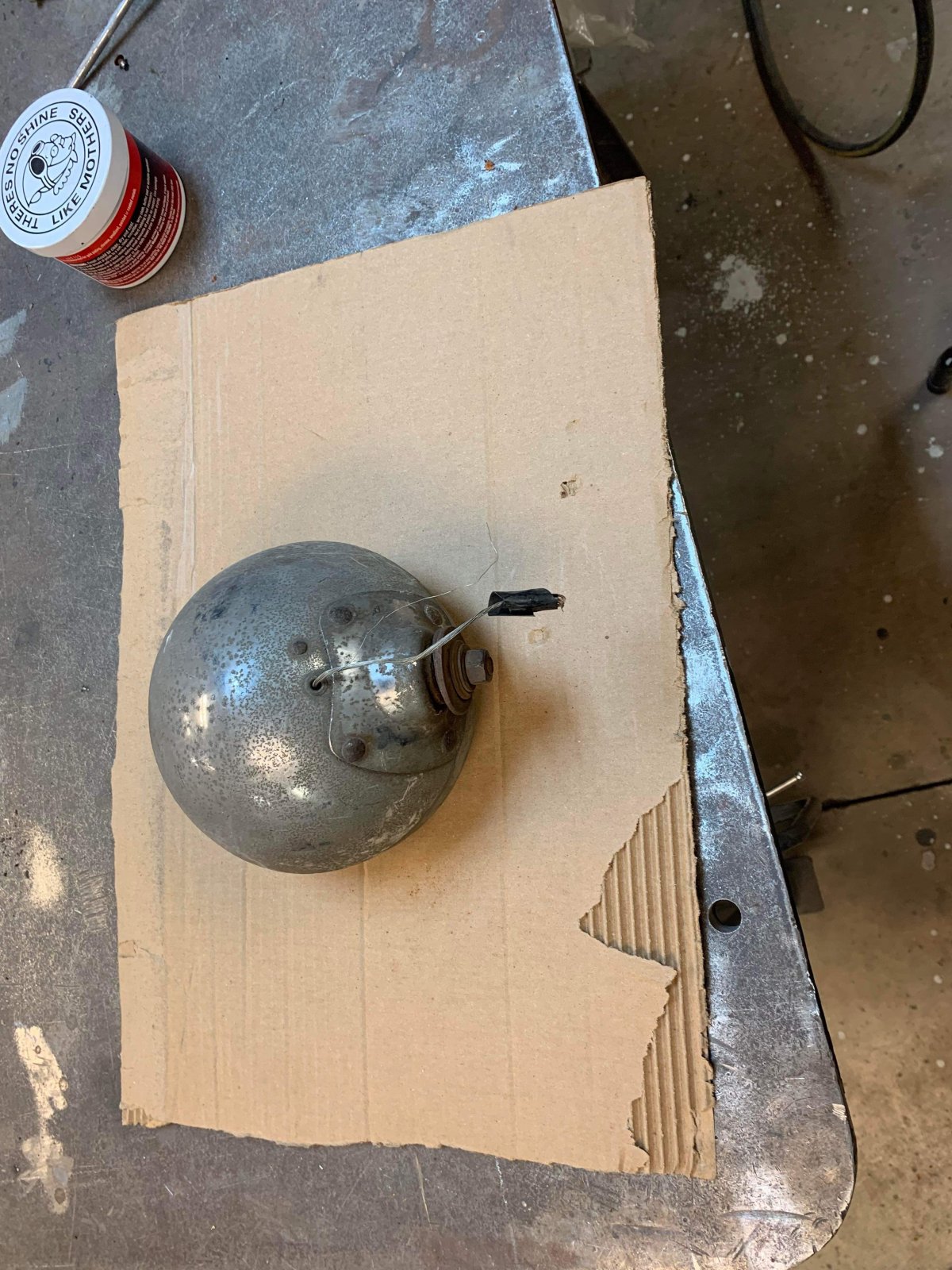

    Moving right along with the lighting part of the project I worked on making the ditch light. Took an old BLC fog lamp and got the bucket of elbow grease out and gave it a good polishing. Then a fog lamp mount was modified to work on the frame 70D1EE10-6943-447F-A2ED-55A9273453C9.jpeg C7626EDE-67EB-4AED-BC8B-6D9A5500BEE5.jpeg BA57C5E5-E29B-4542-B56A-BB537C8B2DFB.jpeg 654FF492-6AEE-456A-A93C-EEDF1E30CFCC.jpeg FE78A3C0-1603-4A3C-AAFF-18DC6A43182E.jpeg 32909B65-9D87-4B58-A7EA-8A6EA2224C42.jpeg A33658DD-3208-422A-B47B-3DD27F247FBD.jpeg

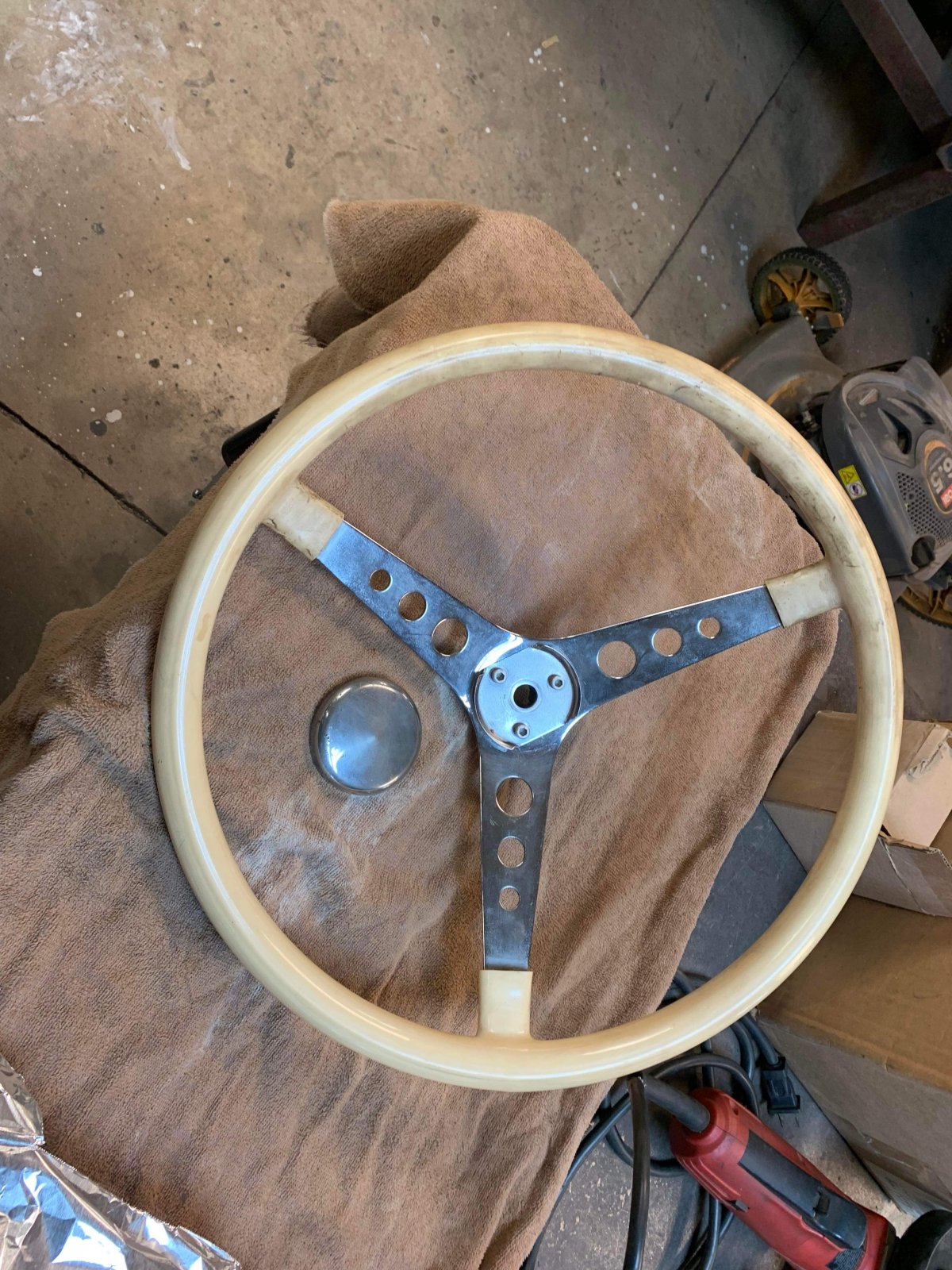

    Mr cheater

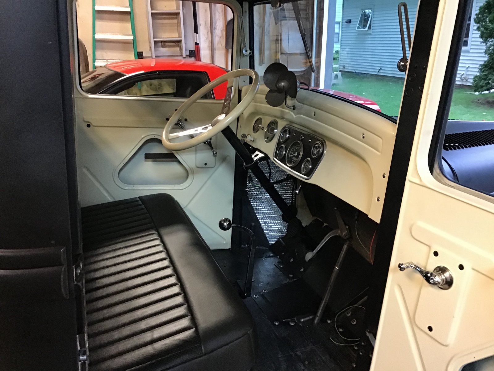

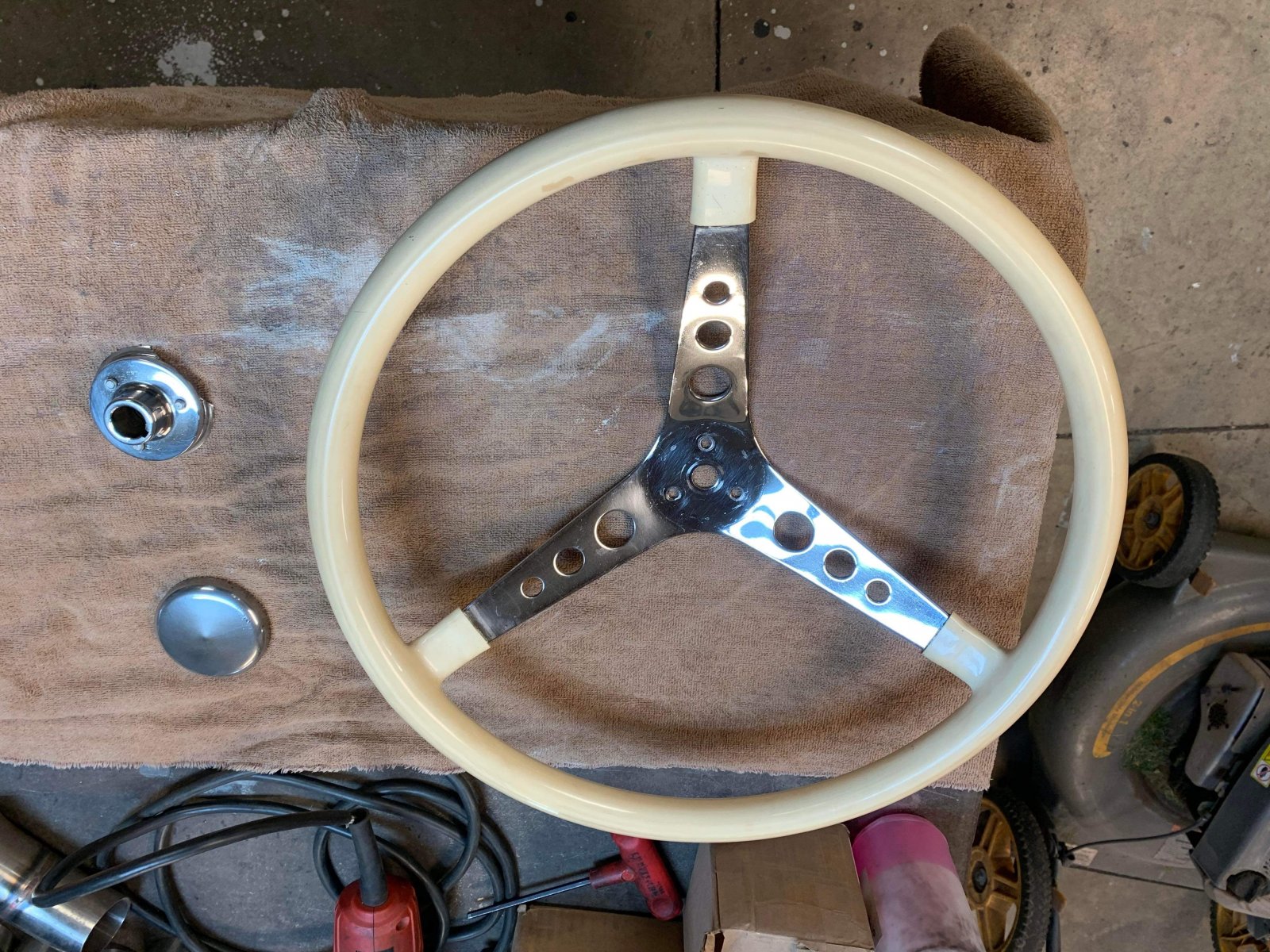

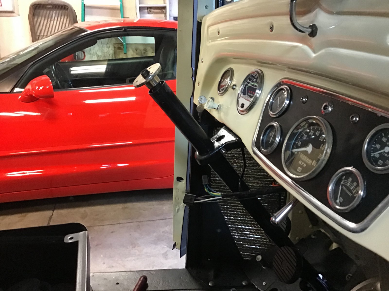

    Another good day in the shop today got the doors installed with the hinge pins and check straps. Got my Covico steering wheel cleaned up and mounted.got the seat set in and got my shifter knob put on 3554B5ED-EB87-4391-B2D9-93C4AD04D456.jpeg 11488CFD-E325-4A1A-AEAC-C1B34E678B11.jpeg 0A778882-49A9-4CD7-9E91-B486051EDB3A.jpeg 3D062407-9969-4F48-B408-A13235F2E932.jpeg C90DBEE7-581E-4E6A-9FA6-D9B2DF26AB0E.jpeg 82A2120C-B01A-40F9-B540-65B663F97B78.jpeg E9A02F72-BC2E-4749-A693-192647ED1C49.jpeg

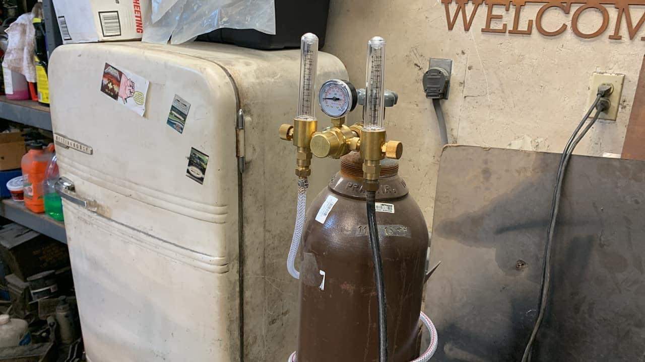

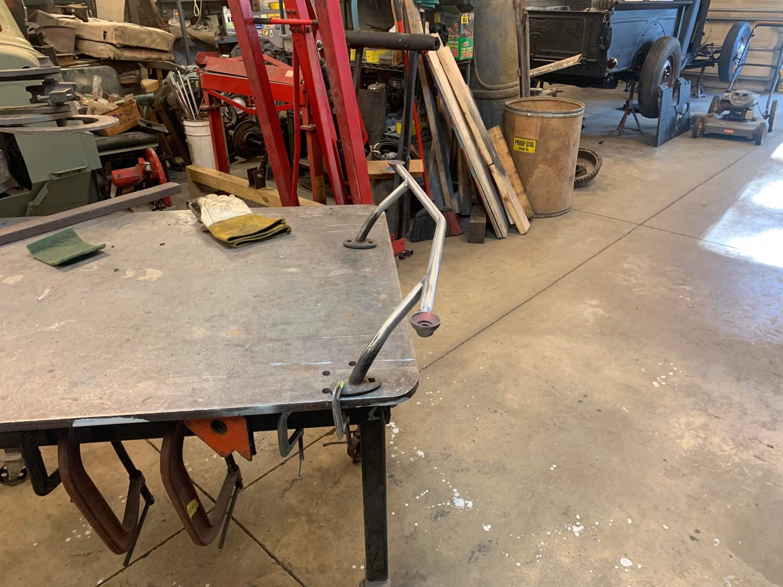

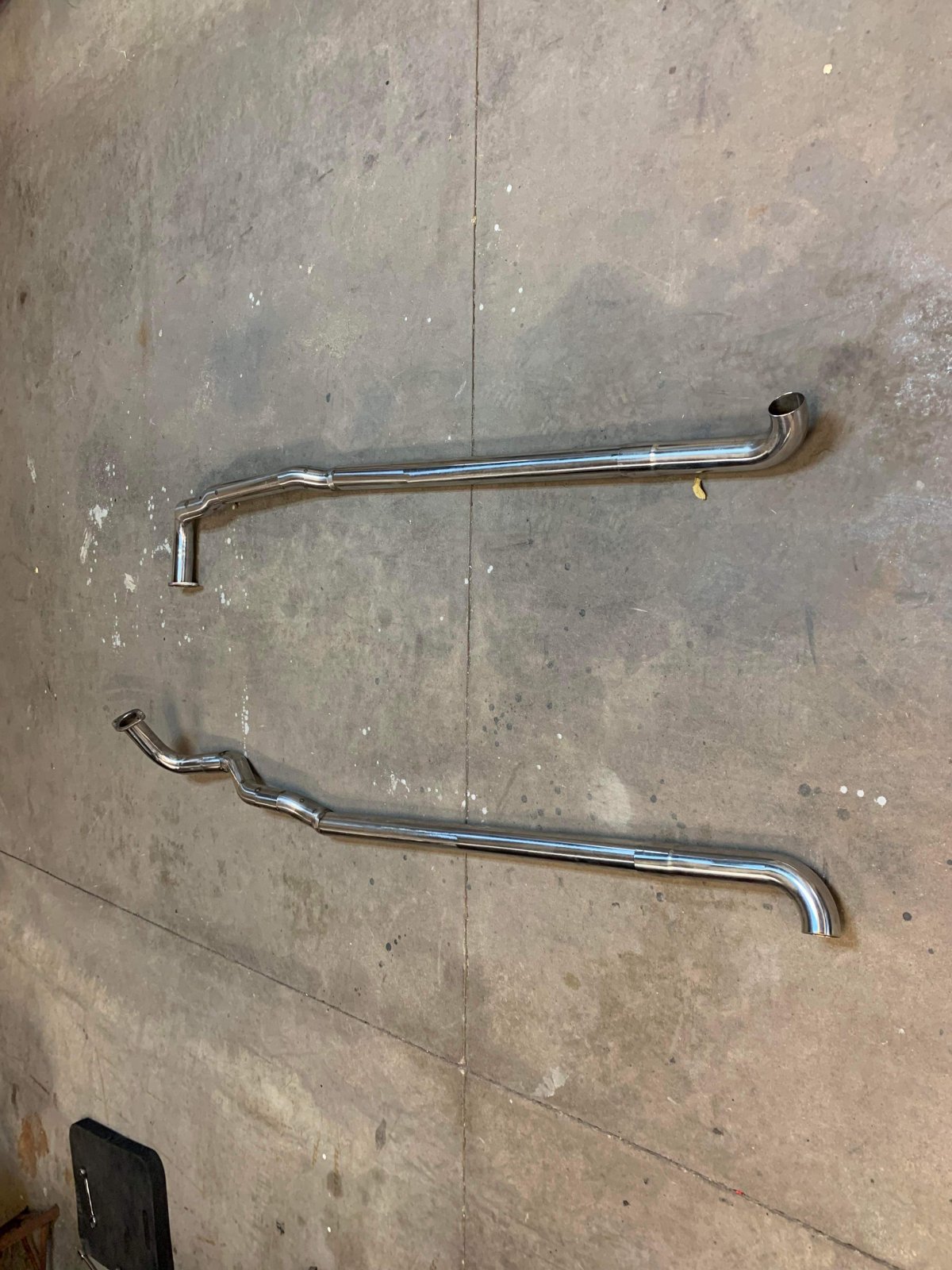

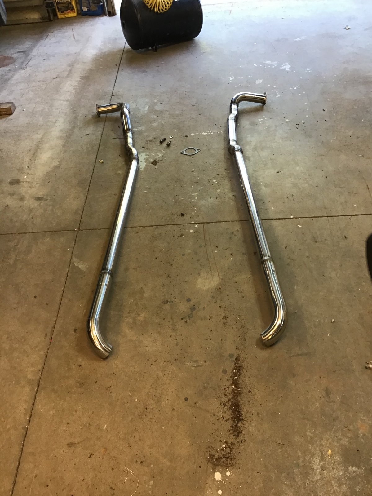

    Mr cheater

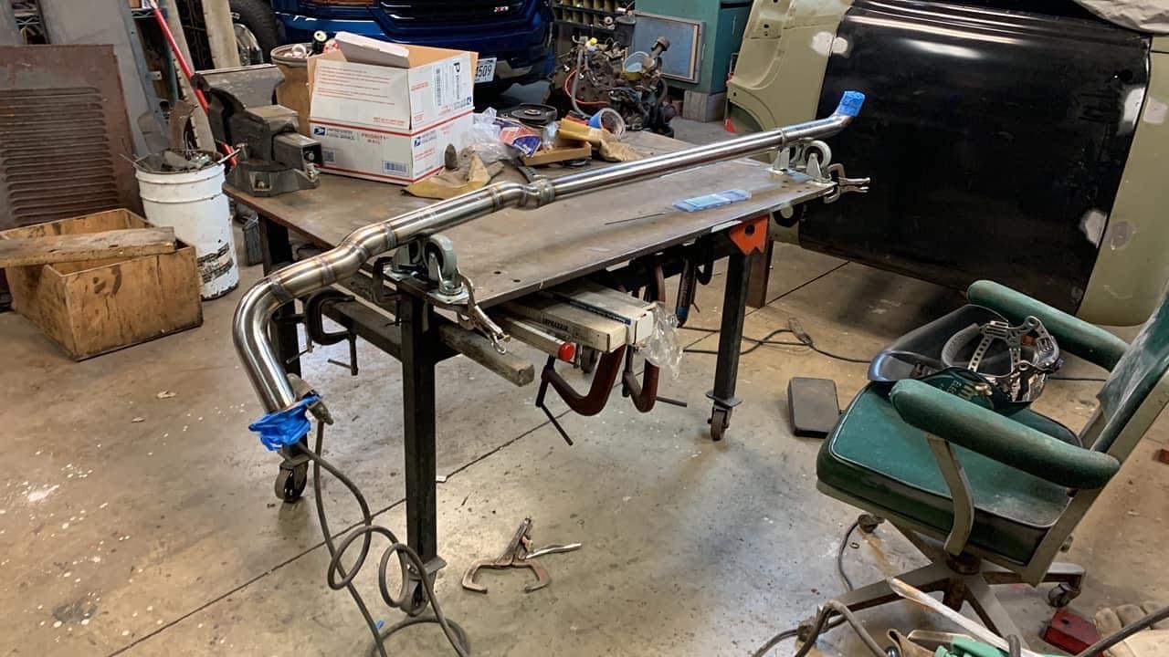

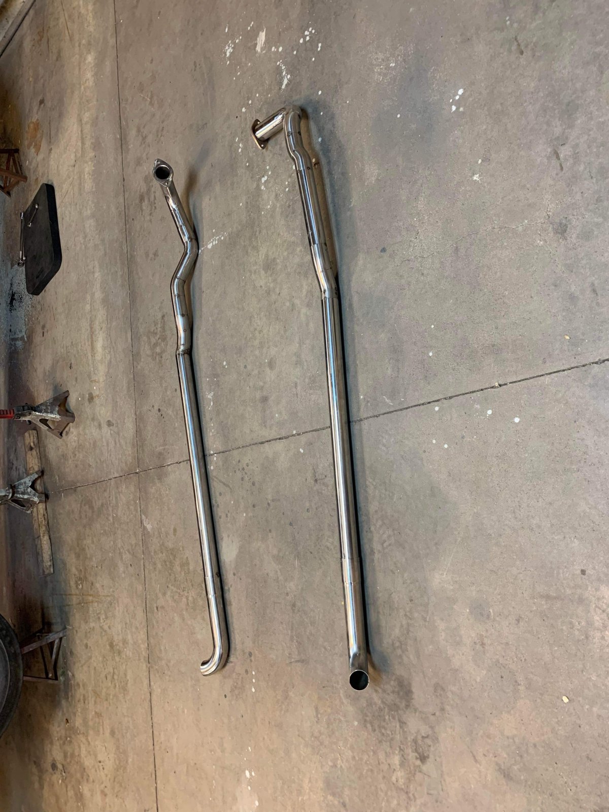

    Many moons ago I bought some stainless steel bends from a vendor at the Jefferson swap meet this was my time to put them to use building an exhaust system and doing some back purged stainless steel welding E3C52035-855F-4D61-A1F8-2C97A241F680.jpeg E6C49CBF-A669-405C-9347-4E4ECC28CCE5.jpeg 1F1CC5BC-B281-445F-8251-85492F76A9DB.jpeg EE9CB073-C31A-4587-B65A-C245D6BBF7B9.jpeg DBBFDD44-BCB1-49CA-B039-0FCB12B1ED1C.jpeg F0F9A847-21C9-476F-8325-2935D9A2059C.jpeg

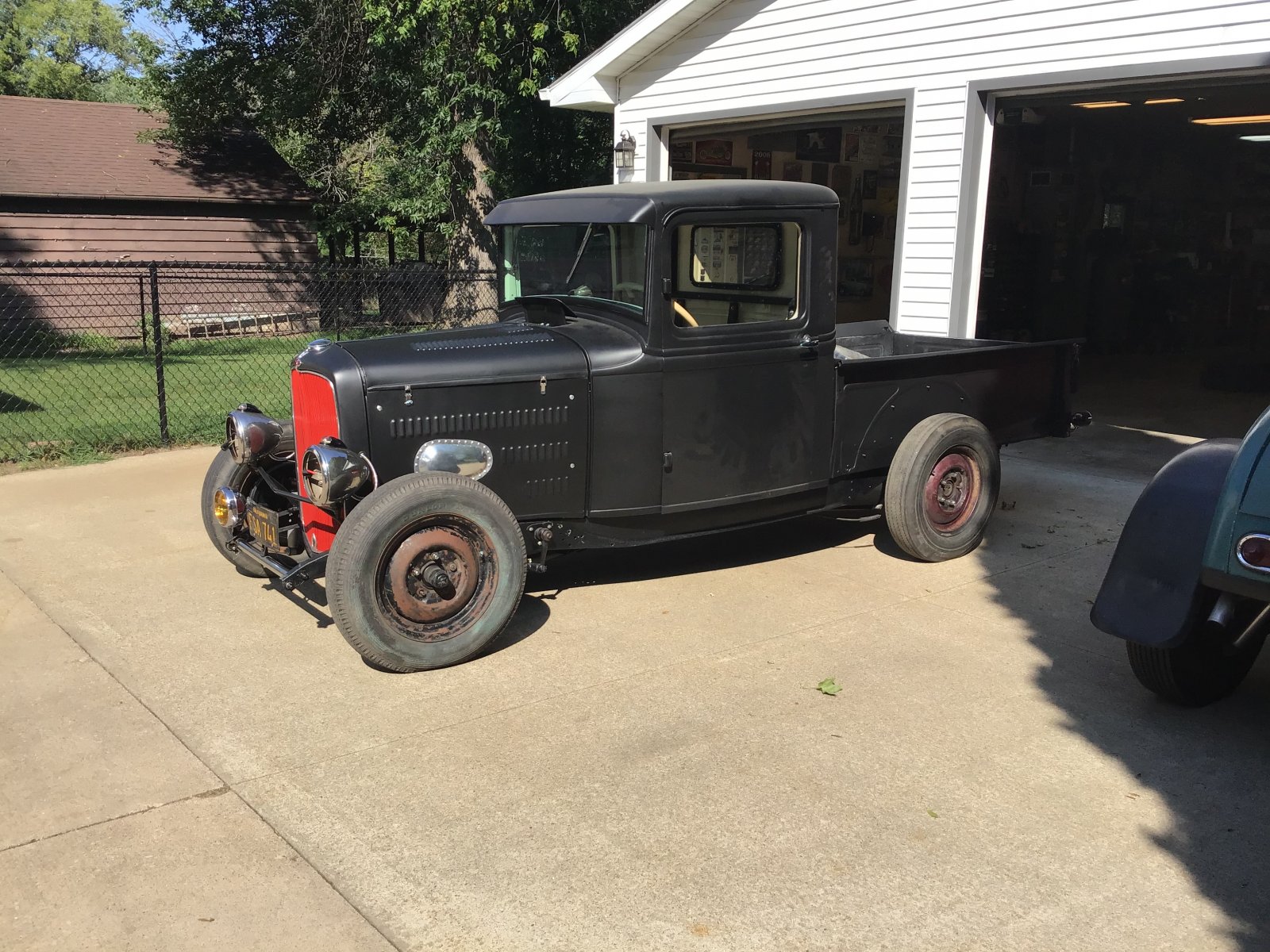

    Mr cheater

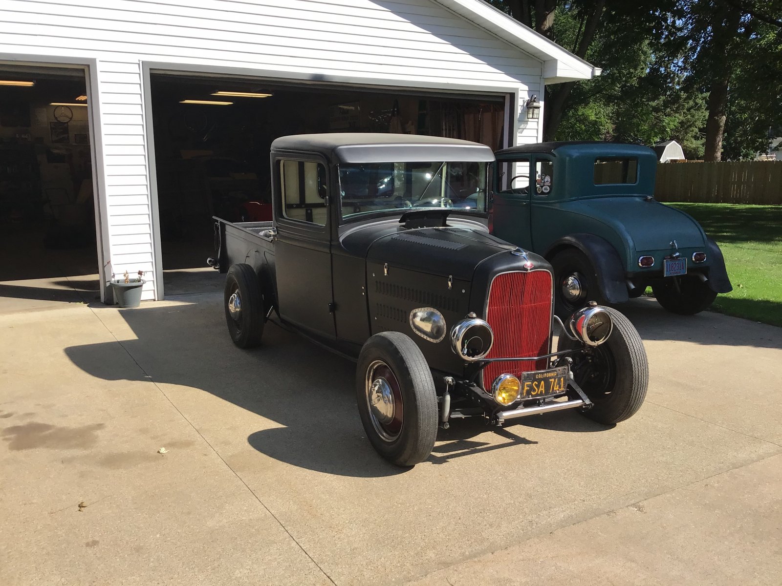

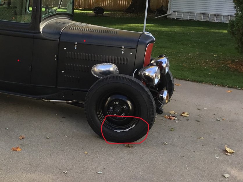

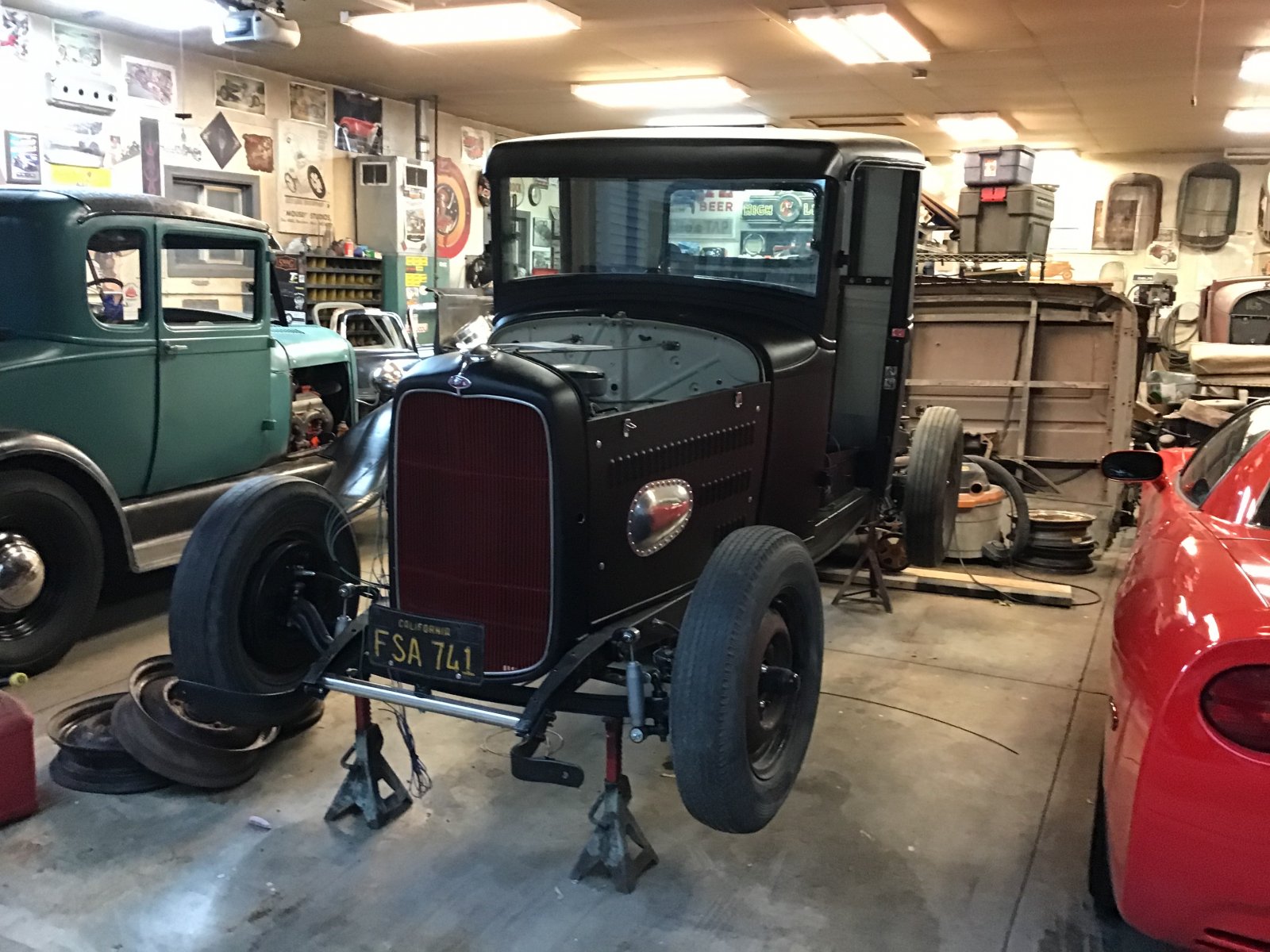

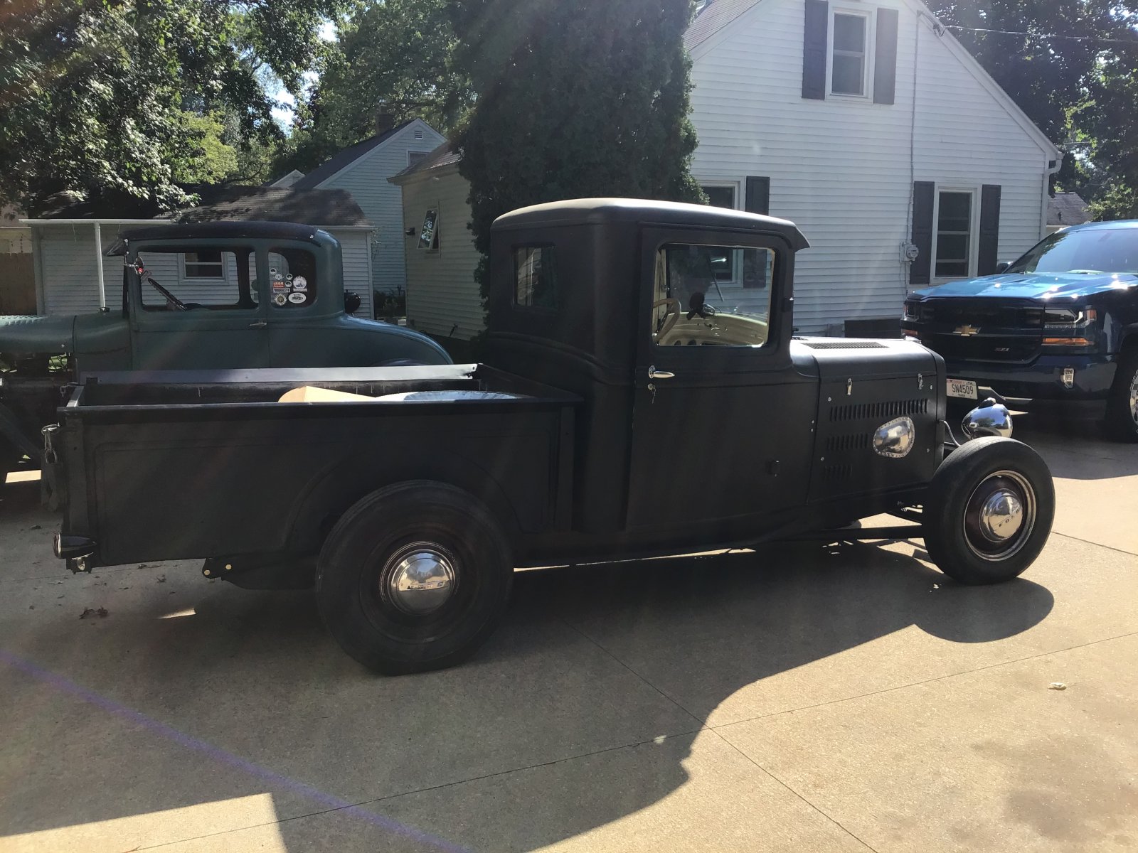

    Got the wheels back from powder coating and got those mounted and put on. Thinking it’s going to need hub caps. I went with 600-16 on the front and 650-16 on the rear 8A11A972-070E-46B5-A8E3-A84EEE3E48AE.jpeg 35FC1BF7-9B5C-4ADE-9AC2-112DE9EFF9BB.jpeg 959055FA-B412-4298-B9B7-F680D0D25D5E.jpeg

    I love your exhaust, beautiful ... and I love the wheels, just black is fine in my mind.

  25. loudbang
    Posts: 40,342
    Think you have enough wheel weights there Butch :) If it were mine I would be concerned.

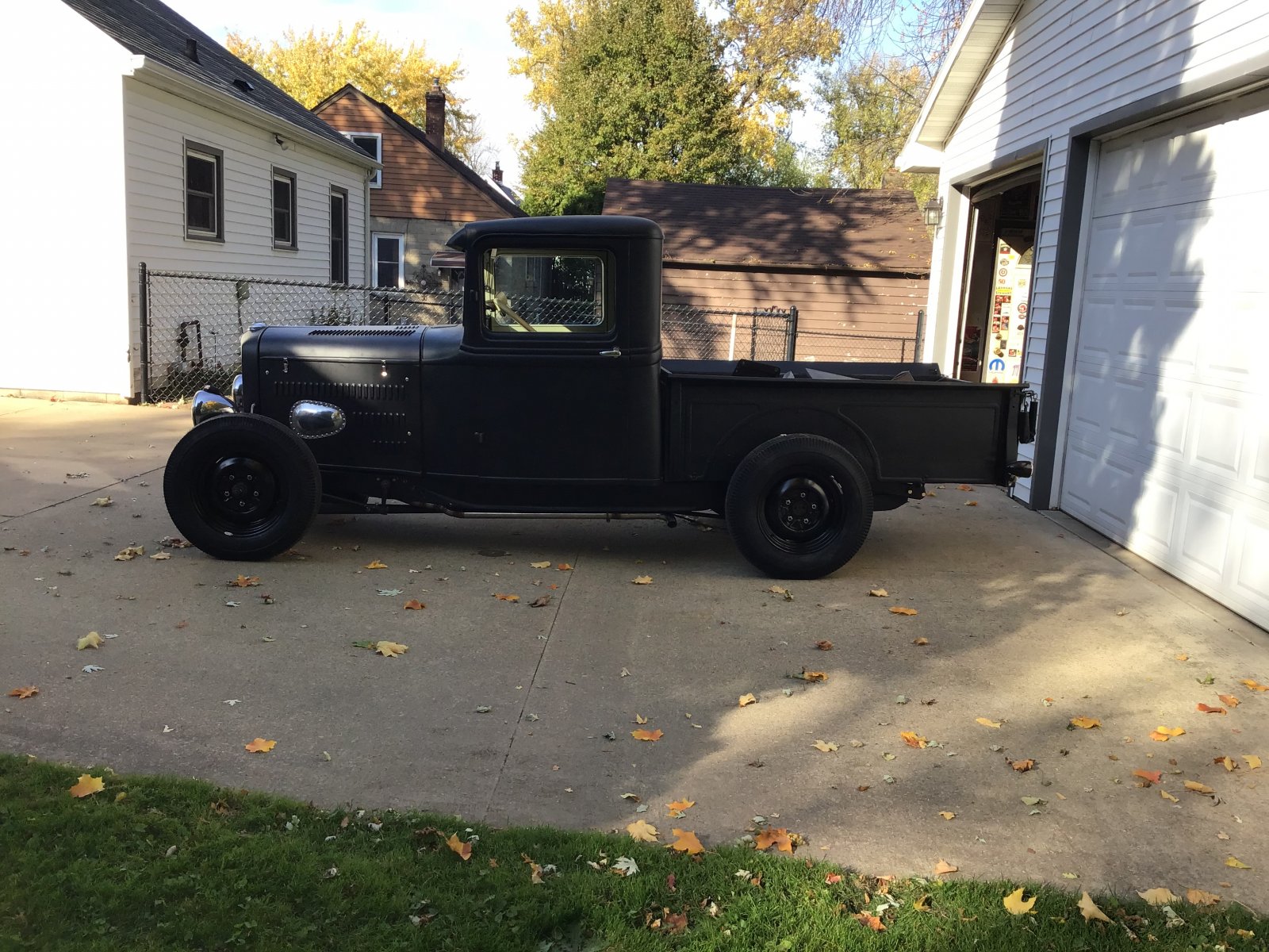

  26. Mr cheater
    Joined: Aug 18, 2010
    Posts: 642
    Mr cheater
    that’s what I’m wondering as well. Any suggestions
  27. 1935ply
    Joined: Oct 21, 2007
    Posts: 295
    1935ply
    from peyton,co
    1. H.A.M.B. Chapel
    Try turning the tire 180 degrees, if it takes the same weight at that position, I would think the tire is the problem.
    Mr cheater and loudbang like this.

  29. Squablow
    Joined: Apr 26, 2005
    Posts: 18,243
    Squablow
    Lookin' real nice! Hub caps for sure. I agree it might be a good idea to deflate the tire, mark it and spin it 180 degrees and see where the balancing lands. Maybe I've been lucky, but I've successfully cut way down on wheel weights before by trying the tire on the rim in different positions. If the weights just follow that spot on the tire no matter what position they're in, it could be a tire issue. If they stay on that part of the wheel, it could be a wheel issue. If they move around, usually you can find a sweet spot where they mostly cancel each other out. I've also had where the tire doesn't seat on the bead perfectly square the first time, and breaking the bead and re-inflating sometimes will fix it with way less weights necessary.
