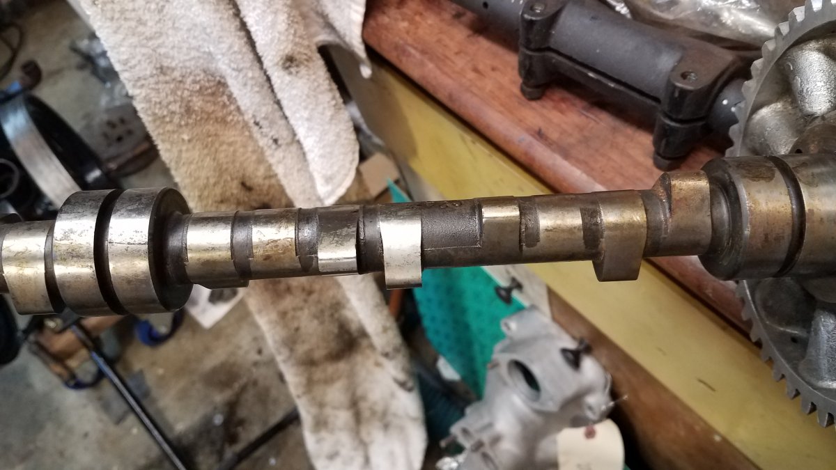

    The issues I have run into with the engine now is main caps.
    The engine I have was originally built by Amocat in the Seattle area around 2007 or 2008 for a nice prewar ’29 Roadster. The engine was never completed and then robbed for parts to get another Nice LB together for a show deadline. After Amocat closed, the engine went to a friend of mine and sat in his shop for 10 years. In that decade…..the already checked and line-bored main caps have vanished.
    I bought another set of caps and took the whole mess to my machine shop. They told me the caps I bought are off just enough to make them not useable.
    I ultimately need to find the mains for this particular block (they have yet to surface), but I’m also trying to find a few more set of caps so that I can take a box full to the machine shop and say ‘Here…..find a set that fits” as a backup.
    I have three sets as we speak, but would like to scrounge up a few more. Anyone in HAMB land holding?
    Late-1936 to early-1938 21-stud with 2.399” insert main bearing caps.
    I of course don’t need to keep all these sets, I just need enough stock to find a good set and return the rest…and square up on the set I need.
    I also need an early 21A cam, so I can have it reground as a Winfield 3/4…..unless someone has an original early flathead Winfield ¾ !

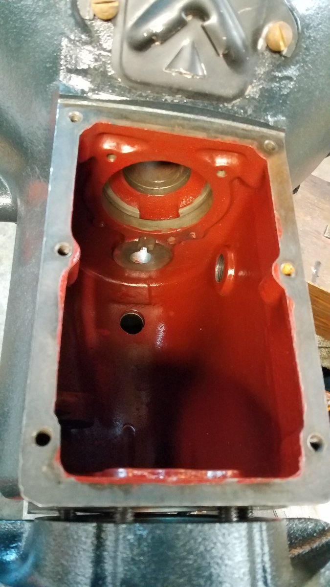

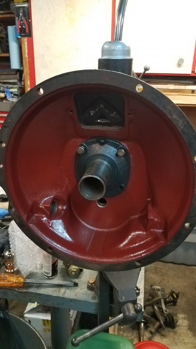

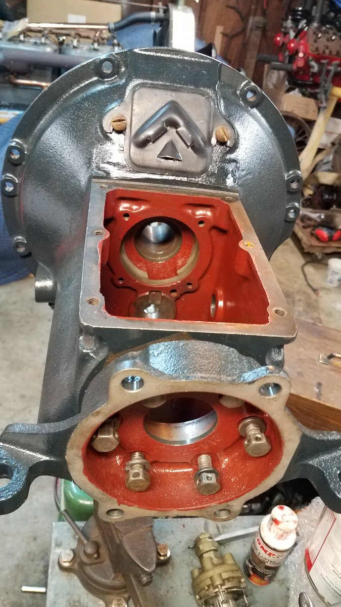

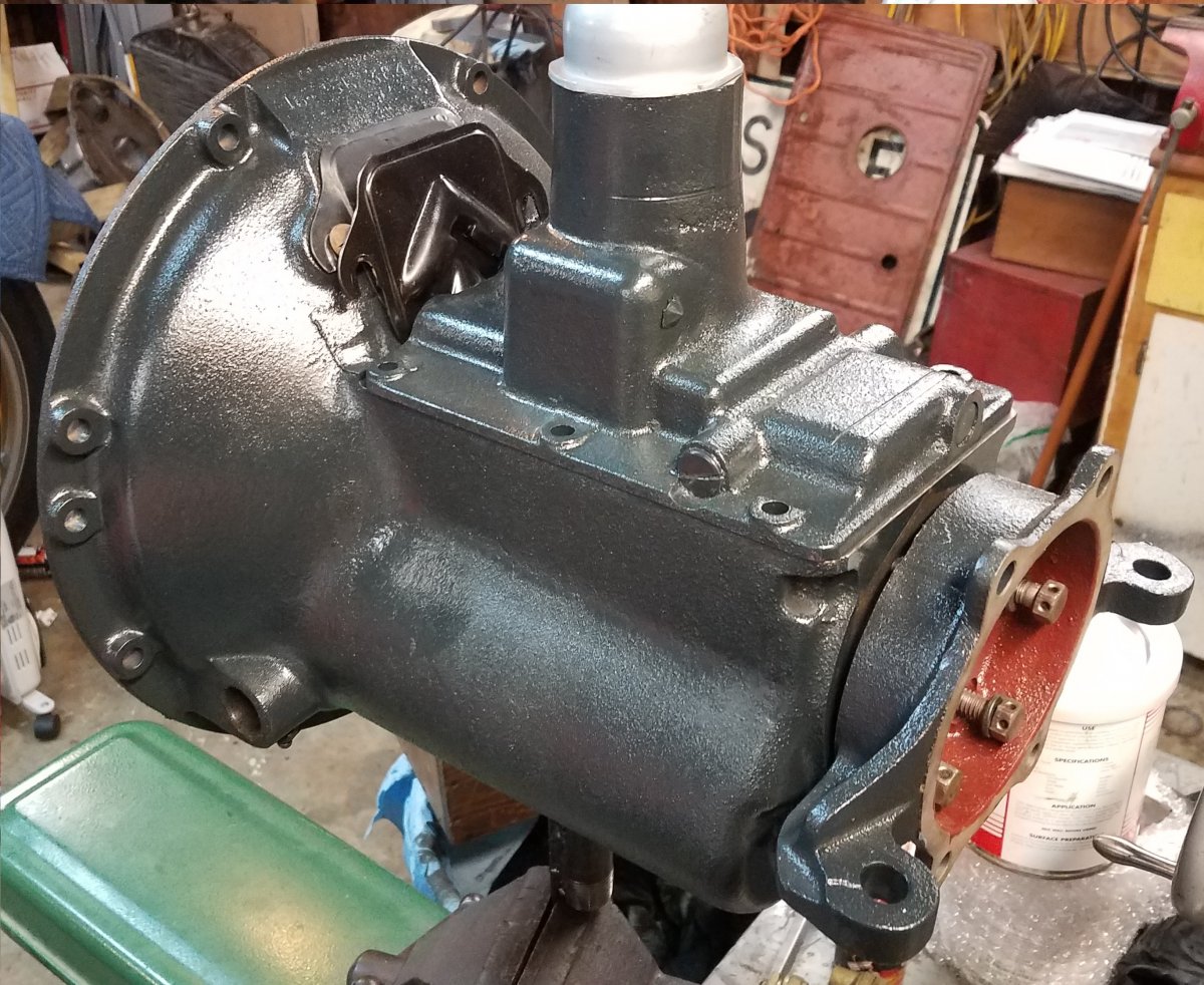

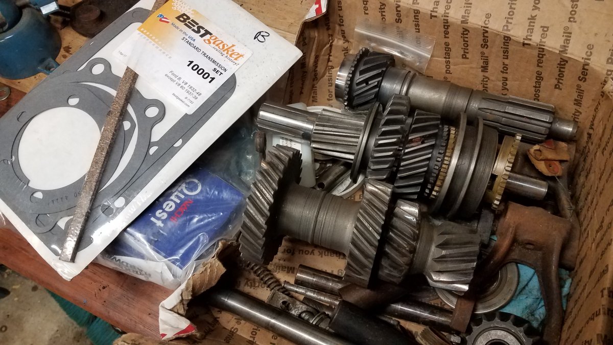

    Weekly Update!
    Not a hell of a lot to report this week, but I did get some work done on the transmission. I got the case painted up in old Ford Green..
    And I got the inside coated with Glyptal.
    I also have my gear sets all ready to go and received my parts order of bearings, small parts, snap rings and bushings from VanPelts.
    Now, time to ***emble! I have a few of these boxes to do, so I’m gonna do them all on the same weekend. I will do a big post on the ***embly process when we get to it.
    Stay tuned!
    ~ Mr. Model T

    What is the red you used on the inside? Anything special?
  12. Glyptal
  13. MrModelT
    Joined: Nov 11, 2008
    Posts: 2,745
    MrModelT
    Glyptal. its a oil resistant protective coating for cast parts....commonly used on engines, transmissions and rear axles.
    ~ Mr. Model T

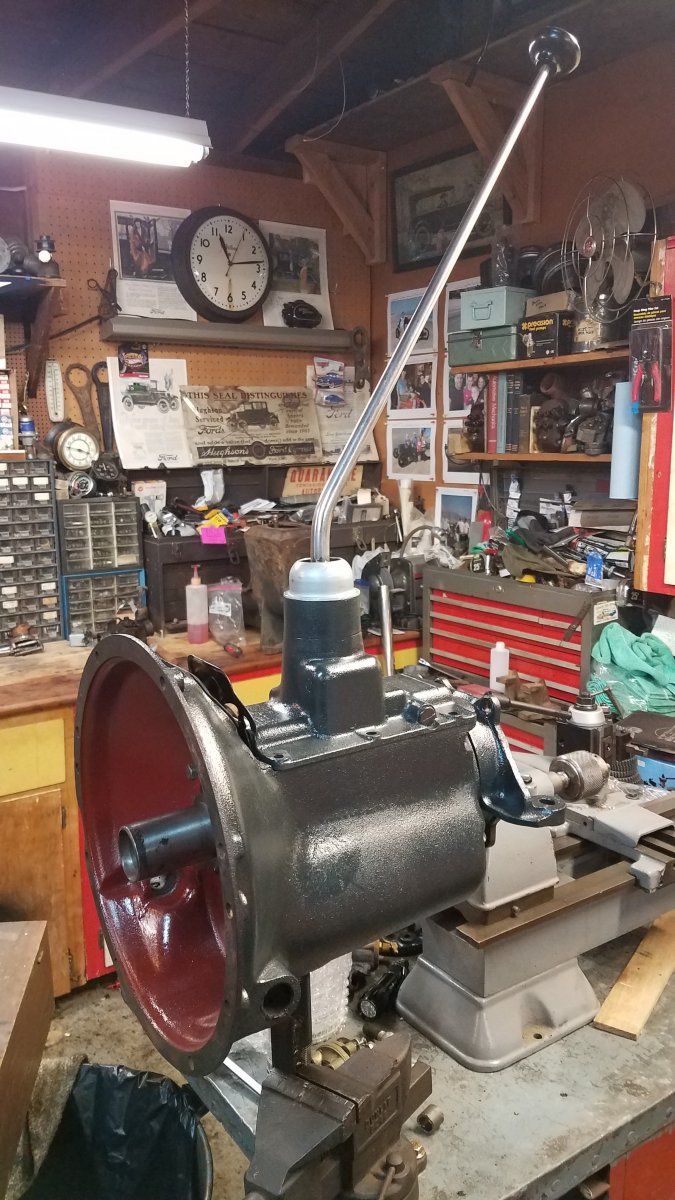

  14. brsturges
    Joined: Oct 22, 2008
    Posts: 1,052
    brsturges
    from Miami, FL
    Trans case looks great! I'm interested in the mount you have rigged up in the vice. Trying to figure it out but can't see the other side. Looks handy for transmission work.
  15. MrModelT
    Posts: 2,745
    MrModelT
    Its a piece of 1" Steel plumbing pipe (about 8" long) welded to a piece of 2"x2" steel angle (about 12" long). Its a concept I barrowed from Vern Tardel...works great! I'll get some better pics tonight.

  25. MrModelT
    Posts: 2,745
    MrModelT
    That said, I do have some minor updates.
    I made a trip back to the Estate where the Bronze heads came from and bought some more goodies. The prices were right and it was a smart move. Here is what I picked up:
    Another good '39 trans..
    a few intakes...
    the Kingpin set I needed..
    A mystery .317" lift cam...
    Chromed '37-'41 Axle...
    A pair of Holthouse Coils..
    I also scored this NOS Lucas Flathead Magneto..
    Some of this stuff will probably go away to finance the project.
    The one thing I plan to keep however is this.....a 1940-'41 Lincoln Zephyr transmission.
    I cracked it open to find a really nice box.......except for a single broken tooth on the cluster gear.... :mad:
    So now I'm on the hunt for a replacement Cluster Gear. The ratio is the 26-22-18-14....anyone holding?
    More later,
    ~ Mr. Model T.
    ClarkH, Stogy, brad2v and 5 others like this.
