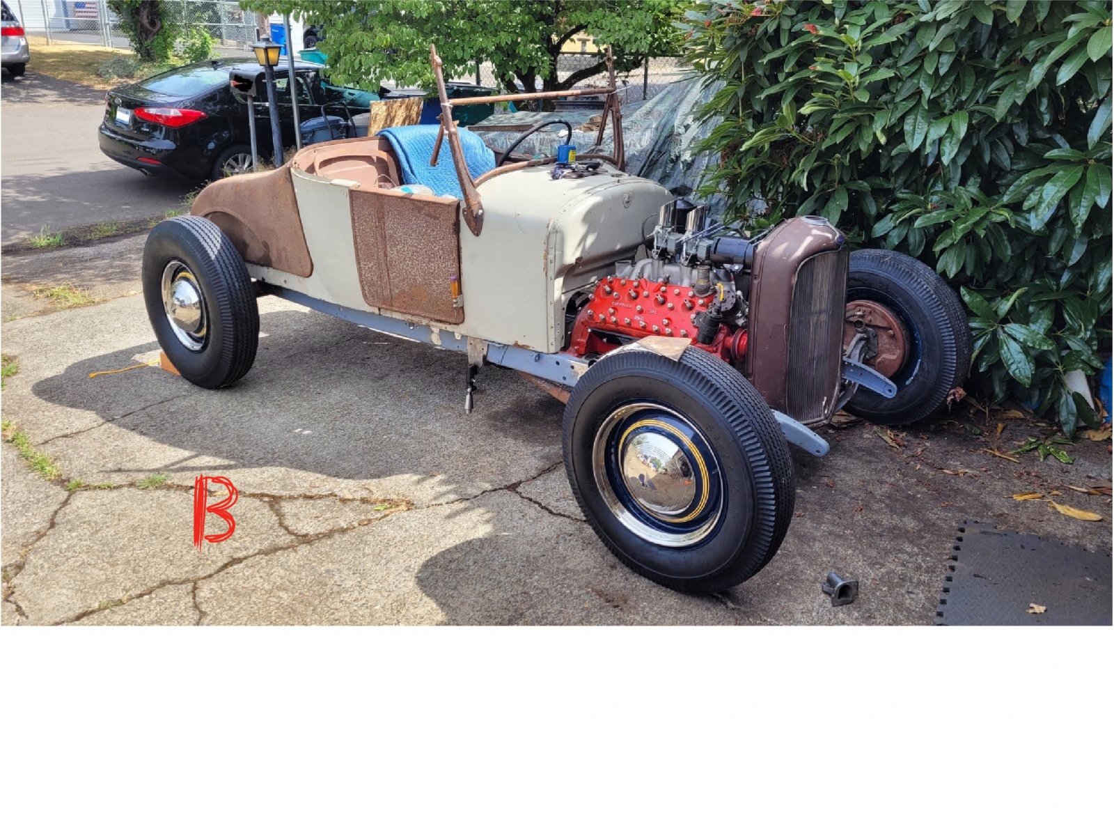

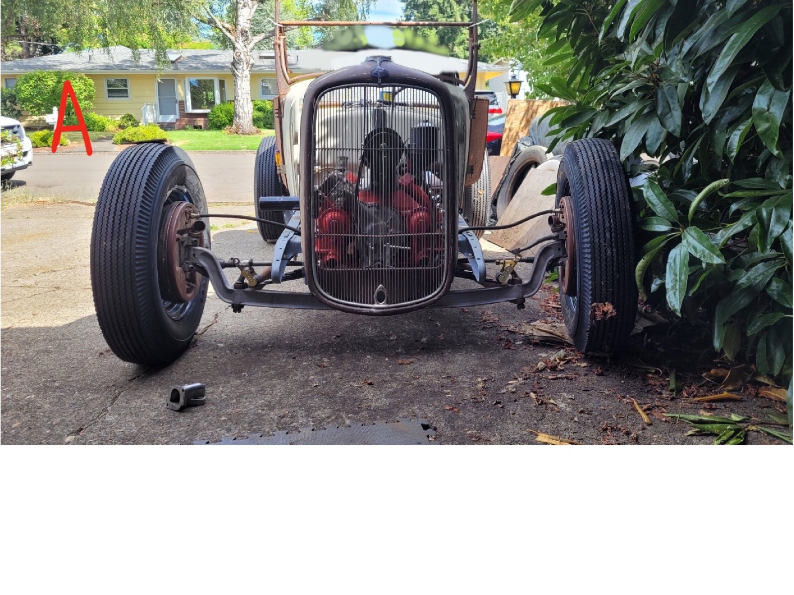

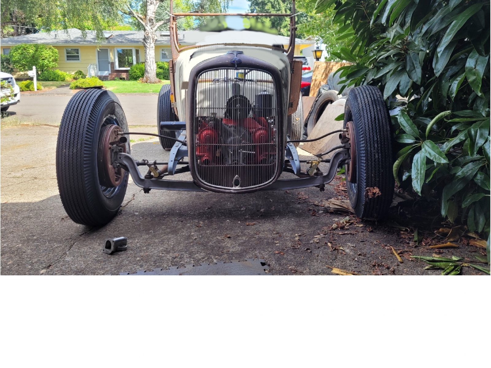

  3. What about splitting the difference between A and B (do half the chop)?

  5. MrModelT
    Joined: Nov 11, 2008
    Posts: 2,745
    MrModelT
    I think so too. More lower, less chop...but do both.

    Joined: Oct 1, 2015

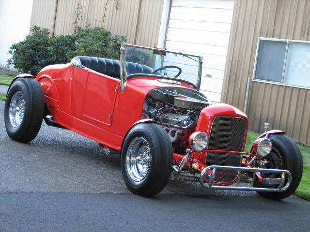

  11. I don't like 32 shells on T's, but this ain't bad.
    A Boner, Spooky, rod1 and 3 others like this.

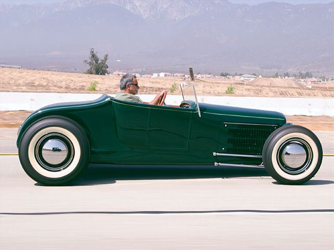

  12. MrModelT
    Posts: 2,745
    MrModelT
    I'm not a huge fan of a downward angle on the radiator support rods. To me, it just looks too stark, like the American Graffiti coupe (I know, its sacrilege to criticize that car, but i have always had an issue with that, lol). I will agree that too level with the cowl does make it look too tall. There is "Just the right amount of level".. lol

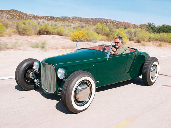

    I was digging a bit last night through my archives of Hot Rod stuff looking for this, the Keith Tardel built '27 Roadster:
    This car excellently employs a '32 shell with a '27 body. Yes, its on a '32 Ch***is, but I think that is a tad irrelevant for this exercise.

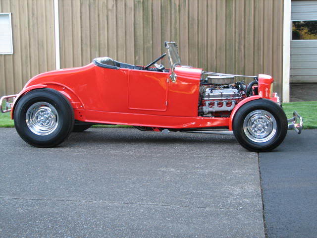

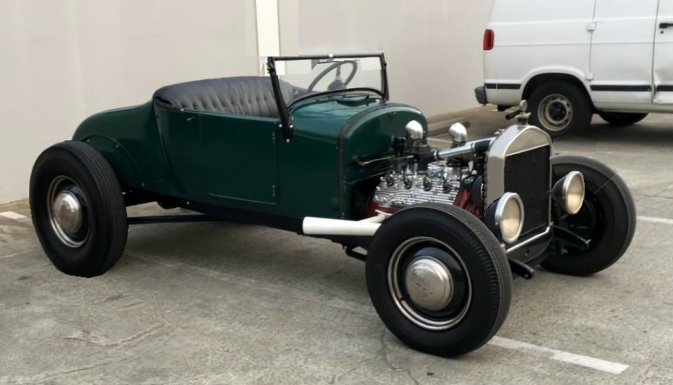

    The other option would be to go with a '28-'29 Shell instead, like Dennis Lacy's old T:

    The Tardel Roadster is also a major influance on the current '27 build..
    Spooky, brEad, OFT and 3 others like this.

    FWIW. My two cents is this, The "chopped & dropped" photoshop was the most proportionate out of the 32 grille shell ideas. I also like the 28/29 shell like the Denis Lacy example...

    The Tardel build looks good but once again from some angles it looks a tiny bit tall. From other angles it's fine. That may just be the way it is and you just have to for the best you can. You can't see it from more than one angle at a time. I like all the A shells on As. I usually like T shells on Ts if they are not br***. The painted ones are best on minimal rods. Do it with the same eye you had on the other build and it will be fine.

    I love a 28-9 shell on a T. Probably my favorite. For what it’s worth I think Dennis cut his A shell. I recall him talking about it a few years ago?

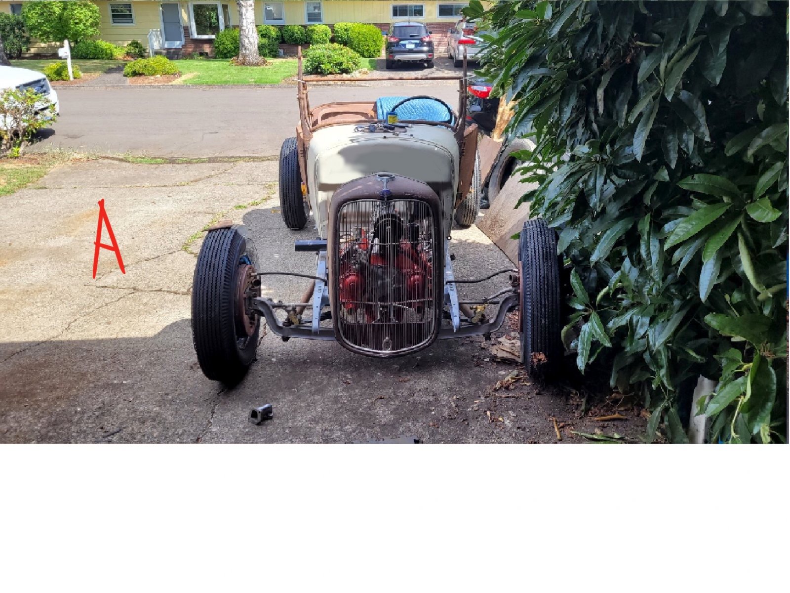

  27. flyin flattie
    Joined: Oct 13, 2005
    Posts: 602
    flyin flattie
    from Redmond OR

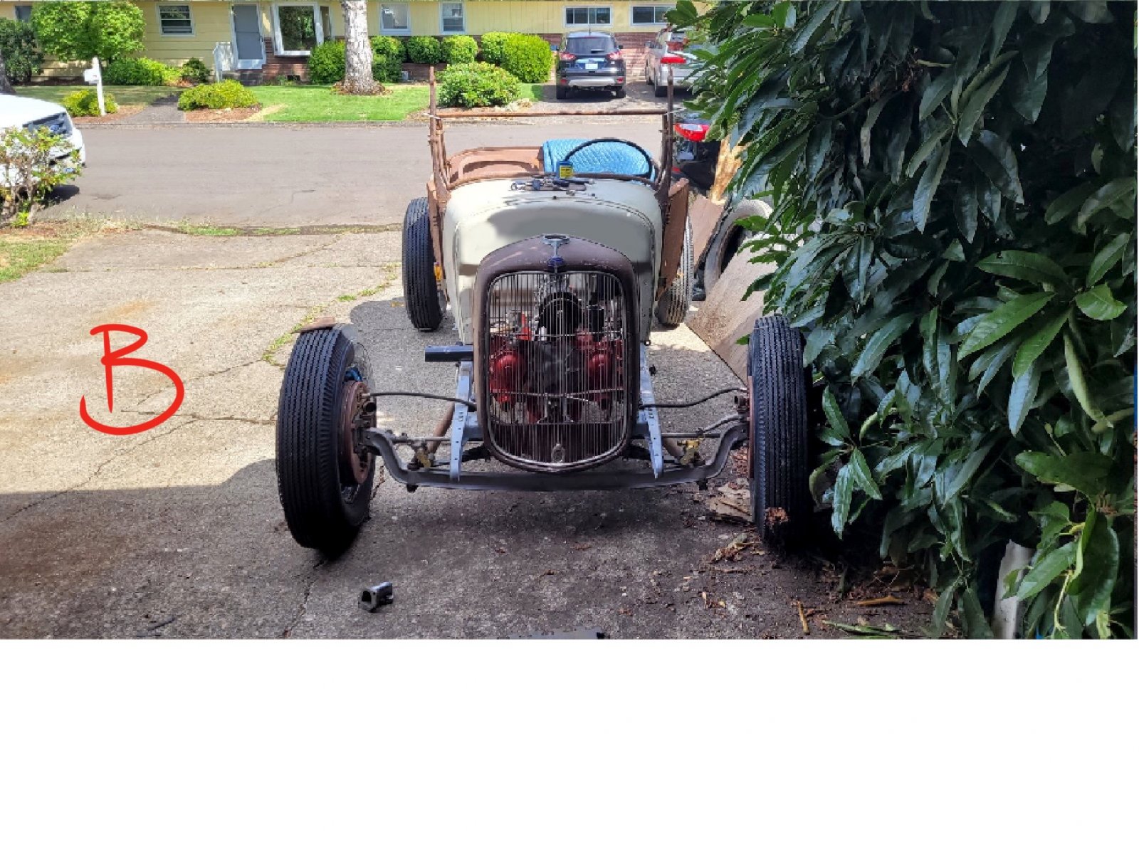

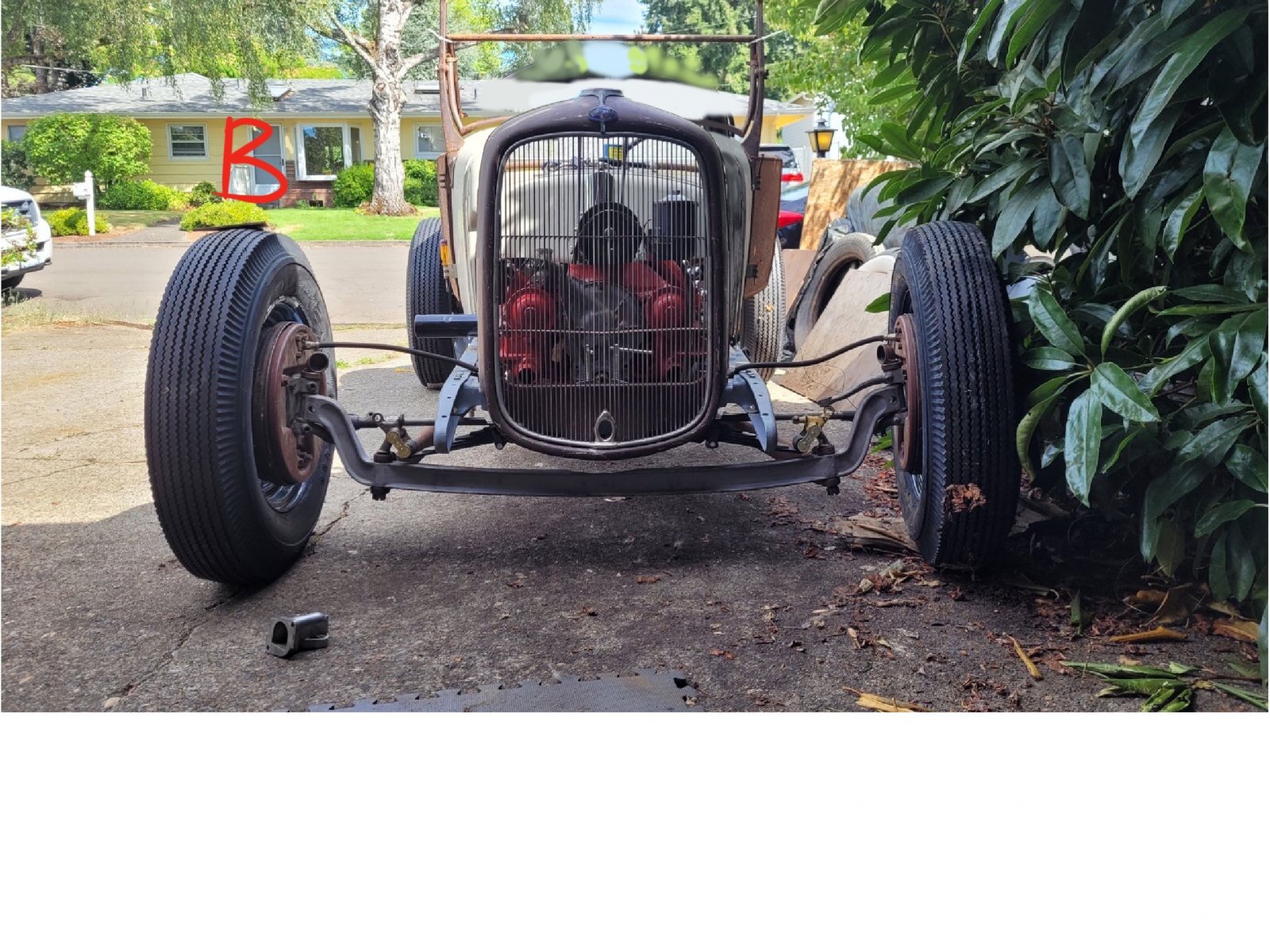

    0C086F94-485D-41F5-AE95-87FC997A1AA7.jpeg E5665F58-F923-4B7C-9A65-02020E5C7A71.jpeg I vote B I don’t care for the dropped look it’s kinda hangin low for no reason.
    Spooky, brEad, Dean Lowe and 6 others like this.
