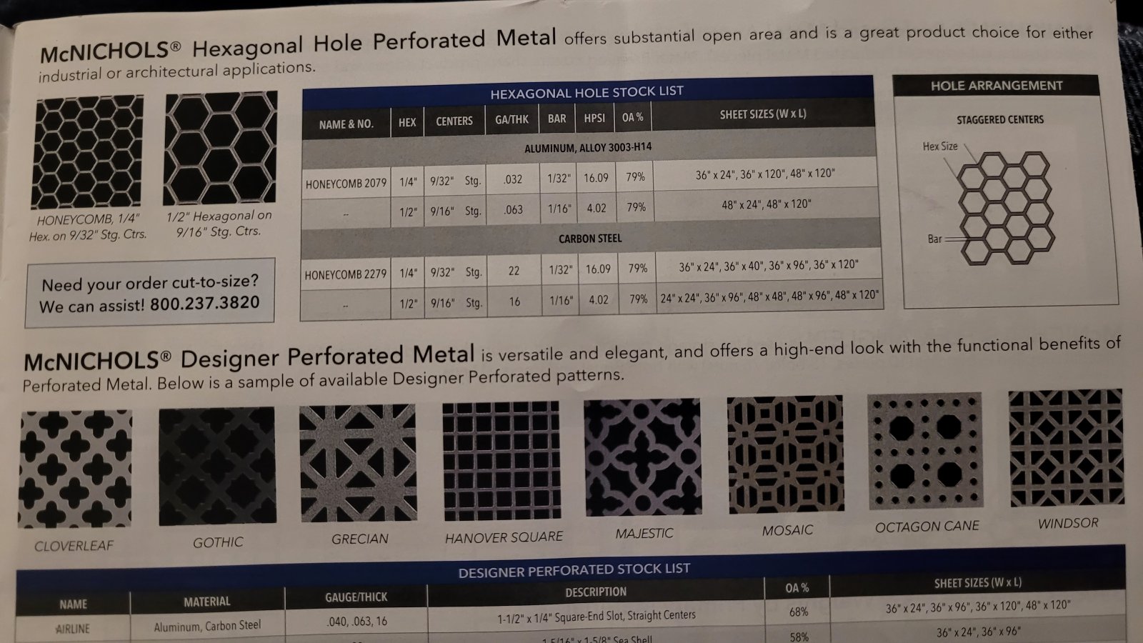

    I looked at that stuff, don't know how I feel about it yet. I would have to see it in person and with the shell.
    So this is the stuff i wanted to use originally. This is actually a great price and may have to jump on this. When i first found this stuff.....I have seen it listed for $800 a sheet, which is insane.

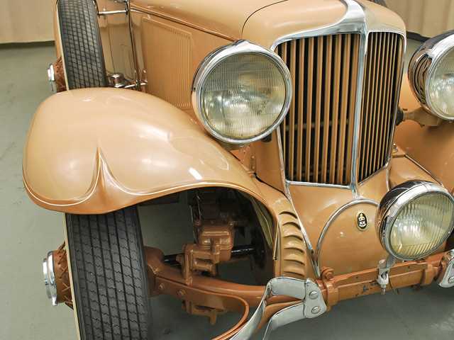

    If building an insert with the awesome grille you have that I’m jealous and in love with. I’d try to get as close to another beautifully designed car from the era. The cord l-29. Probably run an aluminum strip down the center on the outside of the shell, nicely hand polished for a era correct sheen. Then painted grill bars within the shell itself. And doable easily at home with basic materials. 4A919FC3-DC78-472F-9BFC-B723A8234577.jpeg

    Honestly, this is sort of the way I was thinking in the beginning. The shape of this shell reminds me a lot of both the Model J Duesenberg and the the 1919 Miller "TNT Special", but is also reminiscent of the Cord L-29 for sure.
    The major issue is making the slats or shutter. I'm not rally a metal worker, so I don't really trust myself to make them well enough to look like it's almost factory. I could find an insert and alter it....but I don't know if I would be able.to find one that fits.
    I also though of cutting some slabs of old honeycomb radiator core to make an insert...but I'm not 100% on that either.
    I do agree with you 100% though...this shell deserves something special.

    I think some thin br*** half-Round straight pieces to make some false Duesenberg style louver slats might be the trick..

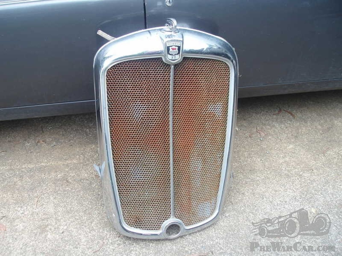

    This is probably not much help but in NZ and probably the UK there is a mid 1930s Morris rotting away under every hedge. Many of them had radiator grills fitted with fake 5/16 honeycomb insert. I bought one for a few dollars and am fitting it to my roadster which previously had br*** mess insert bought from a local hardware store. Sadly I suspect not many Morris hedges in the US - maybe the Ebay hedge. 17286a_resized.jpg 20220923_105211.jpg

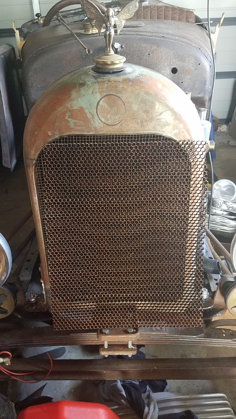

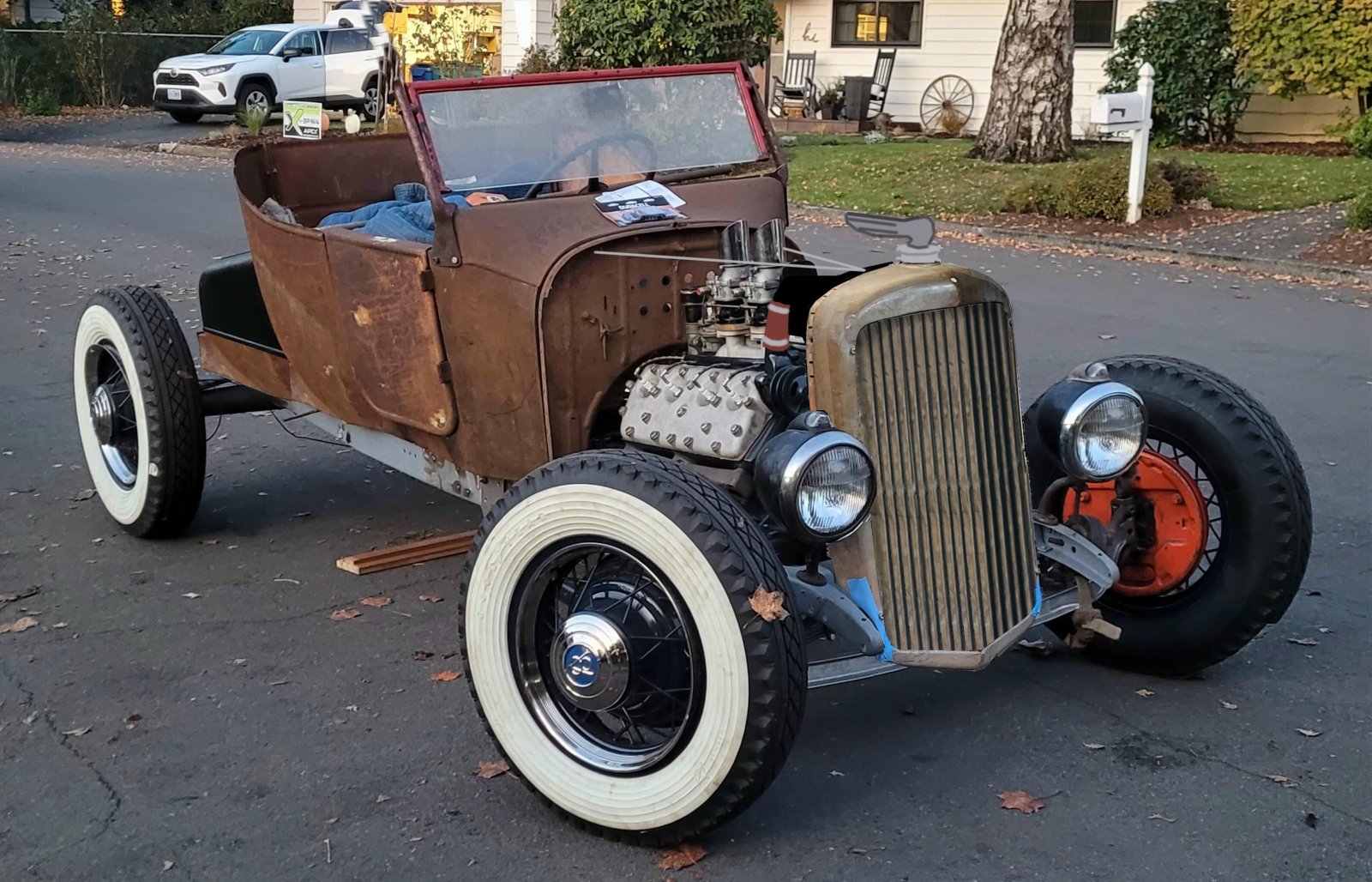

    Ultimately, this is what I had originally wanted. These panels are not big enough (Opening on mine is 18"x29"), but there has to be that is bulk sheet form..
    Ask and ye shall receive! lol. I'm gonna check this out as an option, this might be perfect.

  18. MrModelT
    Joined: Nov 11, 2008
    Posts: 2,745
    MrModelT

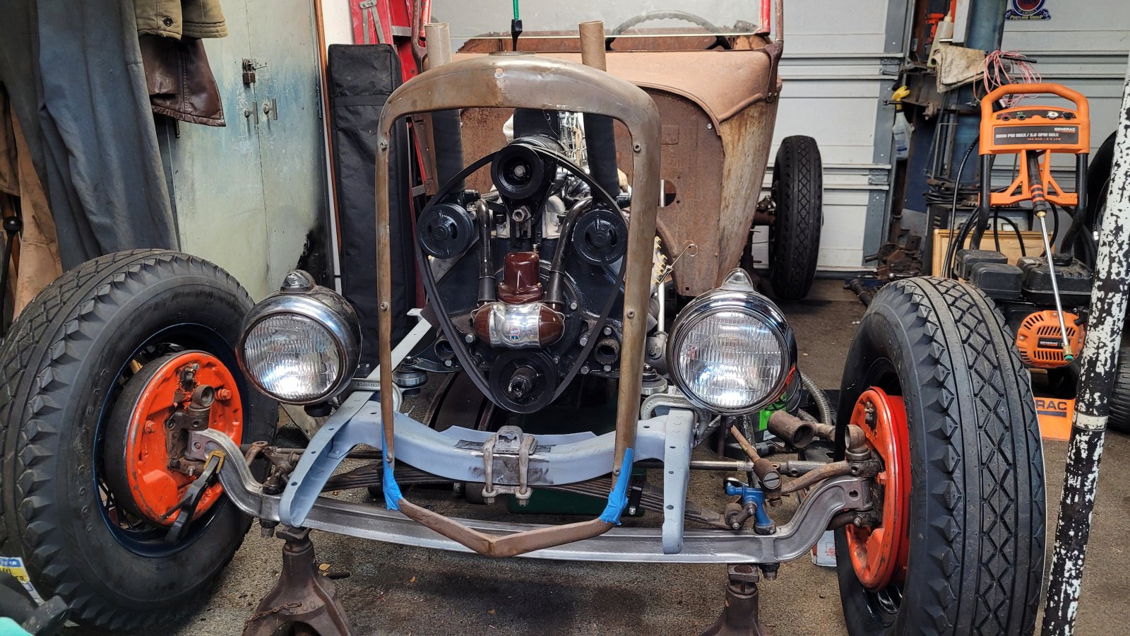

    I'll put up a larger update tomorrow, but I have been pushing forward. As for the radiator shell, I'm weighing options.
    My first choice is to order a selection of br*** oval half-round stock to build a false shutter insert similar to this Duesenberg radiator:

    I was also gifted this McNichol's Catolog in the mail that does have some great screen alternatives..

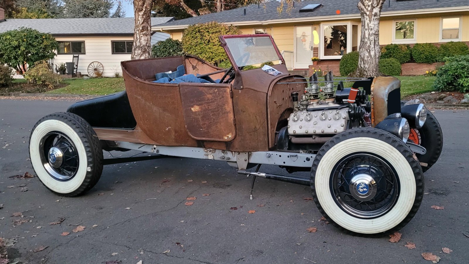

    Update: One step forward, two steps back..

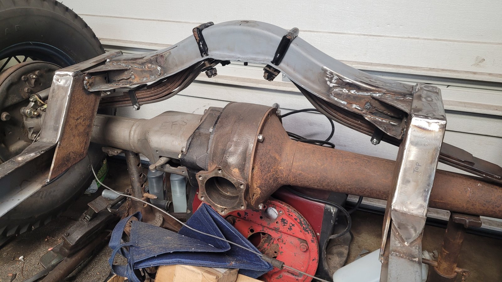

    After finishing off the rear frame pinch and the drop, I mocked up the car and realized it was WAY to high and i could never get it low enough by conventional dropping means...not without some collision in the suspension. This ment that my only solution was to take a step or two backward and do what i should done from the start: use the '26-'27 crossmember I had set aside for this in the beginning.
    I had used the early '25-earlier crossmember for two reasons: 1) it was the correct length and 2) it was already out of the frame, ready to go. The only issue is with the early ones are not as deep as the cars were taller. The later '26-'27 cars used a different crossmember with a deeper pocket and a substantially higher arch. This lowered the car about 4" more.
    I got to work on lay out and removing the one I had just put in in.
    I cut the old crossmember out the old Crossmember and left the back plates where they welded to the frame to act as a pad to weld to...
    Then got everything welded up..
    Looks like i got the stance right this time....
    More to come..
    ~ Mr. Model T

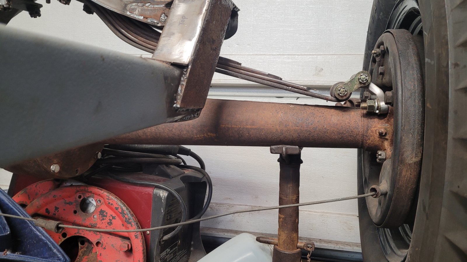

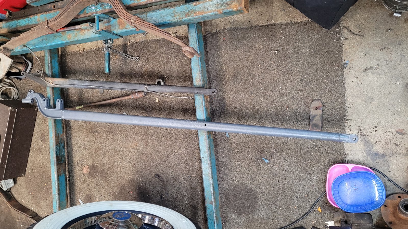

    Forgot to add I started working on wishbones and got both pairs of split '32 wishbones welded up the same day as the frame. Trimmed to length, pie-cut, tapered and welded up..
    Next are the rears. Since i have a '36 Columbia axle for this car, i had to dig up a set of '36 radius rods. Was debating on the best way to shorten them so they don't look weird. I think my plan will be to remove '36 ends and swap the tube portion from a set of '41-'48 Lincoln ones that are just about the right length for how short i need to trim the drive shaft down. Should be pretty straight forward as i did that same deal years ago on the A bones i used on my Black '27.
    More coming..

  22. MrModelT
    Posts: 2,745
    MrModelT

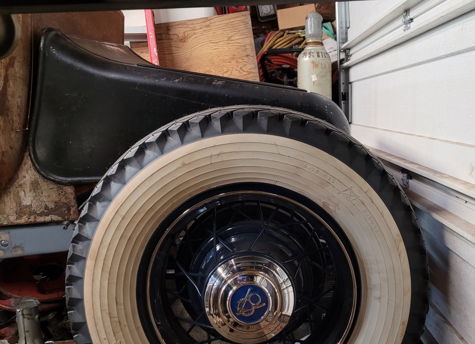

    I think so too! The front was always pretty solid (Hard to go wrong with a good drop axle and a reverse eye spring), but the Rear stance is the most important and will make or break the whole car.
    When i put it together with the original early crossmember....it was WAY too tall:
    After switching to the 4" lower drop '26-'27 crossmember, I think we are right about on the money:
    I didn't want the top of the wheel over the turtledeck, but i didn't want it WAY below it either. There may be a bit of adjustment needed as we add weight, but i think we are just about perfect.
    Outback, OFT, brEad and 4 others like this.

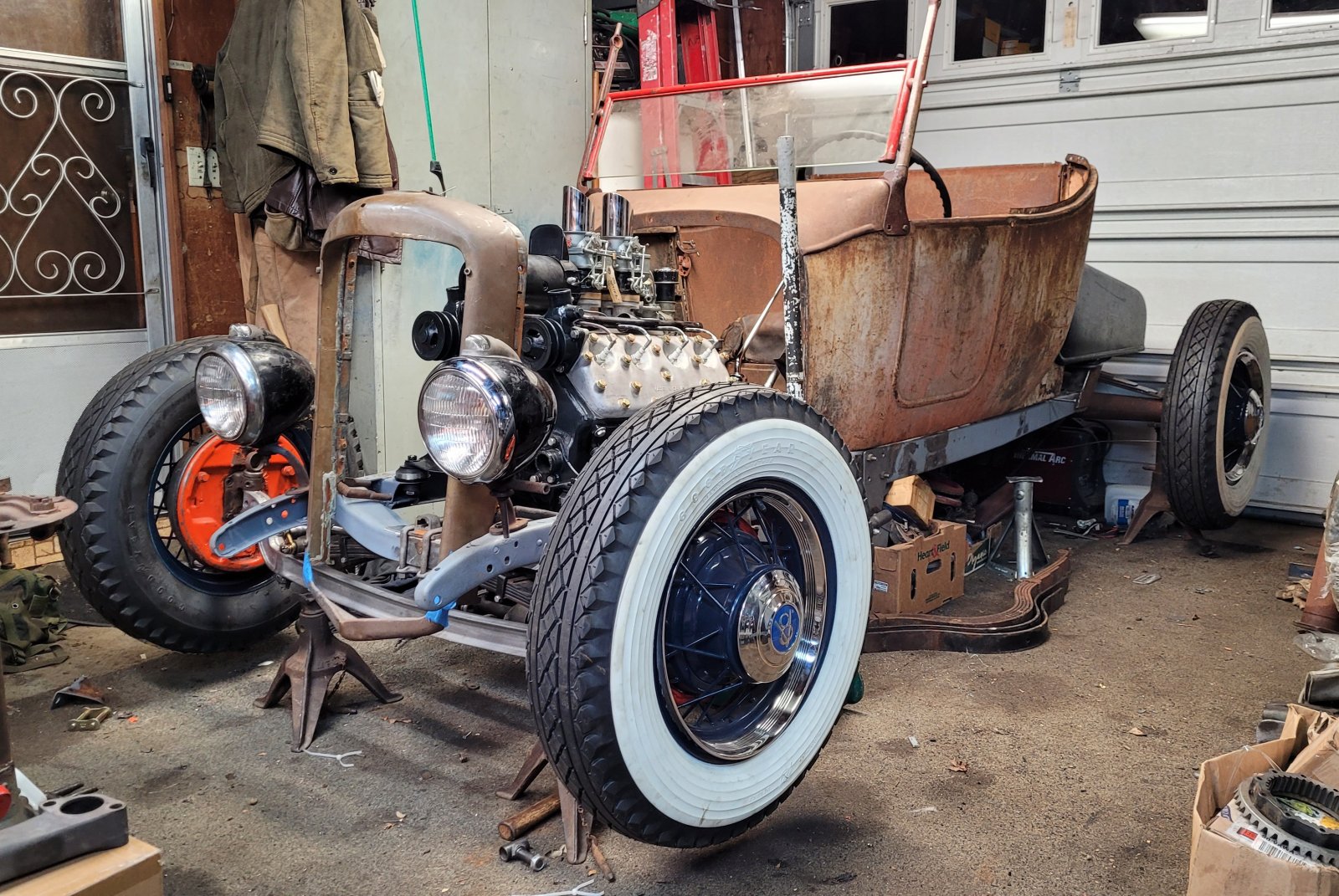

    Outside Mock-up..
    After getting the frame sorted, i had the opportunity to push it outside to really get a good look at the stance:
    Naturally...this meant i needed to Photoshop them a bit further to get the effect with the radiator shell installed.
    Slatted Shell..
    Non-Slatted:
    Beauty shot...
    What does everyone think? I think we nailed it.
    ~ Mr. Model T
    cactus1, A Boner, Spooky and 6 others like this.
  24. atch
    Joined: Sep 3, 2002
    Posts: 6,401
    atch
    I like it just the way it sits with the possible exception of the vertical location of the radiator. Is it in its final location?
    The suspension/stance is spot on.
  25. MrModelT
    Posts: 2,745
    MrModelT
    Just about. It's a 1920s Sprint car radiator shell, so it's supposed to be vertical. I plan to give it a slight lean back to get the filler neck straight.
    brEad likes this.

    Looks pretty spot on! In the side view with out a grill it feels like it could come up just a hair in the back but with a grill it may fix that visually.
    It looks perfect in all the other photos so I’m thinking my eyes probably catching some body line that’s making it read nose up when it’s not.
