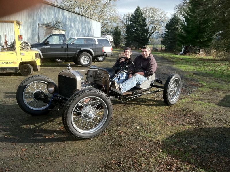

    Our Friend Tim Williams brought his Speedster out to extend his hand crank and give some rides after putting on a new high compression head. The new head made the car go a little faster, from 35-40 mph up to almost 50+ mph, not too shabby for a stock high that has been planed almost a 1/4 of an inch!!
    I had a very little time there on Saturday as Carston had his birthday party going on Saturday afternoon. The 1904 Phare Solar spotlight bottom was just falling apart. I cut all the junk parts off and cut a new peice out to take up Jim's (my father in law, who builds high performance racing planes) to get riveted in place as well as new holes drilled for ventilation and the burner mount......
    Hinges got delivered on Friday afternoon . I had ordered it from Grainger and they were delivering them either Friday or Saturday. When they delivered it I thought Grainger would bring it to the shop in one of their vans. No! They used a motor freight company with '48 trailer to drop off an '8 hinge. We weren't exactly sure how the guy was going to get out of the drive way!! I got the hinges cut and started the final filing and fitting of the hoods before Thursday afternoon's riveting adventure.....
    finished fitting the electrical box to the steering column. Moved the monocle windshield down the column 2 3/4" to get some much needed finger clearance on the steering wheel before Clayton get's the glass cut....
    Fixed the carb problem we been having with a plugged up carb by changing it out for a rebuilt single barrel. Seems to get better performance with it, might run but still looking at the Stromberg 97. We ran the 97 a few times without a fuel filter and it got plugged up when we got a bad tank of fuel. Had too come up with a temporary throttle linkage and spring mount. Of course you gotta give a few rides and terrorize the neighbor hood before puttin' the "Special" away before the evening festivities!!!
    Finished switching out temporary hardware on the passenger foot rest. Used new stainless bolts and brass acorn nuts....
    I still have too mount the new upper radiator hose yet ....
    So between helping Mike mount his body on the frame of his '51 Chevy 2 door post and a little shop cleanup I had a really good Saturday. Clayton is just about done with his front end so we can get started on modifying the rear suspensions on both of our cars to make them ride better and hope fully get the "Special" torn apart for paint soon...
