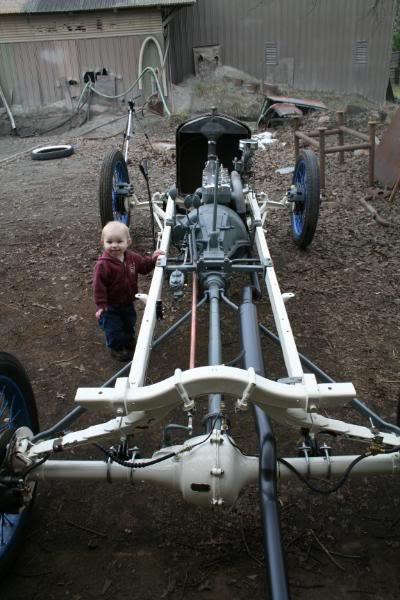

    *UPDATE*
    More Fun With Carburetors..
    Chris and I played around with getting the Holly 94 2-barrel cleaned back up and reinstalled on the "Special" yesterday. The 94 I had rebuilt had become choked with sediment and dirt...some from the tank and some from the lack of air filter. After we cleaned it up and got installed, still had some flooding issues which we think is due to too much fuel pressure. We have a regulator on order.
    Her are some photos from yesterday captured by Mrs. Model T :D
    ..talking to the parts guy..
    ..making hood hinges...
    More to come...

    This may be a question you have addressed earlier but was wondering why you didn't use the same rear axle lowering hardware that your friend Chris used on his speedster.
    Kume
  15. MrModelT
    Joined: Nov 11, 2008
    Posts: 2,745
    MrModelT
    You mean on my '26 roadster?
    The rear axle lowering method seen here on the "Special" was actually copied from my car originally. While this method did work, it did have some axle/frame interference issues. To correct this, I completely redesigned the rear suspension on my roadster to fit within the specs of the current axle location and drive shaft length while adding some ride height.
    This same new method will also be applied to the "Special" after the kinks have been worked out using my car as a test bed.

    There are many different ways to lower a T. I wanted to keep the frame flat and uncut because I see the "Z" lowering brackets as a potential weak point and I didn't want the rear cross member intruding into the turtle deck area.....and I wanted to do something different and get the car low as possible without cutting the frame :D
    The major potential drawback to this style is that the spring mounting points have to be moved ahead of the axle, which pushes the axle backwards...lengthening the WB. This did not come into play on my car because I added the Chicago O.D. which requires the drive shaft to be shortened anyway. On a Stock T with no O.D. unit, the drive shaft would now be too short requiring A: the frame to be shortened B: the engine moved back in the frame C: add a second cross member forward of the original rear cross member to hold the spring in order to compensate.
    The method that Chris used on his original speedster frame is a more common way of lowering a T and it does keep the axle in the same location (front to back) as it was originally (especially important with a stock drive train), but would need some modification work to the rear of the body to allow clearance of the rear cross member.
    You wouldn't have to add wheel well cut outs in either of these scenarios, but the Turtle deck floor would have to be modified if you "Z"-ed the frame. You could always do reverse-eye main leafs and a drop axle, that would drop it a bit and is virtually mod-free...its all bolt on stuff...

    The Z brackets on my original speedster are made out 2.5 steel bar so it is very strong and would not break. With the Laurel style z bracket on my old ch***is it was about a 4-5 inch drop on the rear and with the front was over 7 inches and extended the wheel base forward by 12inches. You can go either way (z the frame or extended shackles), either way is just as strong.
    Get a book Called Model T's in Speed and Sport, it's blue and white cover and they have a whole section on lowering a T ch***is (20 or so different ways). Also Check out the tech section of the Northwest vintage speedsters website (NWVS.org)for several other different ways to lower your ch***is.

    Here is all the plans I have for it.
  25. MrModelT
    Posts: 2,745
    MrModelT
    They are stout, but it's not their strength or beefy-ness that is of concern to me (lord know those brackets of yours would survive an atomic blast :D).....its stress on the frame and the inability to flex that does. The Model T frame, though flimsy in appearance, is remarkably strong. Constructed of Vanadium steel (which is both hard and flexible), the frame is actually designed and acts as part of the suspension and must be allowed to flex.
    The addition of heavy boxing plates, heavy reinforced "Z" brackets or addition cross members may stiffen the frame, but this is counter-intuitive to the Model T's design and could cause extra stress by not allowing it to flex as intended and may result in these additions, or the frame "cracking out" at those weld points.
    When I design my support cross member for the Chicago O.D. it will have to be built in such a way that the frame can still flex as intended while still offering support to the aux. O.D.

    Kume,
    If your going to use the laurel style z brackets do not weld them in place. I would bolt or rivet them so there is flex.The plans show where to rivet or bolt the brackets together. Clayton is right and I have personally seen cracked frames where pieces are welded to them. On my original ch***is I welded boxing plates the full length of the frame to eliminate this problem.
    Clayton you might need to look at your steering mount as it is just a welded plate to the inside and top rail of the frame and could cause cracking. Perfect candidate for another "Riveting" session with George!! Sorry!!

    I agree. That was done before I really understood the concept and the design behind the Model T. I have worried about that steering mount for a long time and may just have to give in and replace it properly.
    ...another item added to my "to do" list. :rolleyes:
