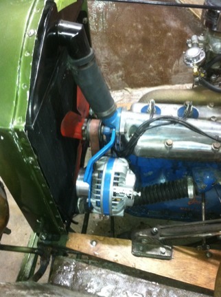

    Well I had part of the day off. My mom's car developed a electrical problem last night so I got it fixed and had just enough time to go and build my alternator pulley. So here is the finished pulley ..... 3.5 inches in dia. By 1.5 inches wide.

    Thanks, you might just have to learn how to run a lathe... I'll try to post these current pictures up. Hopefully you can see them. Yesterday afternoon I got the alternator mounted up permanently.
