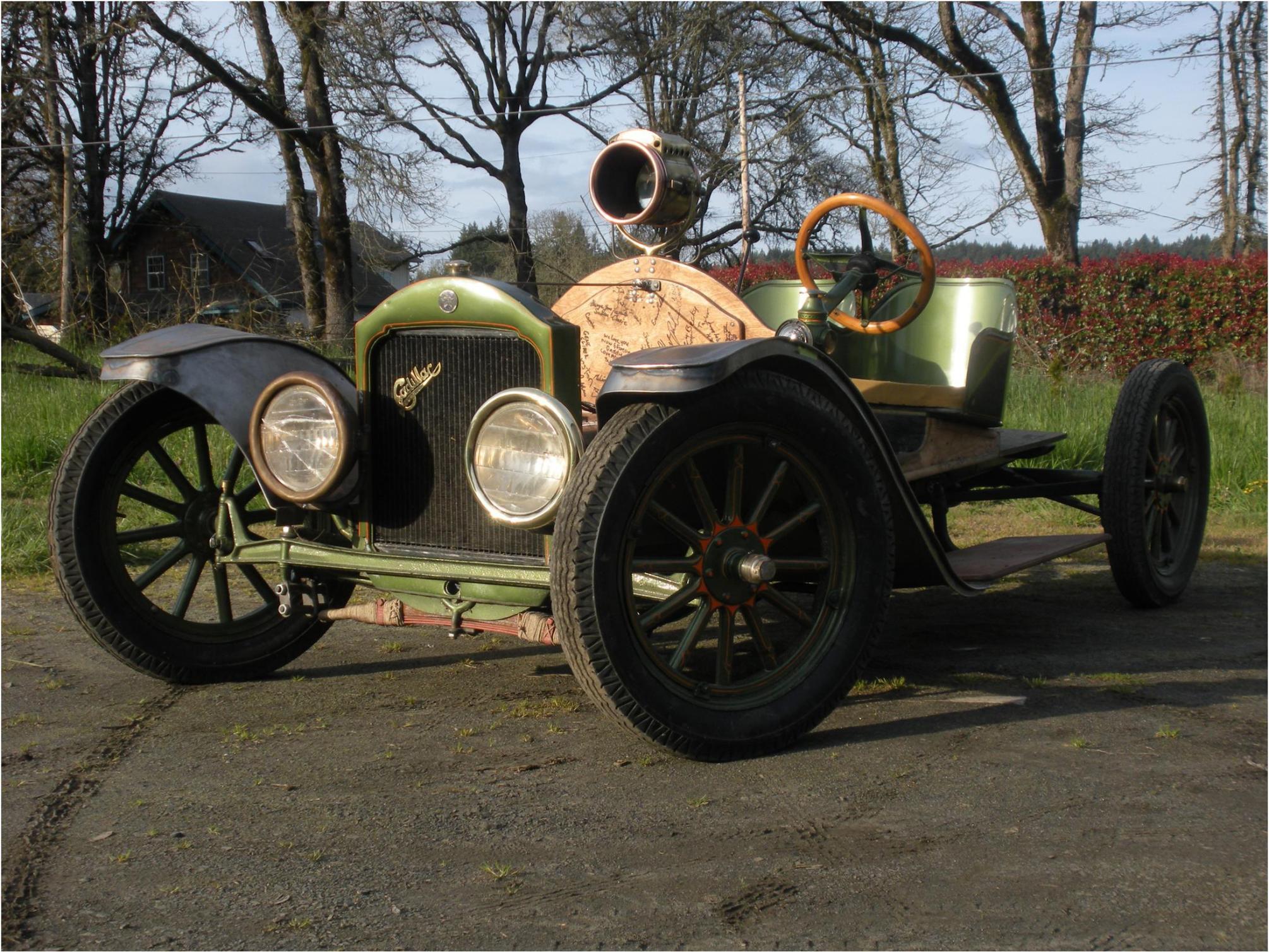

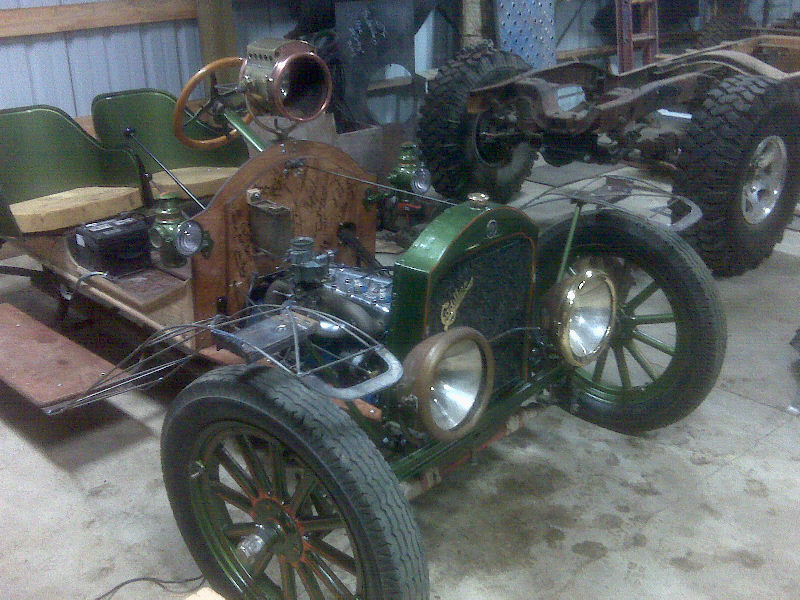

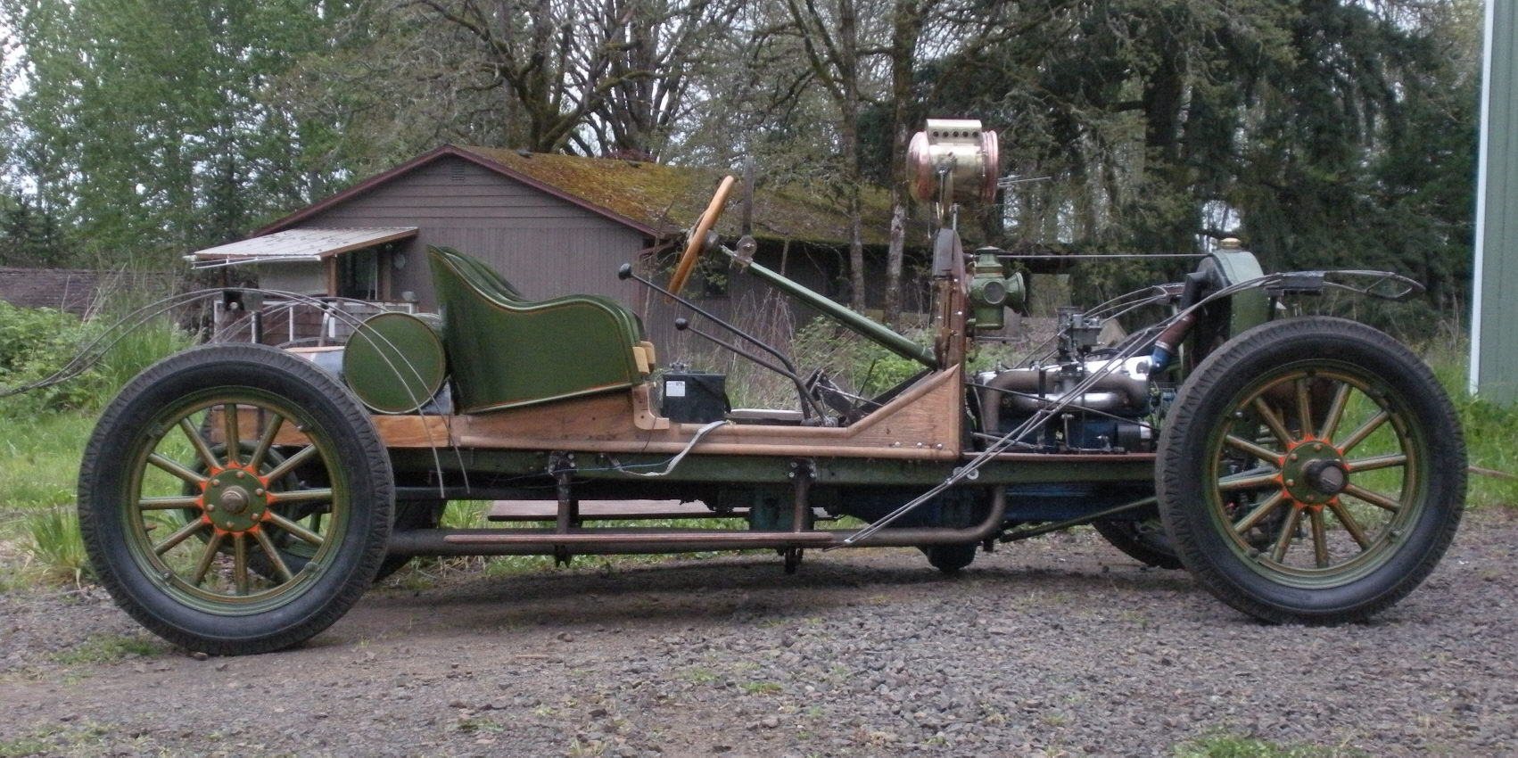

    Hello H.A.M.B.sters!

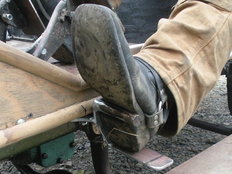

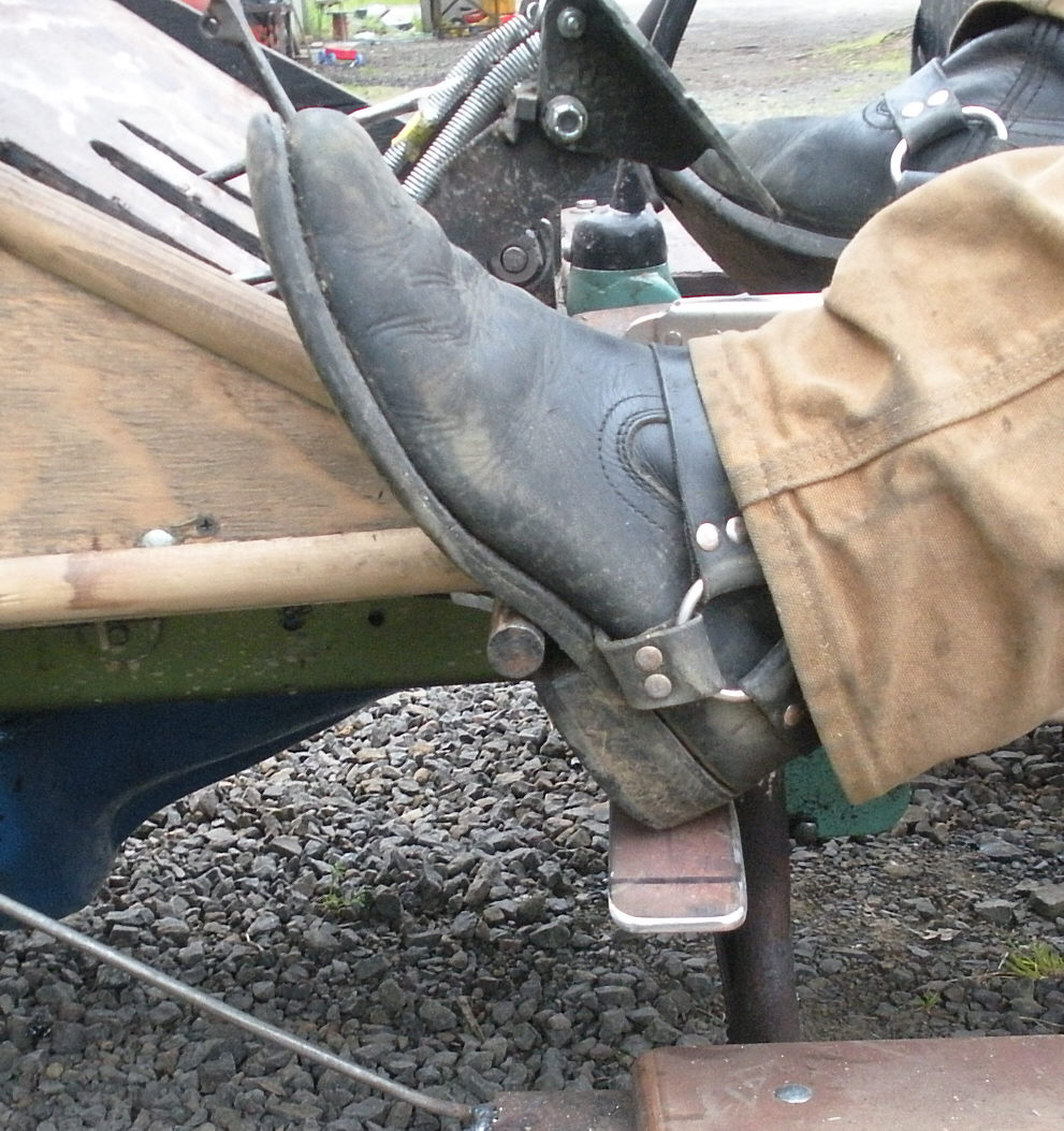

    Got a little progress made on the "Becker Special" this weekend. I got the extra wide running boards mounted finally, the new headlights installed and the front fenders mocked up. I started building up the framework for the front fenders as well, but didn't get very far.
    Chris did a great job mounting the "Special's" newest accessory....something that Bill found years ago and been hiding in the shop since the 1960's :D ...the early Solar spotlight (patented Jan 31, 1899 and Aug 25, 1903)
    Pulled it out in front of the shop and took a few pics, enjoy! :)

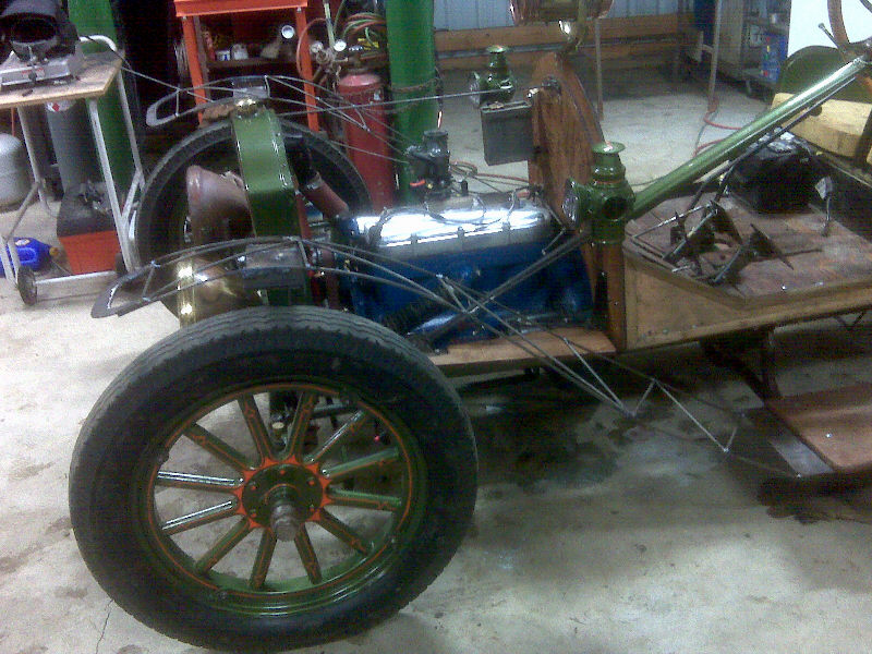

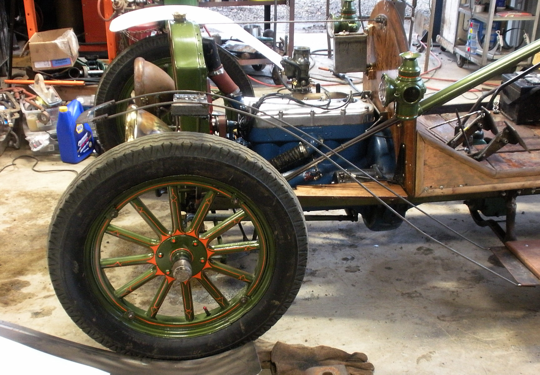

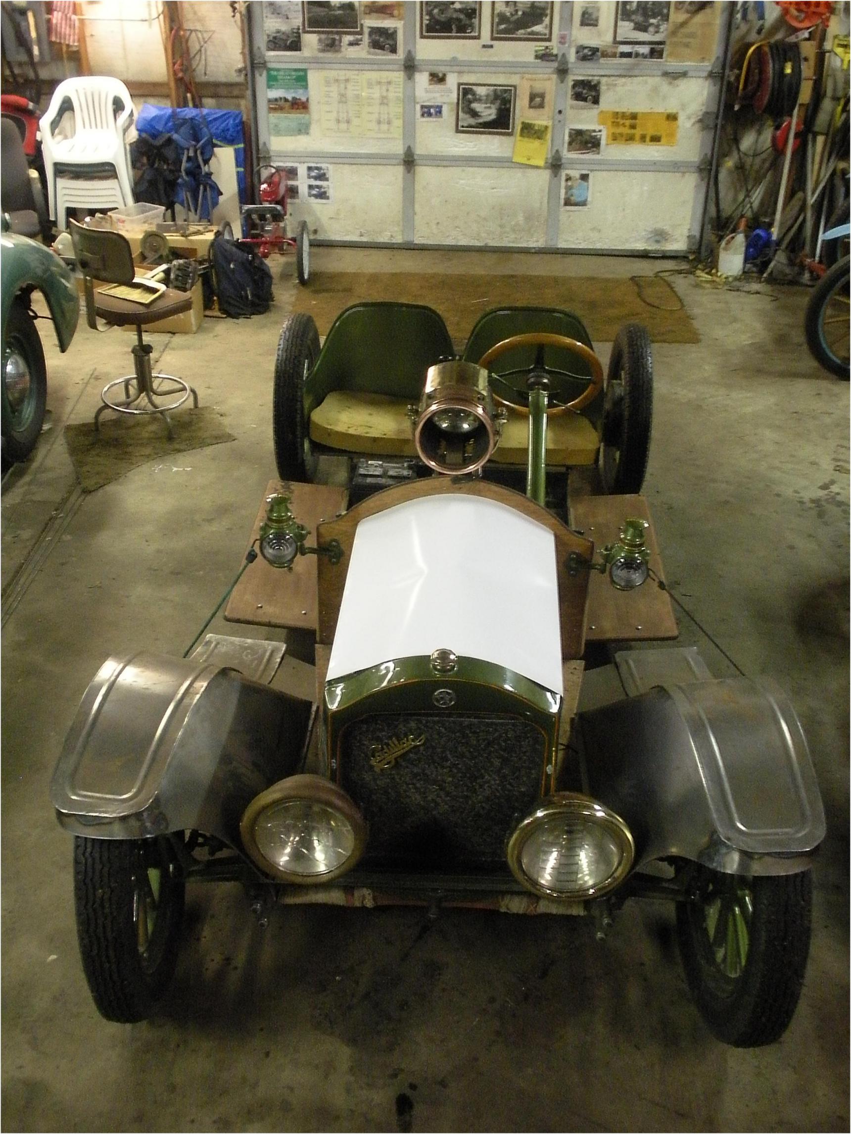

    UPDATE:
    FENDERS: The Beginning
    Well, I finally got started on the front fenders this weekend! Chris and I wanted to try out making Fiberglass fenders to try something new and get the car done for some upcoming events this summer!
    Here is the latest:
    Front fender framework is done! I made up the outer line frame and nose pieces and Chris did the "lattice" work for added support.
    This weekend....I start skinning them :D

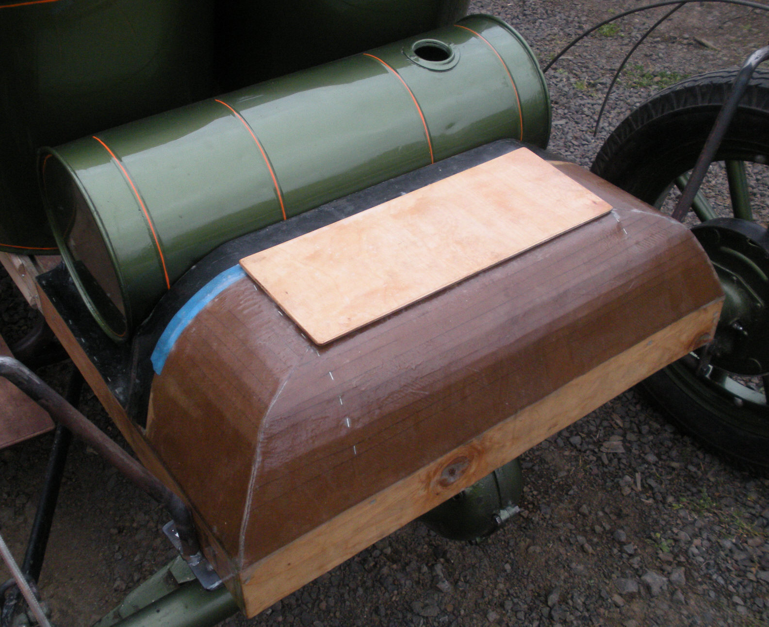

    Update:
    Trunk and Fenders.

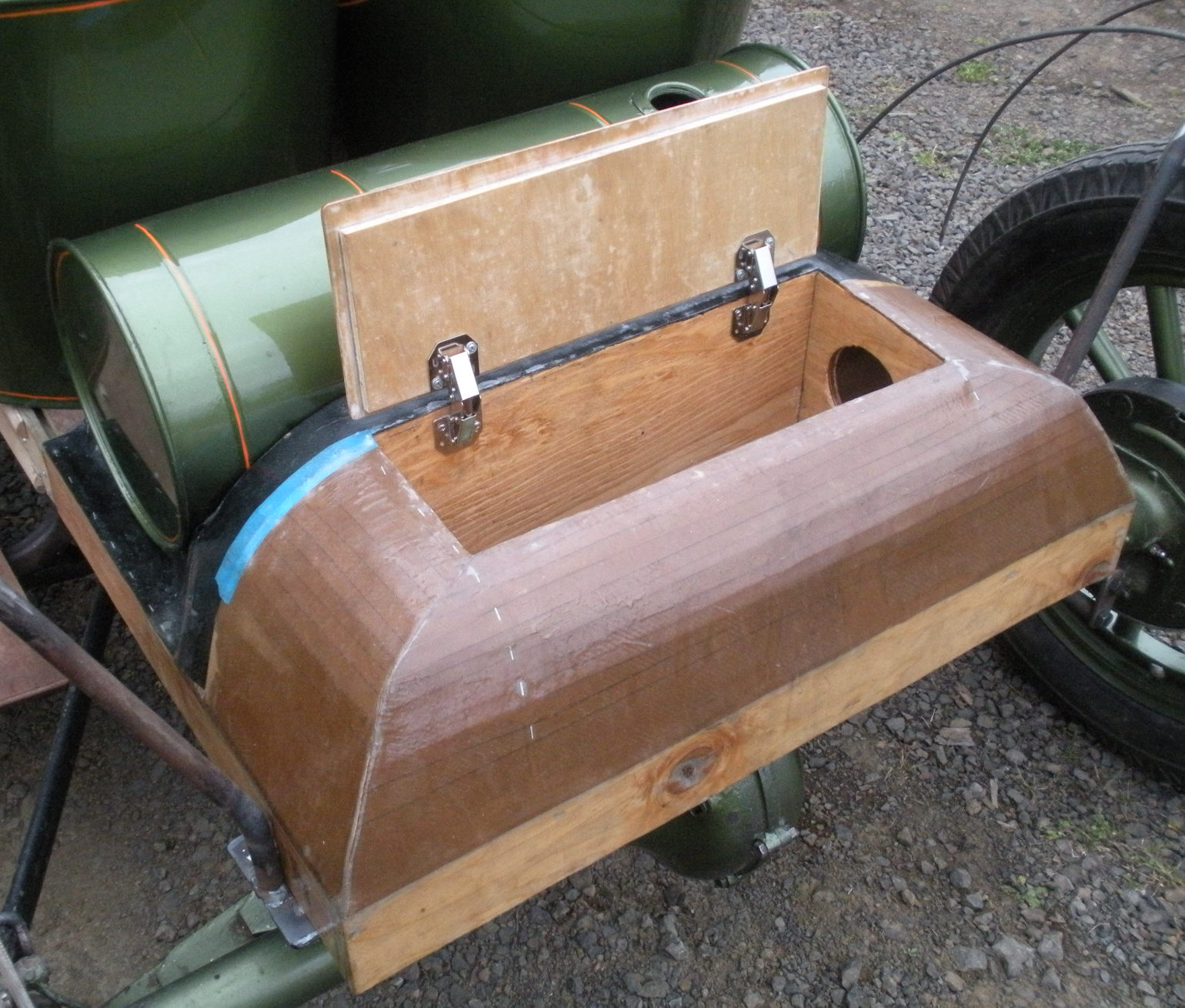

    Well....FINALLY got the trunk section complete! This was our first run at the fiberglass technique and it seemed to work very well. I also got the rear fender frameworks laid out. Chris made some great progress too, getting the auxiliary brake drums machined, The molecule windshield, and the driver's side stirrups made.
    Here are some pics from this weekend's exploits:

    Updated Update:
    More Trunk and Fender Progress

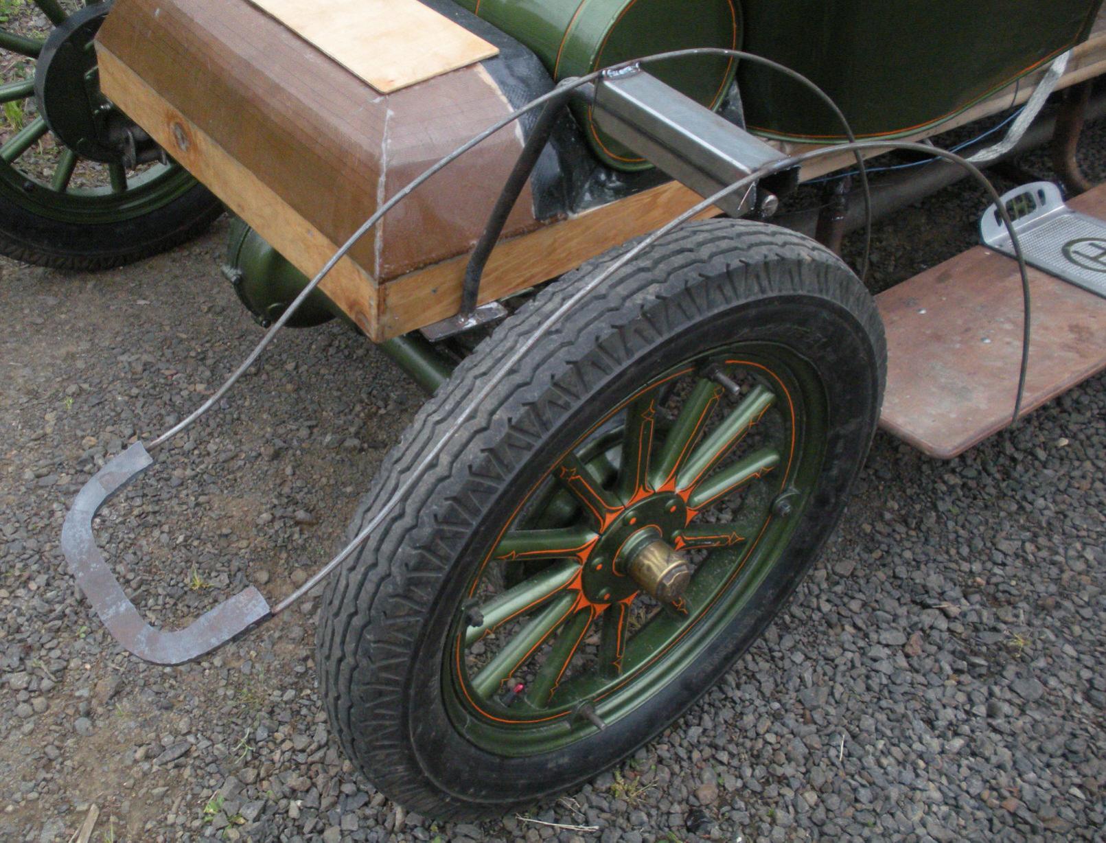

    Chris and I messed around with the rear fenders Sunday night and got them finished and ready for skin. We also mocked up the double spares.....can you say "Baby Mercer"? :D

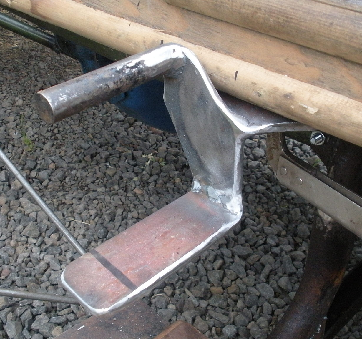

  16. powerwagonmaniac1
    Joined: Mar 17, 2005
    Posts: 329
    powerwagonmaniac1
    from Aloha, OR

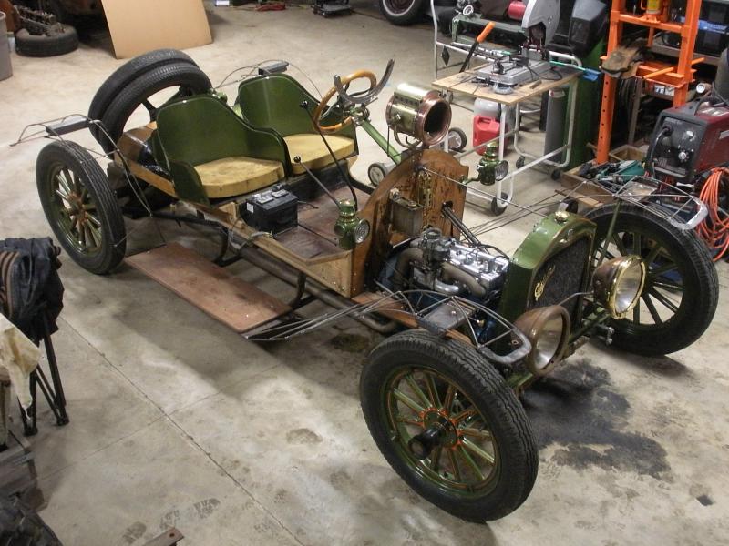

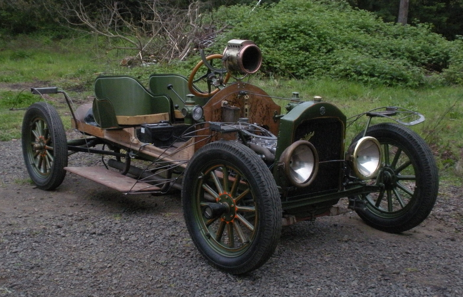

    [FONT=Verdana,Arial,Helvetica]Getting really close to that baby Mercer look we were looking for!
    [/FONT]
    Well Clayton has most of the fenders done in cardboard. Here's the last couple of weeks effort.
    Hope to start glassing them soon so we can blow it apart and start painting it '68 Vedero Green, or as someone said earlier Envy Green!!
    Finished the monocle windshield for it.
    [/FONT]
    While Clayton was working on fenders I started building the emergency brake mechanisms. Hope fully Monday night or Wednesday night it will be done. We'll see!!
    [/FONT]
    Hopefully next week end I can get the spare tire carrier made.
    Goal is to have it finished, licensed, and road worthy by September 17th, 2011, for the NW Flathead Reliability run from Seattle to Vantage Washington.
    Chris Becker

  27. MrModelT
    Joined: Nov 11, 2008
    Posts: 2,745
    MrModelT
    Thank you for the wonderful compliments! This car, and the meaning behind it, means the world to Chris and I, so it is really means allot to hear such nice words from you all.
    I am really honored to have been able to design the "Becker Special". Chris says "The design was all Clayton's doing..", but the design for the "Special" is just as much his as it is mine.
    I could not be more pleased with how the proportions and "look" of the "Special" has turned out. The fenders you see here are also not patterns....there are the Real Deal. Once I have completed the finishing touches, these cardboard fenders will be sealed in fiberglass (resin and cloth) to make them stiff and water proof.
    This was a process that my Dad was using for a few R/C model ships and that Bill was fascinated by. We had joked about trying this on a car and when we started the "Special"....it was only fitting.
