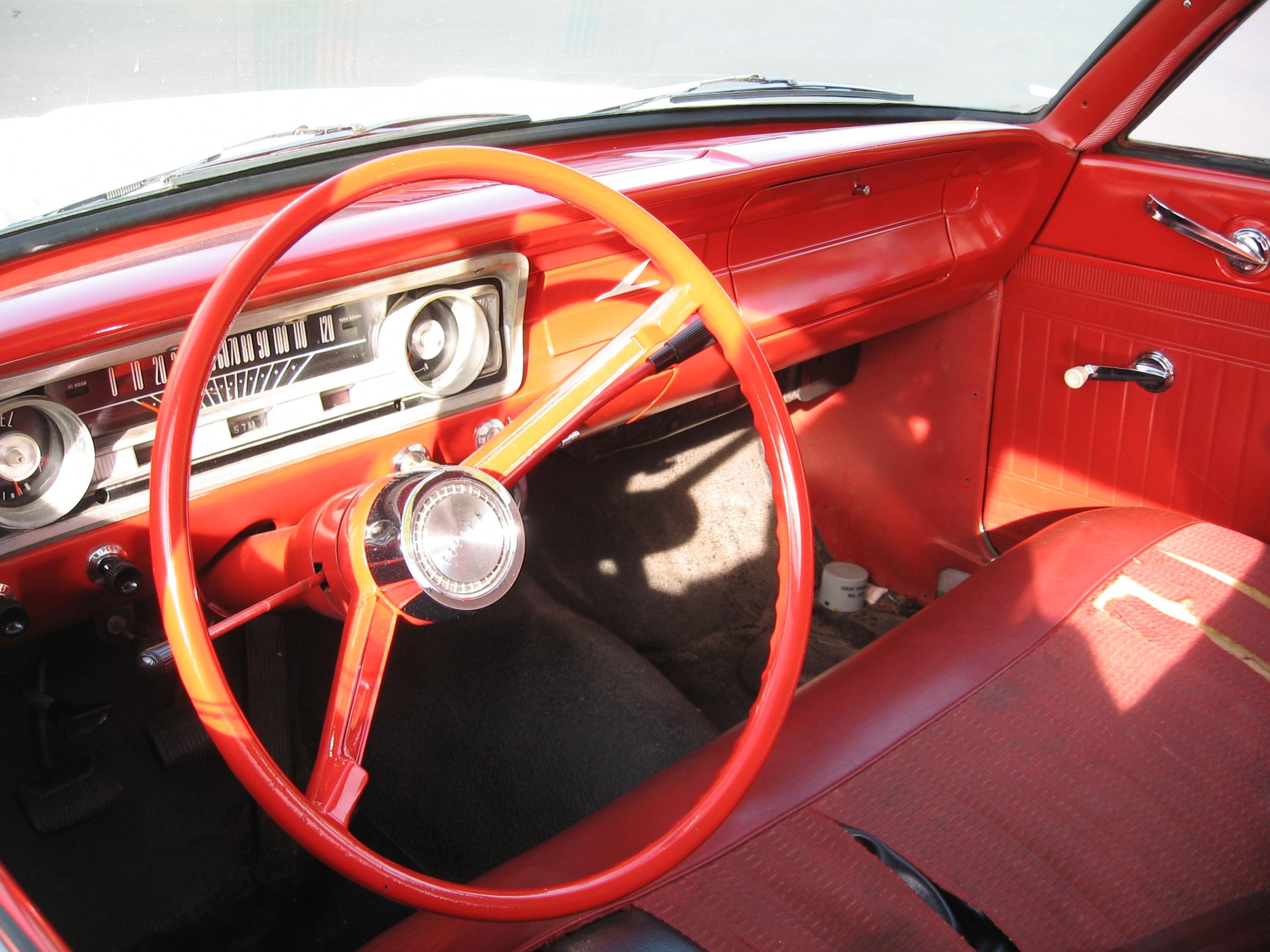

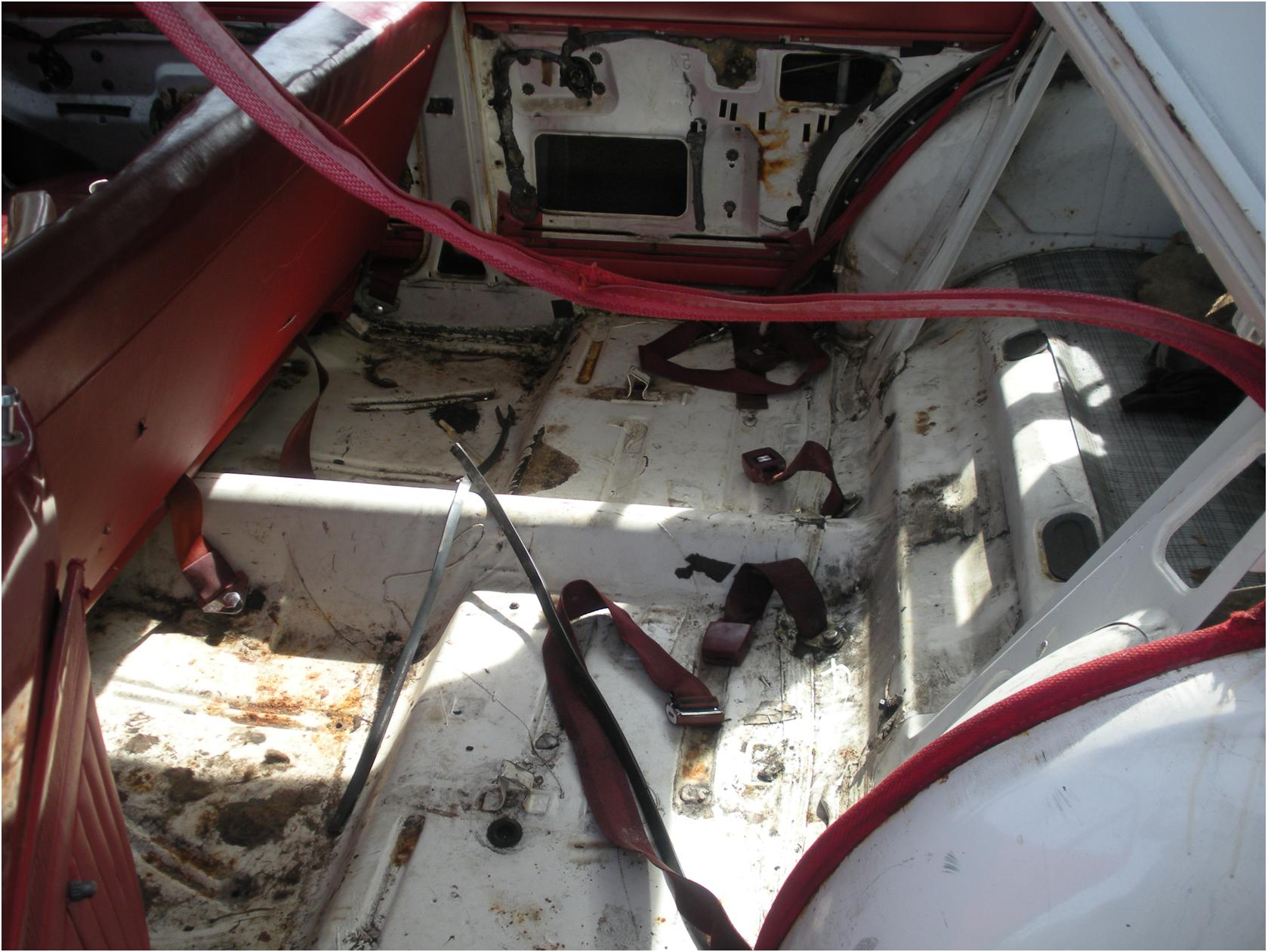

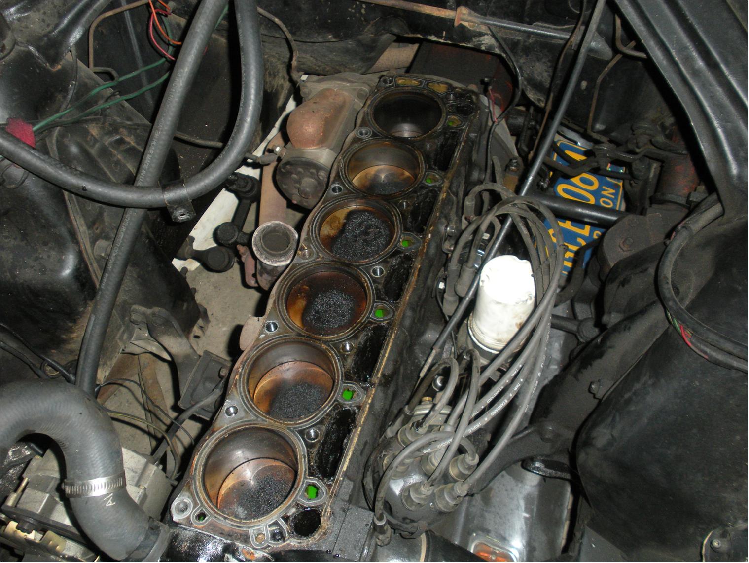

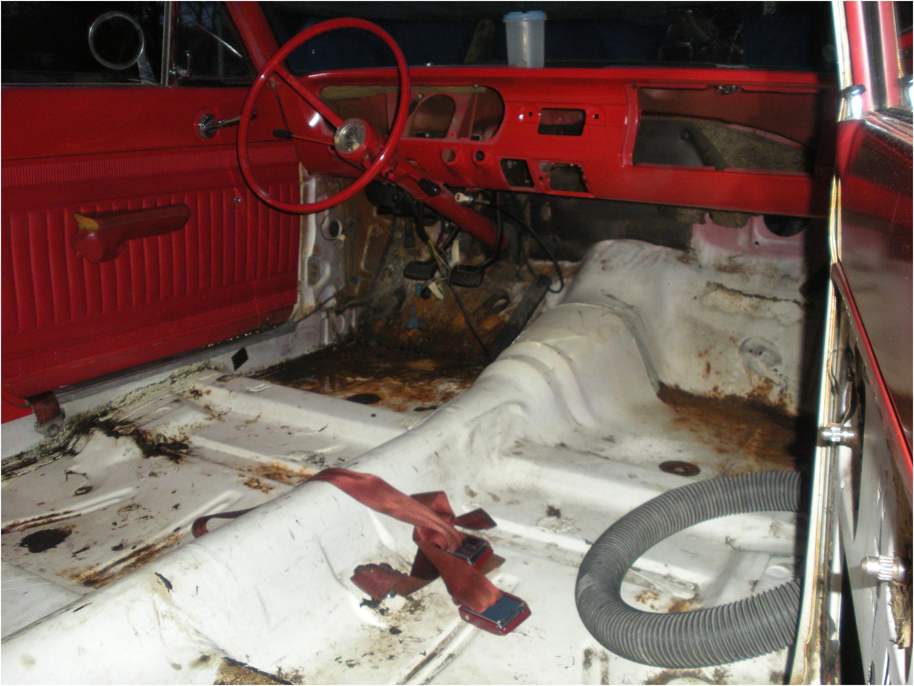

    ..Anyway, enough of that for now, here are some pictures: Before, disassembly and today.
    Enjoy!

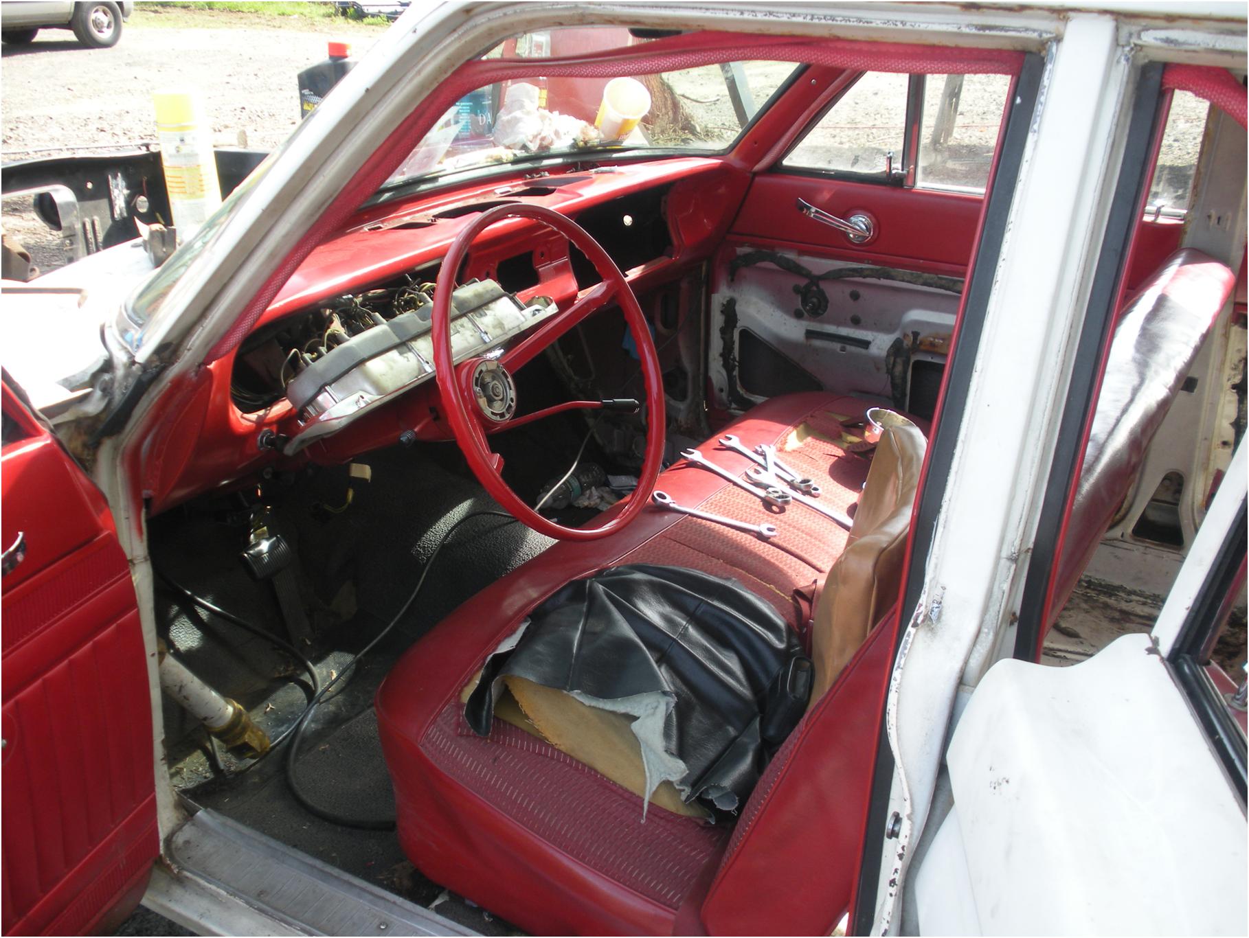

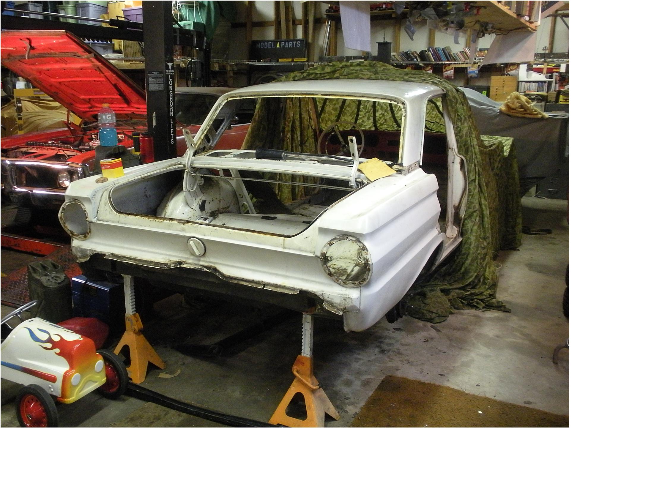

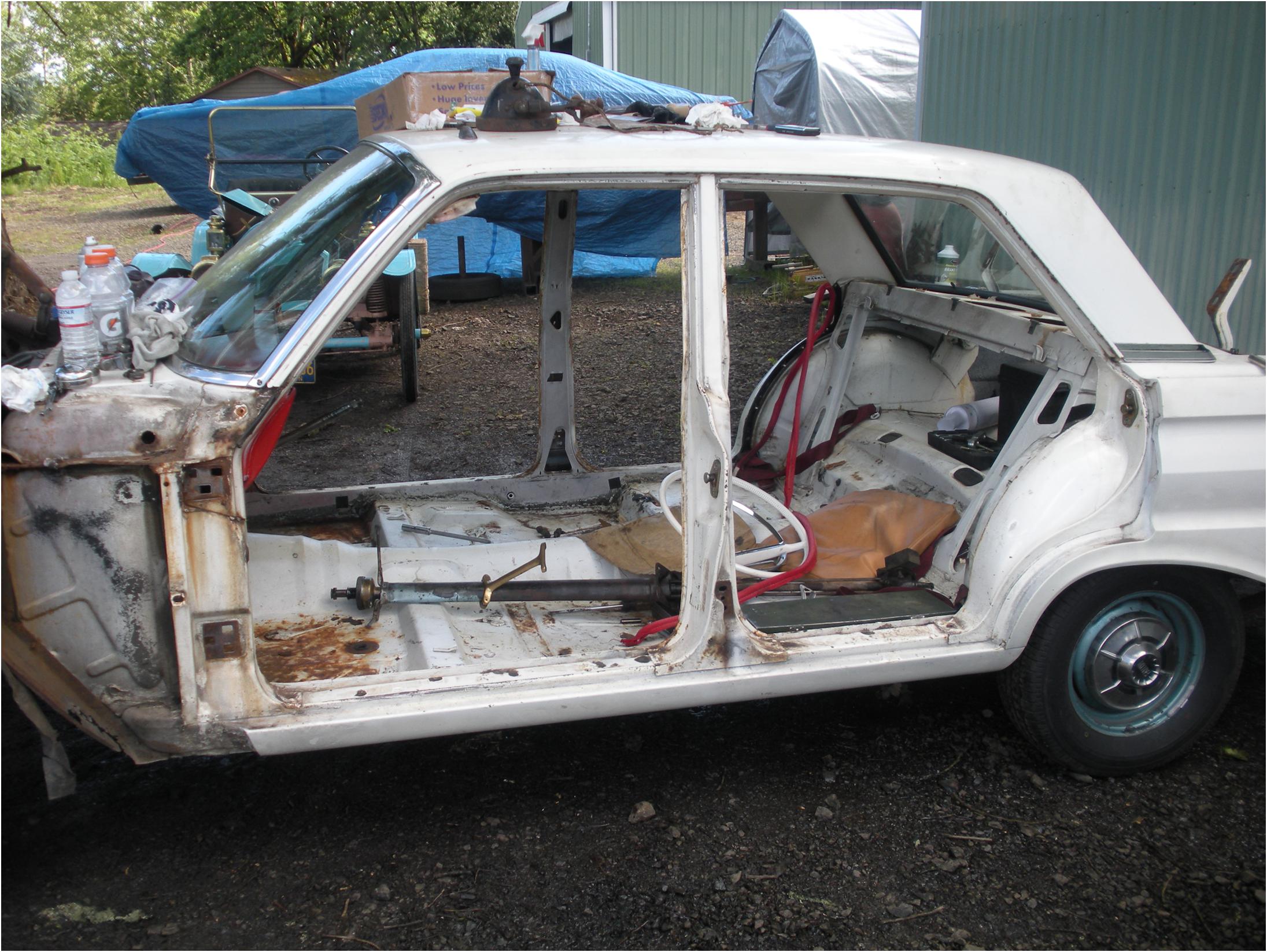

    Here are a few more....
