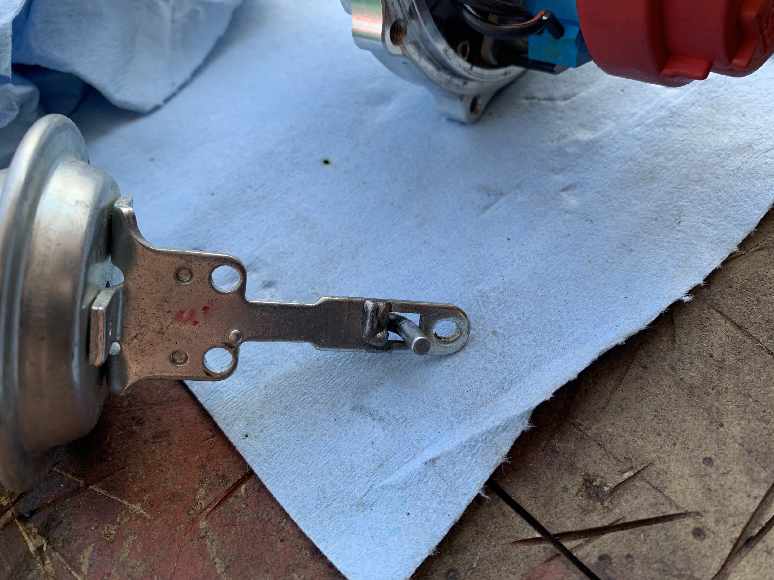

    So what do you do when MSD says their cans give around 10* to 14* of advance at full **** and you’re getting closer to 20*?
    Solution: take the damn distributor out, pull it apart, and modify the pull length. It’s a little nit picky, but well worth the time/effort.
    Here’s my solution in pics to help fellow MSD ****ers (pun intended).

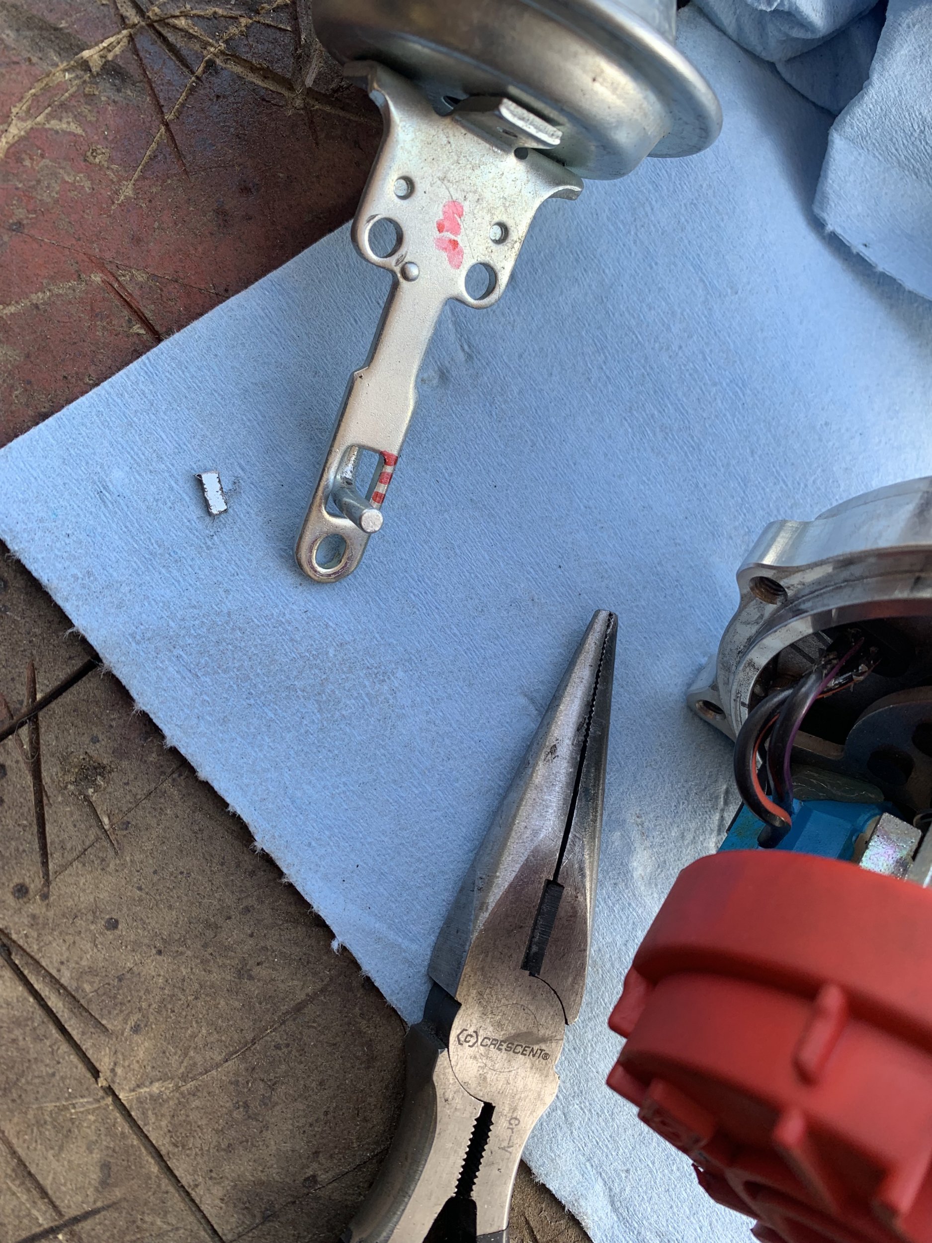

    1st up: make a little plug to weld in. Size is important (no matter what she said, haha), so always better to start with a little bigger.
    Step 2: carefully weld it in.

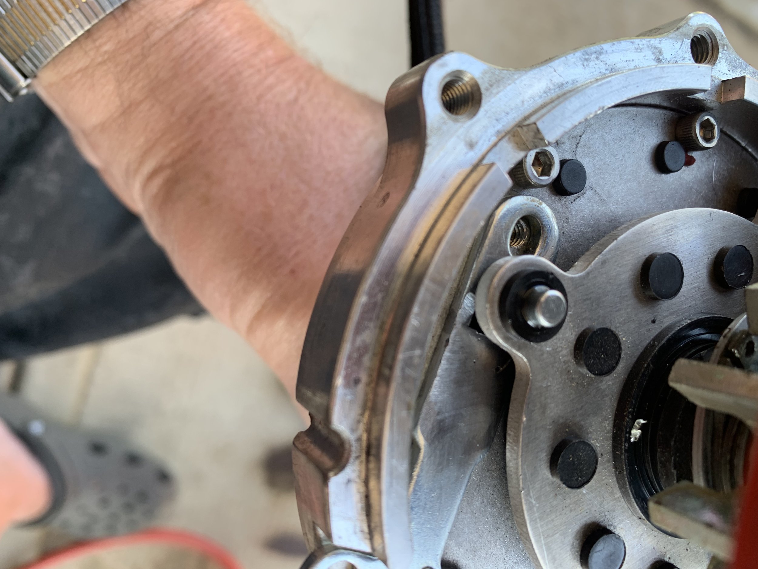

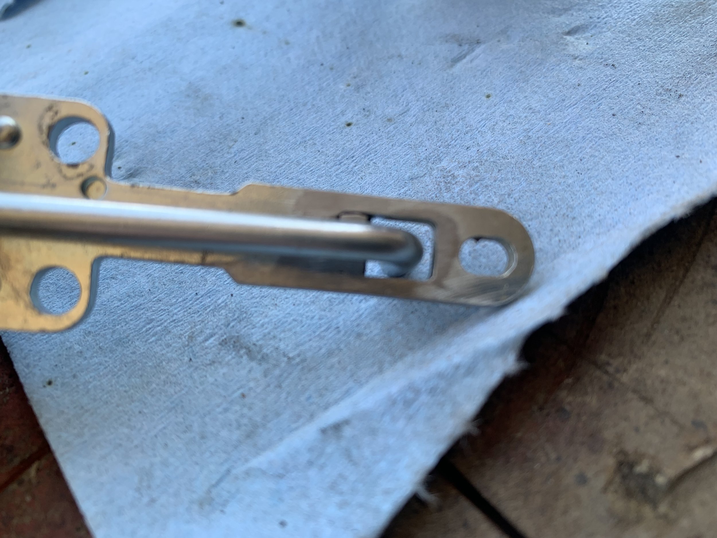

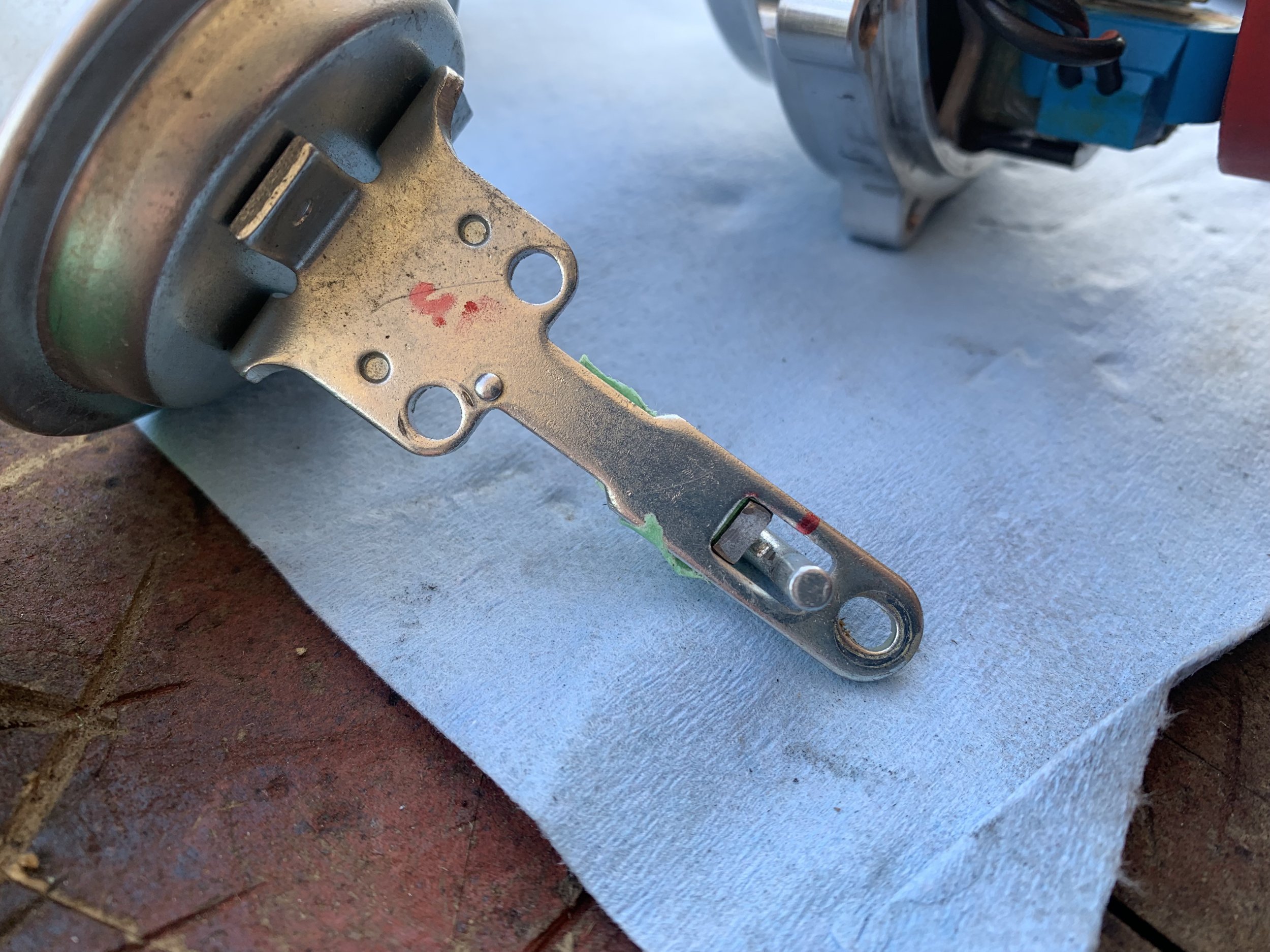

    Step 3: clean it up so it doesn’t interfere with the little bushing.
    Note: I left one little corner non-welded so I could always go back and see how much I adjusted the pull length.

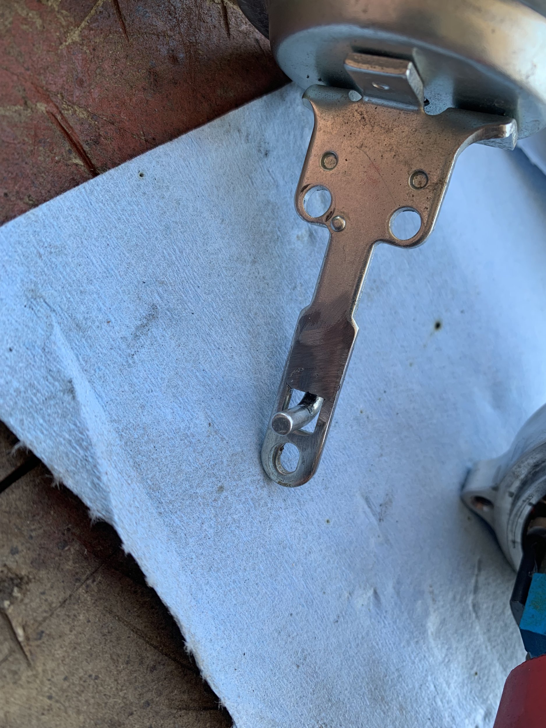

    Final step: re***emble distributor and stab her back in.
    I’m sure this isn’t a new solution, but if anyone else is dissatisfied with getting 18-20* advance out of a product advertised as 10* to 14* then I hope this method helps.

    Little update: decided to finally put the dual quad ‘battleship’ on the little 383 stroker that’s in the Tudor (last Fall). I started doing some tuning before it got cold, and as much as I liked my solution, wanting to put another 2 degrees of vacuum advance in sure made me wish I had found an adjustable can.
    On the positive side: I had the dizzy out anyway.
    But taking it apart and filing out a little of my welded in stop was nitpicky. That slotting idea would have been a good plan. ;)
    Must have been living right as I’m just getting back into tweaking the new setup and doing a little more tuning before she rolls out for summer cruisin, AND it turns out I magically hit +2 degrees on the ****on. So now it pulls a total of 12 degrees. Fingers crossed it’s the last adjustment on the vacuum front.
