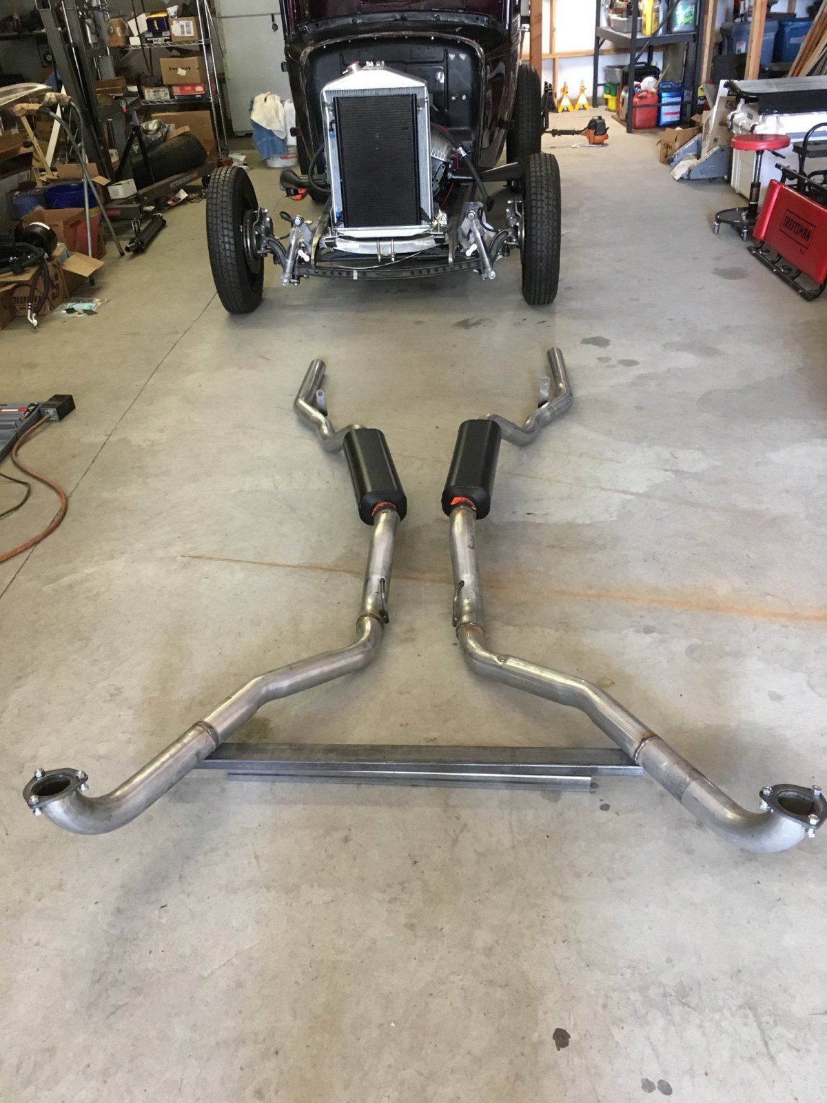

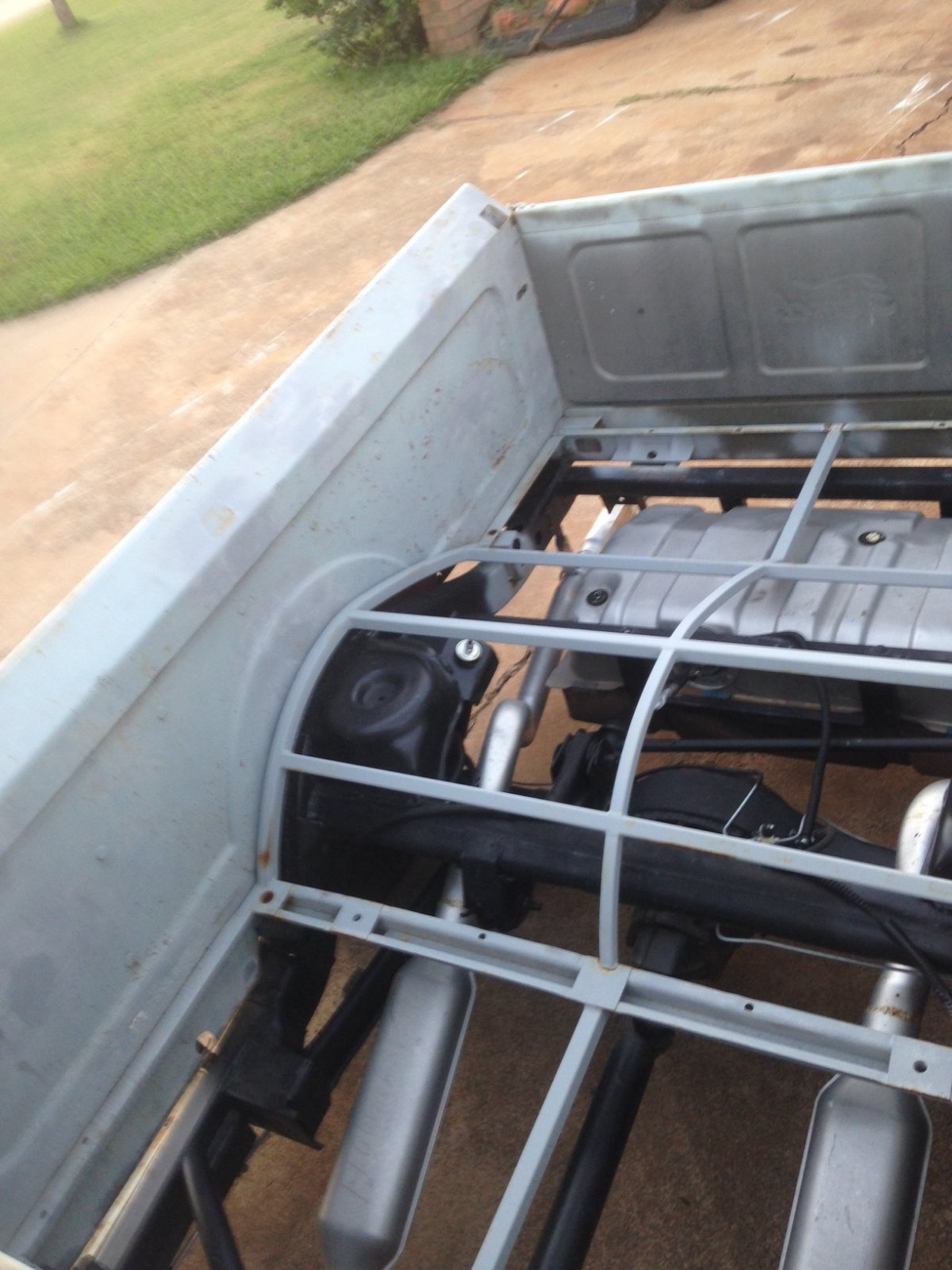

  26. Cheap long gl*** packs. Off too loud, add a short one. :)
    I do like the hush power mufflers.
  27. bobss396
    Joined: Aug 27, 2008
    Posts: 18,761
    bobss396
    I run these in my Ford and they do get better with age. Still a little loud inside the car, even with a full exhaust. I may try adding a small extension to get the noise out from under the rear bumper. I have no package tray or trunk lid gasket which lets sound in.
