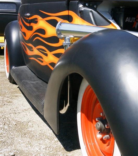

    My 37 had a similar set up. No problems at all
