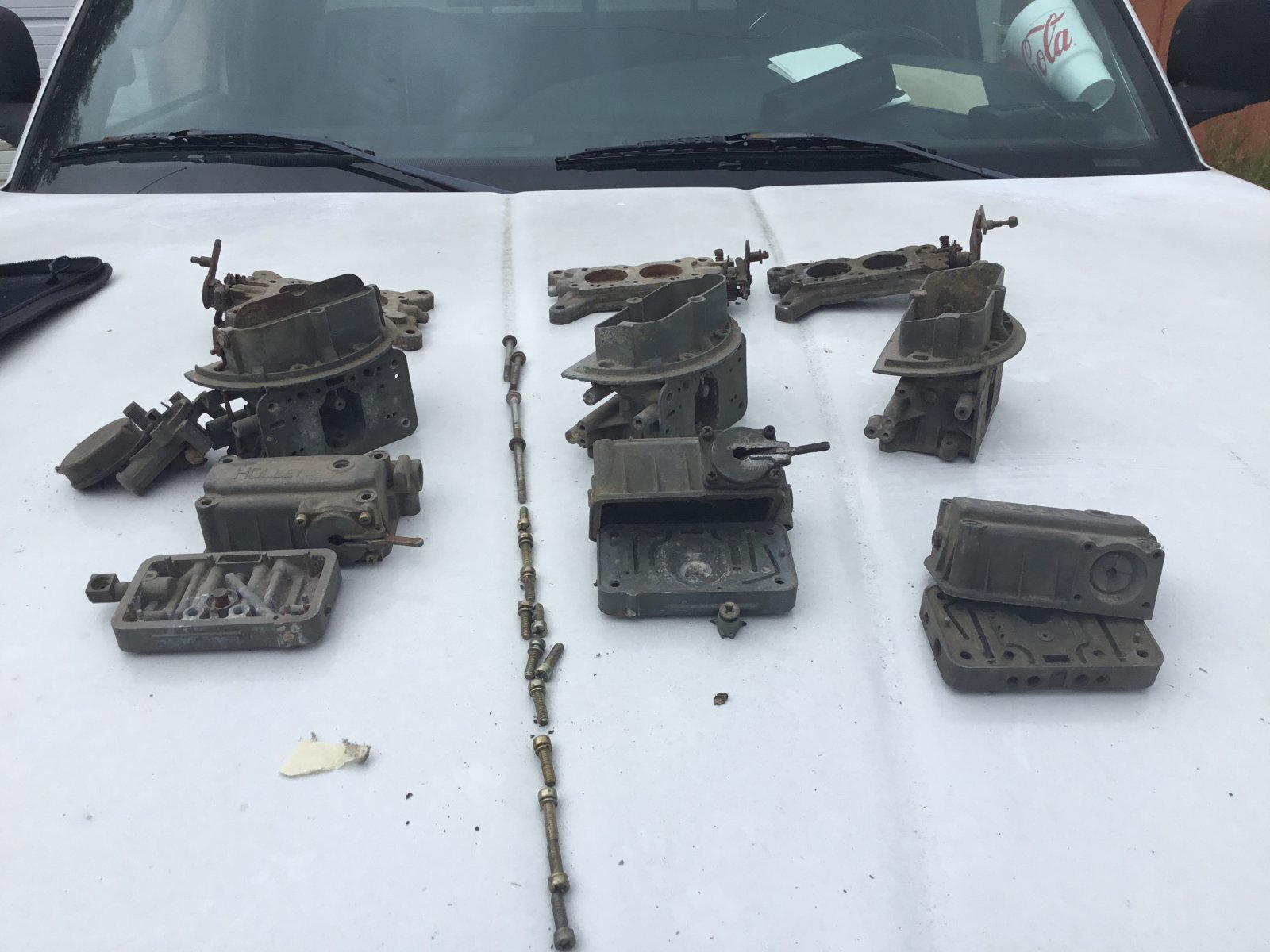

    Probably a better set up….I just like the 3X2s, not sure why! Maybe it was because I was exposed to them at an early age? Not sure. And I have spent the last several years piecing a 3x2 set up for an FE together! I think I now have everything. 87995E68-9C31-45E3-9447-3C2FC4C88E54.jpeg 35F5465C-681D-4DD4-86E1-0179E1E7388D.jpeg
    Bones
