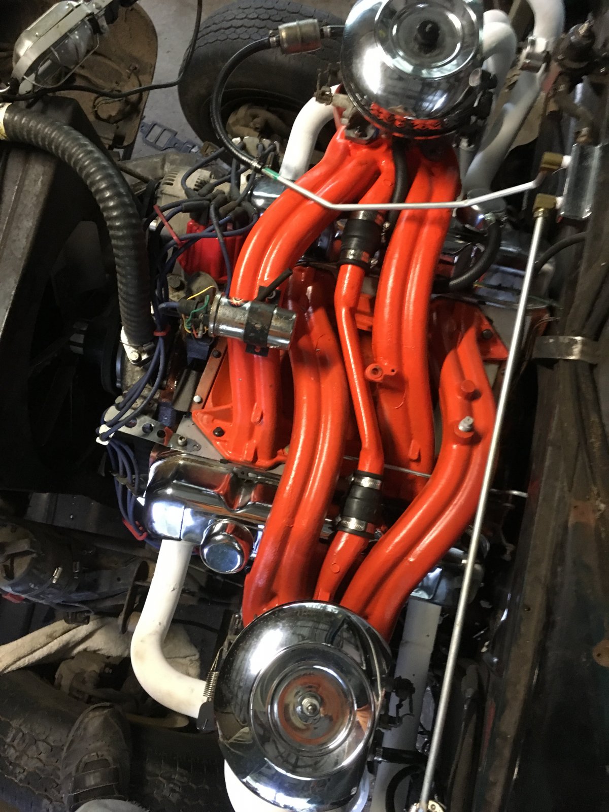

  8. This is hard to tune gets bad gas milage and makes the car slower than a big 4 barrel but look at it . IMG_0223.JPG

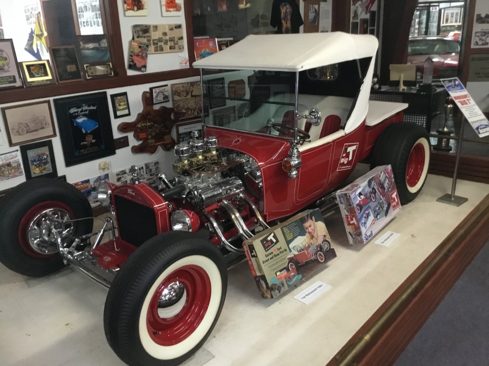

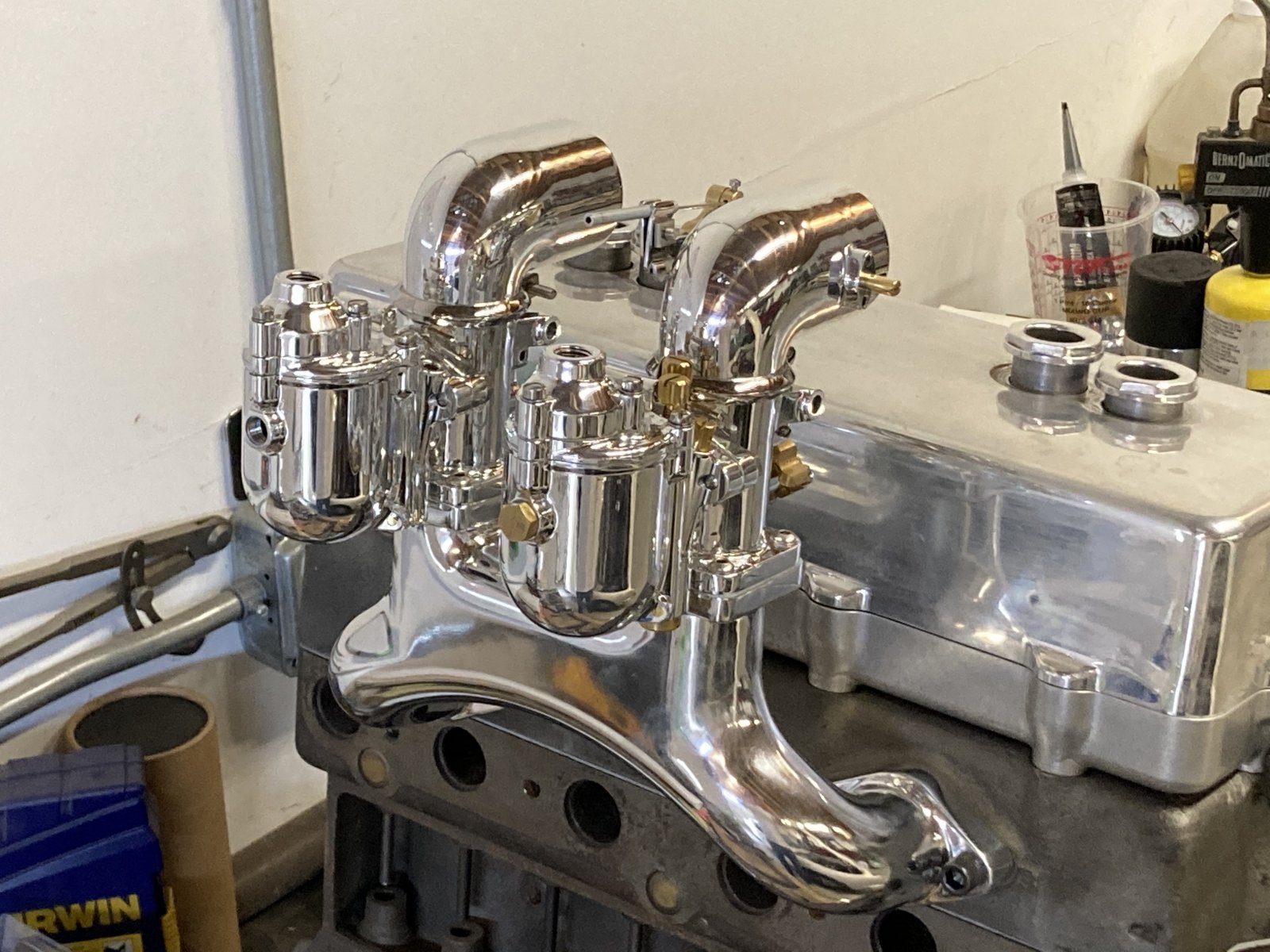

    the guy that owned this car who is full of wisdom told me a flat head with 1 carb is an insult to your manhood top off.JPG
    mad mikey, WC145, Deuces and 4 others like this.

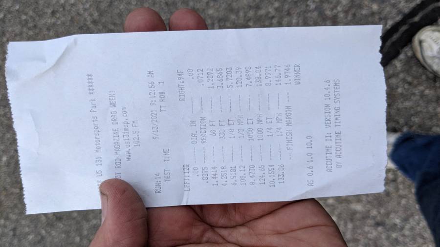

    It's definitely the cool factor!

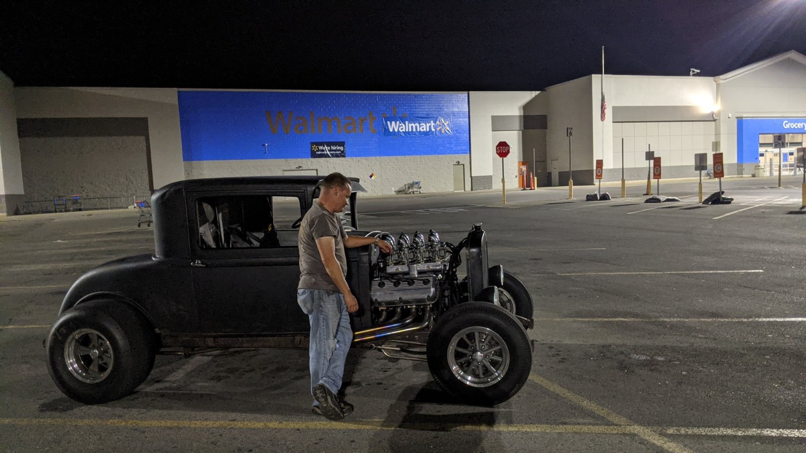

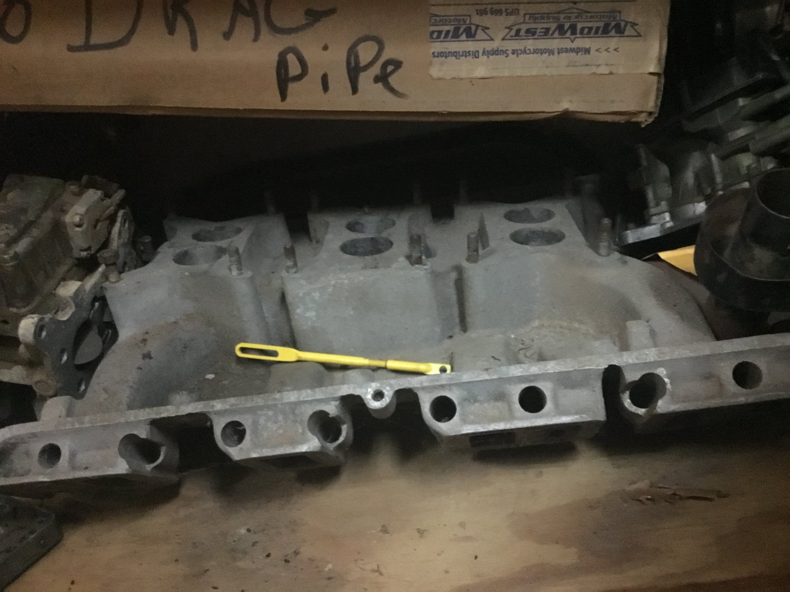

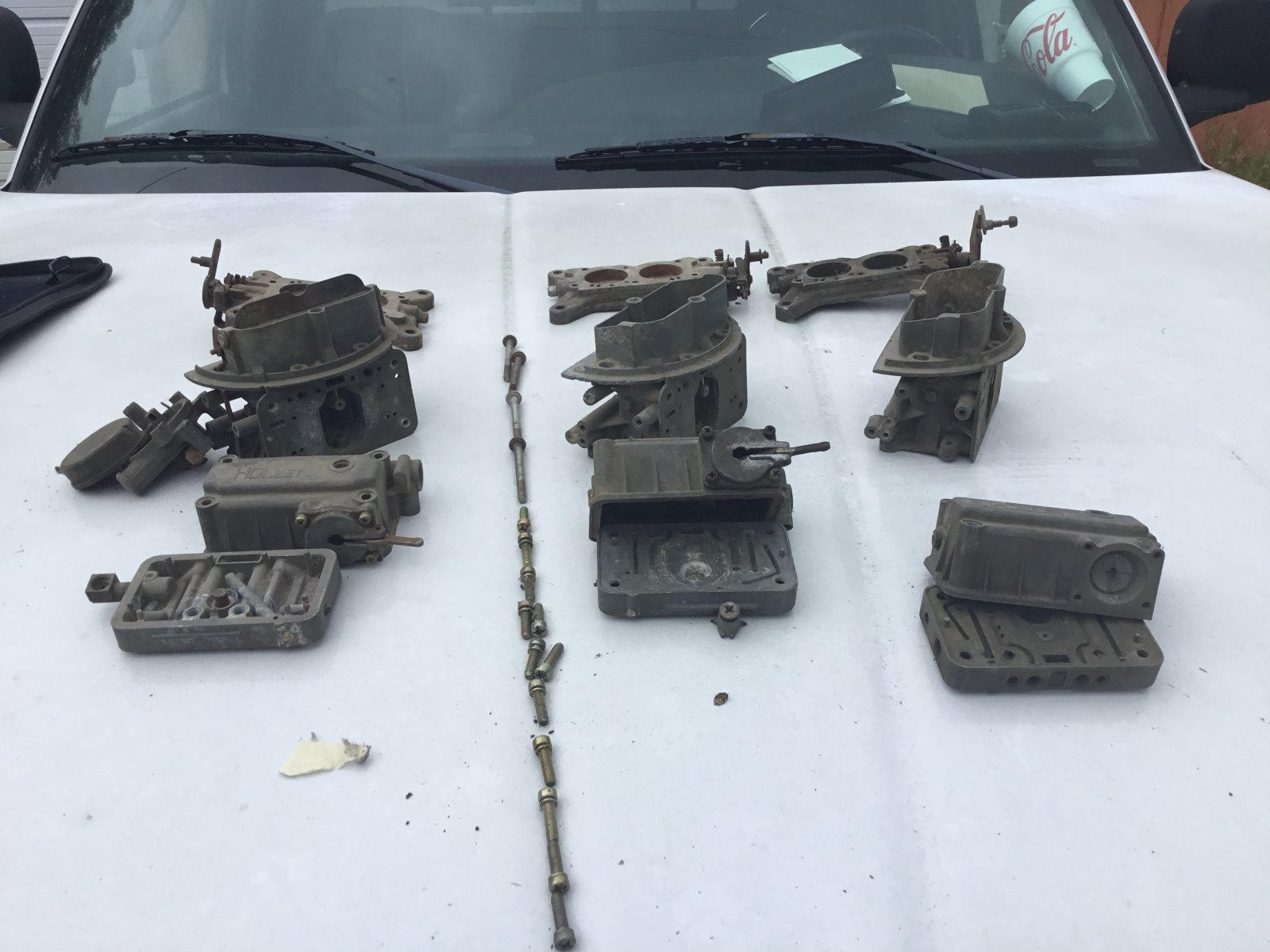

    You mean this one?
