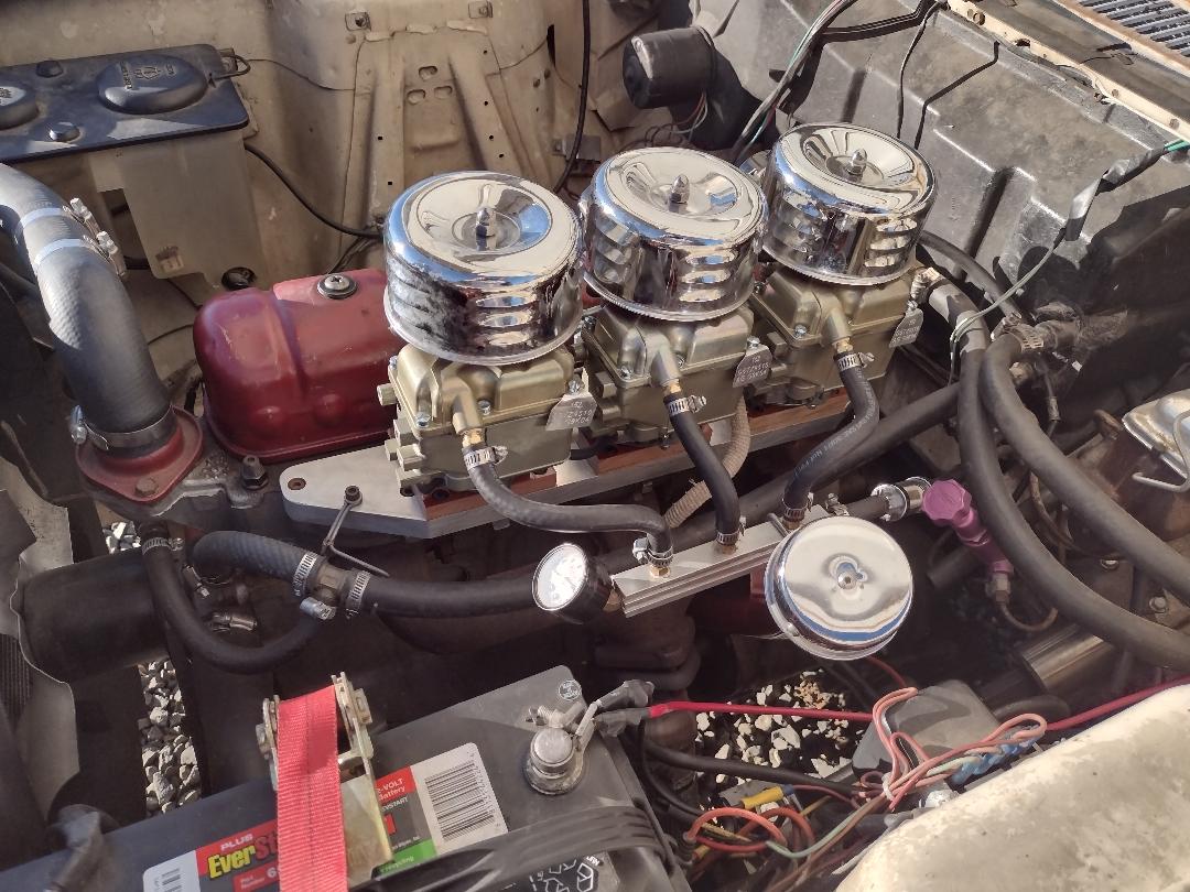

    Because 2 single barrel manifolds for a Rambler 196 straight six were selling for $400+.

    now that's bad***!!

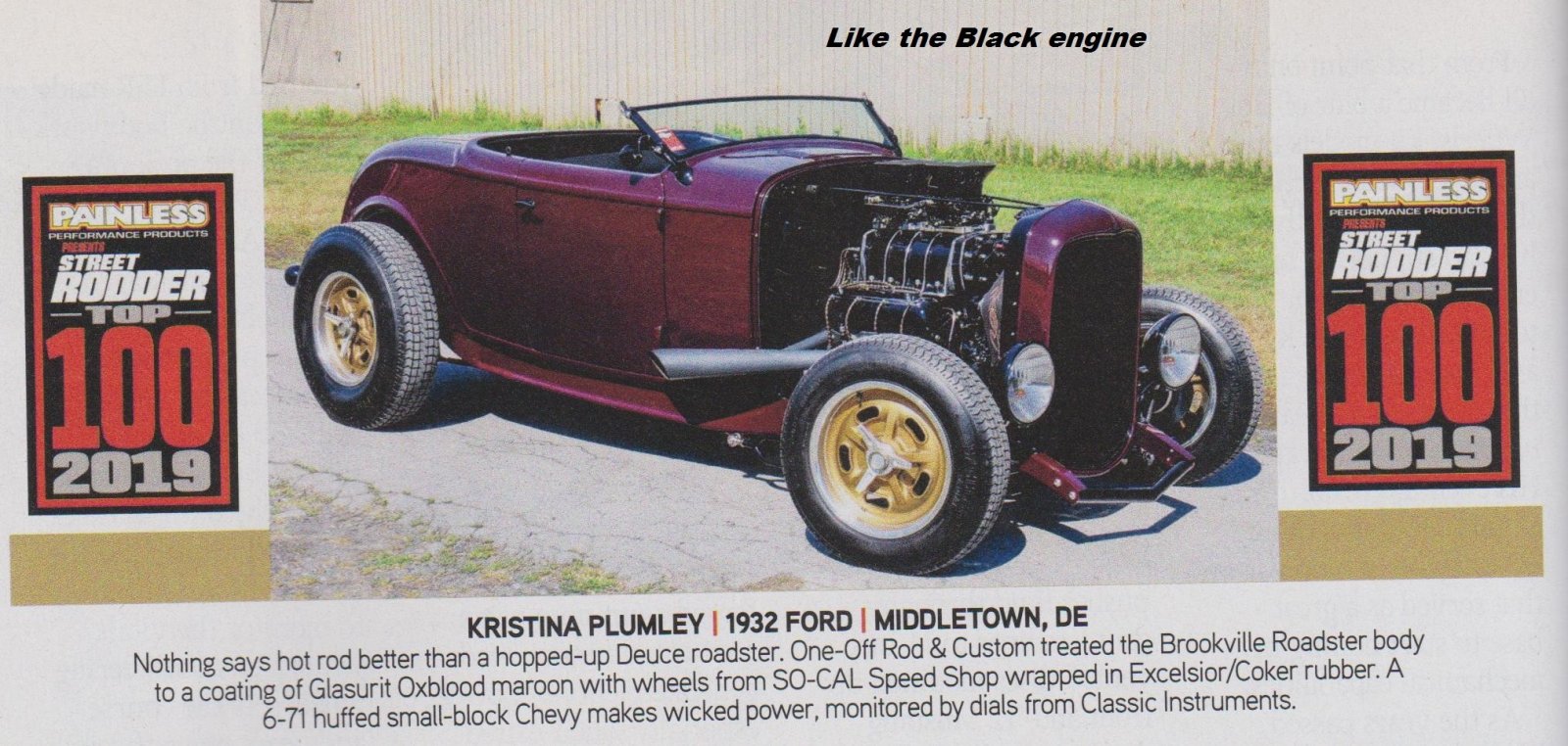

    Mikey, thats a perfect example of a car that had lots of thought put into how its going to look. Don't think too many people would look at it and use the word "cute" to describe it. Not saying only vehicles that look like compe***ion coupes. I've seen a lot of cars that were mildly hopped up that said "performance". To me its all about using components that look like they actually do increase the performance, and are logical for that engine. The picture below is another example where it looks logical and increases performance. Its very well done.
    Lot to admire about this. If I saw it at a rod run, I'd be wanting to talk to this guy. Look at the little details to appreciate what he actually did.
    When I look at an engine, the thing that registers to me is not whether it has the dipstick in the right place or 2 humps on its heads, or etc.............but whether the components actually appear to work well together to provide power. A whole lot of glitz does not impress me, and my opinion is that the person who built the engine doesn't understand that just putting more and bigger doesn't always work right.

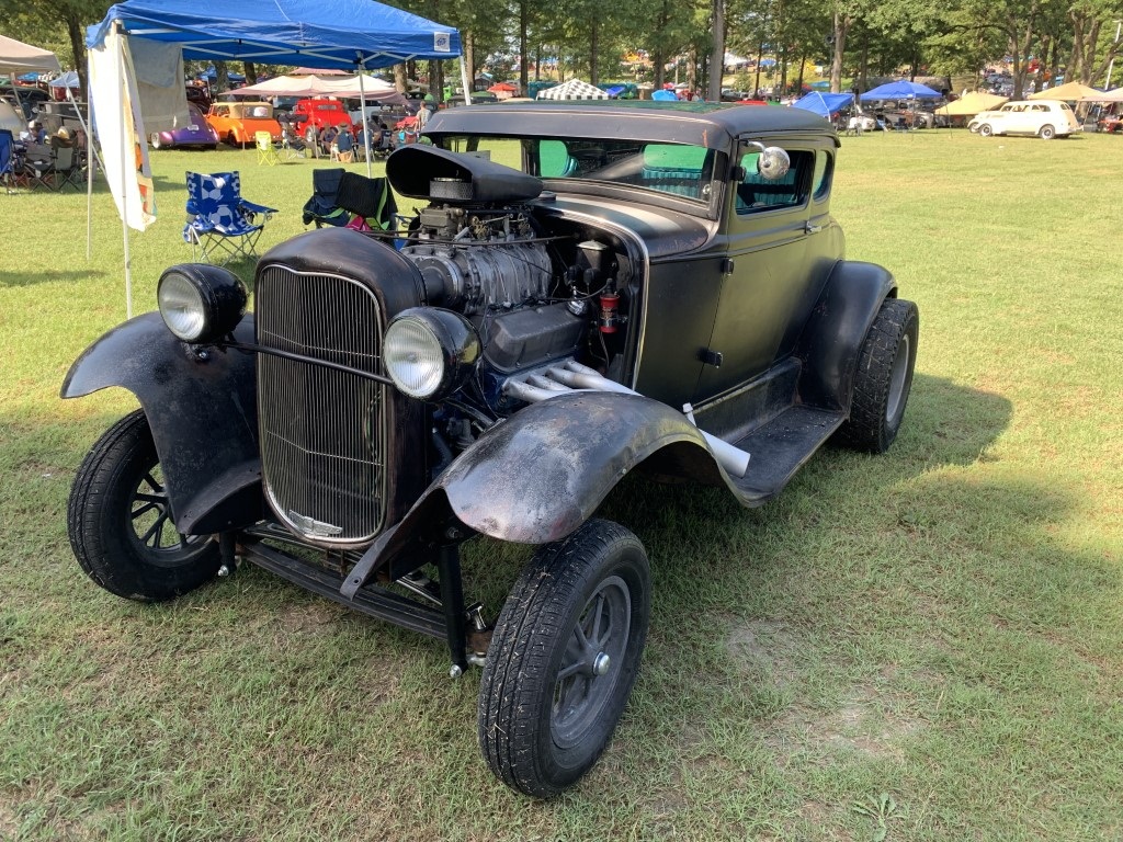

    Here are some cars that say performance to me.......

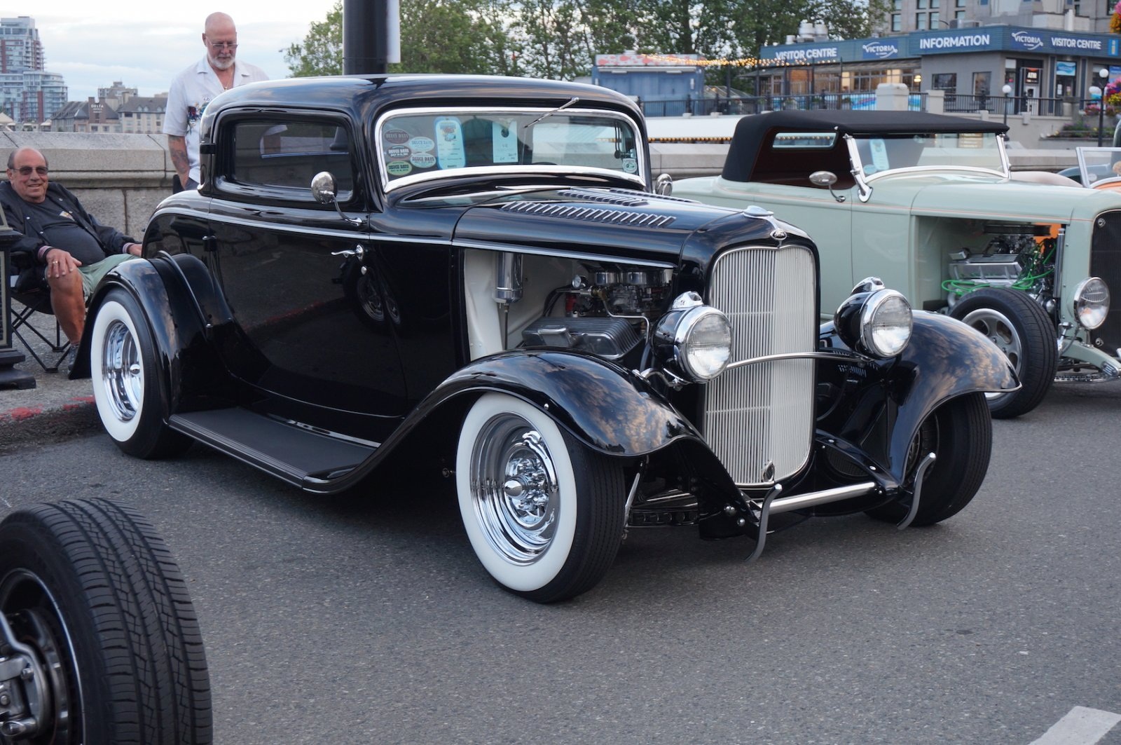

    Here is one that says "cute" to me. 3 dueces but the at***ude of the car just doesn't say much about performing well. Nicely done, but "cute"

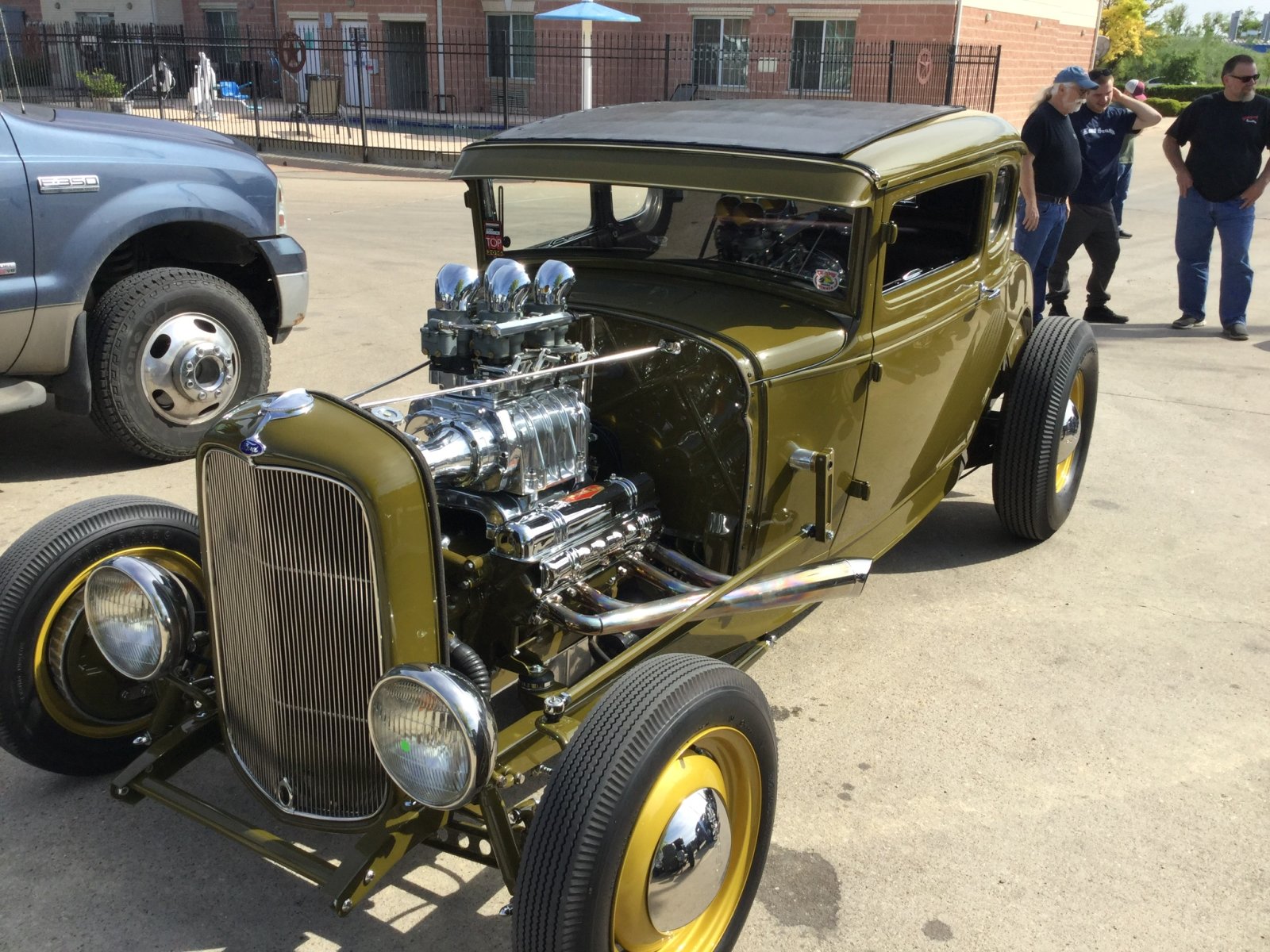

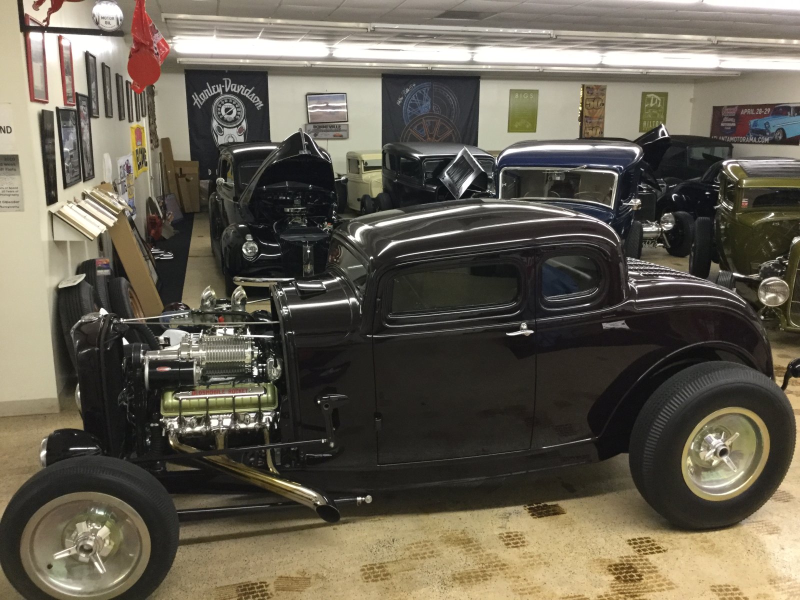

    And the last one is probably the best example of a car that looks like a "poser" in my opinion.
    Its a nice car. But what jumps out at me is first the guy went to the trouble to supercharge it then only used 2 two barrel carbs on it. Second, the supercharger is kind of small, so its going to need to operate at a higher rpm to make much boost...so is it really helping ? Chrome fan blade and chrome ignition components. Just says to me that its never really driven or raced.....just for looks.
    I know others may not agree with my ***essment of how a real hot rod should look. Its not about having a blower, but no matter what components someone choose, they should look like they work together.
    OK, stepping down off my soapbox.:cool:

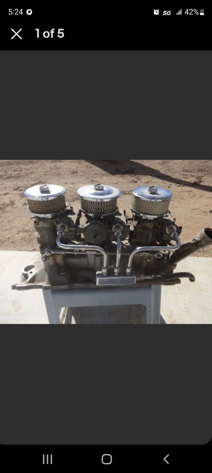

    this sweetheart is on the way to my house. Screenshot_20221126-172416_eBay.jpg

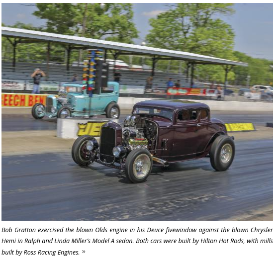

    With all due respect,
    @ekimneirbo
    I believe this is a very traditional setup.
    Quite typical for the time.
    Pretty high-end, even.
    '32 5W... check
    Olds motor... check
    Vintage SCOT blower... check
    Two Stromberg 97s... check
    (Edit: Two Holley 94s... check)

    Not sure if I could agree with "poser" as a description of the 32 in your last pic. I see what you're getting at but I've seen that car run. Motor was built by Ross Racing and ***uming the smaller blower and two large 97s were sized to the 324 CI Olds.....and it works. Not a drag monster by any means....but it ****s and gets with that combo. It's a Hilton built car and I'm sure looks figured into it - but it's fully functional.:)

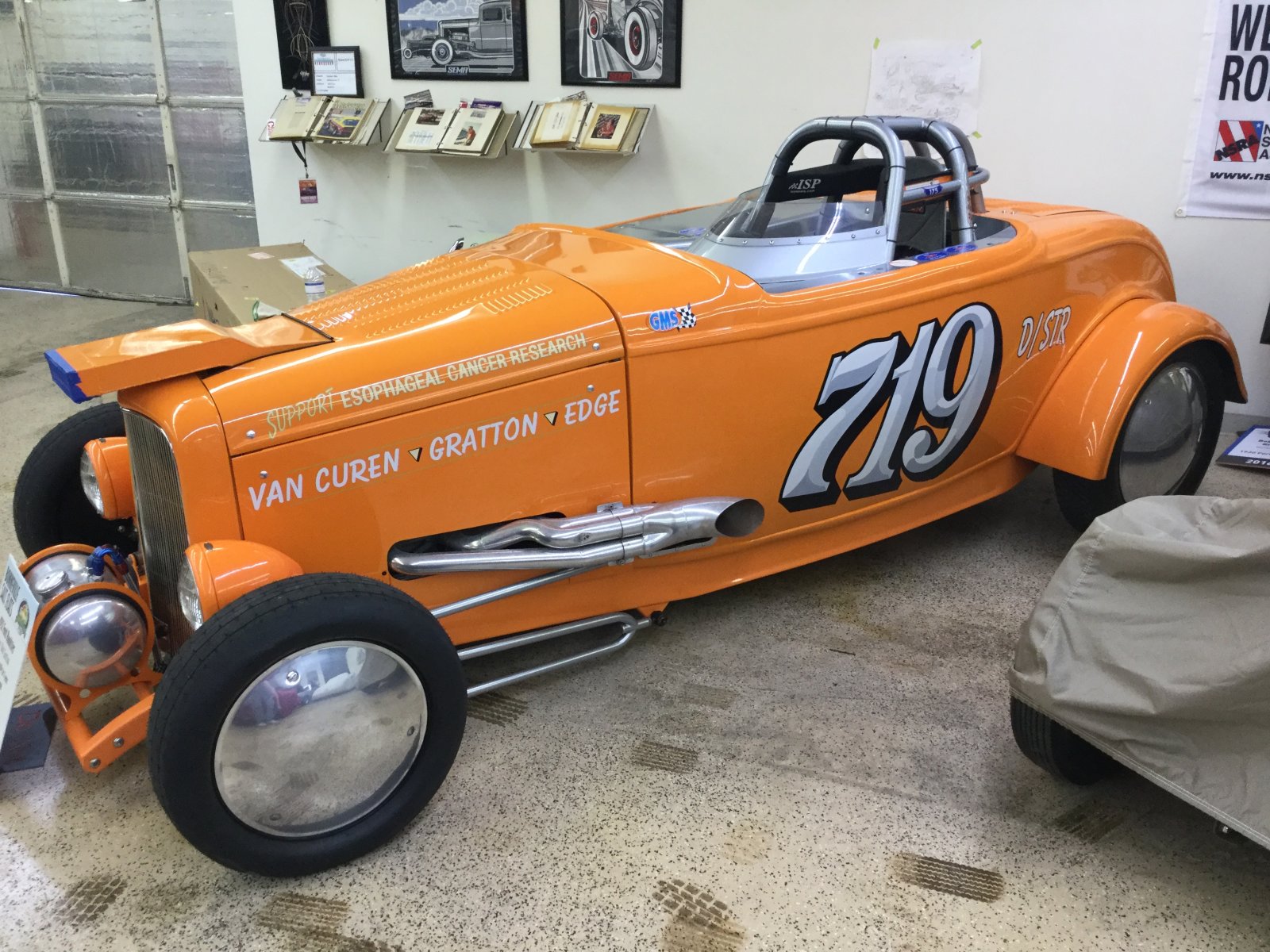

    Just wanted to make a comment on the fellow who called the deuce coupe a “poser” and questioned the use of chrome,small blower and two carbs. Not sure what type of high powered hot rod he drives or how many long distance trips he makes in his hot rod but I can ***ure you this hot rod has made many 1000 mile plus trips,been down the drag strip countless times,done the best and smokeyest burn outs in Goodguys history at the “Hot Rod of the Year” durability run Nashville
    And run like a champ. I’m sure Tony from Ross Racing Engine
    Would love to have your brilliant input on his engine building abilities or Bobby on the vast experience you have on style and design when it comes building hot rods. Maybe you should drag your hot rod out and we’ll bring one of our hot rods out and we’ll take us a nice long ride and wind up at the drag strip and have us a friendly little wager on who trips the lights at the far end first. Now I’ll step down from my “soapbox”
    Take your pick,we’ve got a few hot rods B0E2079C-4108-48DA-B441-3689C63E652D.jpeg 83C8A214-6CD3-467C-9E06-FF2A22FD169B.jpeg 392DB7B6-CEFC-41D7-96B2-20C14B0A9B5C.jpeg 94F99B55-A062-4593-BBD1-08518DB4700C.jpeg

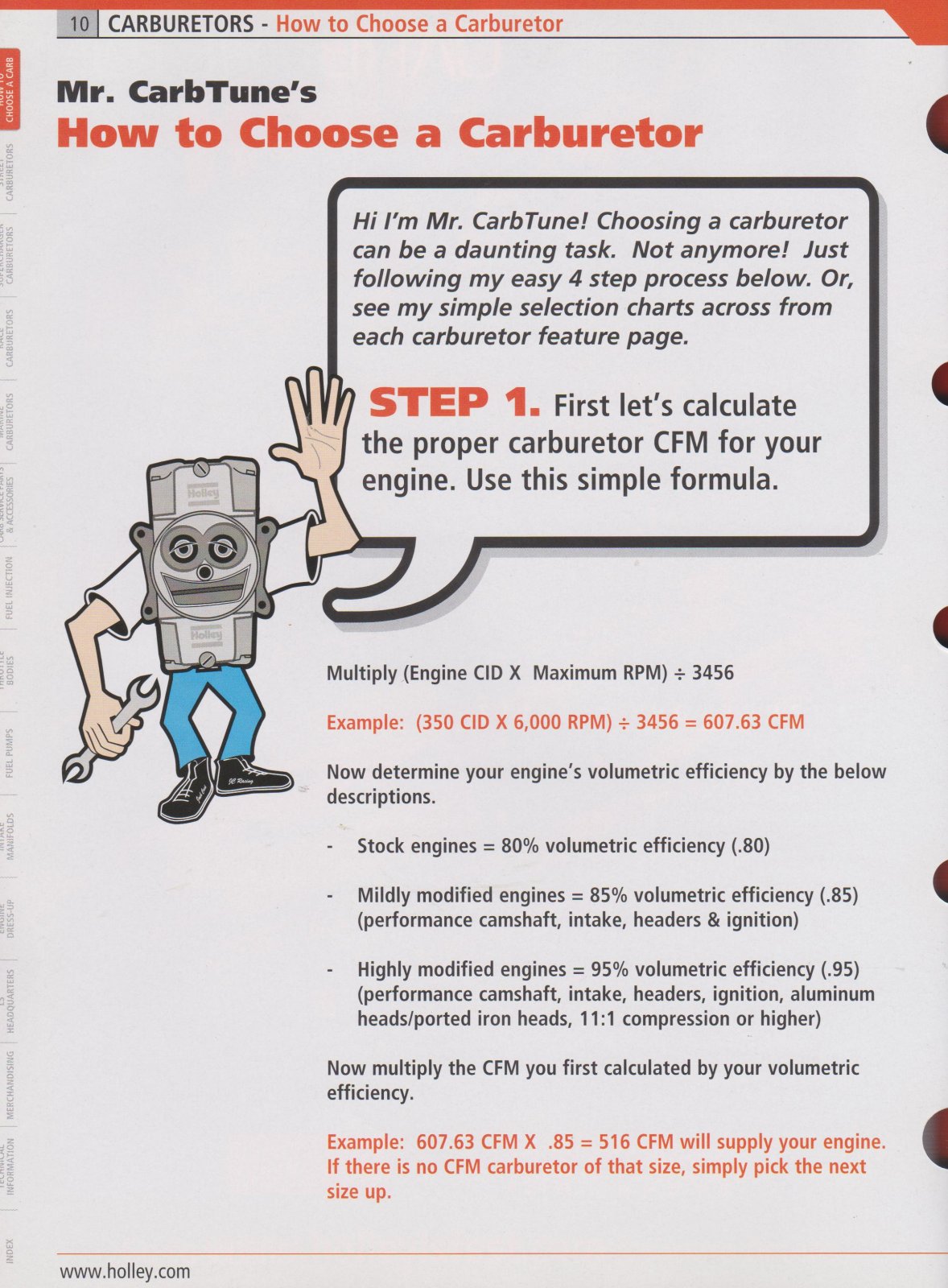

    As for carbs for it, I planned on using 2 Holly 465 cfm carbs to control the air if naturally aspirated......but after talking with a rep at a well known blower company, I'll probably be going larger than that. Depends somewhat on whether I use the used GMC 6-71 or a new 8-71 which would be better suited to 500 cu in.
    Here is what Holly says about carb selection .
    Now, it would seem logical that with a blower moving even more air at wot, the size of my carbs will need some further thought. So when I see a supercharged engine with two 2 barrel carburetors controlling the amount of air that can flow, I have to wonder how that works.
    The original topic question was "Why are multi carbs so popular"
    The answer is that when done correctly they can increase power, and an engine that has them on it will appear to have superior performance, thereby looking Kool. Unfortunately there are many multiple carb set ups that did not look astetically appealing and many did not provide a performance increase. As time went by, logical people learned what actually worked and what was a waste of money.

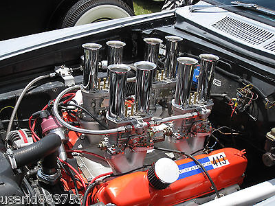

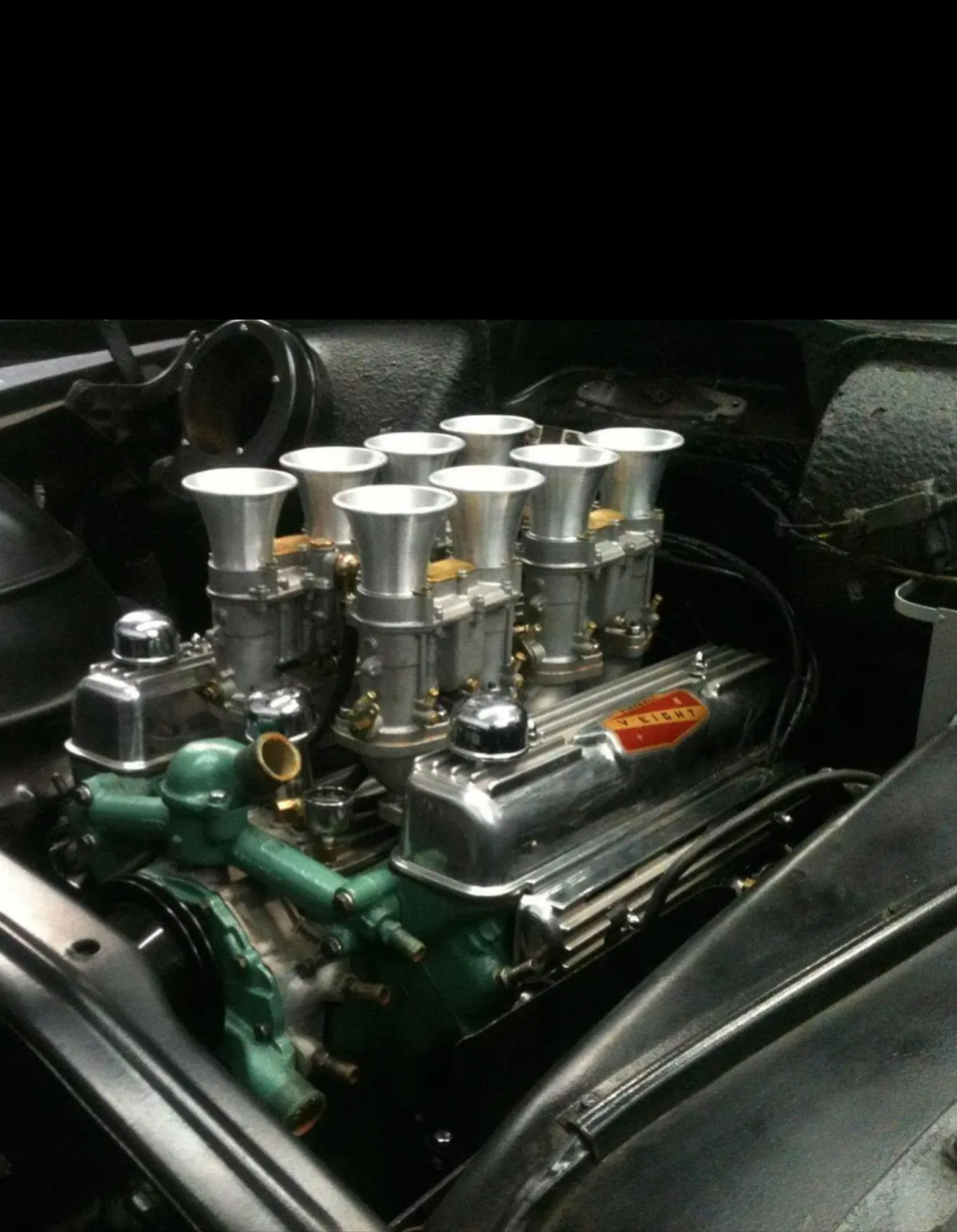

    The question is asked, "Why?".
    And the only two possible answers given are "looks and performance".
    Not fair. Not enough choices.
    The answer is history. Tradition.
    Always.
    And looks and performance of the time are part of that tradition.

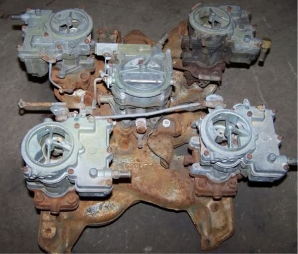

    Here are a couple more reasons "why".
    One carburetor throat per cylinder.
    Goooood air/fuel distribution.
    Goooood throttle response.
