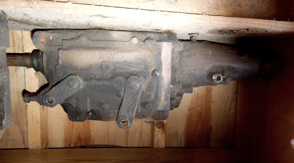

  13. krgdowdall
    Joined: Apr 3, 2015
    Posts: 142
    krgdowdall
    from Alberta

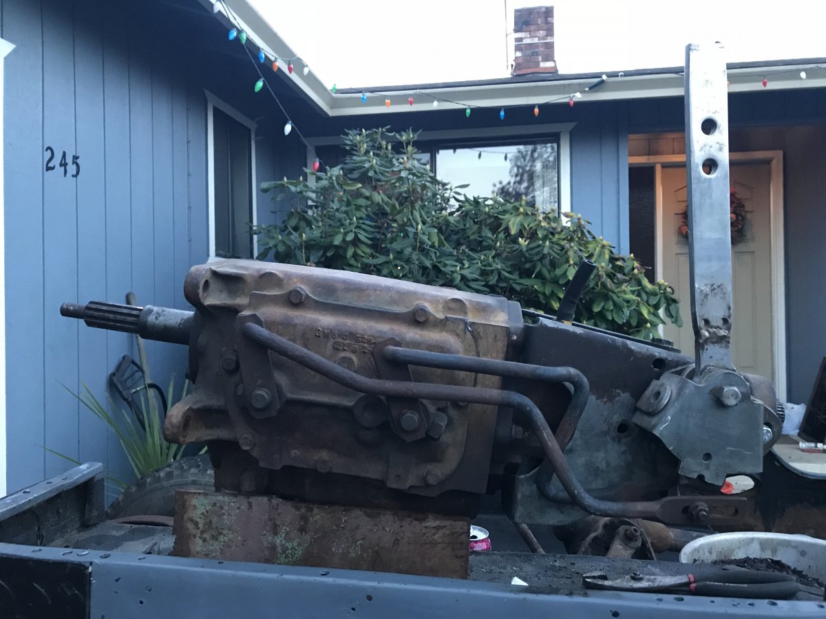

    Your photo shows the shifter on a mounting plate. Does the transmission have threaded bosses cast in the tail shaft housing to mount the shifter. The Transmission photo from Chevy57Dude does not show any cast bosses indicating it is probably from a truck. GM used this Trans in 1/2 and 3/4 ton trucks, Vans and taxi's into the mid eighties. Some had very low 1st gears. The Muncie 3 speeds used in cars through the 60's had the shifter mounting on the tailshaft housing. It is a rugged transmission, and was standard with the big block full size Impala and Biscayne's I don't believe the Hurst Syncro-Lock could be configured for a straight line shift pattern, only the conventional H pattern.
    chevy57dude likes this.

  15. squirrel
    Joined: Sep 23, 2004
    Posts: 60,084
    squirrel
    Truck transmissions through 1972 had the two lower holes (where it bolts to the bellhousing) threaded, because those bolts go in from the front on trucks. Something about being compatible with the SM420/465.

  17. superduper88
    Joined: Sep 13, 2007
    Posts: 214
    superduper88
    This ****** came out of a van, that’s what the guy I got it from thought anyways. It does not have the shifter mounting bosses in the tailshaft.
    1Nimrod likes this.

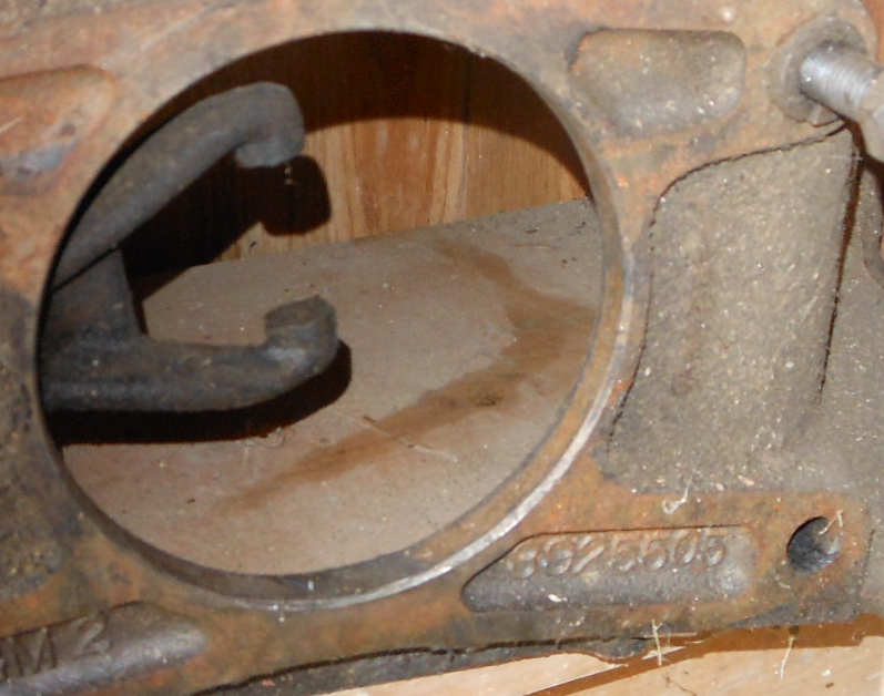

  18. 56sedandelivery
    Joined: Nov 21, 2006
    Posts: 6,694
    56sedandelivery
    The p***enger cars these came in, the nova's/Chevy II's, Camaro's, Chevelles, Vette's (???) had a shifter that bolted to the cross-member, not the transmission; same deal with the Saginaw's and the cross-member mounted shifter. Those brackets and shifters are on E-Bay all the time. My 72 Nova SS had a Saginaw 4 speed with that shifter; tore it all out for a Hurst, but that still did't help the Saginaw. I wound up with a later model T-10, used the Saginaw Hurst and a few spare pieces from the "Hurst bin" at the speed shop. There are a couple of these HD Muncie 3-speeds for sale locally on Craig's List; one for $75.00. I don't think they even know what they have. I am Butch/56sedandelivery.

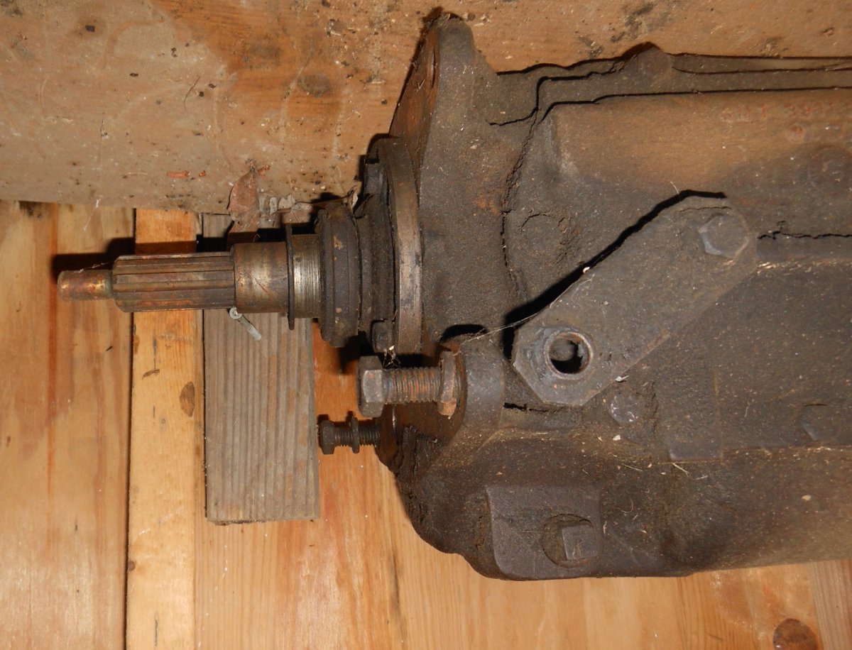

    2143EE77-454C-4F19-AE07-50891F9AD620.jpeg Don’t roast me too bad, I’ve never done shift linkage before, but I straightened and re bent the rods I had and made them fit. It shifts into all the correct gears in the correct pattern, and don’t rub each other or bind up. A friend of mine is going to help me fine tune the adjustment on it tomorrow but looks like it’s going to work perfect! Not bad for misc used parts cobbled together. Couldn’t have done it without the info, thanks again guys..!
    -John

  24. 56sedandelivery
    Posts: 6,694
    56sedandelivery
    Muncie 318 and 319 transmissions had a FOUR bolt side cover, 55-65.
    Saginaw 3/4 speeds both had a seven bolt side cover, 65-mid-70's (?)
    HD Muncie 3 speed also had a seven bolt side cover, but the bolts are in a different orientation. One thing I've wondered about, is why there's another un-machined boss on the side cover, like a Saginaw 3 speed also has; that boss get's machined when it's used on a 4 speed Saginaw. See my previous posts for the HD Muncie years and apps.

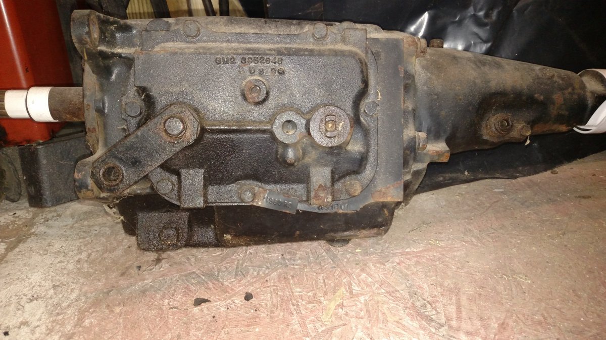

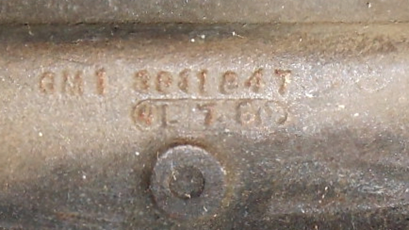

    1Nimrod likes this.
  26. Just guessing the same side cover dated oct. 15th 1973 having 5 mounting ears must be a 351 Muncie

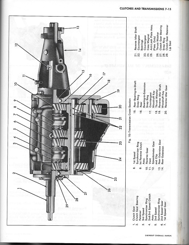

    Does anyone have an exploded view diagram of this Muncie 3 speed transmission?
    I want to talk it apart and clean it but would feel better about it if I had some type of reference..
    Is there a book or PDF somewhere?
    1Nimrod likes this.
  29. Fordors
    Joined: Sep 22, 2016
    Posts: 6,586
    Fordors
    From the 1971 GM Chevrolet Ch***is Overhaul Manual-
    Scan_0281.jpg Scan_0282.jpg Scan_0283.jpg Scan_0284.jpg Scan_0285.jpg Scan_0286.jpg Scan_0287.jpg
