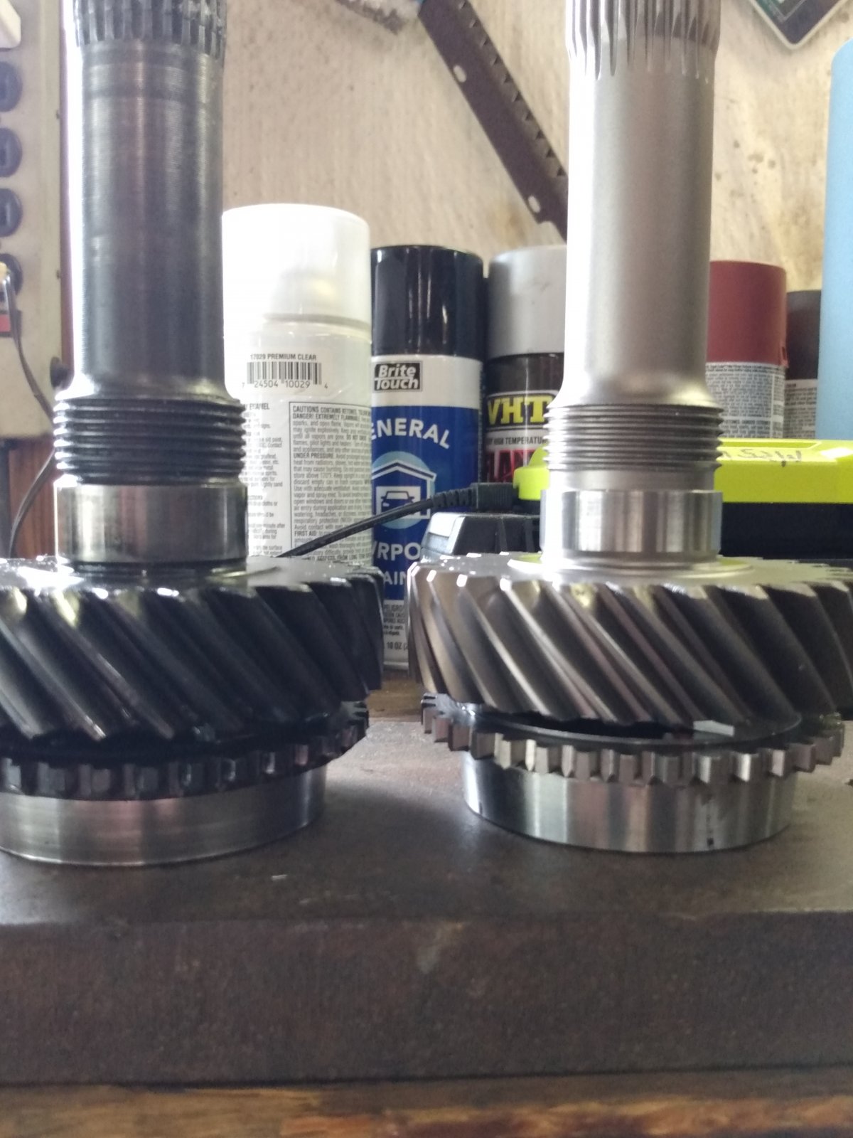

    No expert here but we have done these before........Late M21. I bought parts from a reputable place not some generic ebay parts. It goes all back together, rotates fine, gears shift BUT the bearing sticks too far out the end. The bearing retainer won't go back on all the way. I know there are different sized gaskets but we are off further than that.
    The input shaft on the new one appears to be slightly longer. Pics attached. I called the place I bought them from and he said he can see the difference but doesn't know what to tell me.
    Any ideas?

    Sure looks like a defective part. Ask for a new one, but ask to have him measure it first?

    Have you measured all sums from the other direction? Perhaps beveled end for synchro is where things are off.

    Agree with squirrel. Looks like the syncro cone is taller on the new shaft, as Johnny Gee mentioned.

  10. Are you certain it is the correct application ?
    Several dimensions look wrong just by looking at it,,,,,the area where the bearing sits looks narrow.
    And even the threads for the locknut look like the wrong pitch ?

  12. I'm agreeing with Tommy and squirrel on the cone height and the bearing race, not sure on the thread pitch but the length of the threads is suspect to me.

    How much was the bearing sticking out of the case? Actually, isn't their a snapring on the front bearing that goes tight to the case under the retainer? How much of a gap is their between case and the snapring? Might be excessive tolerance stack-up.

    There should not be any gap between the bearing snap ring and the case. If there is, the syncro ring is either bottomed out on the gear or the main drive is hitting the main shaft. Are you sure the rear bearing and snap ring are fully seated in the mid plate?
    The syncro ring register does look longer and the overall height looks taller in the photos?
    When you install the front bearing retainer on the trans without a gasket and snug it up, is the 4th syncro locked up? If it is then either the main shaft is too far forward or the main drive is too tall.
    Also that's likely a Korean main drive gear, due to it having back cut engaging teeth. That gear should be really used with the back cut Torque Loc style slider also.
    All of the way better Italian (Auto Gear) gears that I have seen, do not have the back cut engaging teeth, like OE and should use an OE style straight cut slider.
    If the bearing snap ring is bottomed out on the case and there is play in the syncro ring, and the main shaft will easily turn independent of the main drive, in neutral, then the most likely cause for the bearing retainer being too far away from the case is, the new bearing snap ring has too large of an OD and wont fit the snap ring register in the bearing retainer. Use the original snap ring. I see that all the time.

  19. I don’t think I would have it machined,,,,,,I would ask for my money back .
    Something just doesn’t look right about it .
    I bought a new pilot for my BW T 10,,,,,it was almost a duplicate of the old one,,,,,looked great .
    Also,,,,,several gears as well,,, top quality .
    You might have to keep looking for a supplier .
    Fit and function on transmission parts is very important,,,,at least to me .

    The height difference is not huge. Usually there is a lot of clearance in the 4th sycro , that I would think would compensate for the difference in height.
    When you snug up the retainer, is there slop in the syncro ring? If not then the problem is there.
    If there is slop, then the only other explanation is the main shaft is hitting the main drive.
    Possible that the bore in the main drive is not deep enough? Never seen that before but anything is possible.
    Bill

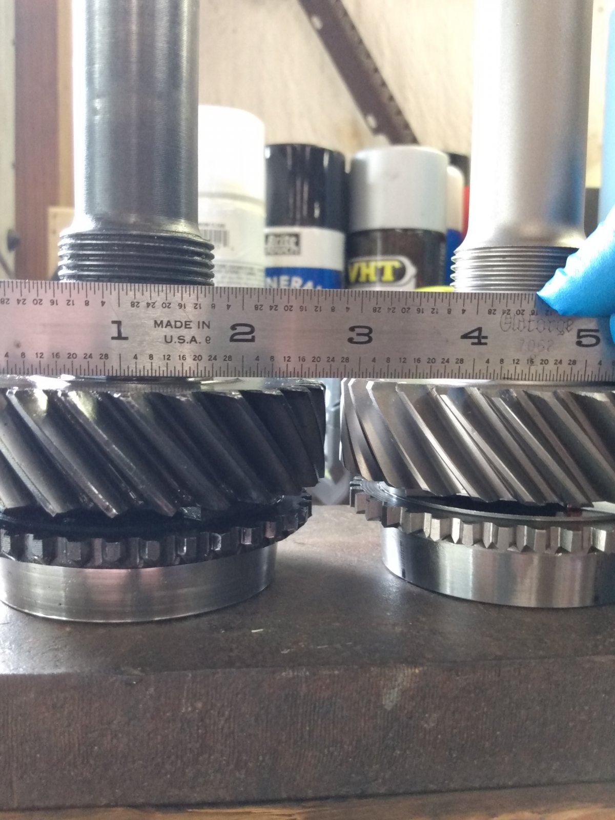

    So....it must be something else at least also........we put the old shaft and input shaft etc back in and it's still to tight.
    It may be closer but when you put the bearing retainer on and tighten it, it locks things up.

  24. Okay,,,good to hear this information .
    It does sound like something is not seated correctly in the main shaft area .
    I would go back and strip the entire main ***embly down and look it over.
    If you want to keep the pilot and grind the cone area down,,you could .
    However,,,I would want an ***urance from your supplier that you would not be responsible for the result .
    I know these parts are fairly expensive,,,I’m guessing 150 or better,,,,,?
    If you don’t feel comfortable grinding it ,,,I can’t blame you,,,,I wouldn’t either .
    It’s a brand new part and should be closer to spec then that .
    Tommy

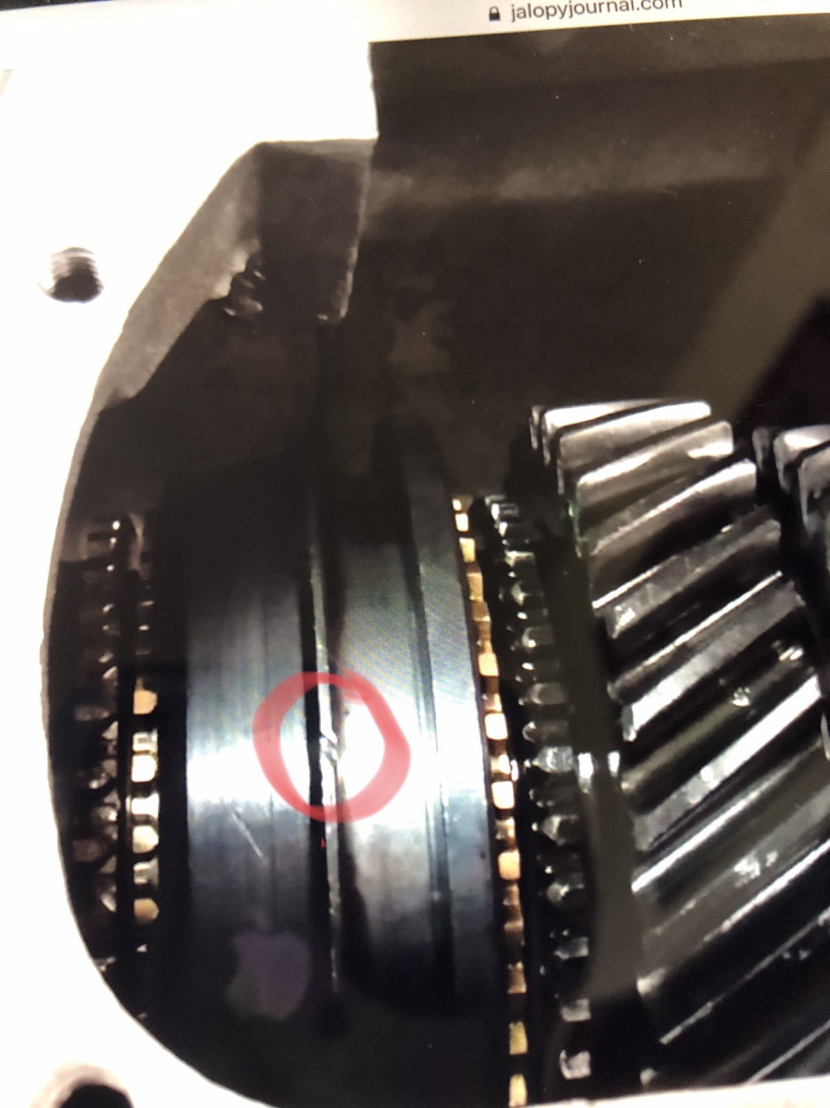

  25. BTW,
    I would smooth out the burr on that 1-2 slider,,,,it might wear into the shift fork .
    Tommy
