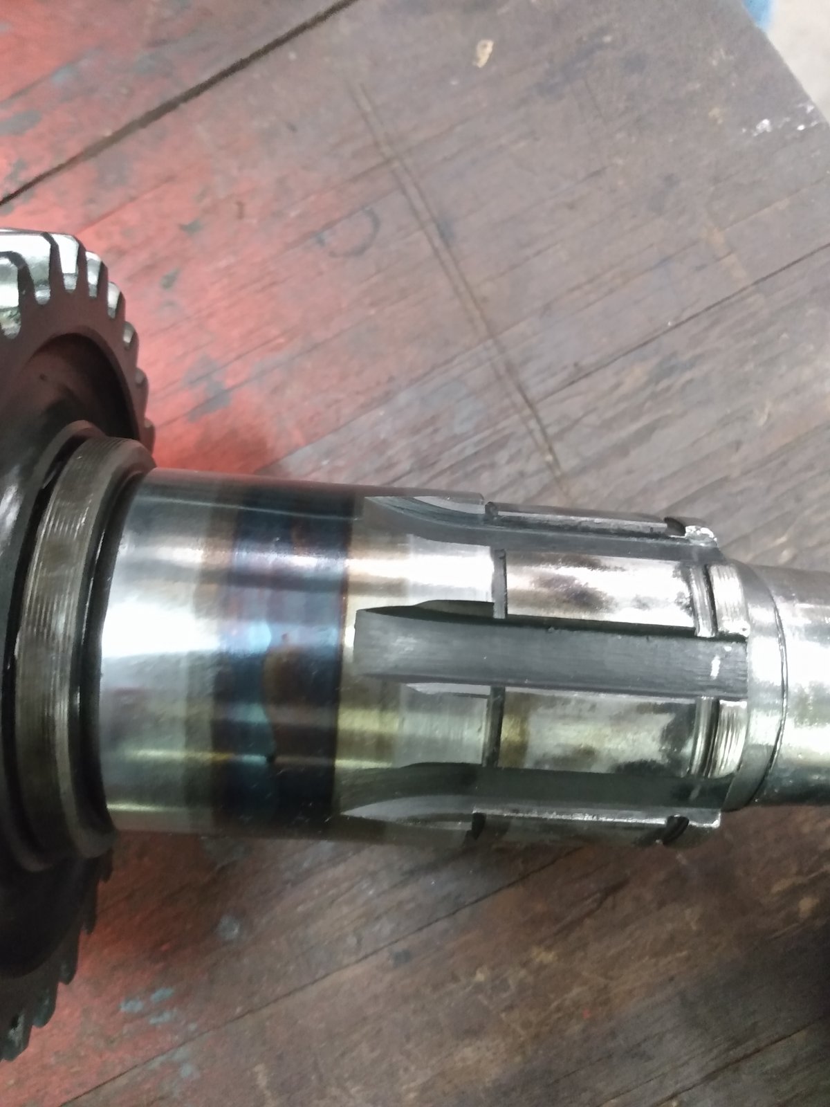

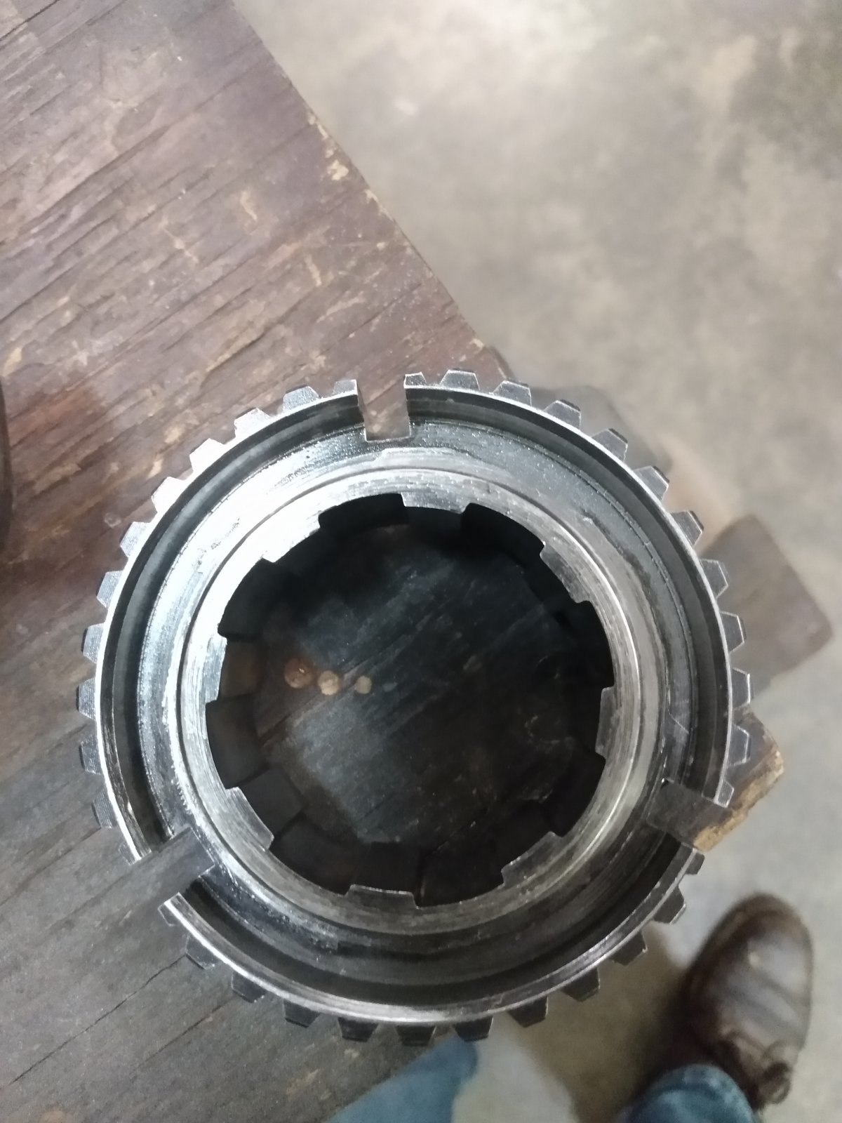

    Expert came by. We had it together right BUT its just not right. He thinks it's the synchronizer hub. It's NOT oem. You can see where it's rubbed where it shouldn't. You can see how hot the shaft has got.
    It never would shift right. If I thought it was just buying a new one........a good one.

  12. Third gear has been hot on the shaft,,,, was it a new gear from before ?
    Check the id for any wear or tight spots .
    Unless you have always owned the transmission,,,,,that could have been from a previous issue .
    Tommy

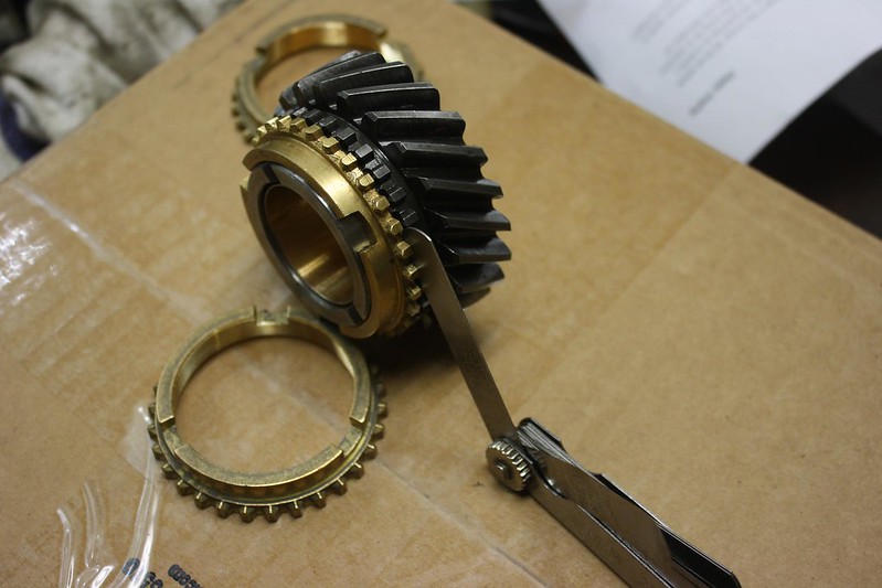

    Always check the synchro ring fit.Make sure they are not out of round..They can vary in ID size ,the best rings are forged bronze
    The fit on this is .035, I do believe the Muncie is the same.
    wvenfield likes this.

  20. Truckedup
    Joined: Jul 25, 2006
    Posts: 4,660
    Truckedup
    New or not they need to be checked for fit.. I have new ones that were out of round and or sized incorrectly...
