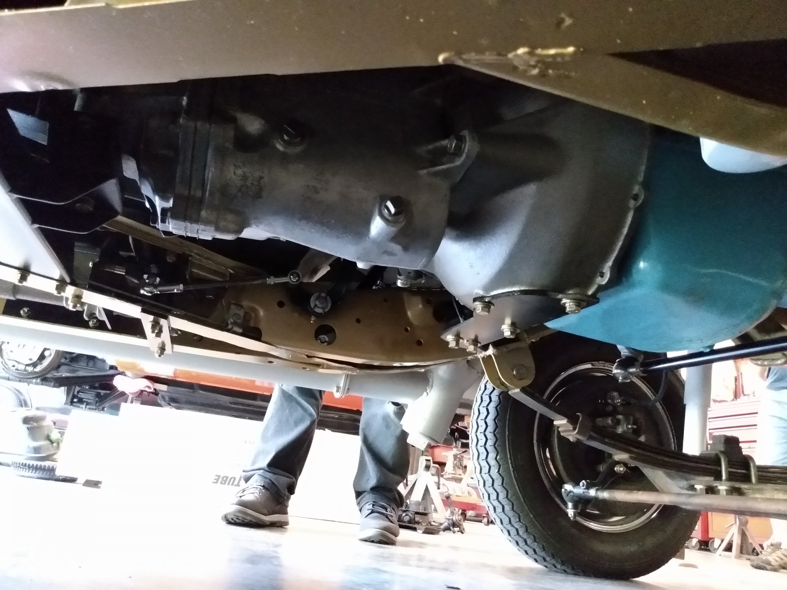

    The larger bearing I originally had on it had to have been put on there over 10 years ago. I bought the transmission nearly 7 years ago and the person I bought it from had it a while before that.

    I'm not really upset, I'd just like to know what is what. I saw where someone had made a retainer to allow him to use the thicker bearing but if I call somewhere to order parts and I tell them what I have and they are supposedly experts I would expect the right part or at least they would have some clue as to why it's not fitting.
    All said and done though now it shifts like through ****er.
  6. Bottom line is, it was a success and we all learned something.
