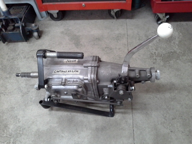

  11. DDDenny
    Posts: 23,002
    20170413_095151.jpg Nothing to add, just wanted to show off my M-20.
