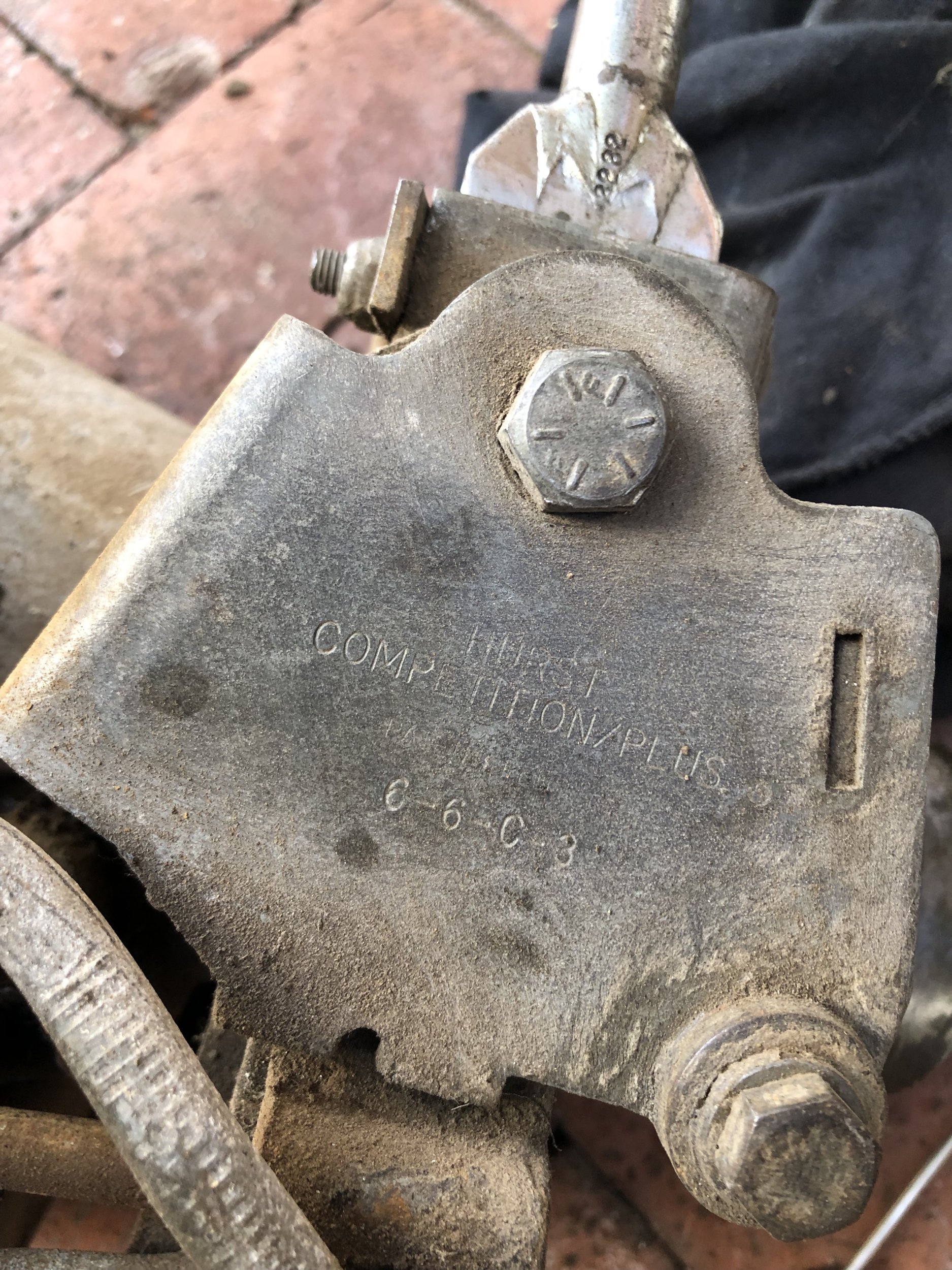

    Anyone know about this shifter?

    It's a Hurst , clean , dis***emble ,lube it , & run it .

    OEM GM? GTO? made by Hurst, note no stop adjusters.
    427 sleeper and saltracer219 like this.

    Yeah, '66 GTO most likely. GTO nerds will pay up for it.

    But still , a usable shifter , parts is parts..

    My point was only that it is devoid of adjustable stops because GM said "build us a million shifters as cheap as possible" so corners had to be cut to get the contract.

    However, those small pilot holes are in the right spots for the adjustable shifter stops. Drill them out, tap them with a 3/8 tap, get a couple 3/8 bolts and nuts, and you're done...or sell it to someone restoring a GTO and buy another shifter with the proceeds.

    Dang it. That’s why I bought it because it had the shifter with the linkage attached. The guy said it came from a Pontiac. I’ve got a bench seat ‘63 impala.

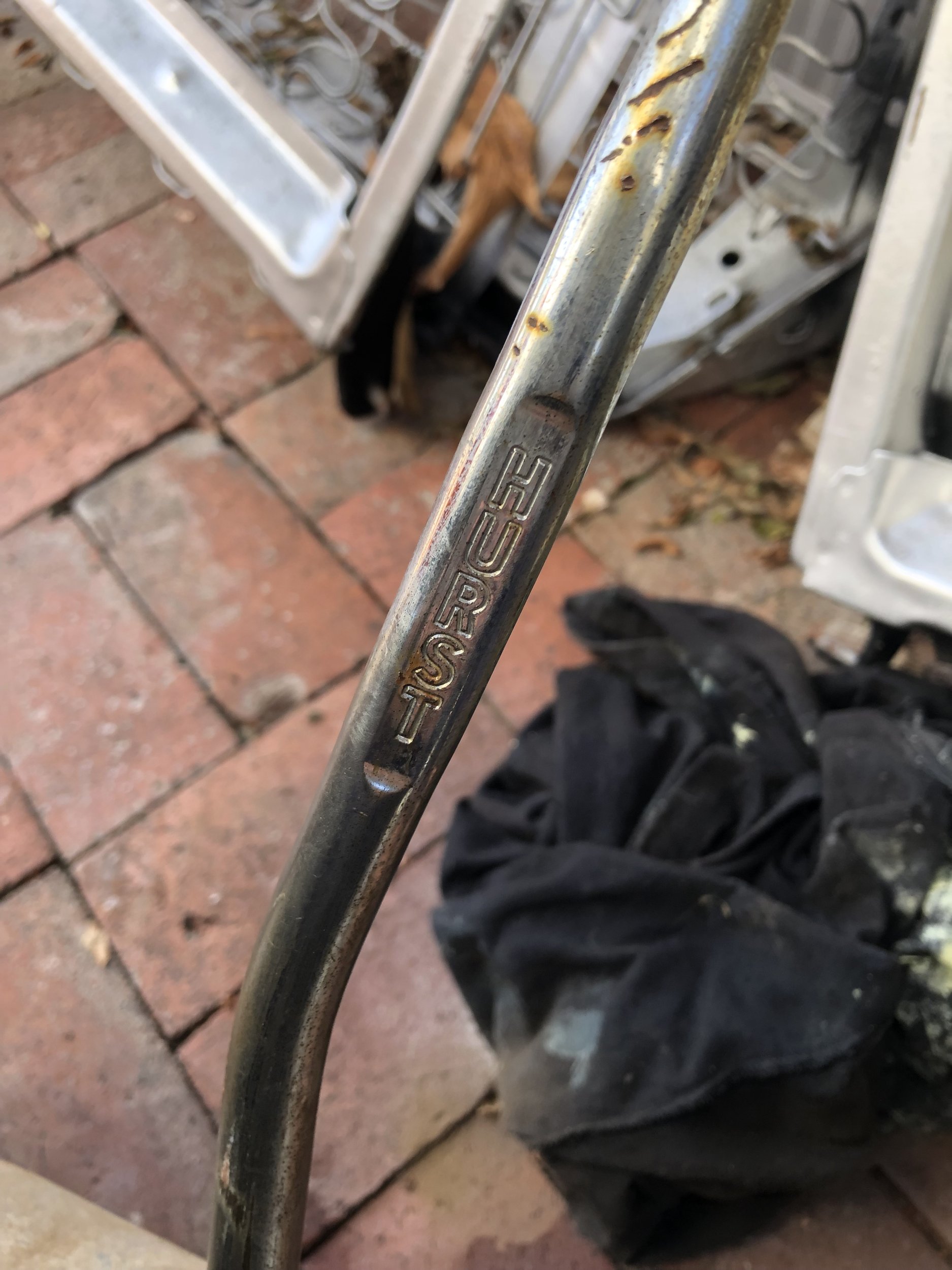

    You guys just said it’s a cheap shifter. Isn’t it for a bucket seats also? I wonder if I can weld this style of shifter

    It's just as good as any other Hurst Comp/Plus shifter, the stop bolts were intentionally left out to satisfy the bean counter's at GM, so Hurst could get the contract from them. The provision's are there if you want to drill and tap the holes for the stop bolts. The stick might even work for you, just gotta try it. As far as the main case goes, you're good there, too. The 010 case's have the 1" countershaft, not the 7/8" shaft of the 325 case. Stop worrying about everything and put it together already, drive it and have some fun. ;):D:cool:

    Hurst make great shifters ,and are totally serviceable.
    I would rather have that old shifter than a modern "out-sourced" shifter
    you can buy shift levers for bench seats
    Here is a 55-57 Chevy Bench seat shift lever for the Hurst shifter [it would probably fit your car]

    It's pretty simple to take a piece of 3/8 SS flat stick & custom make a shift lever that fits what you're doing .

    I would bend up some round stock [or an old lever from an early truck] and weld a bolt-on stub to it.
    This way you can make it look OEM or vintage

    Most Hurst shift arms that I recall are flat stock , shift arms made for OEM's were round , but that's my recollection ? And a Hurst shifters gotta be shiney !! :D
