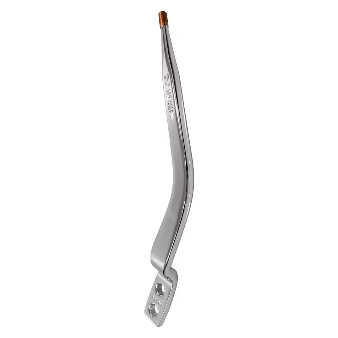

    Im building a’32 Ford roadster with a 283 and Muncie 4-speed. I three the bench seat in the car the other day only to find the hurst shifter rubbing on my leg. Is there a shifter that has an offset to the right that would move the shifter away from my leg? Thanks

    There's umpti-zillion different shift levers available , or you can heat & bend , cut& weld or fab your own .

    Get one for a 70 chevelle with a console

    Camaro/Firebird shifters had an offset toward the p***enger side.

    I used a Hurst for a Camaro in my model A. Works just right

    The amount you took out is about the amount I added. Then made a short lever from 5 /16 SS flat stock

    The stick shown definitely misses your leg. This one’s in my sons 40 Chevrolet with the GMC 6 back a bit. IMG_4057.jpeg
