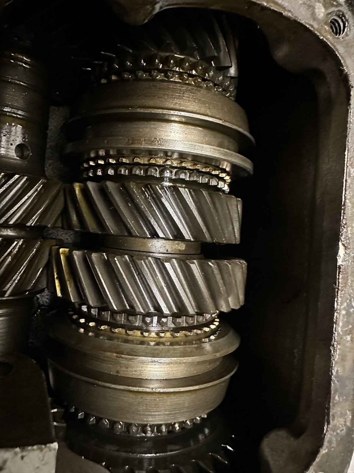

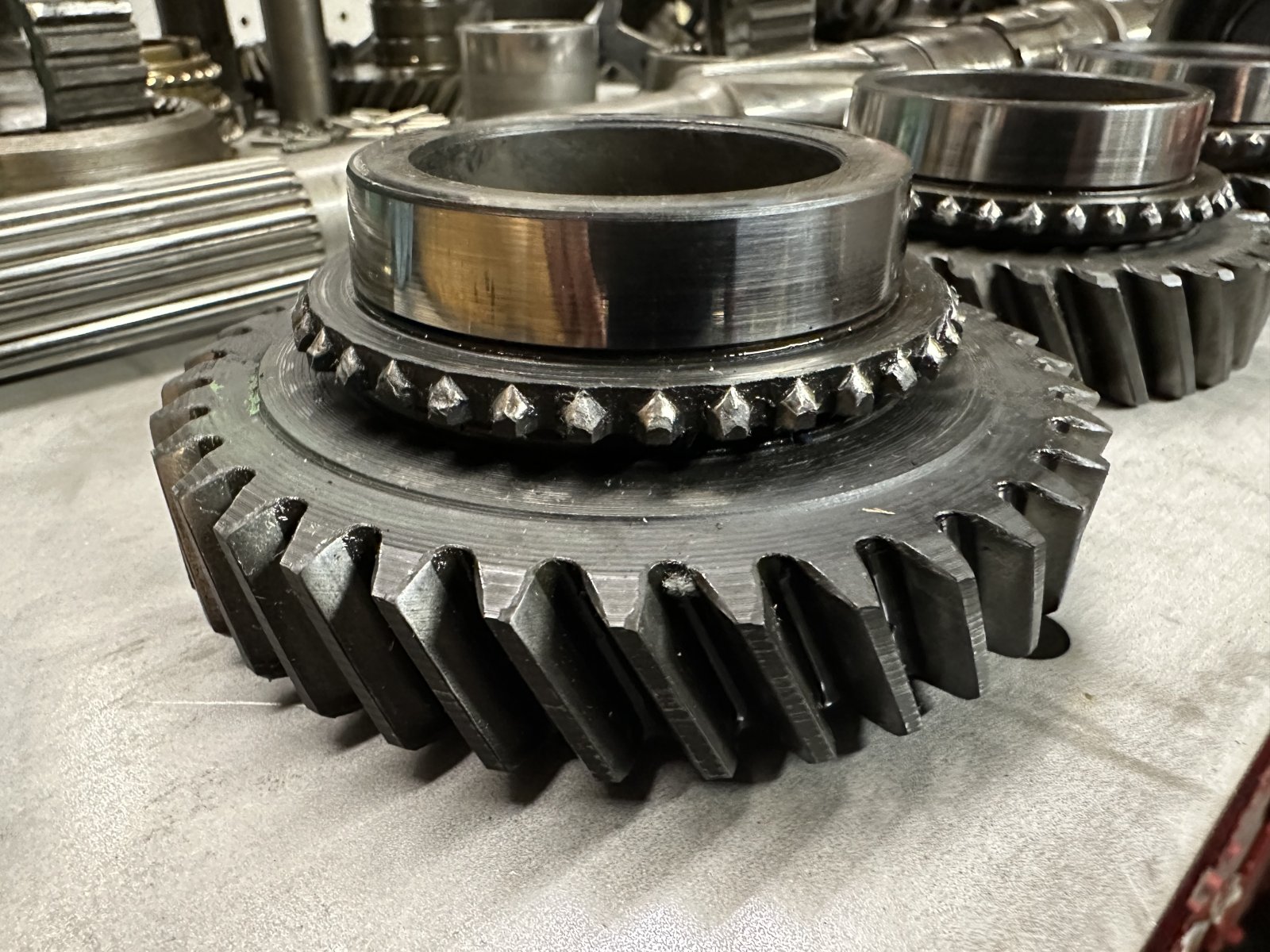

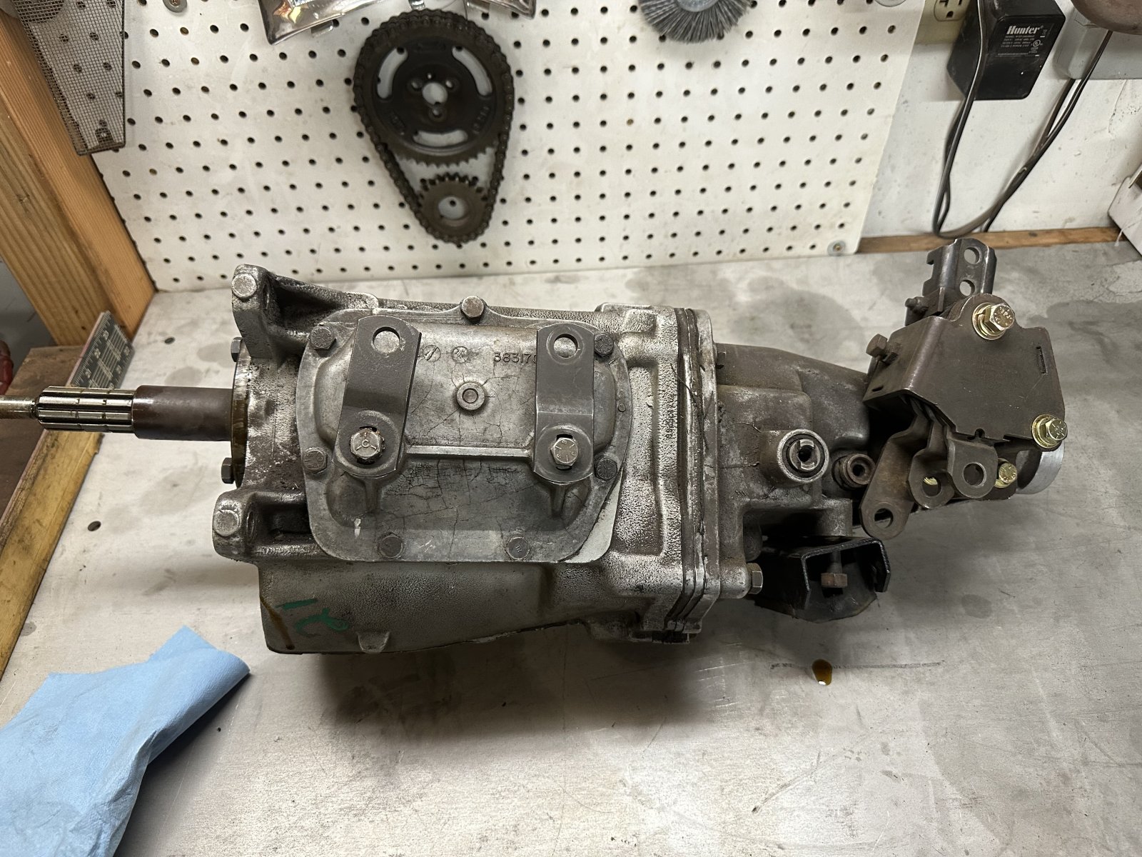

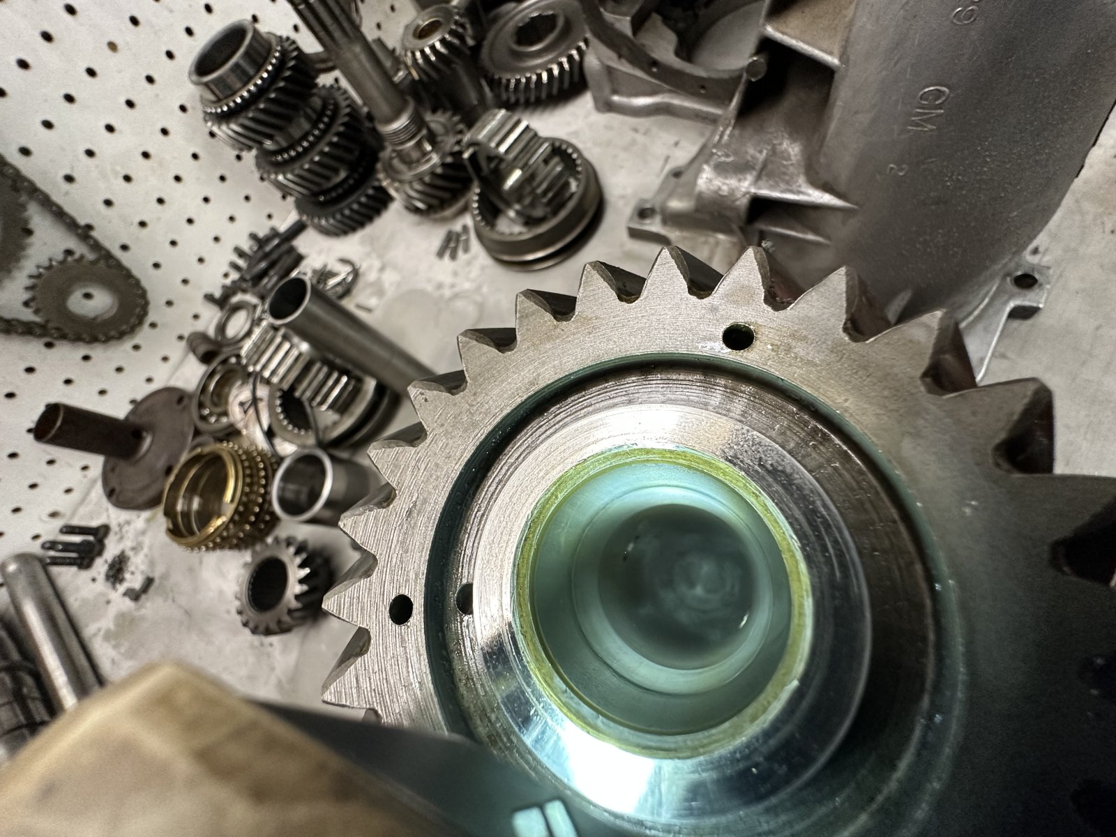

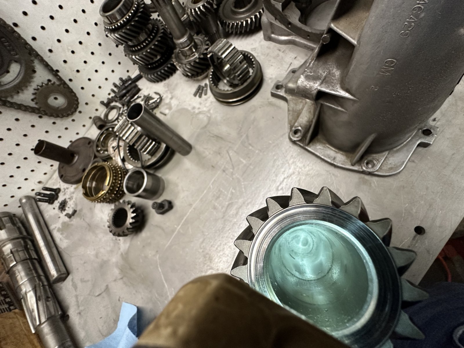

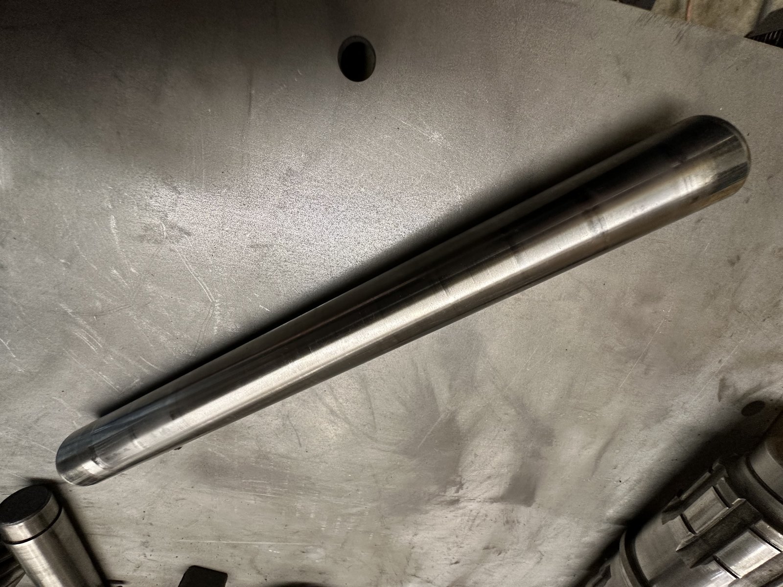

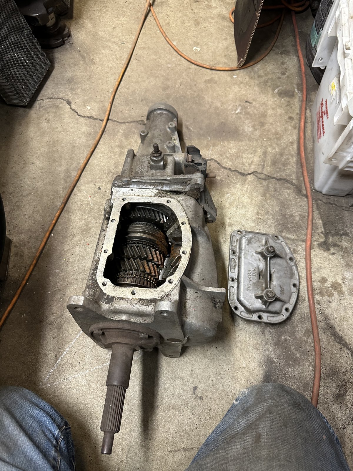

    I finally tore down the Muncie M20 I bought a year ago for my ‘60 El Camino. I got the Muncie, a rusty super T10, and most of a Hurst setup for a reasonable price from a guy who bought out ****** hoard and was selling it out. The M20 didn’t have a side cover or shift forks but he gave me some from the parts pile.

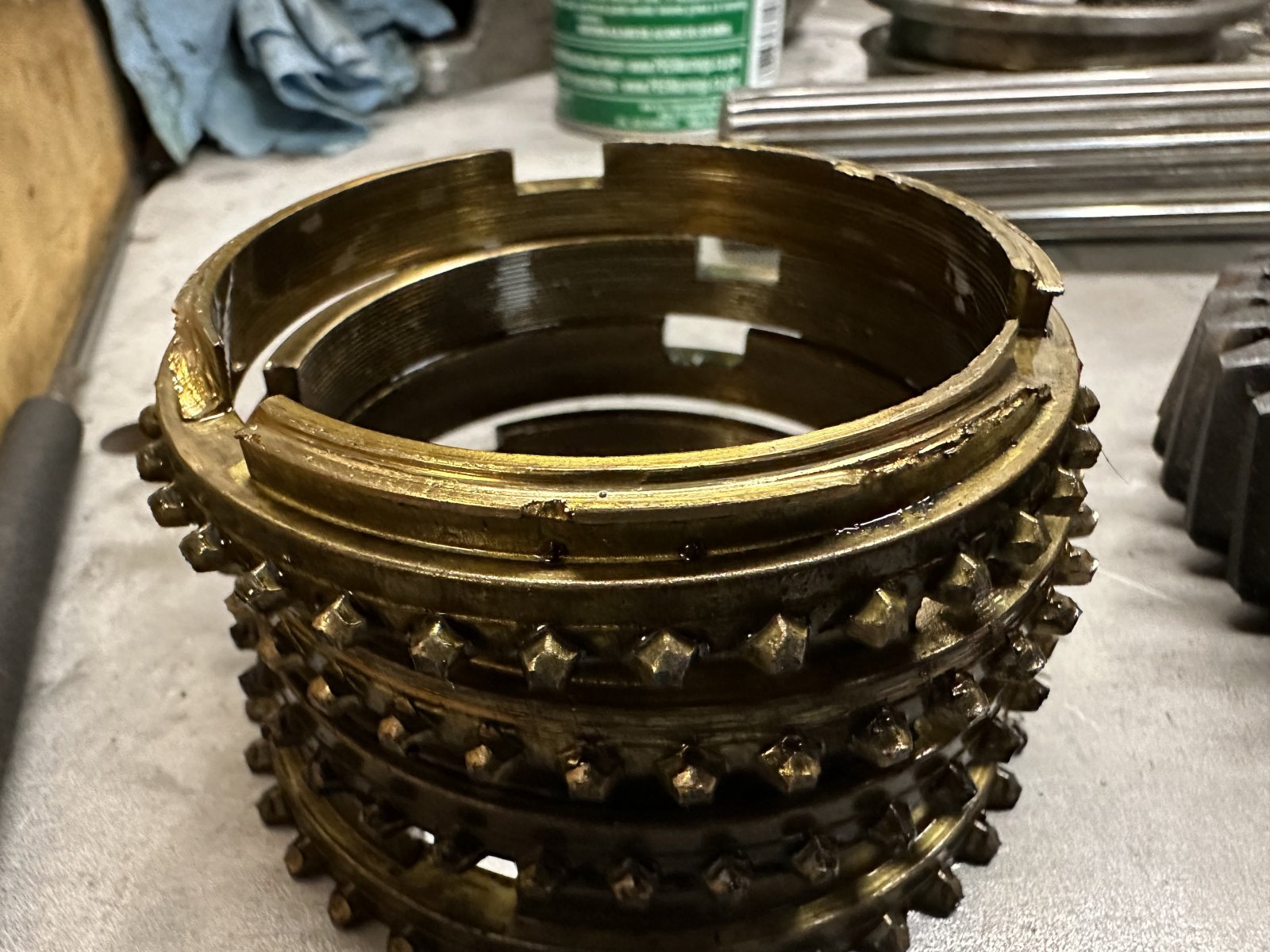

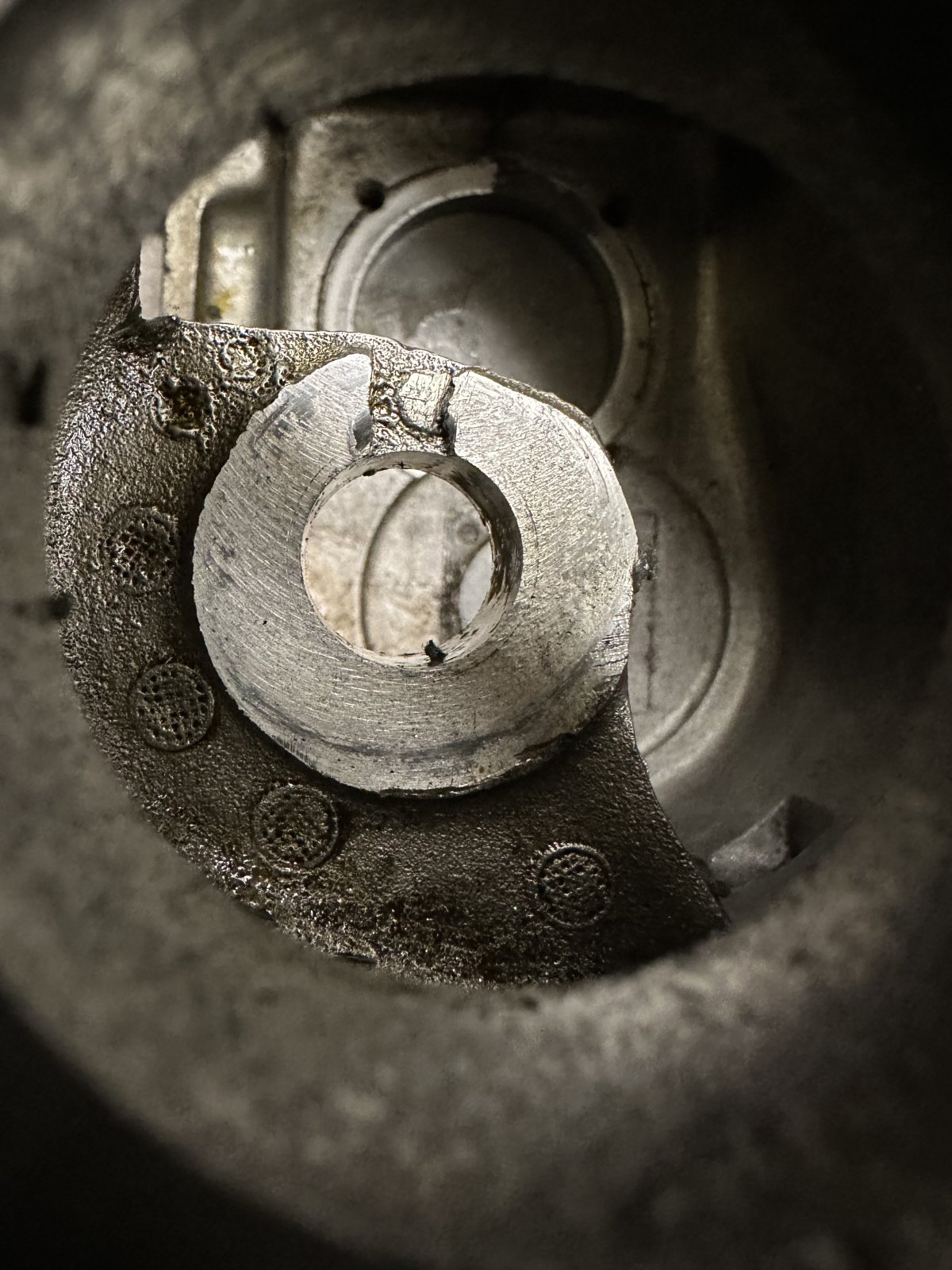

    I could tell from looking in the side cover hole that the synchros and sliders were a little rough.

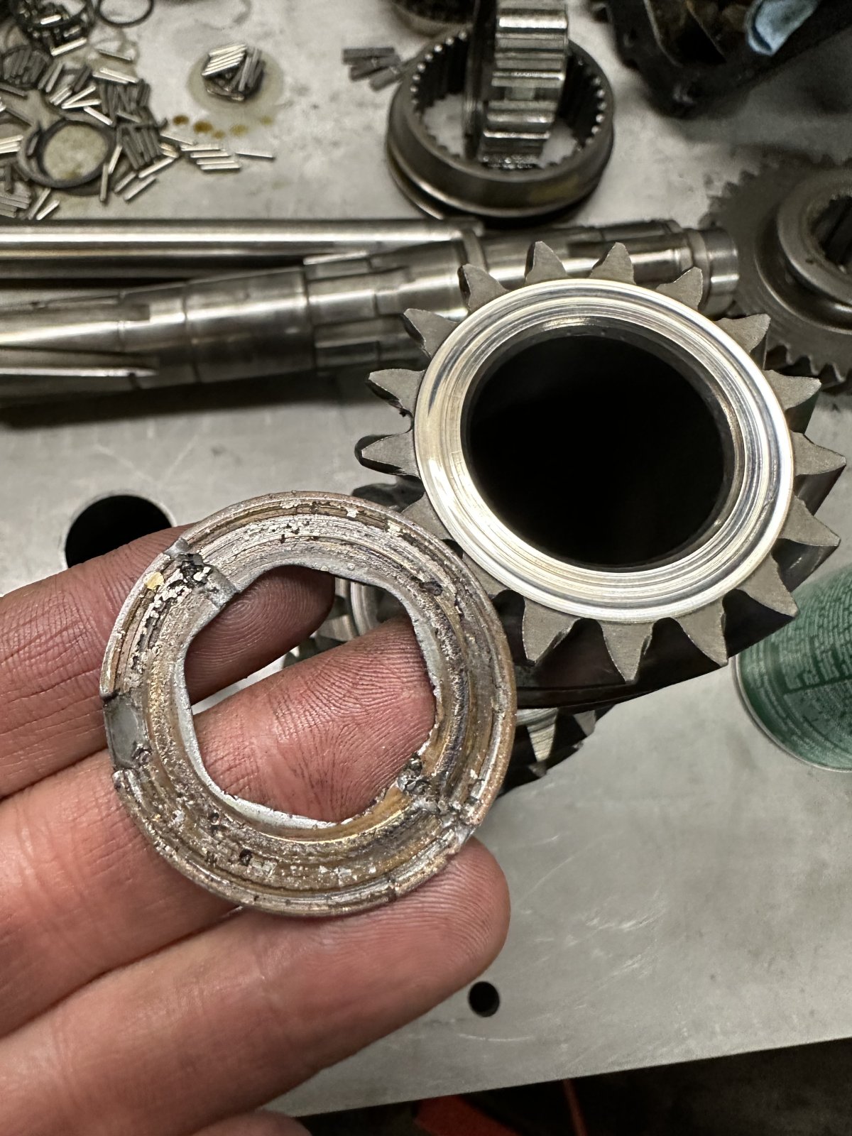

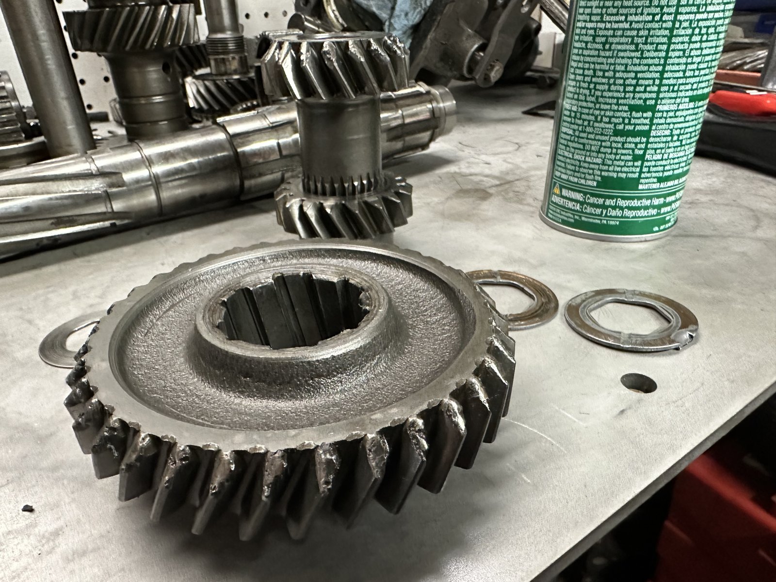

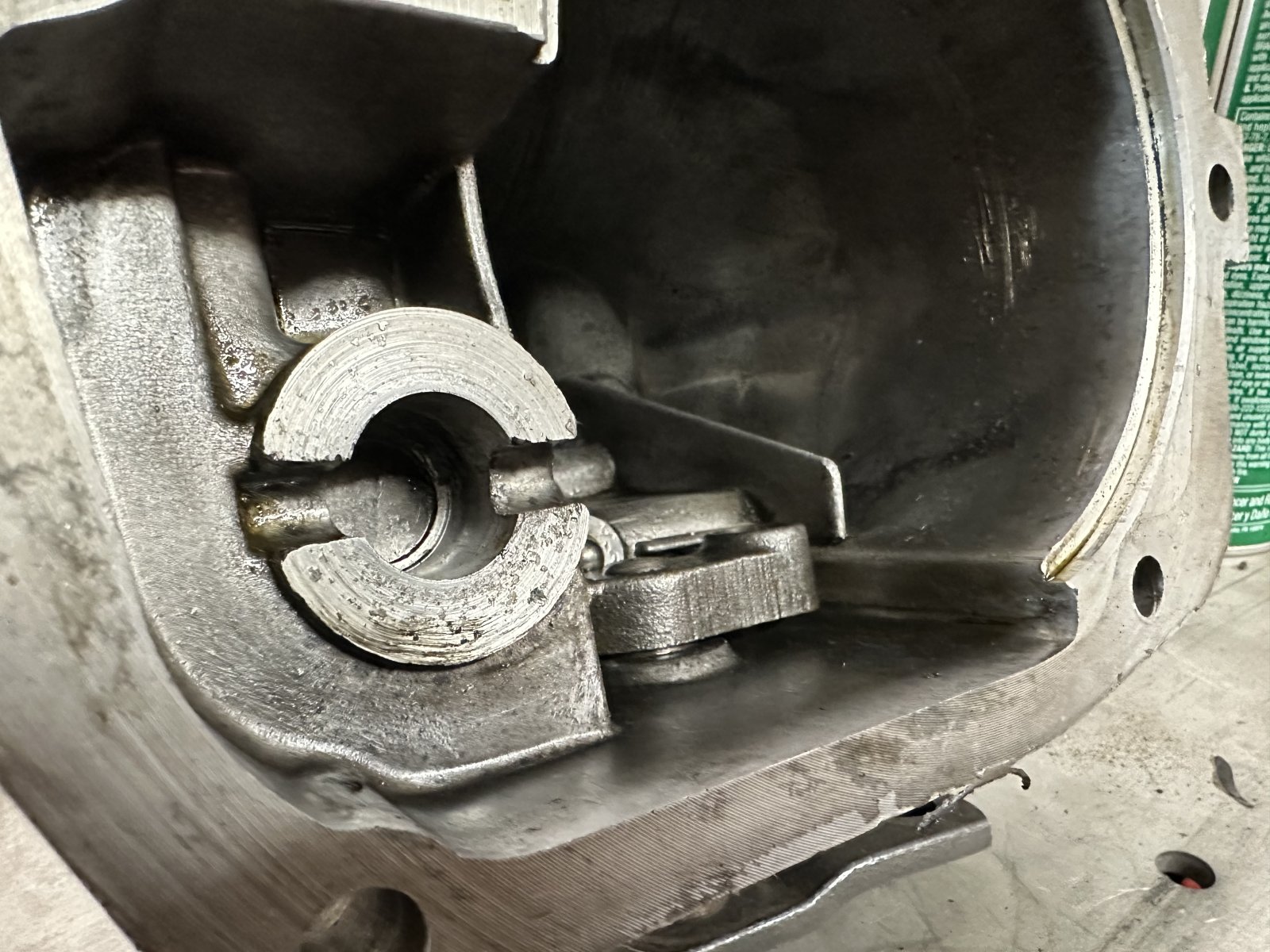

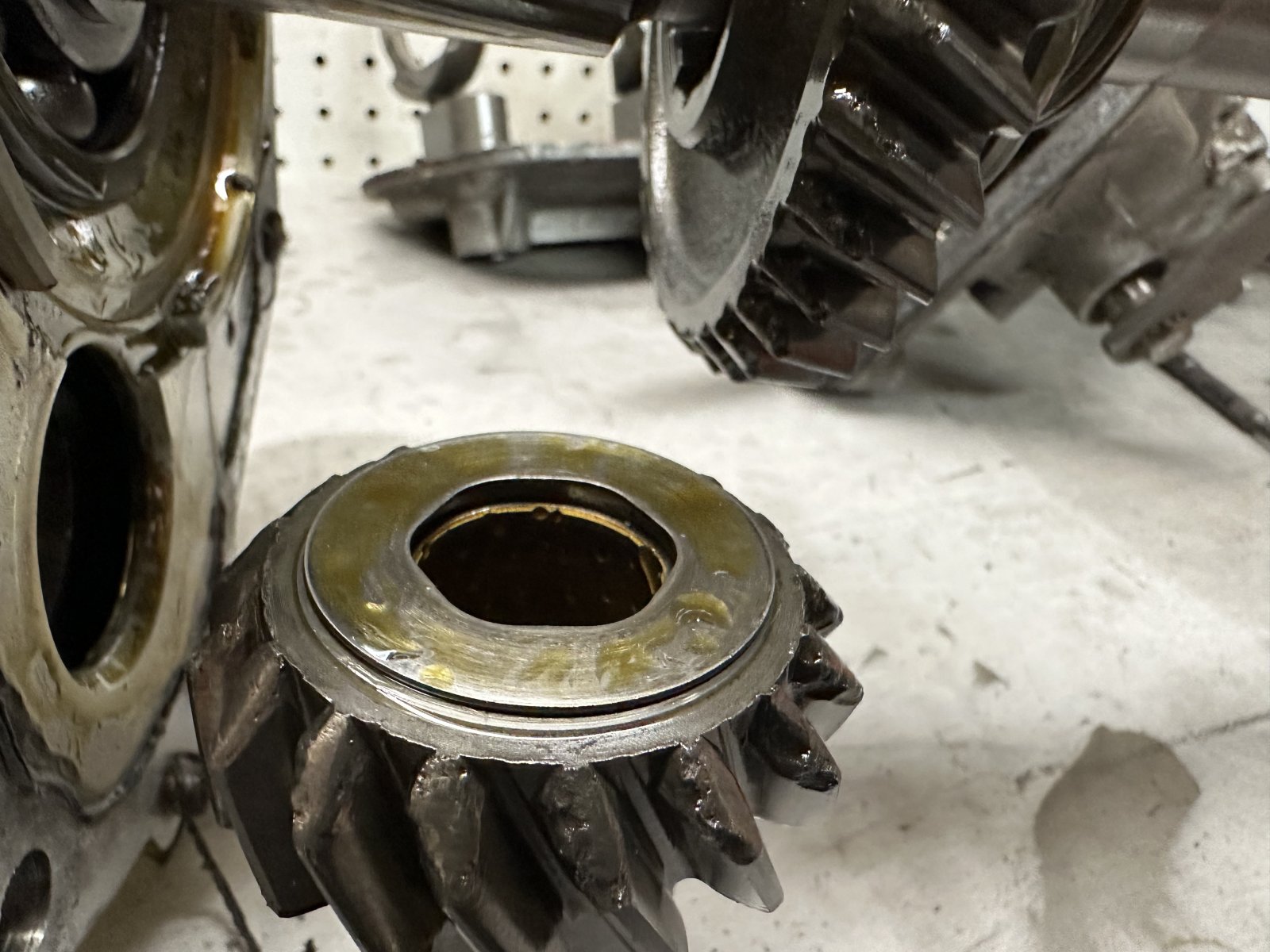

    I got the tail shaft housing open. Reverse looks rough.

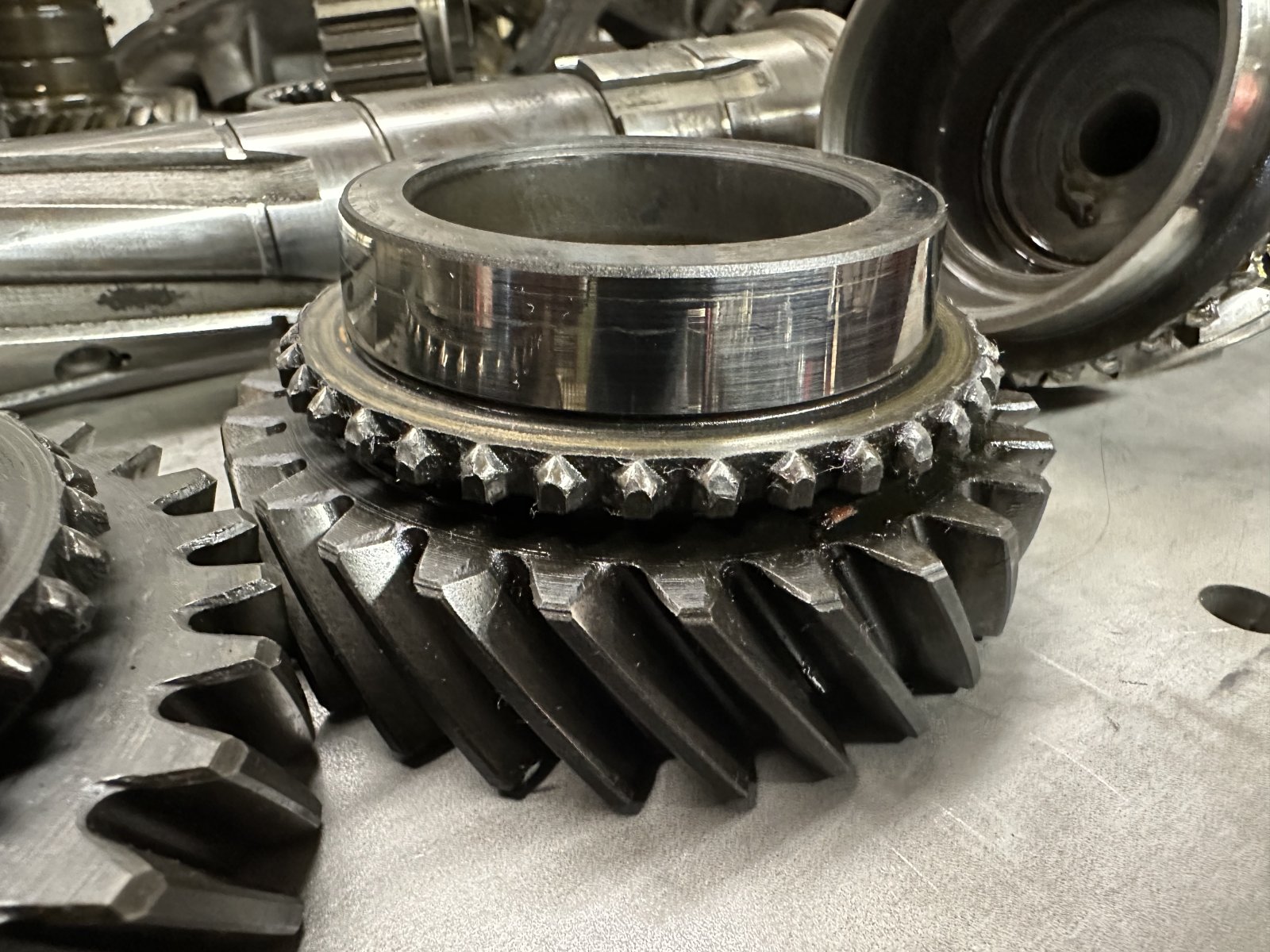

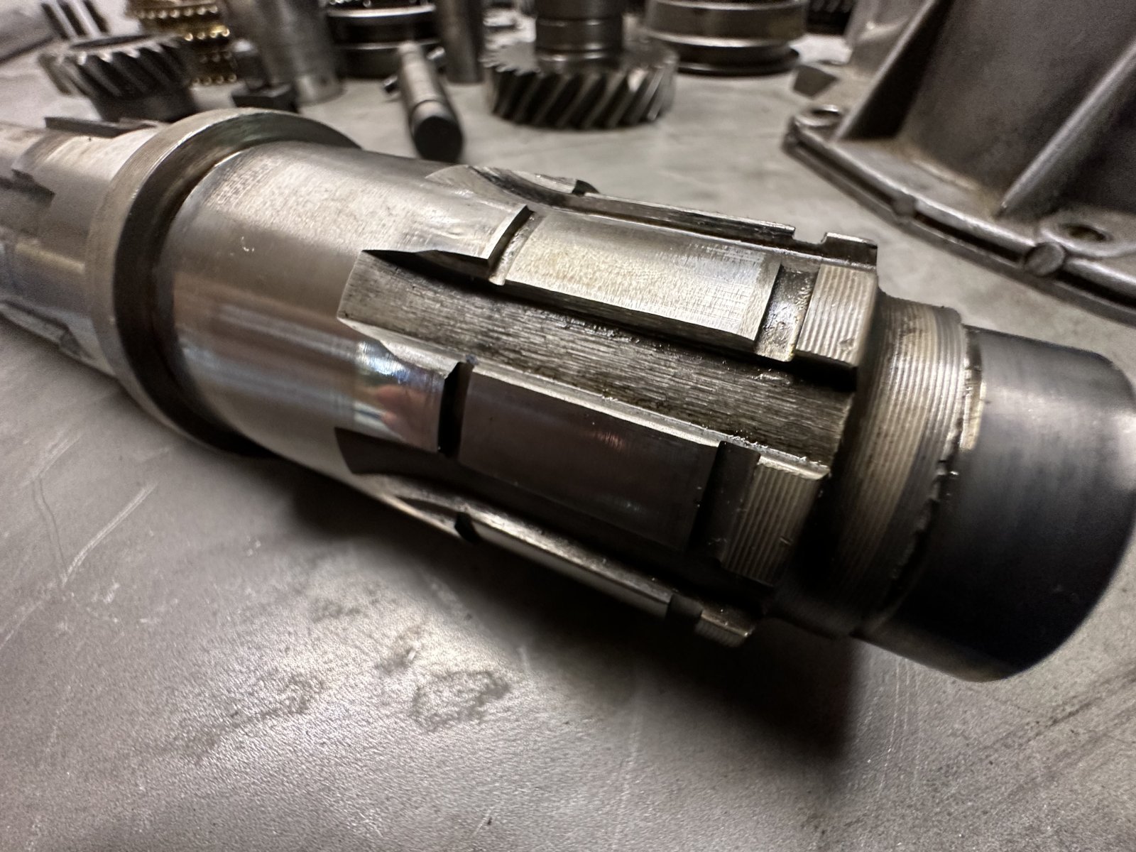

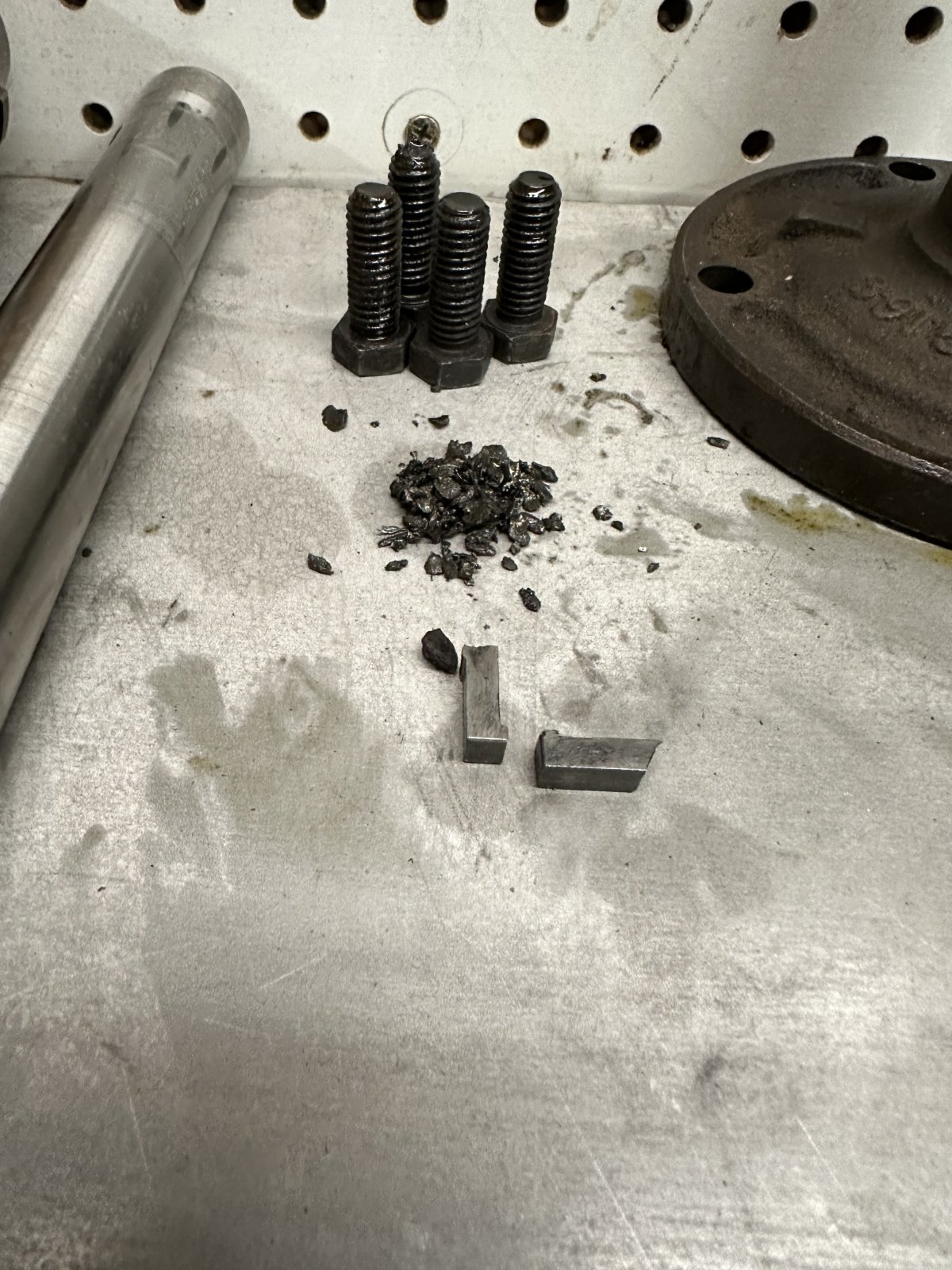

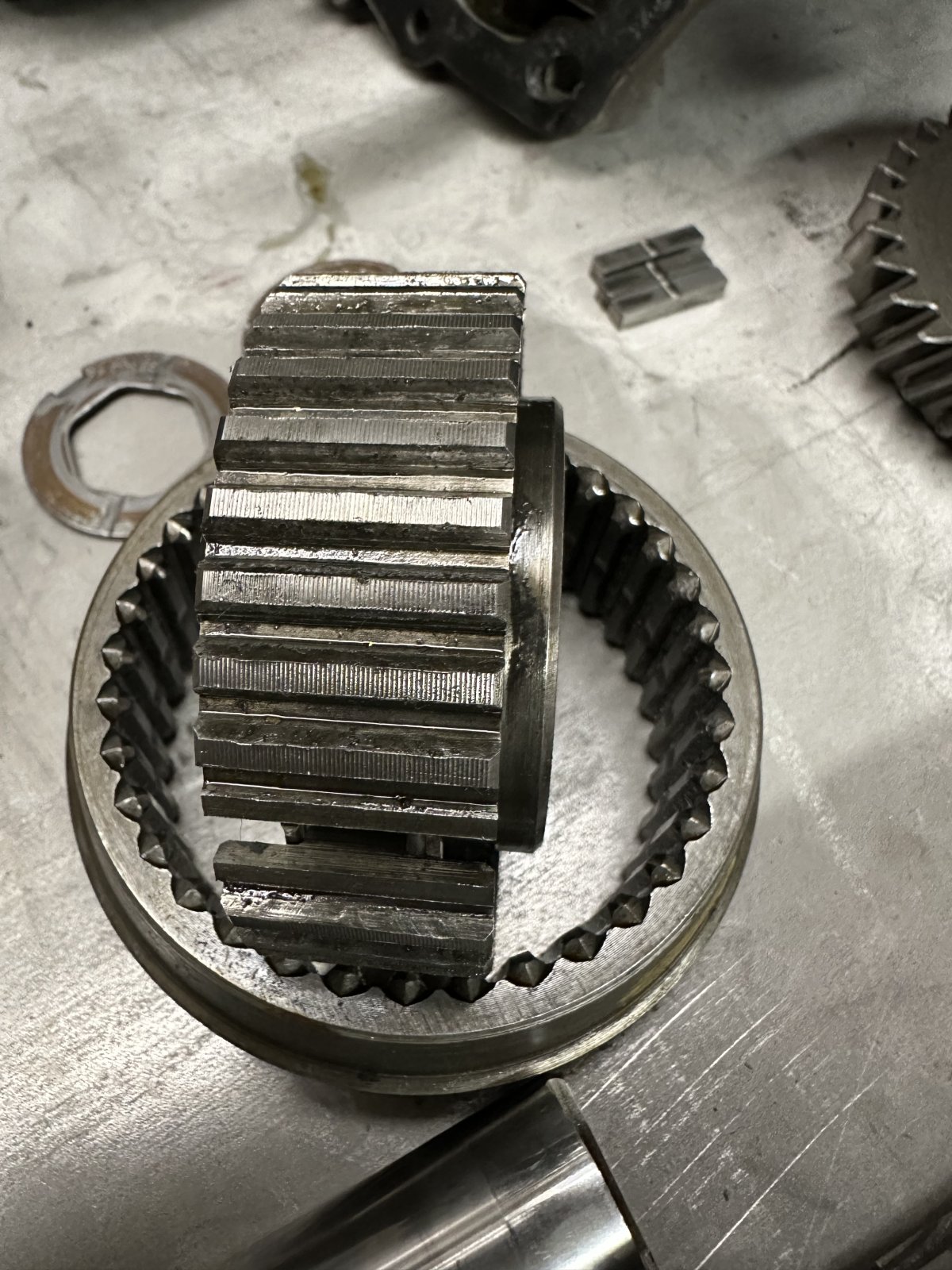

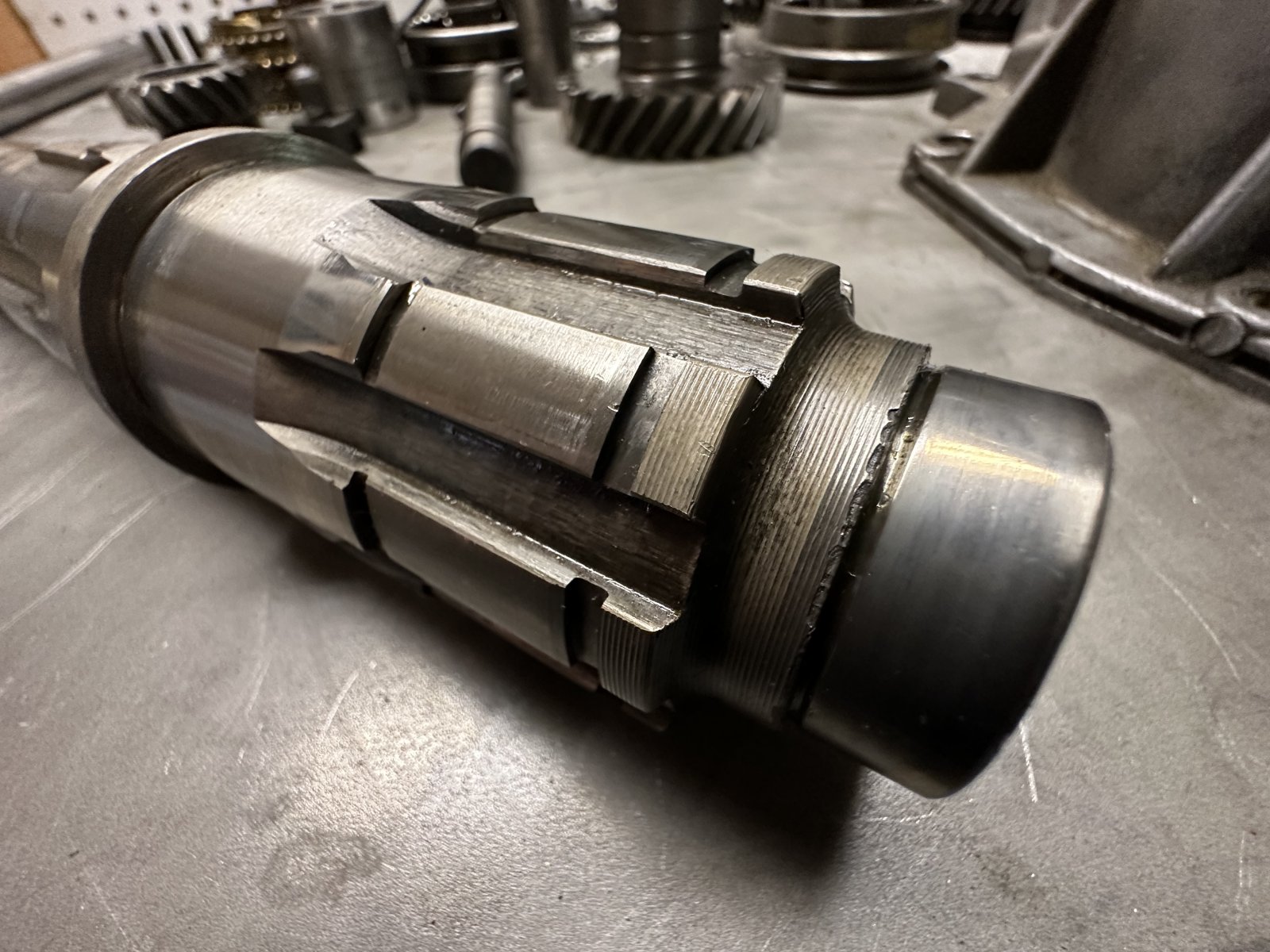

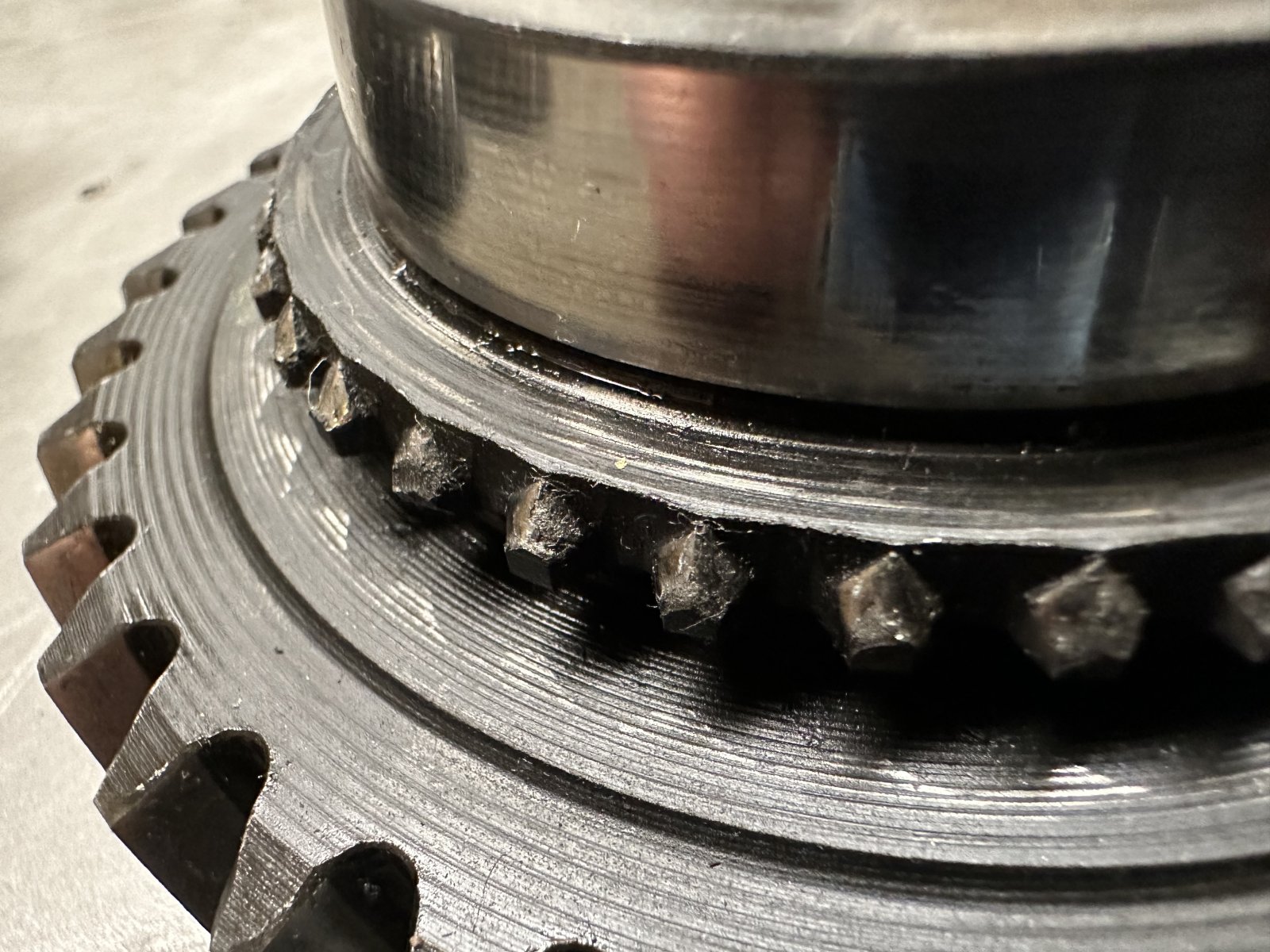

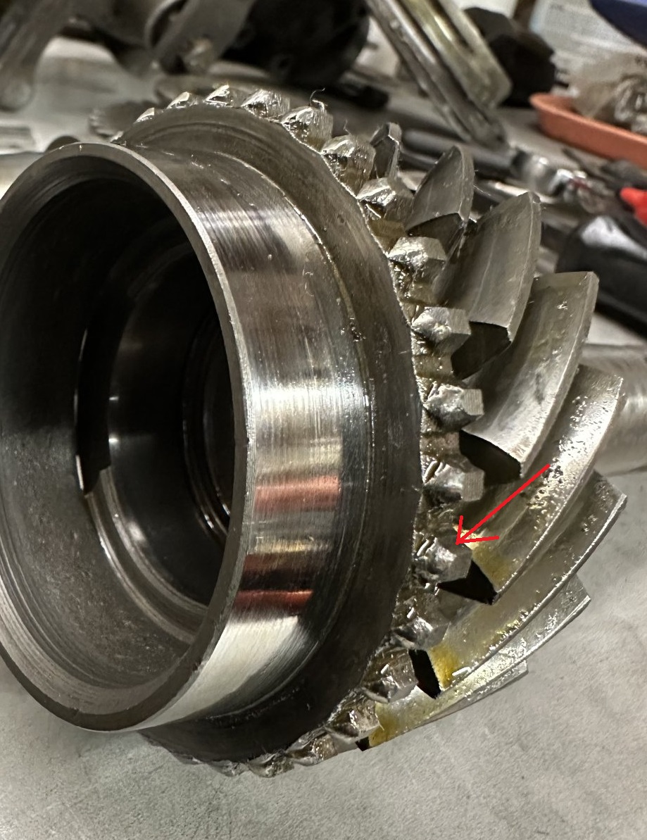

    I started finding chunks of metal. The 3/4 slider didn’t have any dogs in it and looked pretty rough.
    1/2 looked a little better and actually had its dogs.
    Rough br***.

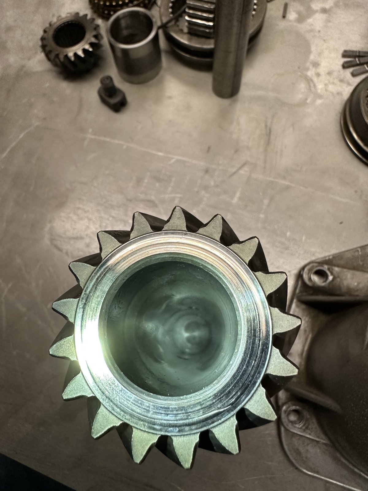

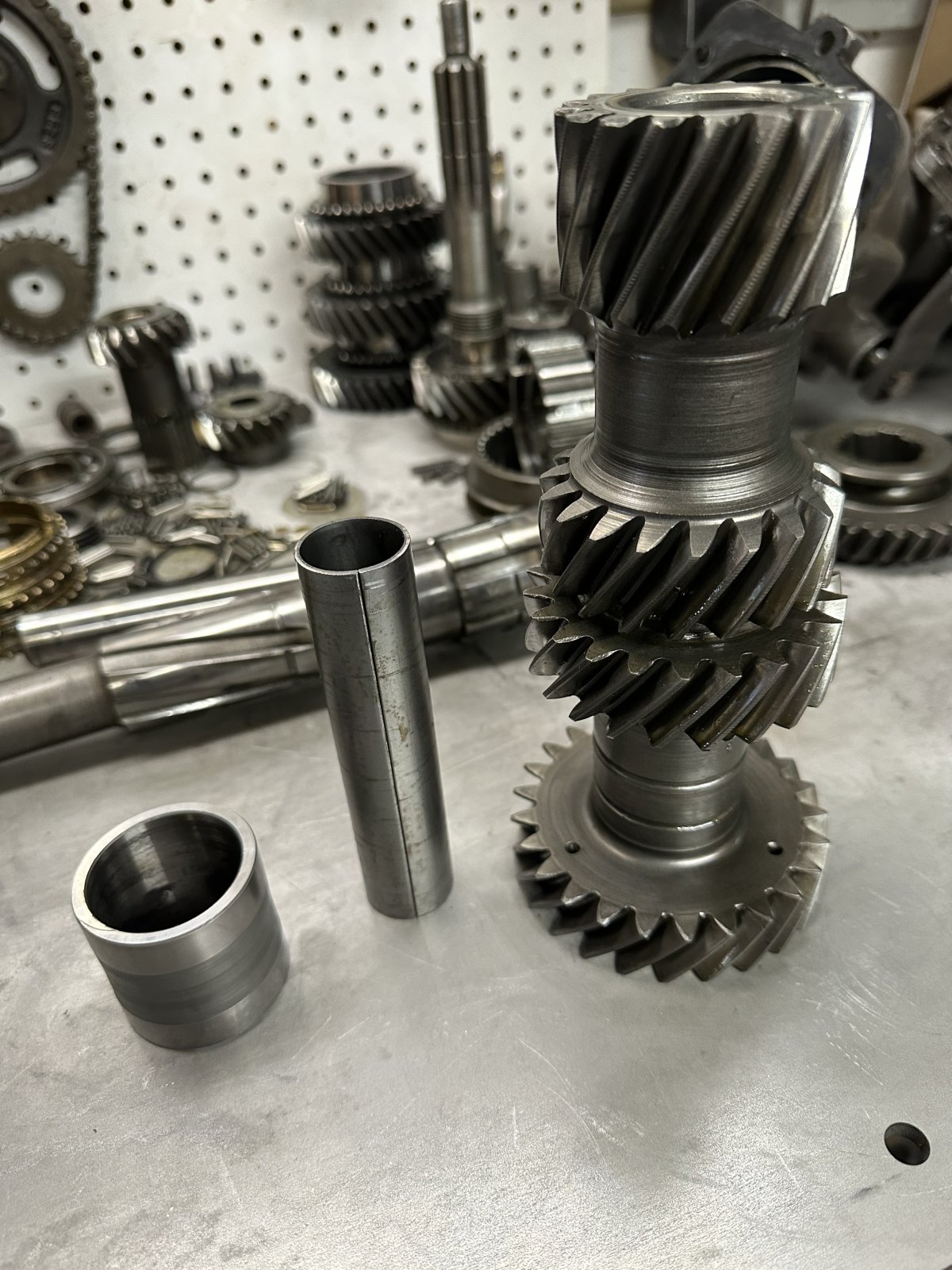

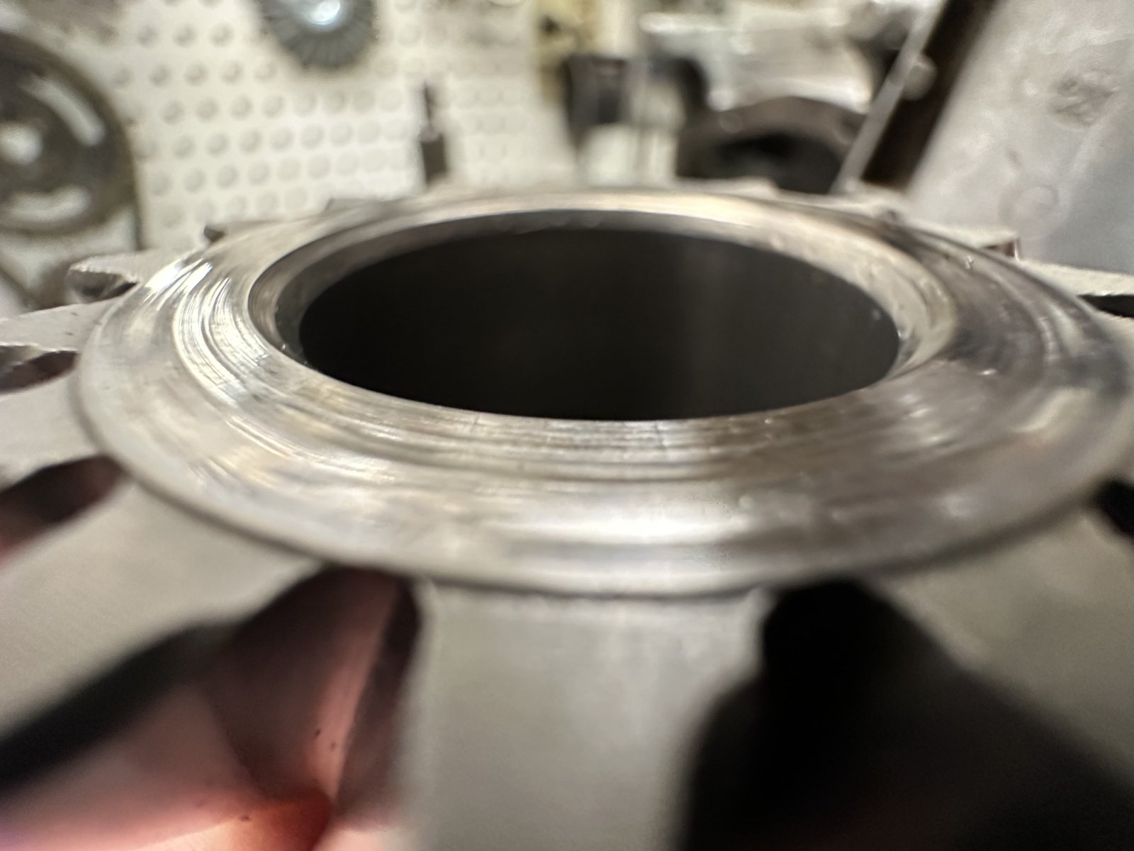

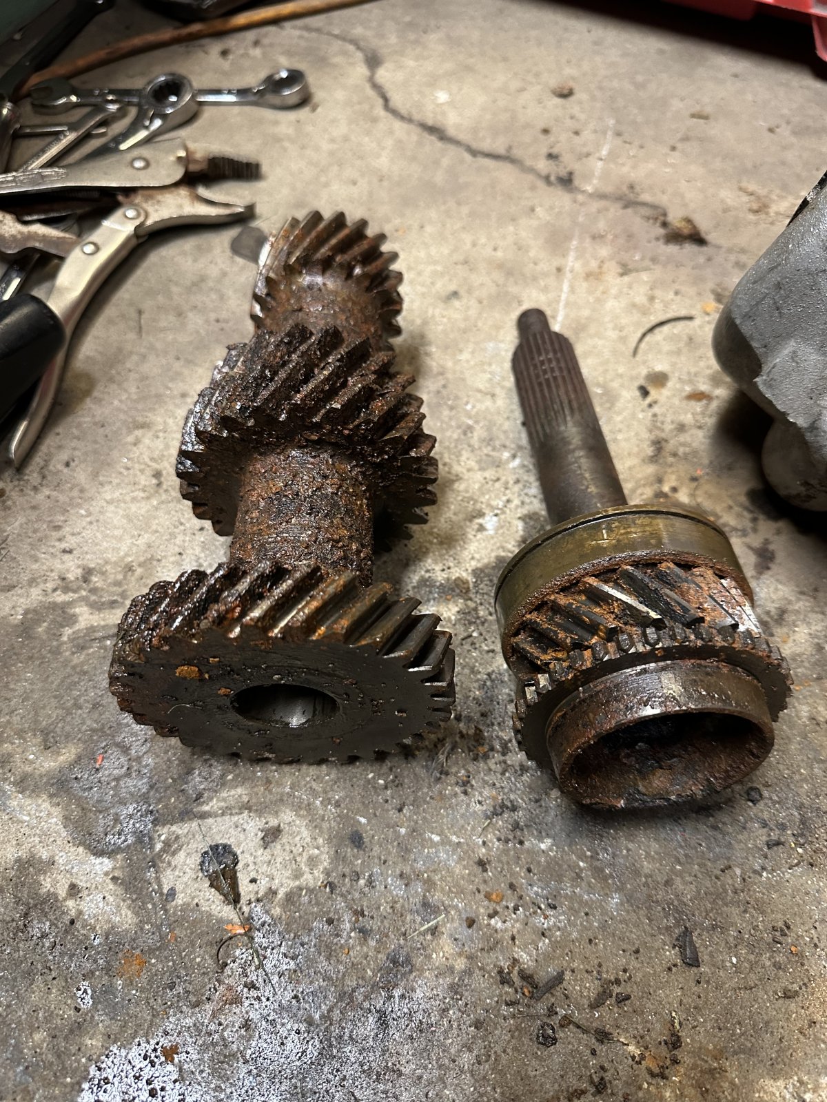

    Cluster gear end surface is grooved.
    But the teeth seem OK
    Reverse again.
    Other gears and main drive gear
    To be continued…

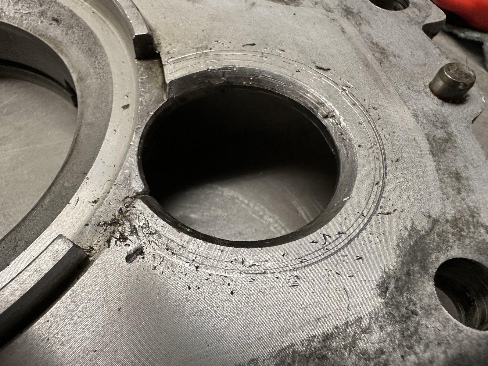

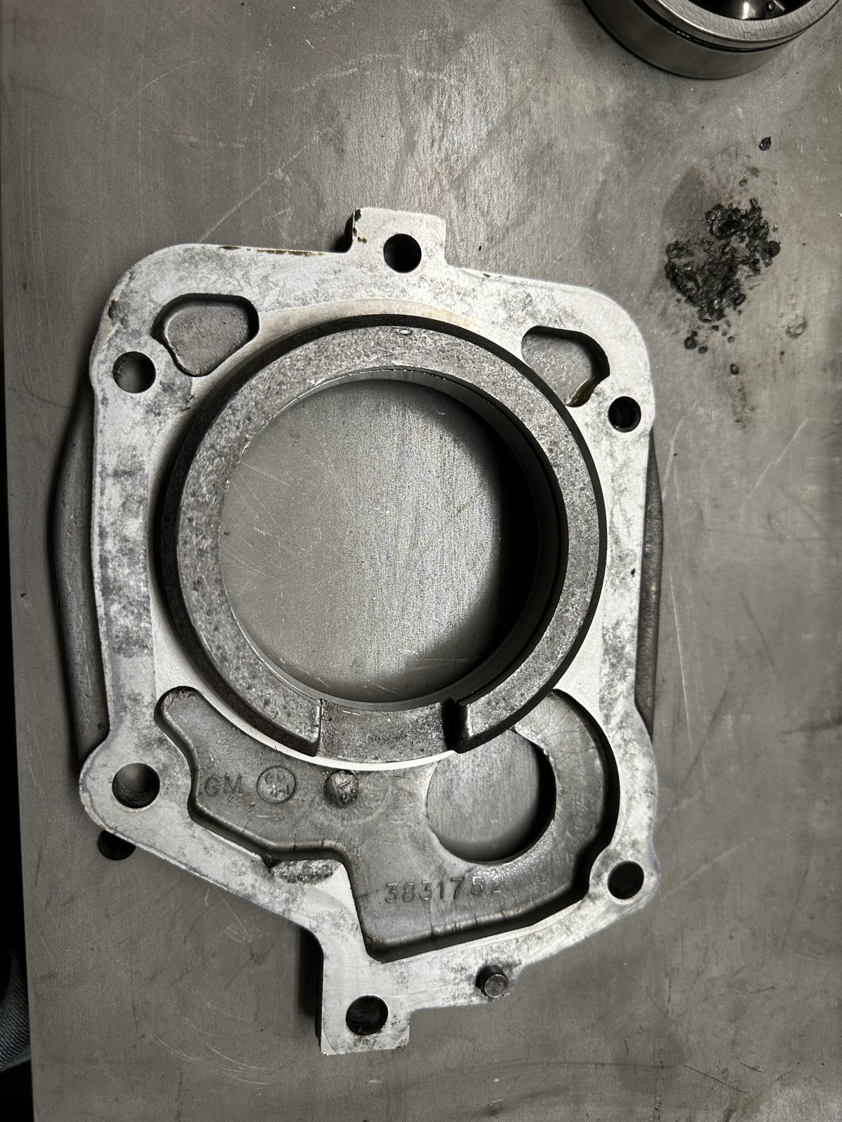

    So I found 2 of the dogs, sort of…

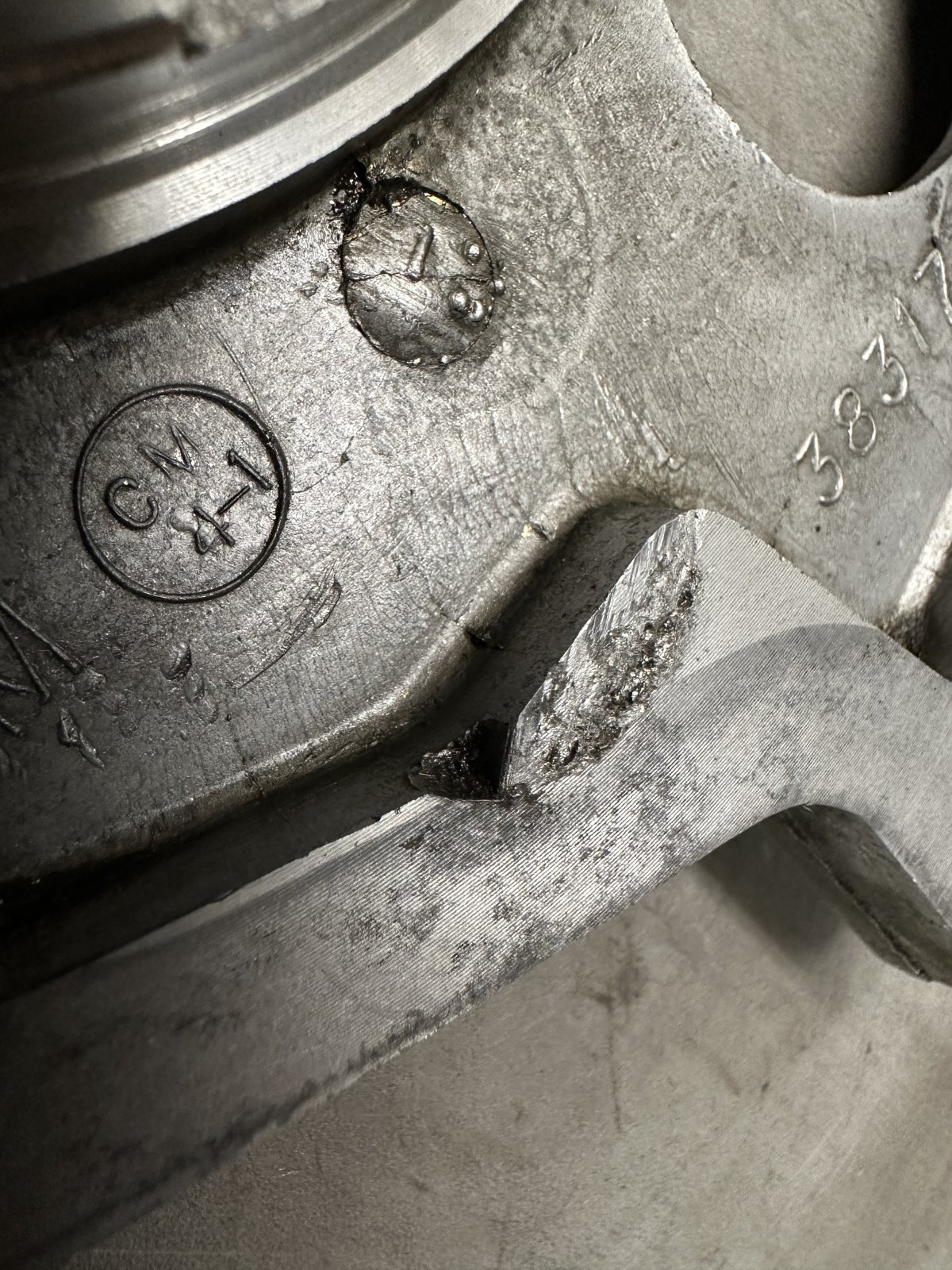

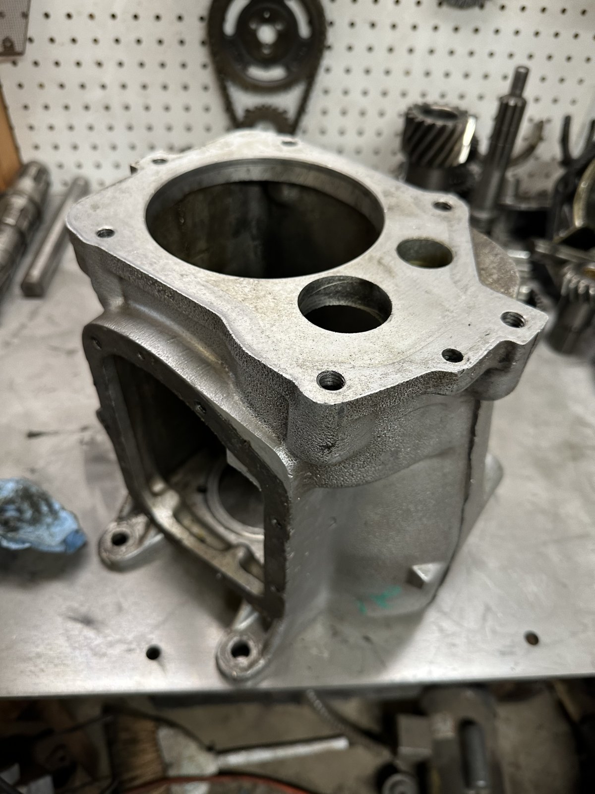

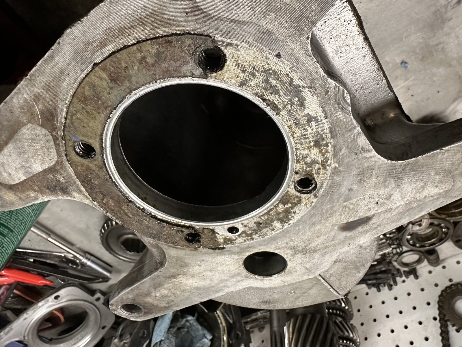

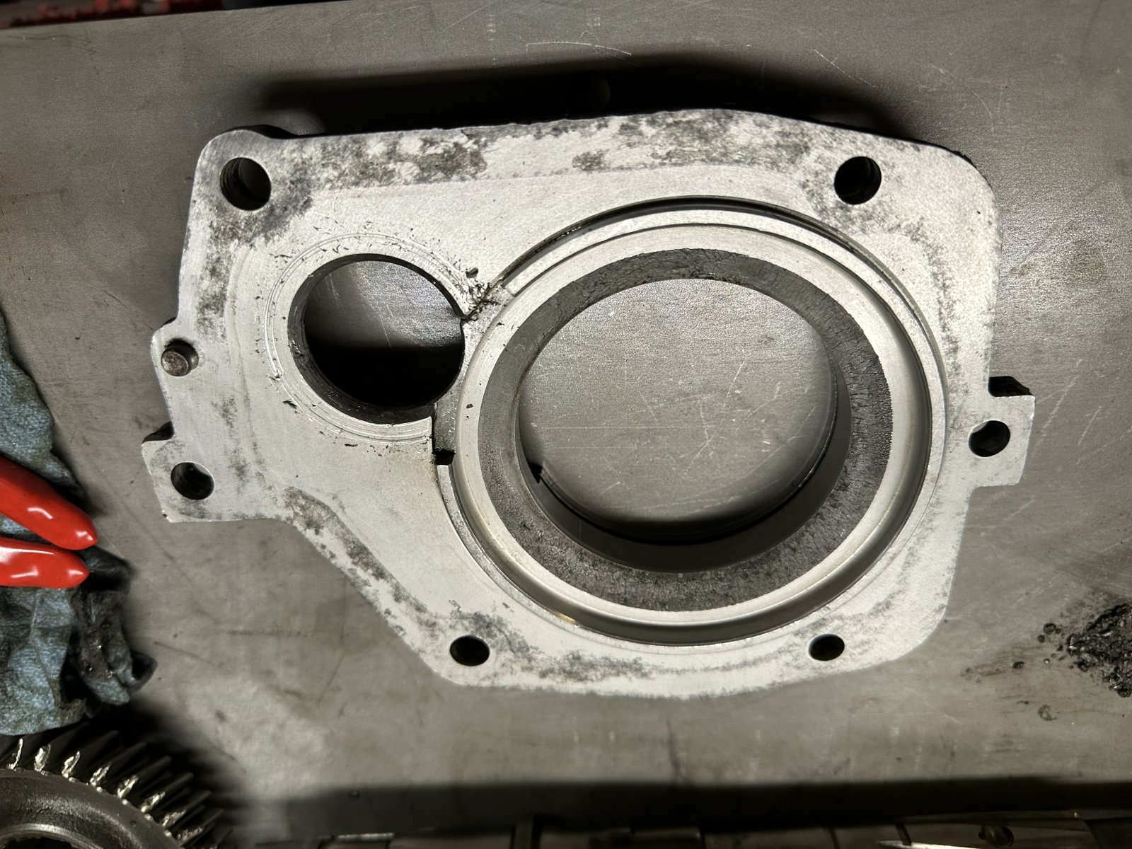

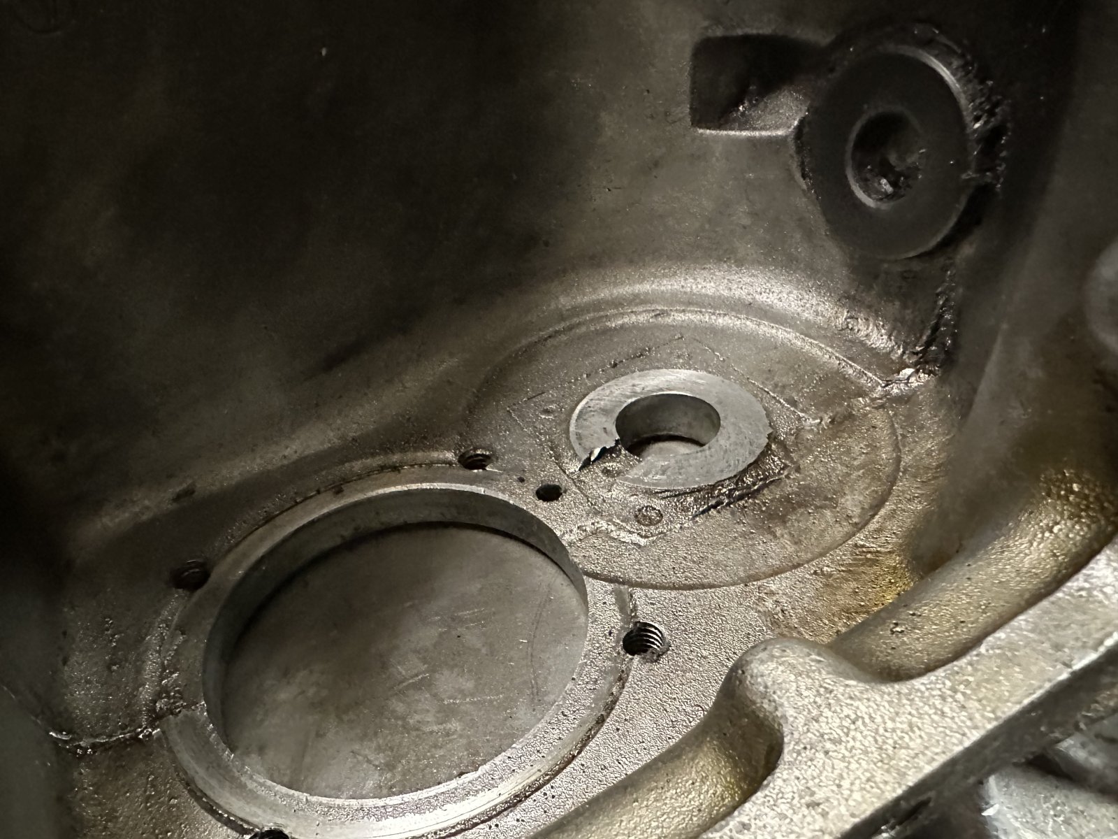

    I did a basic clean up on the case and found some galling from debris.
    I didn’t see any cracking or structural kinda stuff. I have a lot of research to do, but I’m hoping I can reuse a fair amount of this trans. I know I need a kit, new slider ***emblies, and reverse. Im hoping I can dress the surfaces on my case and reuse my other gears. I don’t know if my cluster gear is toast or if there’s a way to save that end.
    I’ve never been through a Muncie before and don’t know what I can get away with. This isn’t a perfect car, and it doesn’t need to be the ultimate trans. Im after functional. Any input would be appreciated!
  3. squirrel
    Joined: Sep 23, 2004
    Posts: 59,843
    squirrel
    what a beauty.

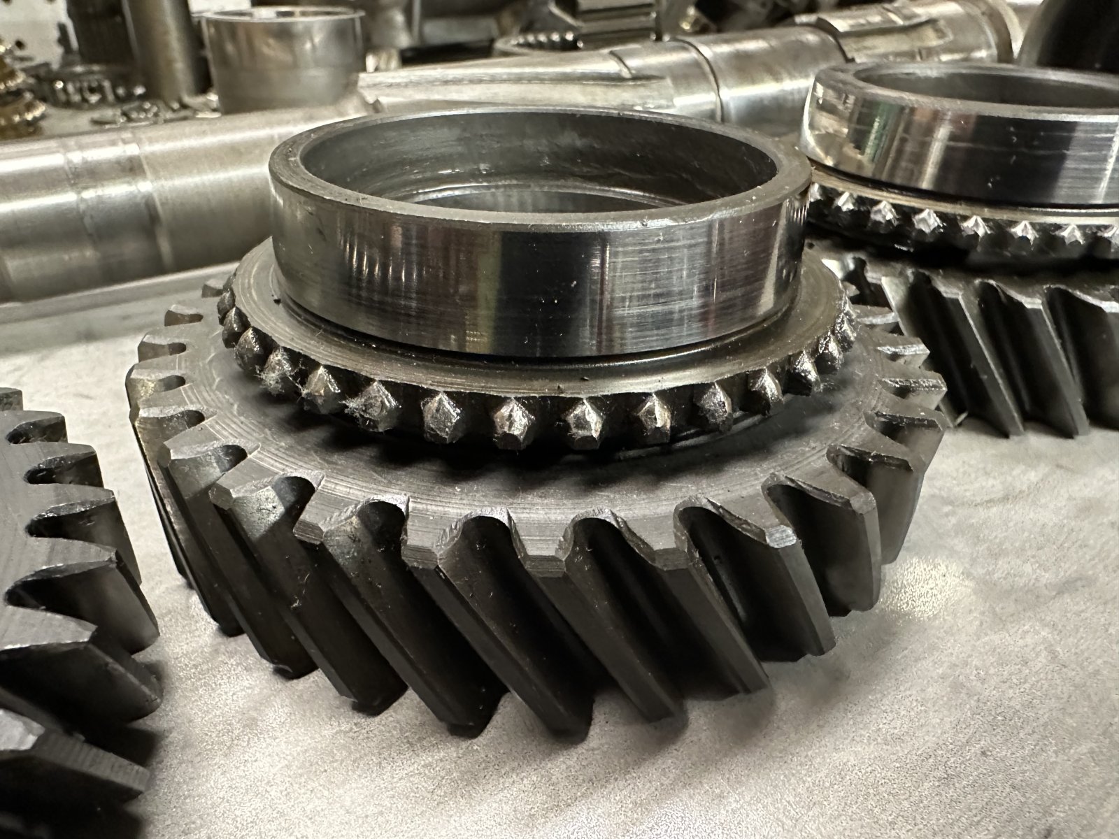

    You can probably get away with using the cluster again. Might see if you can dress the points on the synchro teeth on the gears. But the main drive gear (which you call the input) appears to have steps worn on the sides of the synchro teeth, which might cause it to jump out of gear. Maybe, maybe not.

    Thats a hurtin Muncie...

    I’ll dress the points on my gear synchro teeth and ****can the main drive gear. I’m glad there’s hope for the cluster. Thoughts on the case, mid plate, and tail shaft housing?

    The main body castings should be fine.
    I'm curious how you will dress the synchro teeth points. When I was an apprentice at the machine shop I spent a couple weeks in the cutter sharpening department so snuck in a couple gears and repointed the little teeth on the tool and cutter grinder, but it would seem to be pretty difficult by hand.
    These little teeth also become smaller as they are ground away to repoint them, but mine haven't failed me yet.

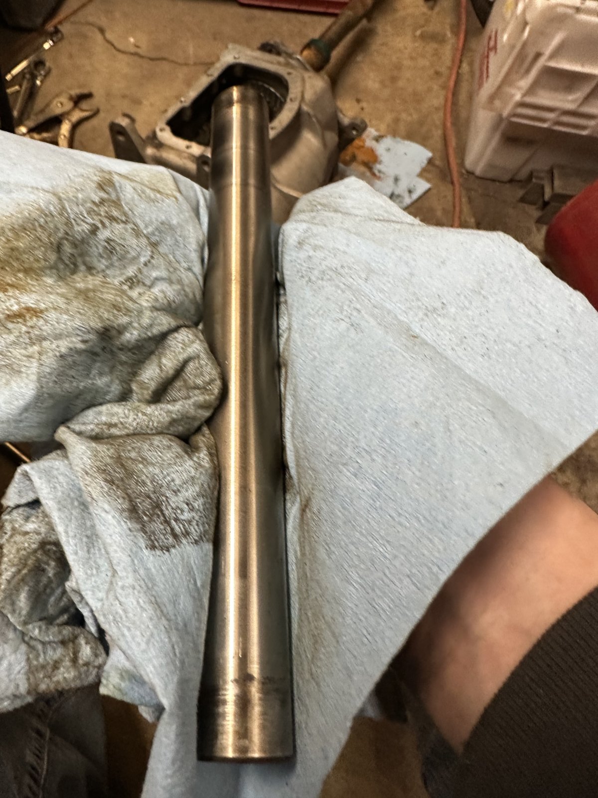

    I would also check your countershaft and matching bearings for wear or damage.

  11. Highly recommend 5Speeds.com, Paul’s a good dude and very knowledgeable. Every time I called, he answered the phone. You can probably send him your pictures and he’ll tell you what’s what.
    Deuces, chryslerfan55, lewk and 2 others like this.

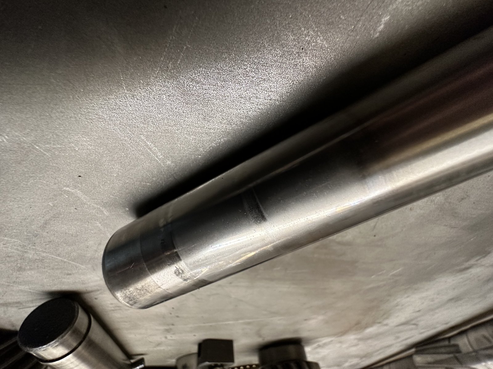

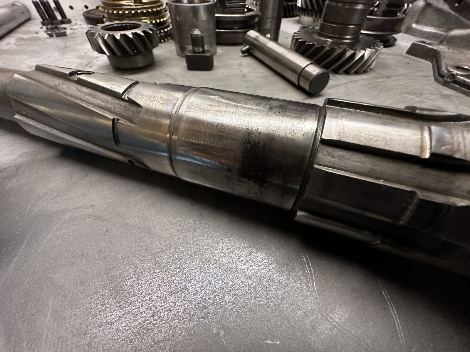

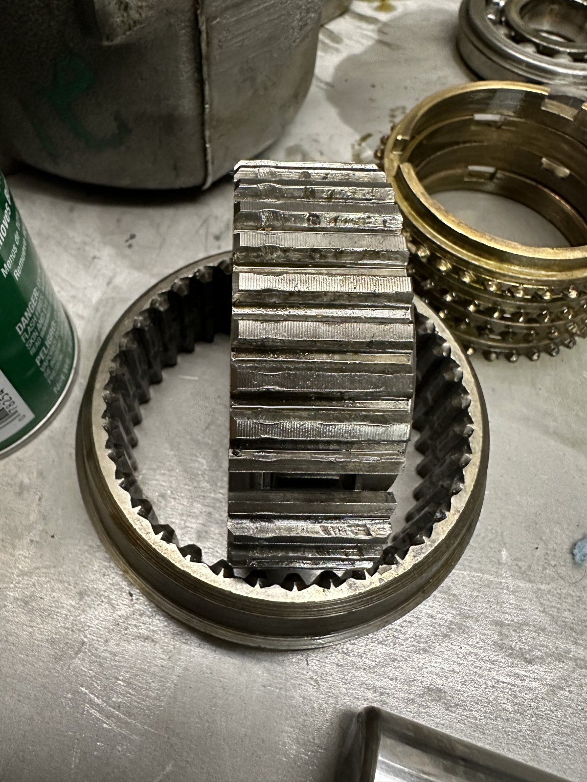

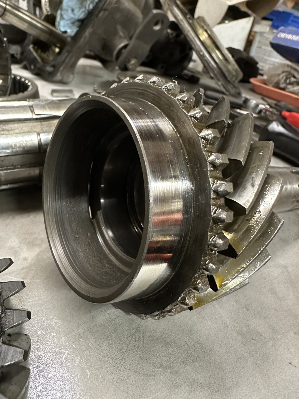

  12. The cases will work out alright,,,,they can be cleaned and will work just fine,,,,no real damage .
    The slider ***emblies need to be replaced as you have already realized .
    The reverse gears are horrible,,,,,,you could get away with just replacing the large gear,,,,,but it would be better to do them both .

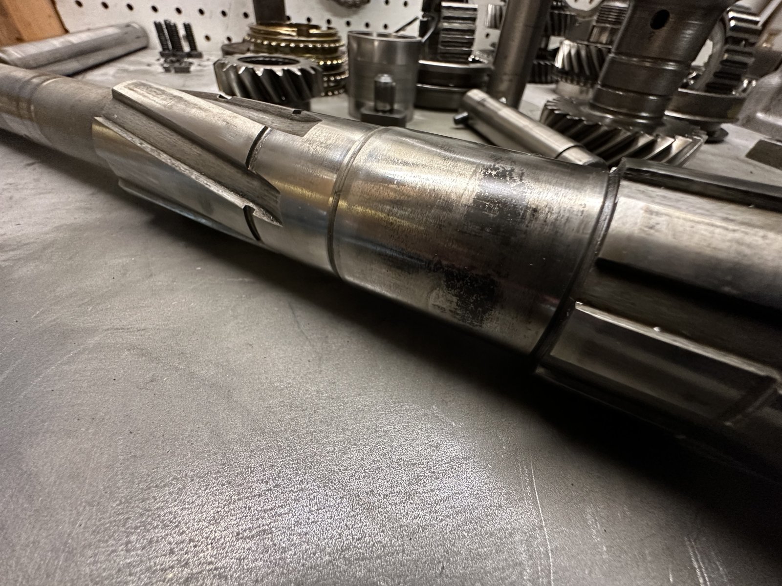

    The cluster is okay to reuse ,,,,,,***uming the inside isn’t worn too bad where the needle bearings ride ?
    I have seen them wear in a bad pattern internally,,,,,check that good .
    The drive gears are fairly rough on the dog lug teeth,,,,,,a good cleaning and close inspection is needed .
    Some of them look really worn back,,,,,,they won’t give a lot of engagement area .
    These might still hop out of gear,,,,,even with new slider ***emblies ?
    Of course,,,the br*** is completely worn out,,,,and the transmission will definitely need a new small parts kit,,,,and large bearings as well ,,,,,,But,,,that’s usually normal anyway .
    You know what you have,,,,you seem to understand the importance of most of the components.
    It should require a fair amount of money and parts ,,,,,but ,,what doesn’t now a days,,,,lol .
    I hope the shafts look alright,,,,,it appears this transmission was run for some time with contaminated lube .
    Check the spline areas and the bearing surfaces of the main shaft too !
    Tommy
    Deuces, chryslerfan55, lewk and 3 others like this.

    If that trans was on my bench, the majority of the internals would be s****.
    I trim a lot of gears and those are beyond t*******.
    Both hubs have a lot of wear, can't really tell on the sliders.
    The cluster may be able to be cleaned up, but will have a lot of endplay.
    Case and tail look ok, but must check that cluster shaft fits right in the case, or it will have to be bushed, or it will be guaranteed to leak.
    Looks like some bolt holes have questionable threads and will need repair.
    Mid plate looks ok, but must check snap ring groove for wear, or the main shaft can walk.
    I'm my shop, time is money and the time spent attempting to trim the engaging teeth, with probably marginal quality and too much material removed, would exceed the cost for new quality gears.
    Id talk to Paul at 5 speeds if I were you.
    If you try to do a Muncie on the cheep, it will likely bite you back.

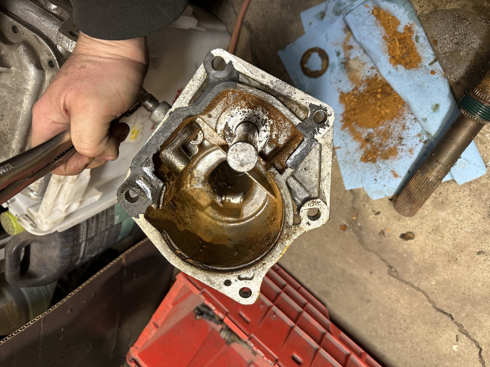

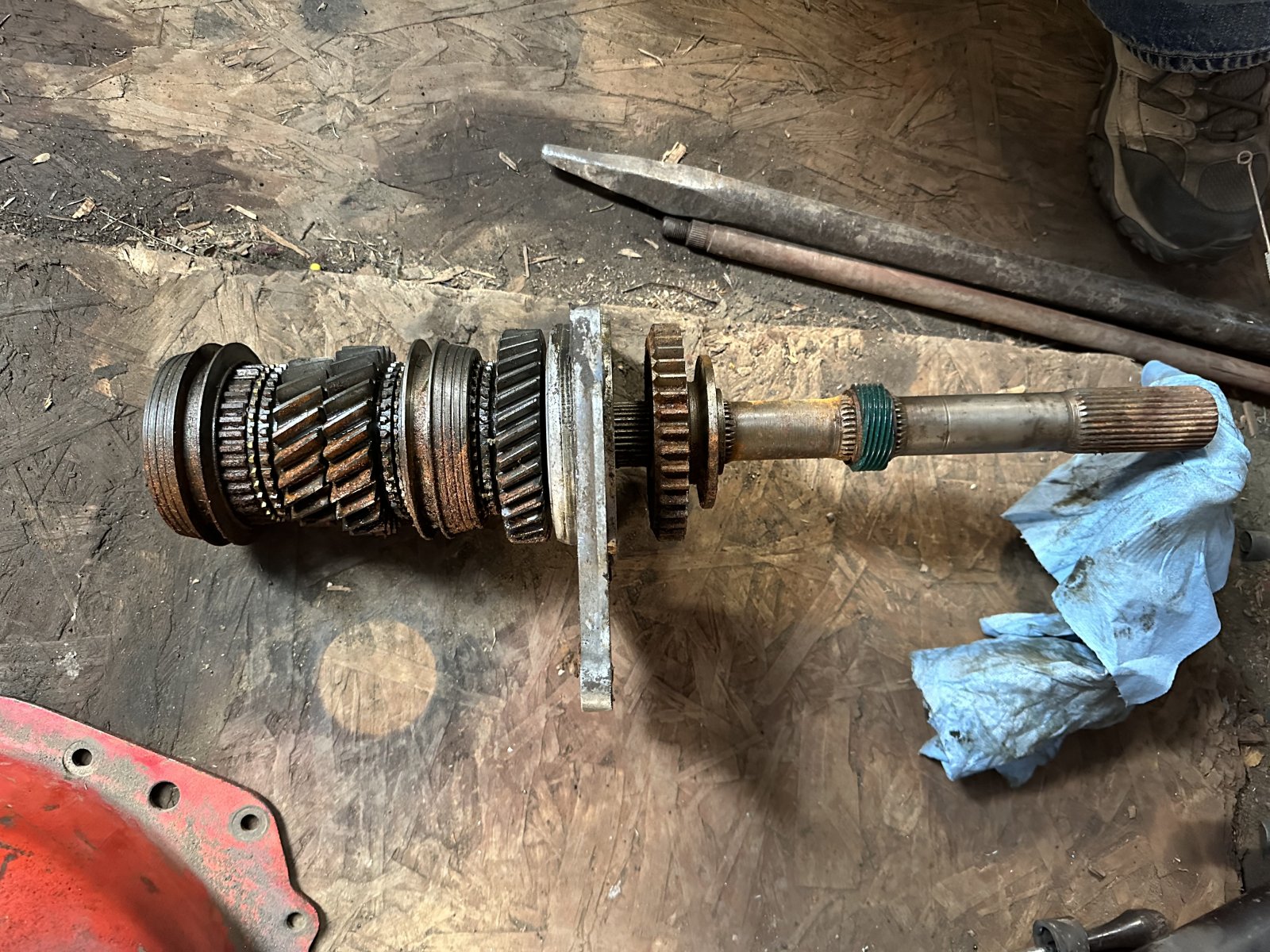

    I think I’ve watched 90% of Paul’s YouTube videos on Muncies at this point plus a couple randos. All were very helpful. The car is a low buck ‘60 ElCo that I’m trying to get on the road quick. It’s getting a vortec head 350. Everything is used and I’ll be lucky if I’m making 350 up. It’ll get a posi and relatively skinny tires. If I go down the rabbit hole of the best of everything and make it perfect, it’ll take me 10 years to finish the car and I’ll never drive it because I’ll be too worried about it. I know I’m playing in the shallow end of a deep swimming pool, but here we are. I’ve got a Vega Saginaw, a couple partial early T10s, the rusty Super T10, and this. $700 Italian gear sets are out, the best I can do is Taiwanese or used individual gears off eBay. I think the main shaft is usable. I haven’t measured the countershaft, but I can feel wear. It was snug in the case, for what it’s worth. I’m looking at the big rebuild kit, about $380, offshore gears, $400, reverse $80, and some hubs, whatever they cost. I got the box for $350/$400. Mystery Craigslist Muncies seem to go for $1200 to $1500 around here. The more I look at my existing gears, the worse I feel about them. More pics!
    558E4F2F-E137-4D1F-8F31-322CE37726C2.jpeg 3E31564F-27CB-43C4-AFBD-B031B192ED69.jpeg 11833BEF-FBAF-45B4-8959-31016345414E.jpeg 36101A8E-3859-47D4-A2A5-9D20984CCA01.jpeg E513BEFD-33ED-4FB9-BC3C-87432DBC8DD0.jpeg 950542CF-38C4-4A05-B419-C16C1D2CCB0C.jpeg E6406251-BCFA-4AAA-89D8-F0FE706712DF.jpeg CAEBAD2B-8302-4340-98FA-DBCE6E58D1D8.jpeg 7945B942-ACCD-481B-9BDA-51352C77E029.jpeg 9066806F-E83E-4434-A02F-44F8C5E03D70.jpeg 4E8ECEC4-E385-430F-963C-4F67E21645F1.jpeg 7FA94D82-739E-4033-8DA0-322905E873C1.jpeg
    I’m going to go out and try to pull the rusty Super T10 open and see how bad it is. Wish me luck!

    If it doesn't shift, grinds, or jumps out of gear, it doesn't matter if its going behind a 100HP engine or 600HP engine, it will do the same.
    Don't attempt to use those speed gears.
    Short of being broken, they are about as bad as bad can get.
    You would be better off looking for something else, or another Muncie parts core that you may be able to make 1 decent trans out of two.
    Bill

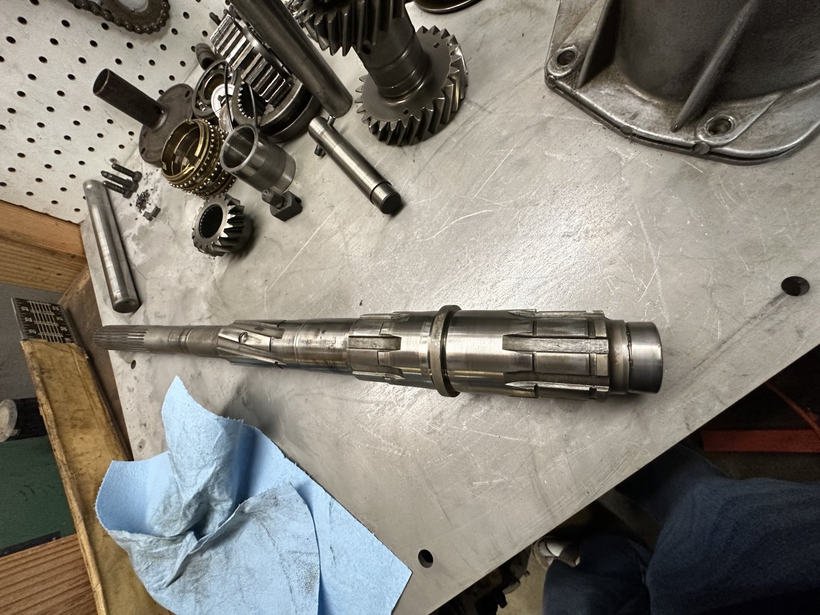

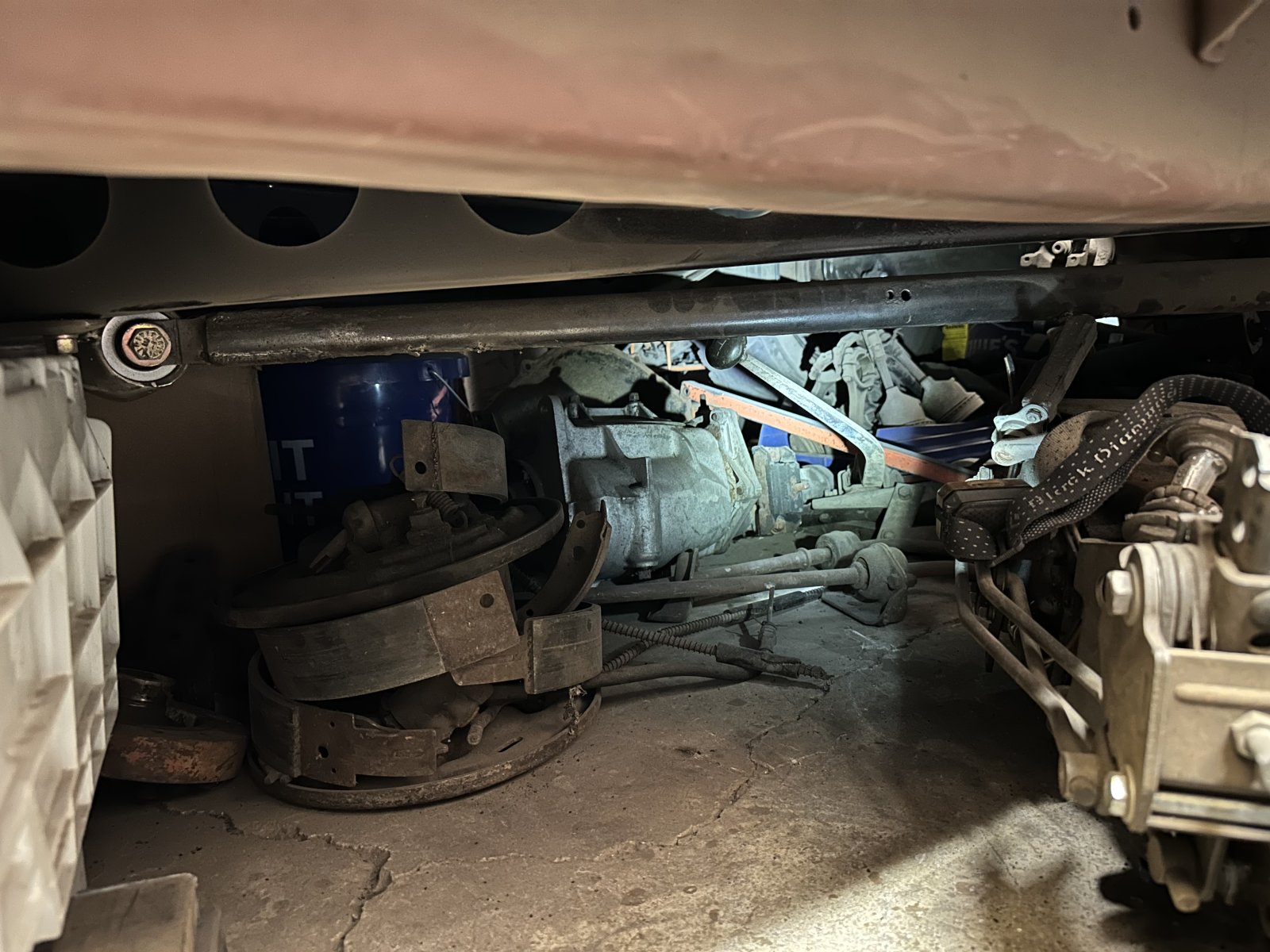

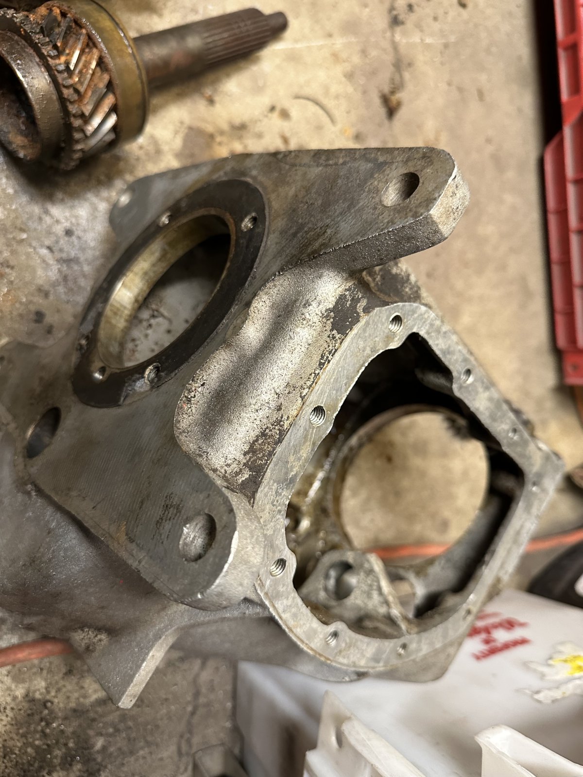

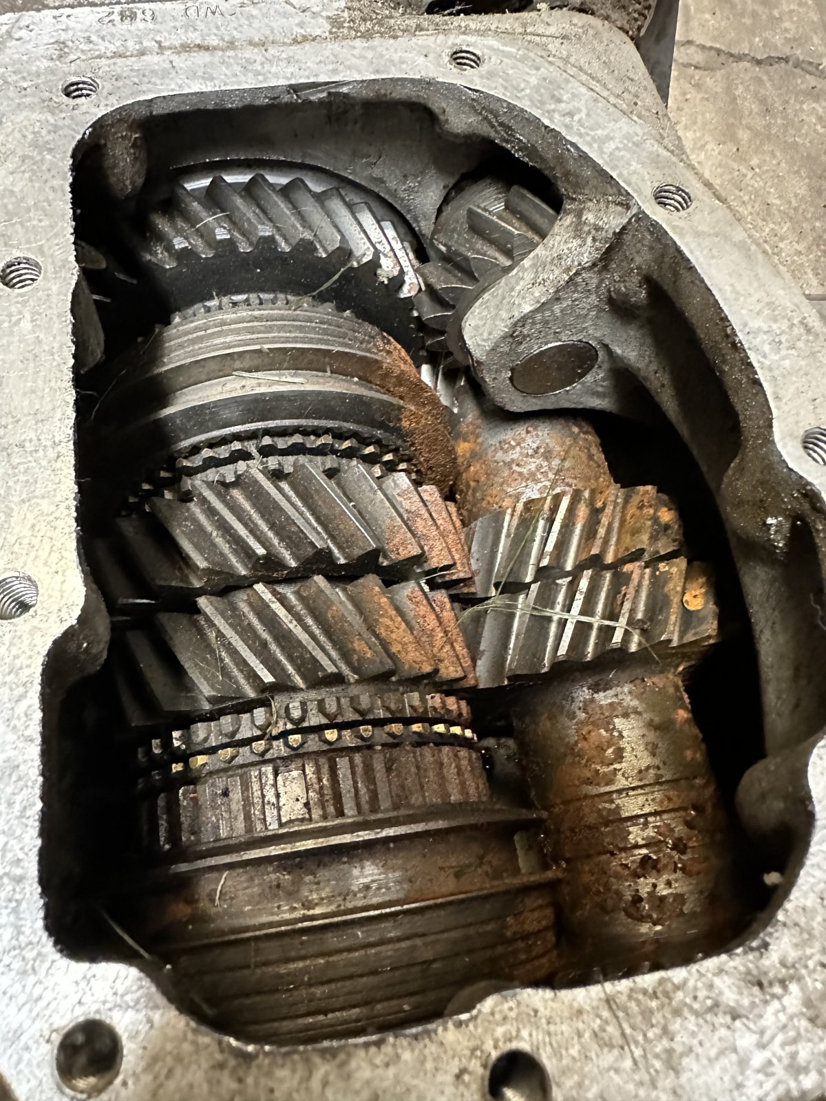

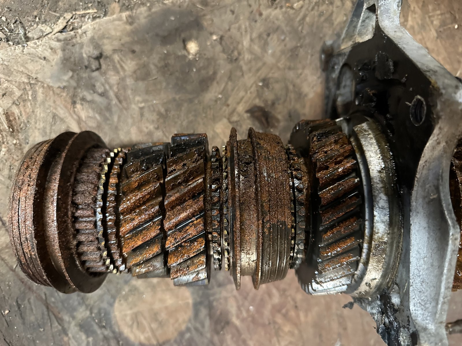

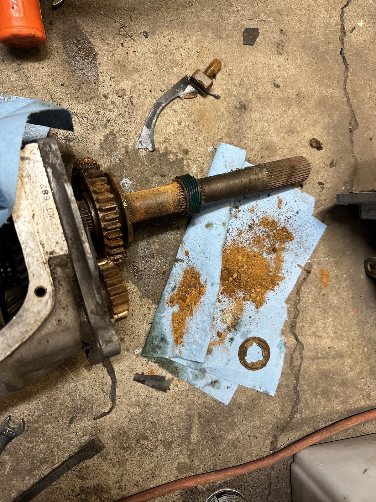

    The rusty Super T10 was buried under my coupe. I drug it out and tore it down. It lived up to its name. I’ll still spend some time cleaning parts, but I’m not expecting much.

    Posts: 22,297
    All of the above, looks rode hard and rode hard again.
    Gonna be an expensive parts trans.

  29. Looks better than the Muncie already .

  30. 427 sleeper
    Joined: Mar 8, 2017
    Posts: 3,366
    427 sleeper
    Even with all the rust and mung in there, it's still light year's ahead of the Muncie! It'll probably clean up nice with a little bit of bead blasting.
