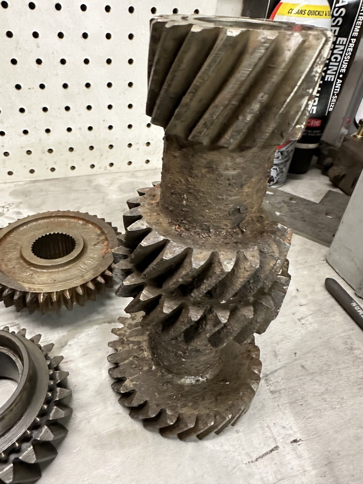

    I got most of the Super T10 mainshaft apart tonight. Most of it looks good. The big reverse gear has some serious corrosion. One synchro slider ***y is still stuck and the other has a su****ious hub. I’m hoping the cluster and the input/main gear/4th will clean up. The bearings actually freed up too, but I’d replace them and the br*** anyway. Pictures:
    2B30164B-78C5-4A76-BC7B-A735C532E436.jpeg 634F3641-F9E1-4187-86C0-3E592F3A5688.jpeg D34065A8-F15E-40C3-99B4-AC0F81F9D132.jpeg C33C3CD7-FDD7-4788-8DE2-E895FF24FC6B.jpeg 146BE4D1-5BDD-4F01-A89B-35313364D9FB.jpeg 8E1971F2-922E-4196-BBD6-6E5AC90FD2CC.jpeg 323FBF8B-BCF0-4BE0-BC7F-AF8E8ABB5302.jpeg C2C68F40-3EDF-4CA5-B662-268CAFD8A691.jpeg 0A33BC9E-3FB7-4134-9A37-DA3A9A7DA7B2.jpeg B0E85BA8-8630-4933-8A44-6E7F04A92C28.jpeg AA0450FD-CBC8-43EE-9411-4D89D62BDC57.jpeg
    Everything is all still grubby and greasy. I did a basic wire brush and wipe. I’ll either start blasting or soaking tomorrow night.

  18. Keep cleaning,,,,,,I think you are In much better shape now with the T10 unit .
    Tommy
  19. chevy57dude
    Joined: Dec 10, 2007
    Posts: 9,650
    chevy57dude
    That T10 is the better unit, for sure. It would be interesting to learn what the first gear ratio is.

    I saw 3 rings on the input shaft, just can't remember what ratio they correlate to.
    lewk and chevy57dude like this.
  25. HEATHEN
    Joined: Nov 22, 2005
    Posts: 9,032
    HEATHEN
    from SIDNEY, NY
    If it's a Super T10, three rings designates a 2.64:1 low gear.
    lewk, chevy57dude and 427 sleeper like this.
