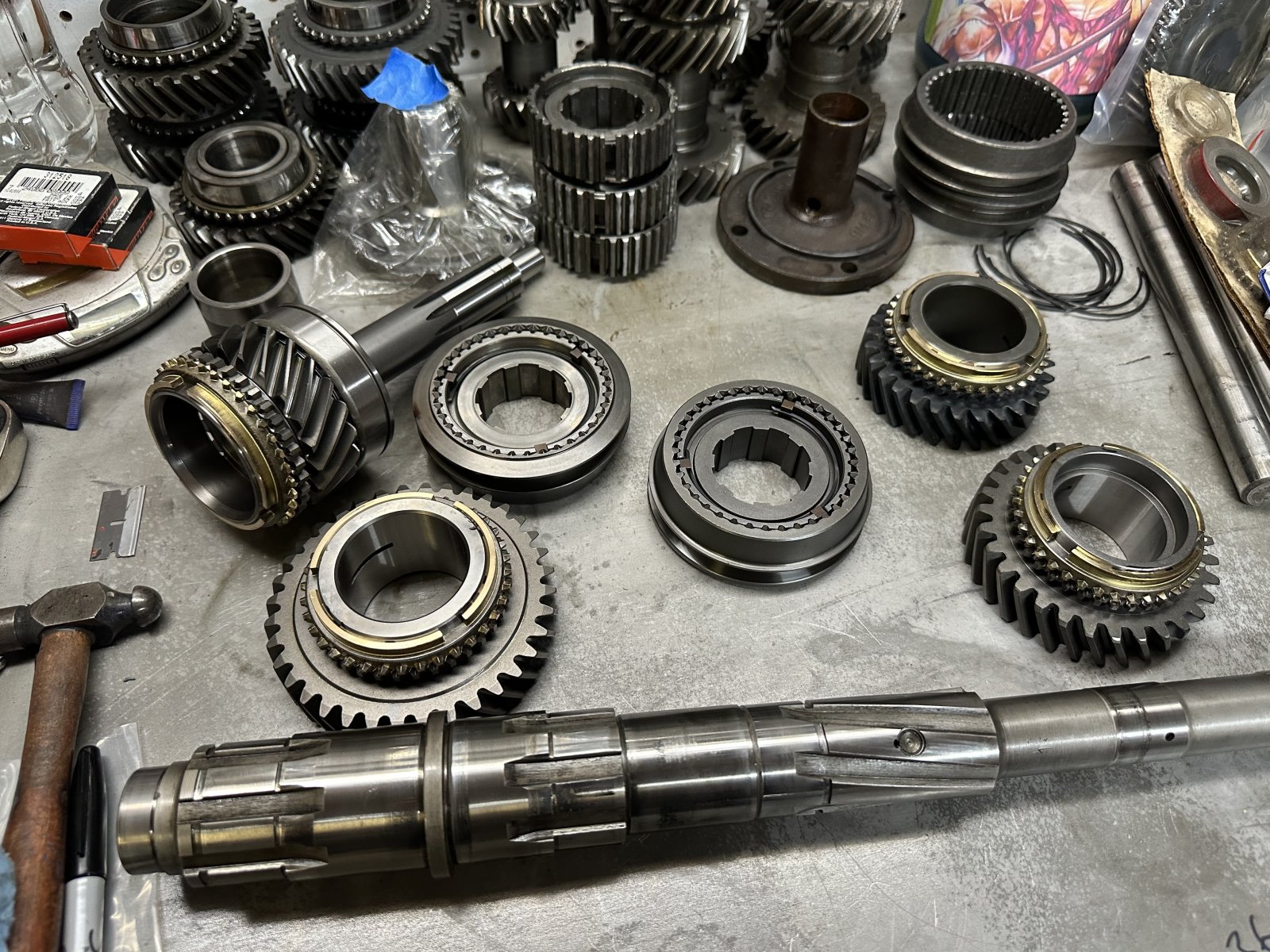

    I’m back. I’ve been gathering Muncie junk (wait, can’t say that again) parts and I’m finally gearing up to put this thing together again.
    5240CA07-6456-4043-8814-B8F56B74A3CA.jpeg D3AC8FF9-2FBD-4632-9CC7-29E9FF99621A.jpeg

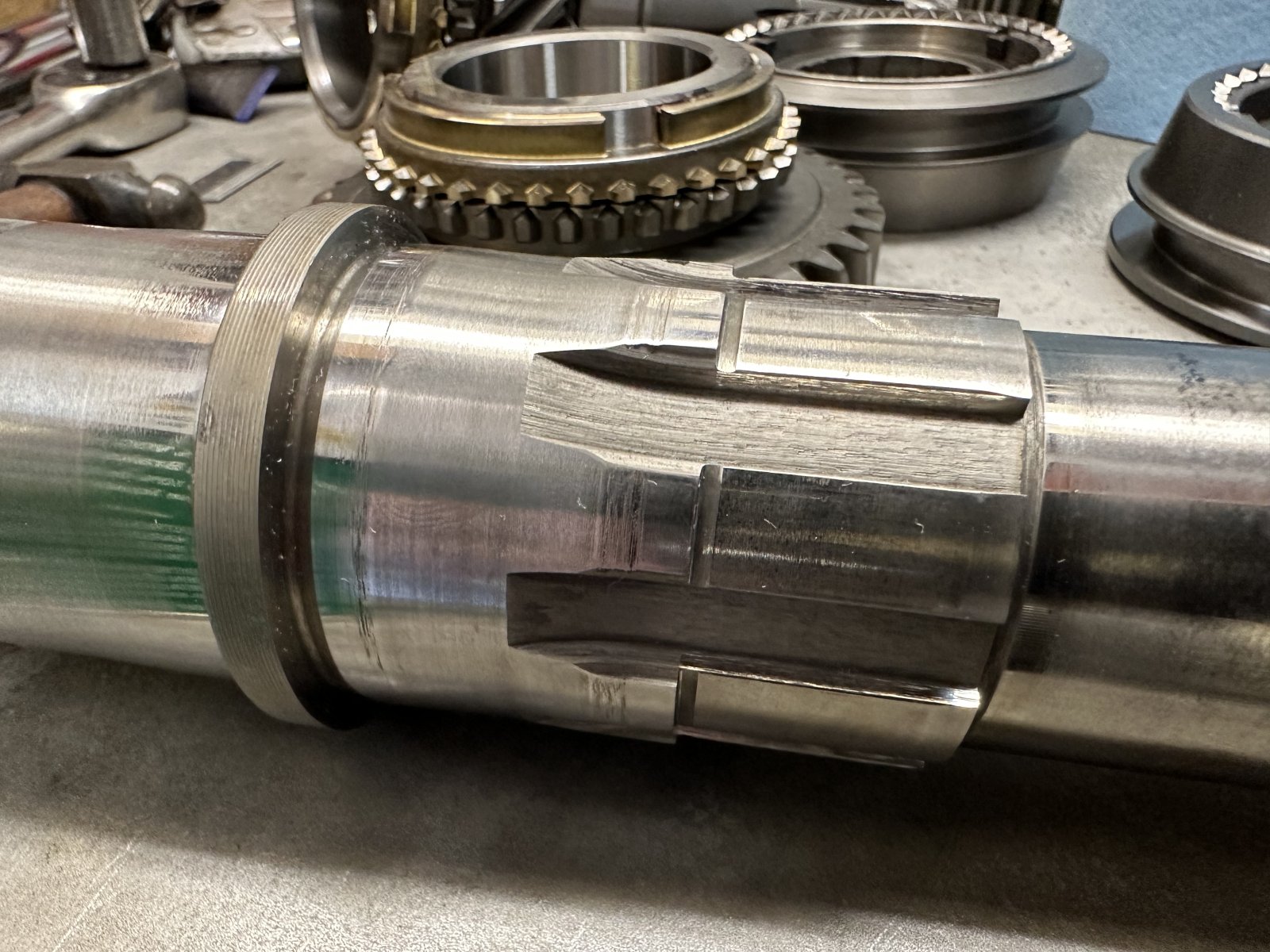

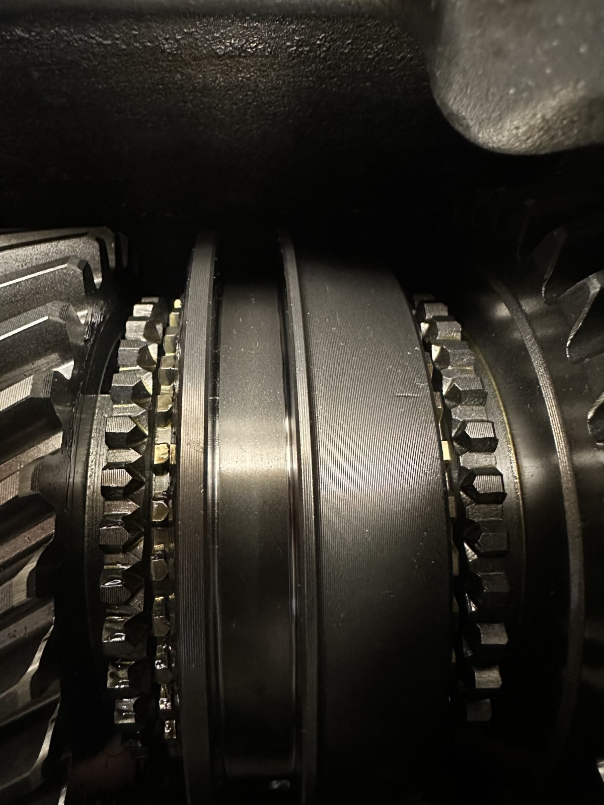

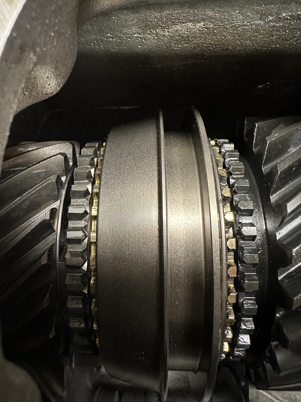

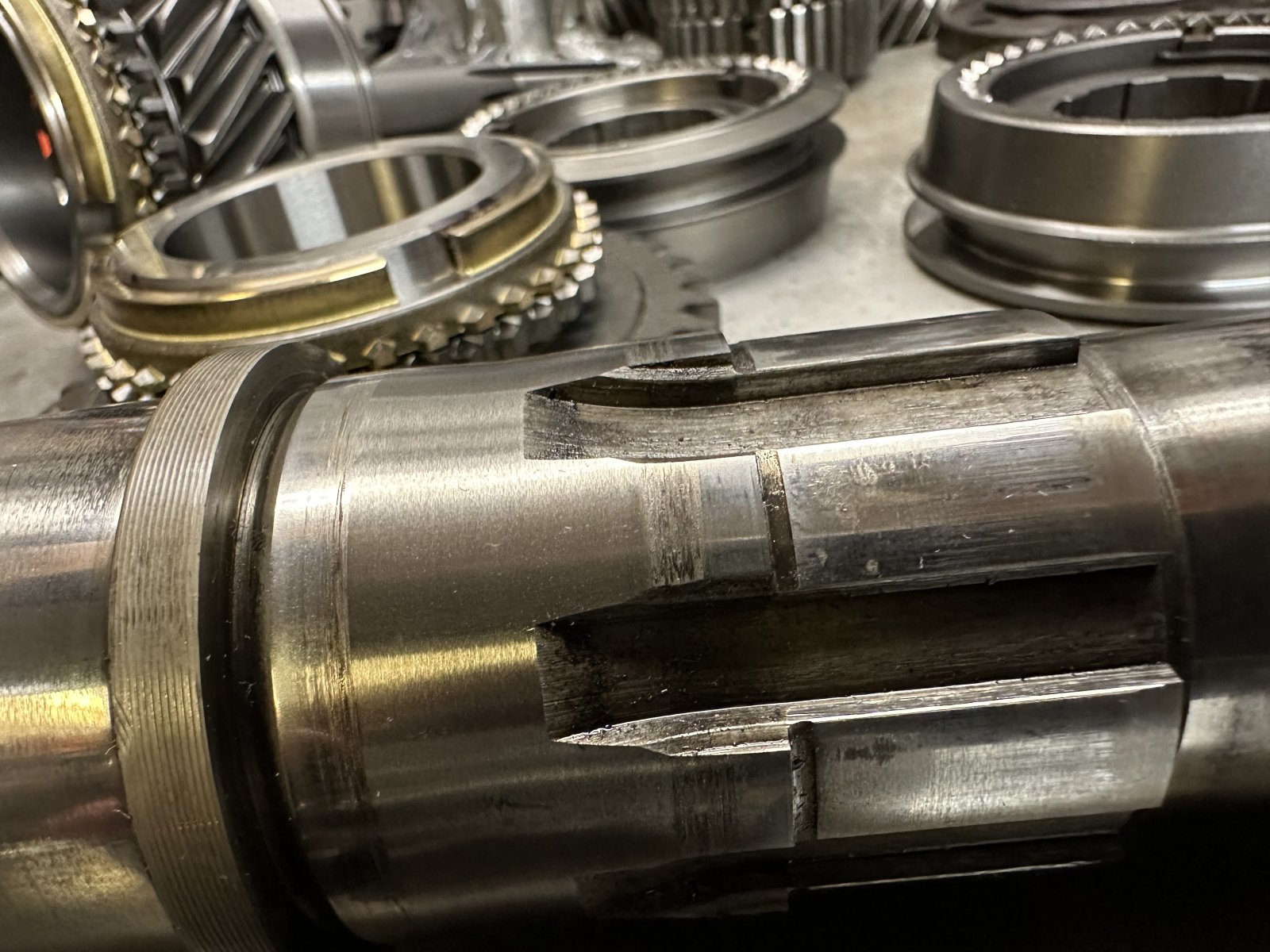

    I got my synchro ***emblies ***embled and my input bearing on and then took a close look at my mainshaft and found some scratching where second rides. I guess I’ll try dressing it with emery cloth at home today or maybe spin it up on a lathe at work this week. If you can polish a crankshaft, you can polish a mainshaft, right?
    Hope it works. I’m tired of buying Muncie parts.
    There’s a joke in there somewhere!
    Budget36 and lewk like this.

    I polished my mainshaft for a while this afternoon and got everything nice and smooth. Second gear spins nice and quiet so I think I can get away with it.
    I also dressed the midplate with a file and smoothed out some damage.

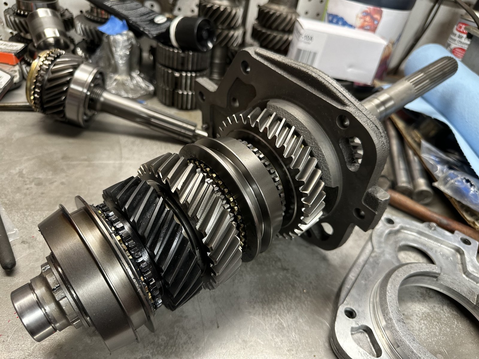

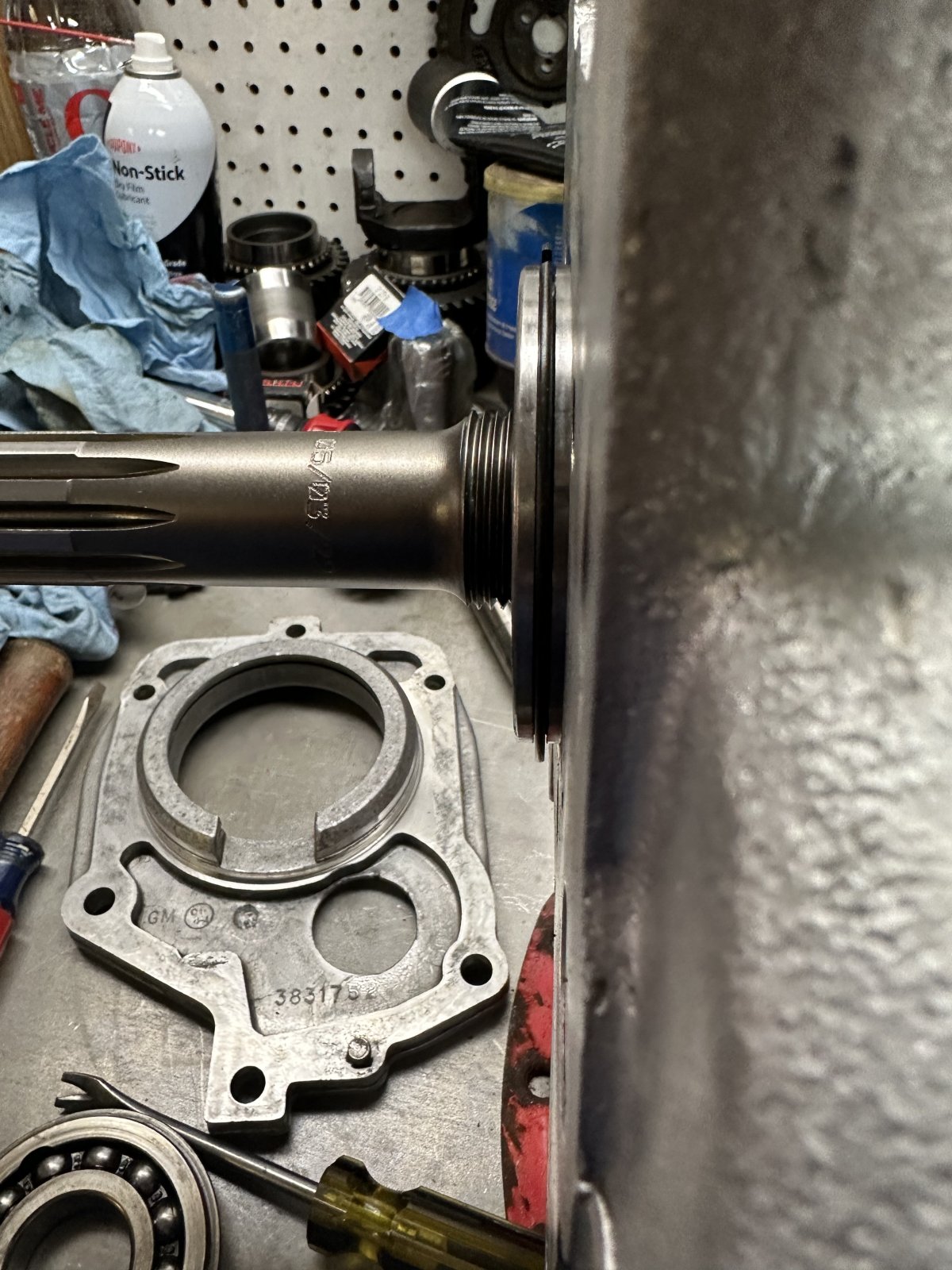

    I then ***embled the main shaft components. Unfortunately, my original speedo gear wasn’t looking great. I have to order a new one. 6BBF105C-998F-4A30-A444-A2F8D85FE1B6.jpeg

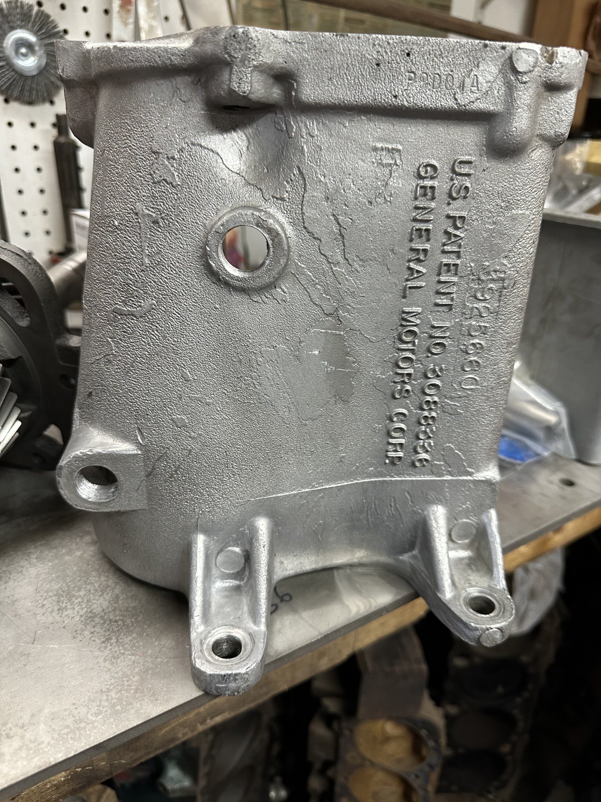

    Next up, I’ll clean the case and drill it for a drain plug. Lots of family activities this weekend so I ran out of car time.

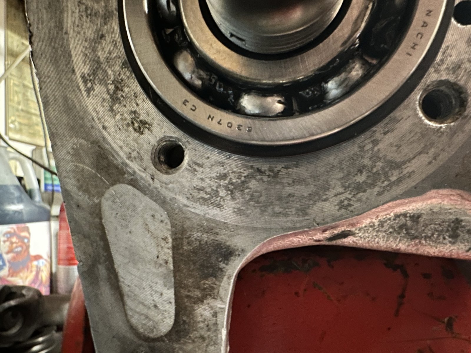

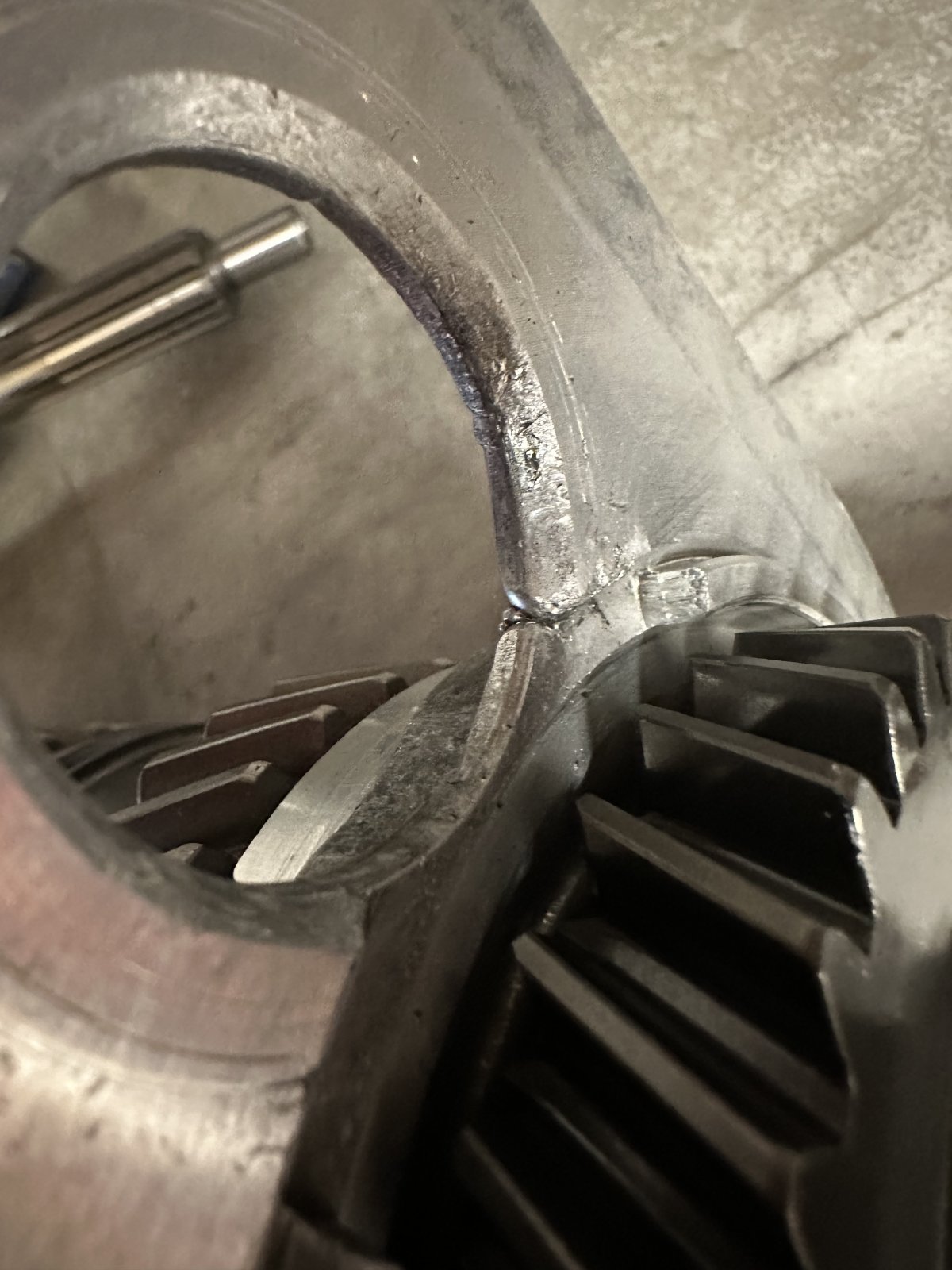

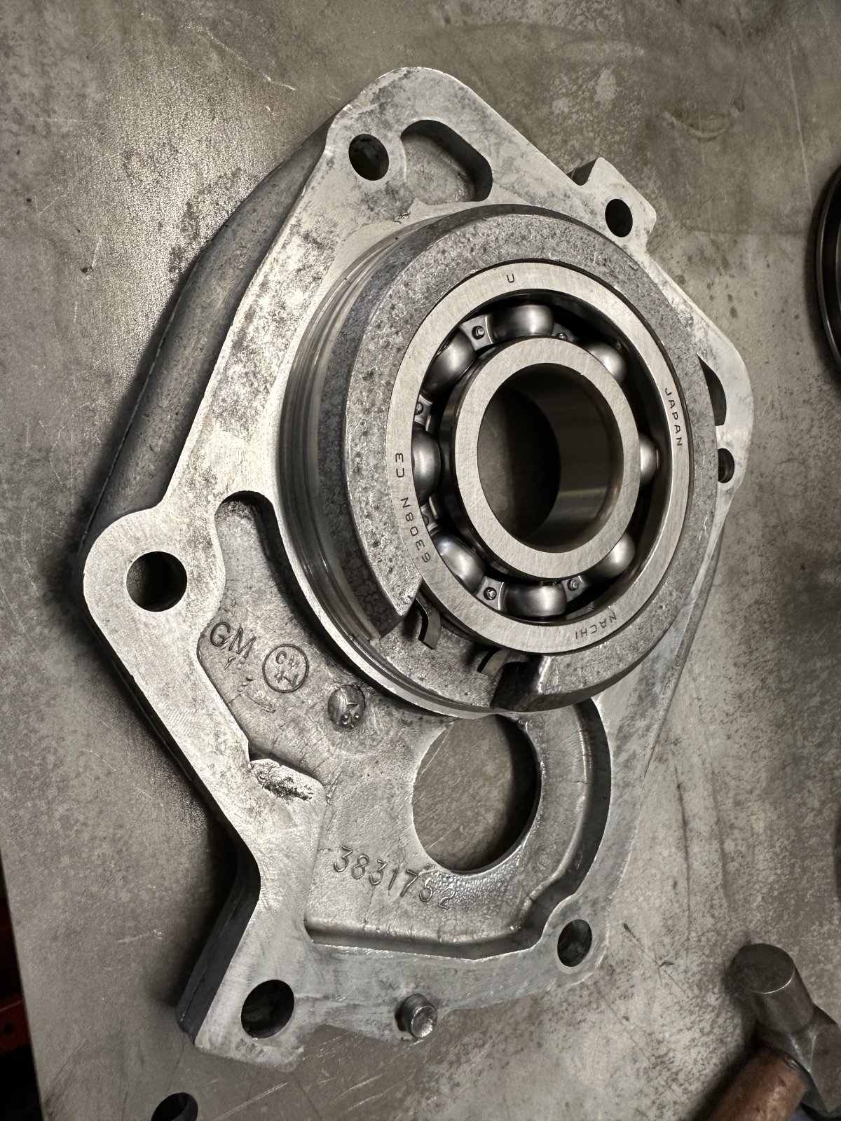

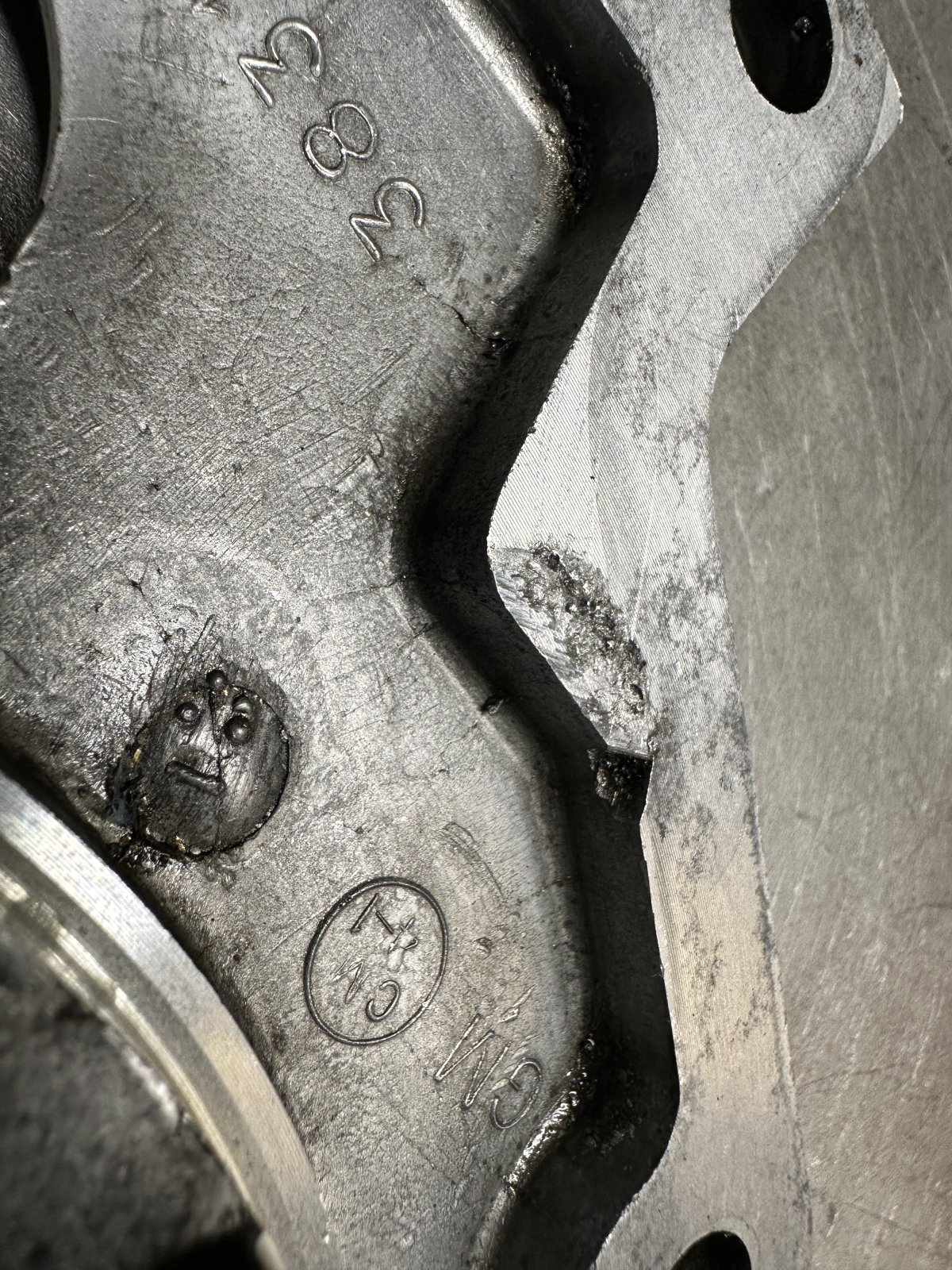

    Does that midplate have a crack in it by the counter shaft hole? If so I would replace it!
  6. lewk
    Joined: Apr 8, 2011
    Posts: 1,080
    lewk
    from Mt
    If you’re looking at this spot, I think it’s just a casting flaw where the aluminum didn’t fully fill. It doesn’t seem to be spreading, maybe…

  7. 427 sleeper
    Joined: Mar 8, 2017
    Posts: 3,366
    427 sleeper
    That hole isn't for the counter shaft, anyway. It's for the reverse idler.

  8. bobss396
    Joined: Aug 27, 2008
    Posts: 18,732
    bobss396

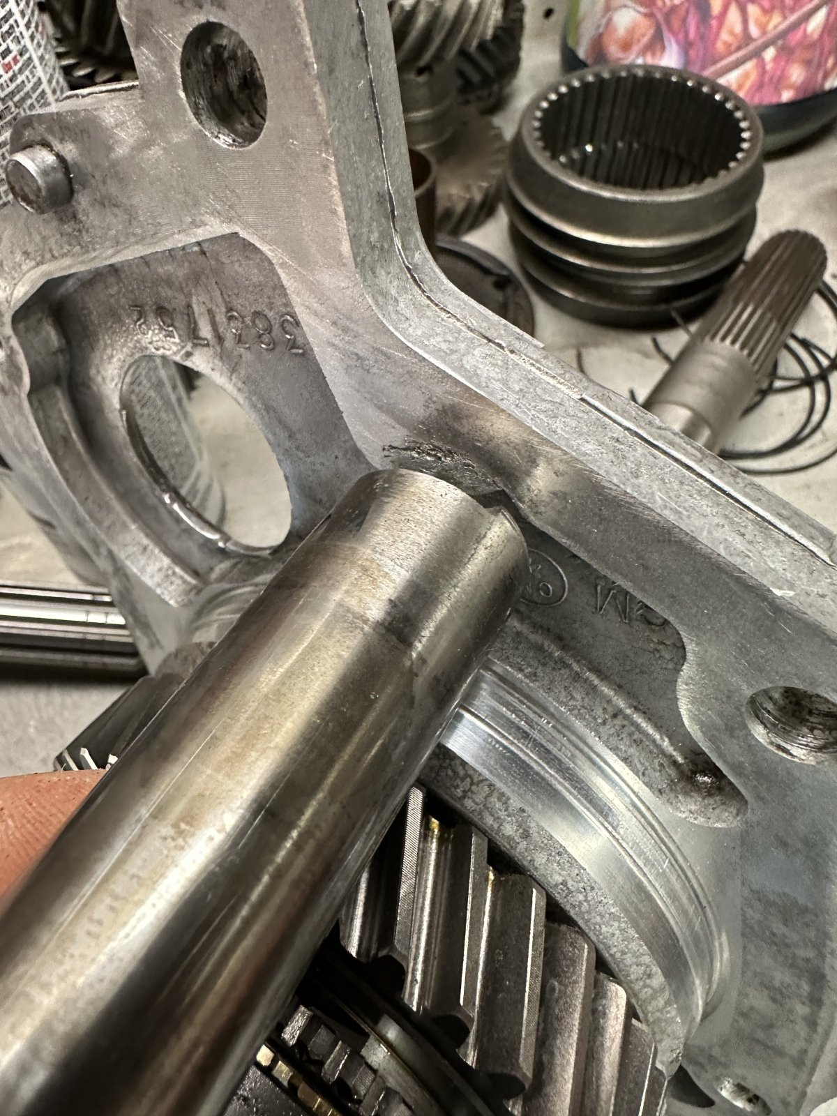

    My mid plate was toast. The countershaft spun and the key acted as a lathe bit, put a nice big spotface in my plate.

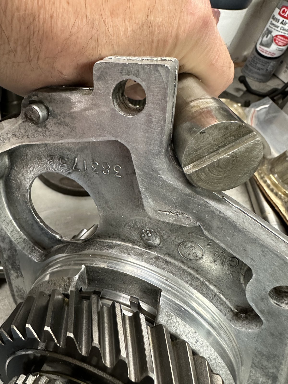

    Ok, apparently I’ve been almost deliberately ignoring the damage to the midplate where it prevents the countershaft from spinning. Now I feel blind or stupid or something. I guess I need get a nodular iron midplate. Unfortunately, I just spent my hobby money stash on a 48/49/50 or so Snap On bottom box to match my grandpa’s top box. I guess I’ll get back on the trans in a week or two…

    Unless I am missing something the countershaft isn't supposed to spin Lewk, It has a notch at the back to lock it in place.

    Yes, correct, the shaft should not rotate. I think folks were trying to point out the damage to the midplate where that notch rides, but I was focusing on the casting flaw by the reverse hole. I had seen the damage, but hadn’t considered why it was there. bobss396 describing how his countershaft spun and ate the midplate made me see that mine was headed that way.

  14. bobss396
    Posts: 18,732
    bobss396
    Yes, the step on the end of the shaft will bore into the mid plate. Mine from day-1 was recessed about 3/16" into the main case. I didn't think it was an issue until it was taken apart. The funny thing is that these shafts are virtually indestructible. My builder had a few drawers of salvaged ones, 7/8" and 1". My case was bored for the 1" shaft.

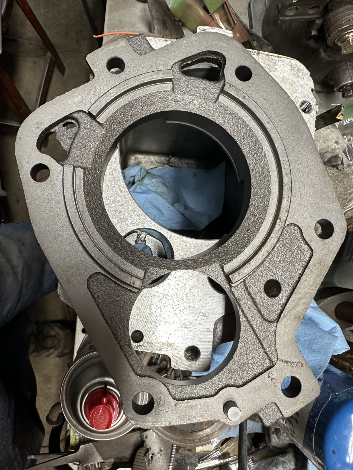

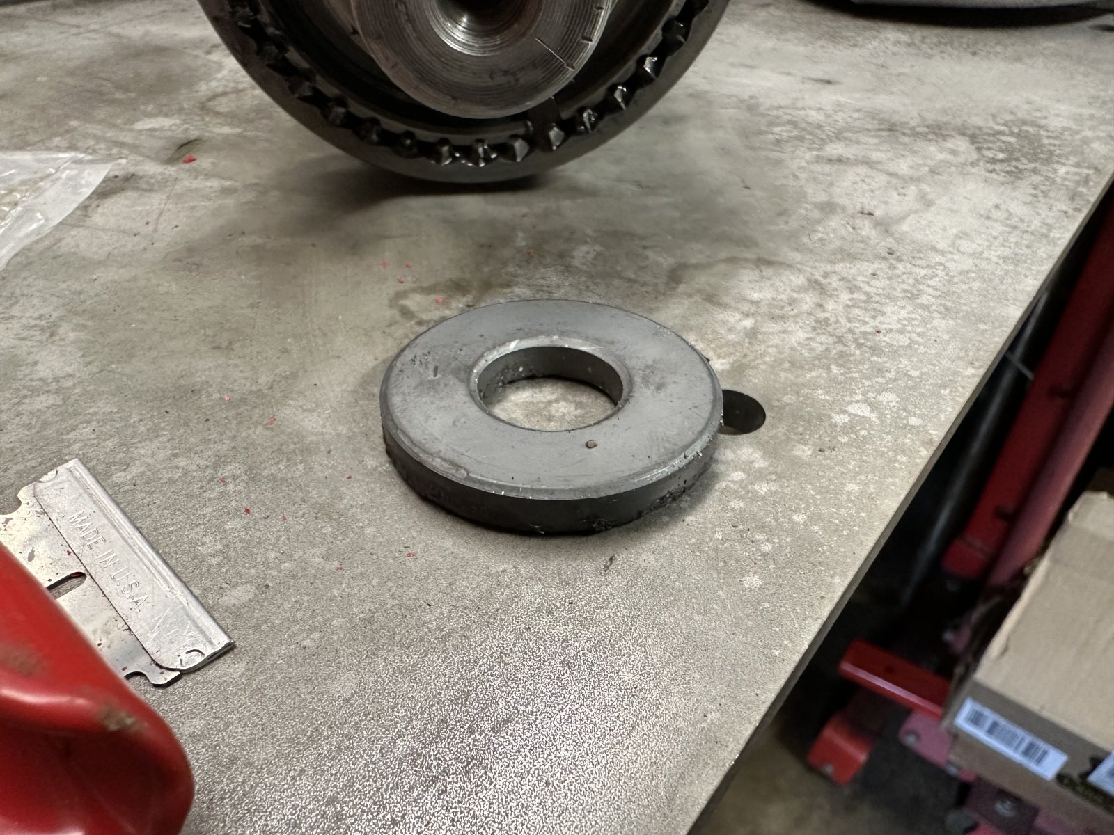

    Alright, back on it. The iron mid plate came in and I got it mounted.
    I drilled and tapped for a drain hole. (1/2-14 NPT if anyone cares)
    The factory magnet basically fell out while I was messing with the drain plug. It would have been exciting to have that latch onto a gear later. I’ll use a magnetic drain plug instead.

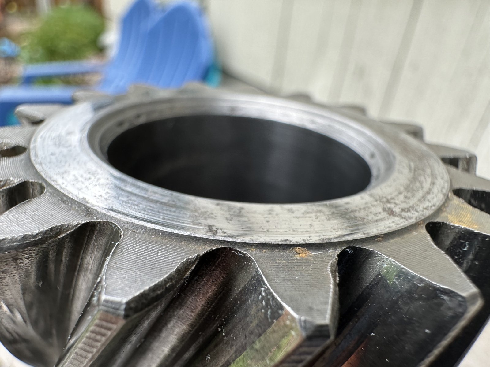

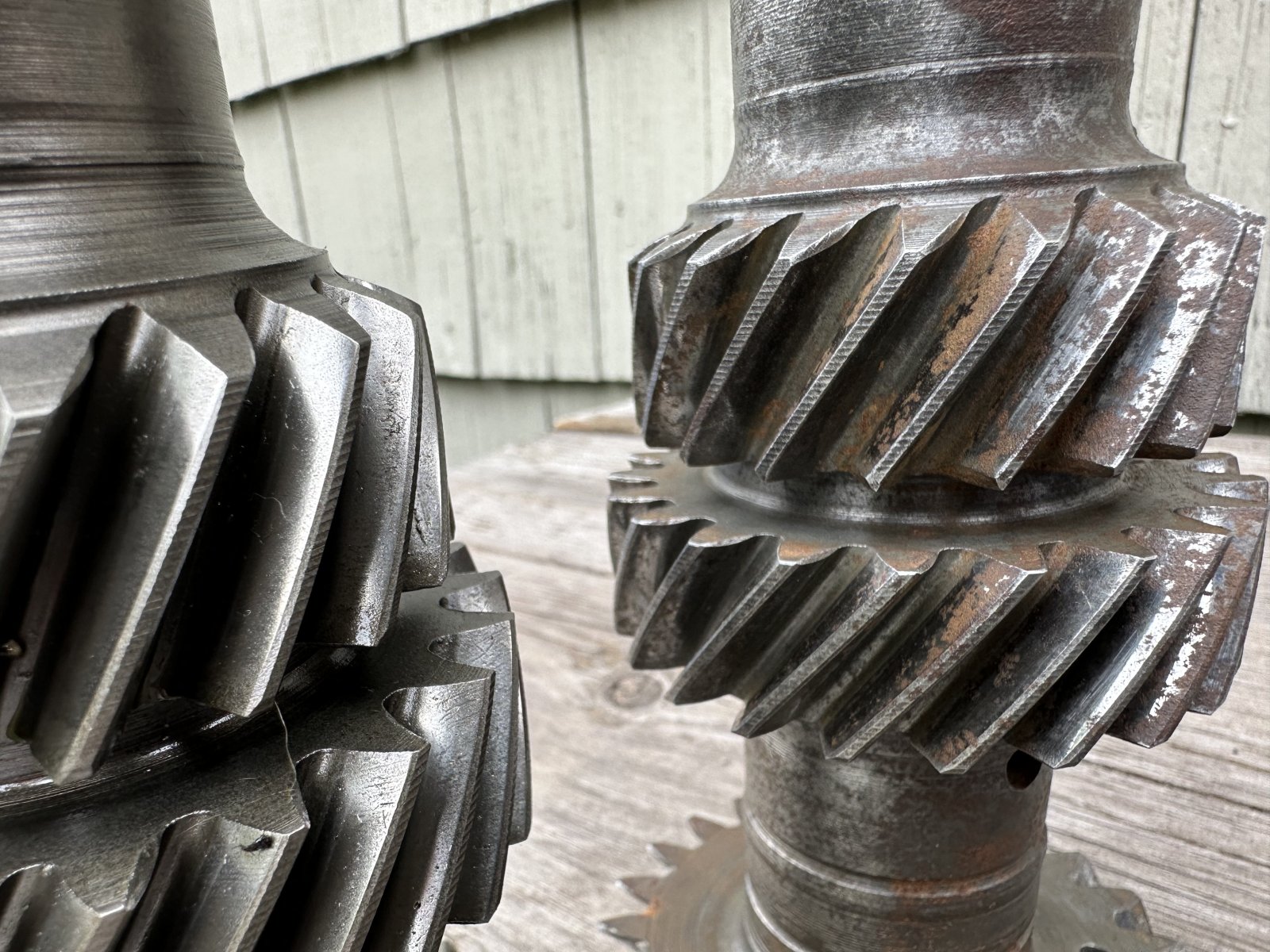

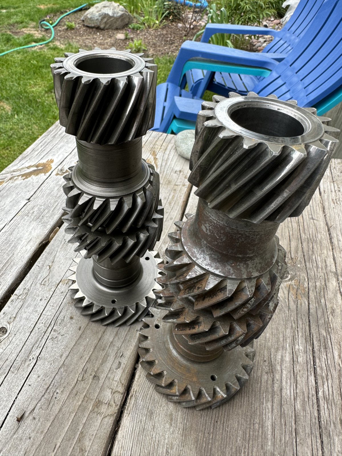

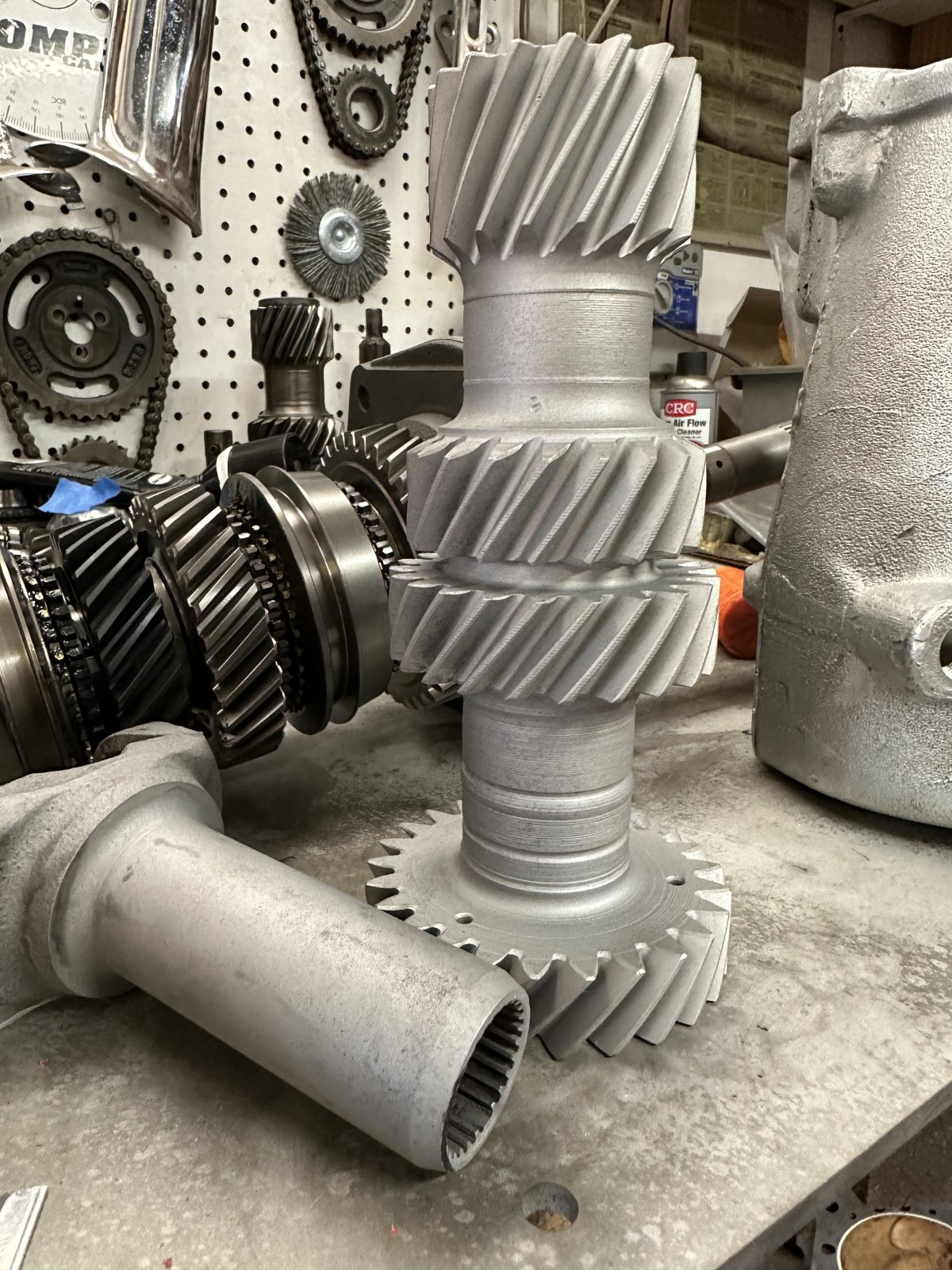

    I cleaned up my cluster gears. I have two, the one from my trans and one from a helpful gentleman in San Diego. The San Diego gear has some surface rust but much better end bearing surfaces, so I think it’s the winner.
    I’ve still got to do the tail shaft bushing and find my driveshafts and choose a yoke to test fit and then hopefully I can do some ***embly.

    Regardless of which mid plate you use , if the counter shaft bore in the front of the main case is loose , the countershaft will eventually spin . most old cases need to be bushed so the case/ bushing/ shaft are a press fit When bushing the case , be sure to maintain the counter shaft thrust bearing surfaces intact, that will help prevent the worn thrust surface as exhibited on your one counter gear .

    Its not so much the spinning that enlarges the case bore , its the input trying to push the cluster gear away , plus when you drop the clutch or speed shift its akin to hammering the shaft sideways in the case . Changing to a 1" shaft requires a different cluster gear . If I had choice between which cluster gear to use , I'd have the better gear ground flat & use extra shim to take up the end play .

    I found a 27 spline yoke on one of my drive shafts and bead blasted that and the San Diego Cluster Gear. SDCG seems like a winner. Surfaces look pretty good.

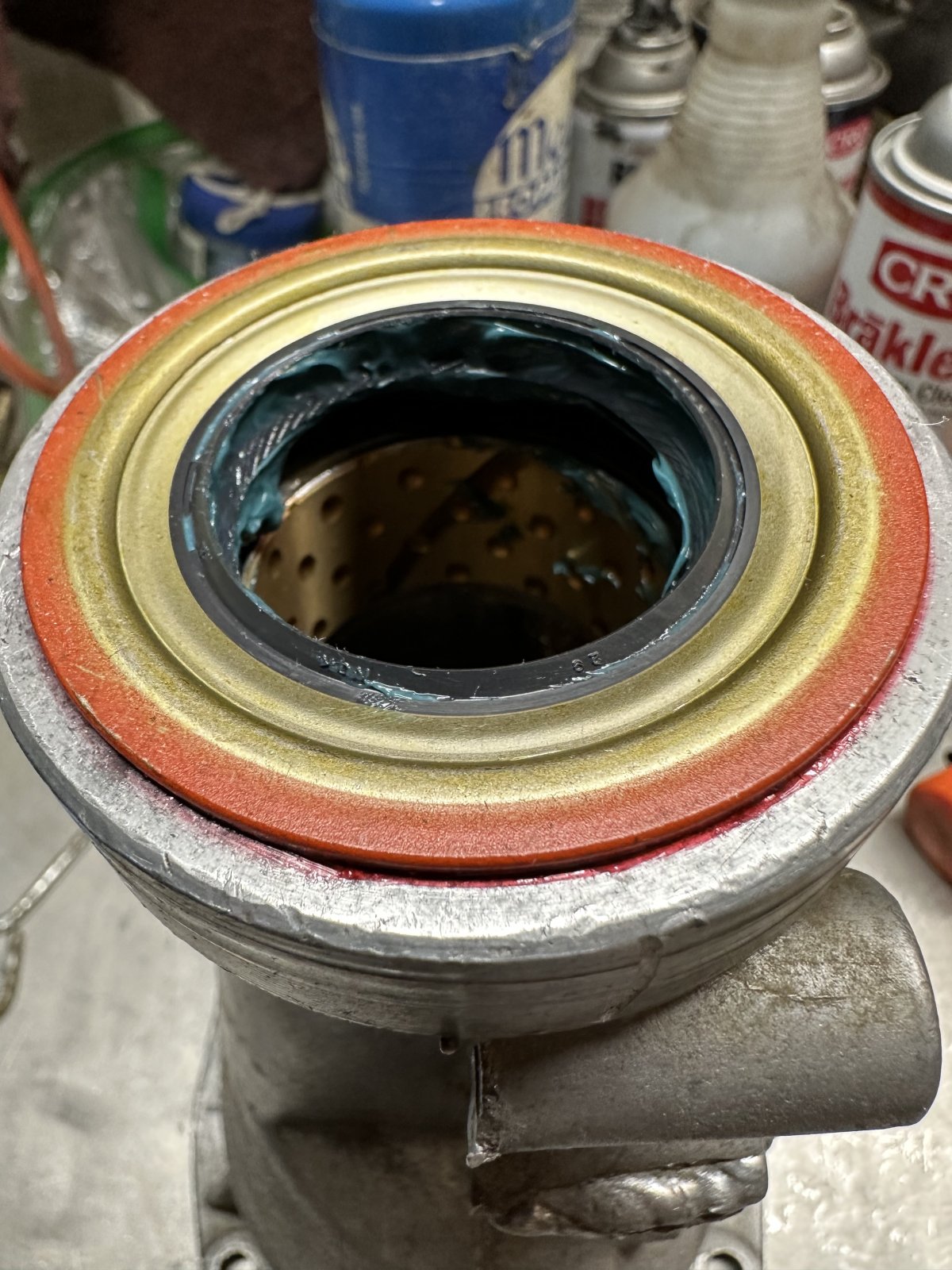

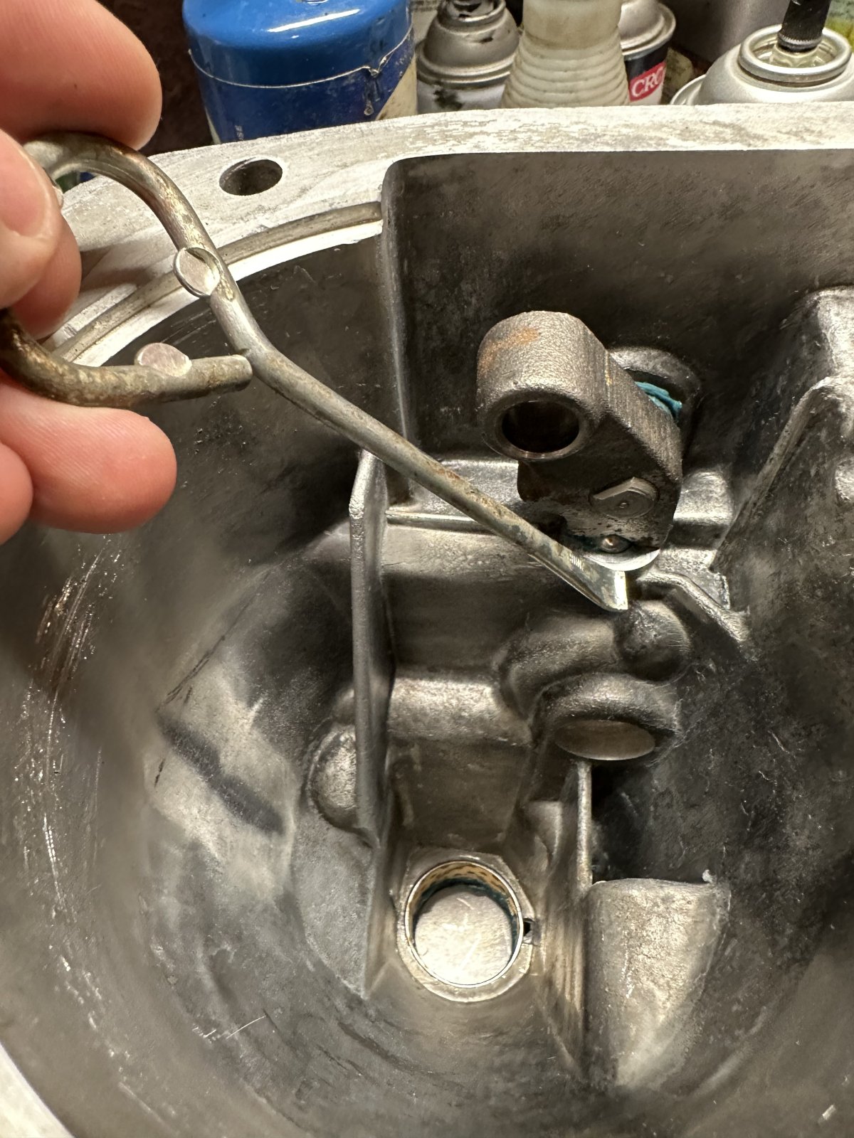

    Sheesh, tough crowd! :D I know I’m slow but family first, work, and then I try to play cars on the side. I did get the tailshaft housing cleaned, bushed, and sealed.
    Paul has a ground down prybar to get the detent ball compressed on his vid, but I found an old church key and it worked fine.

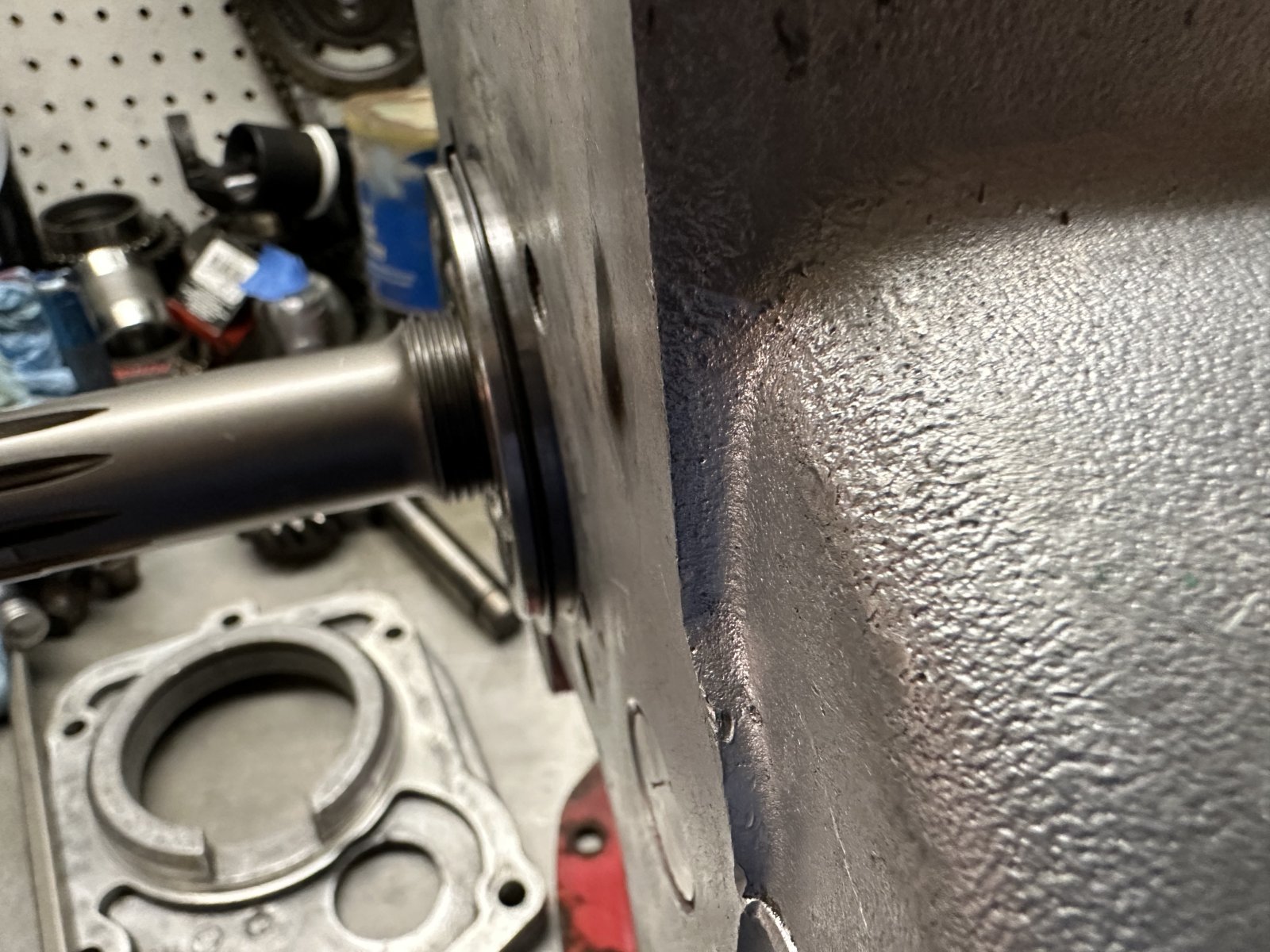

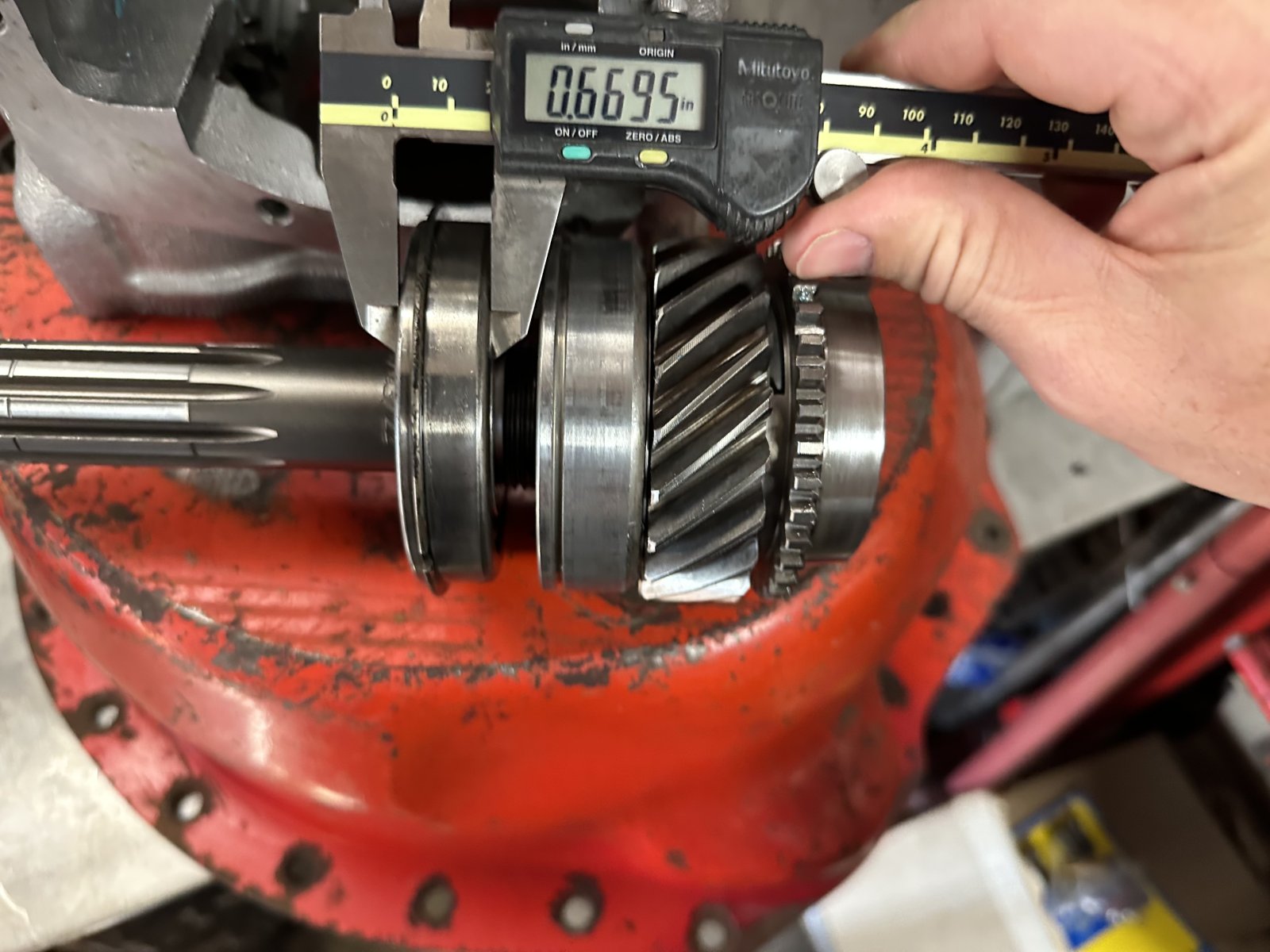

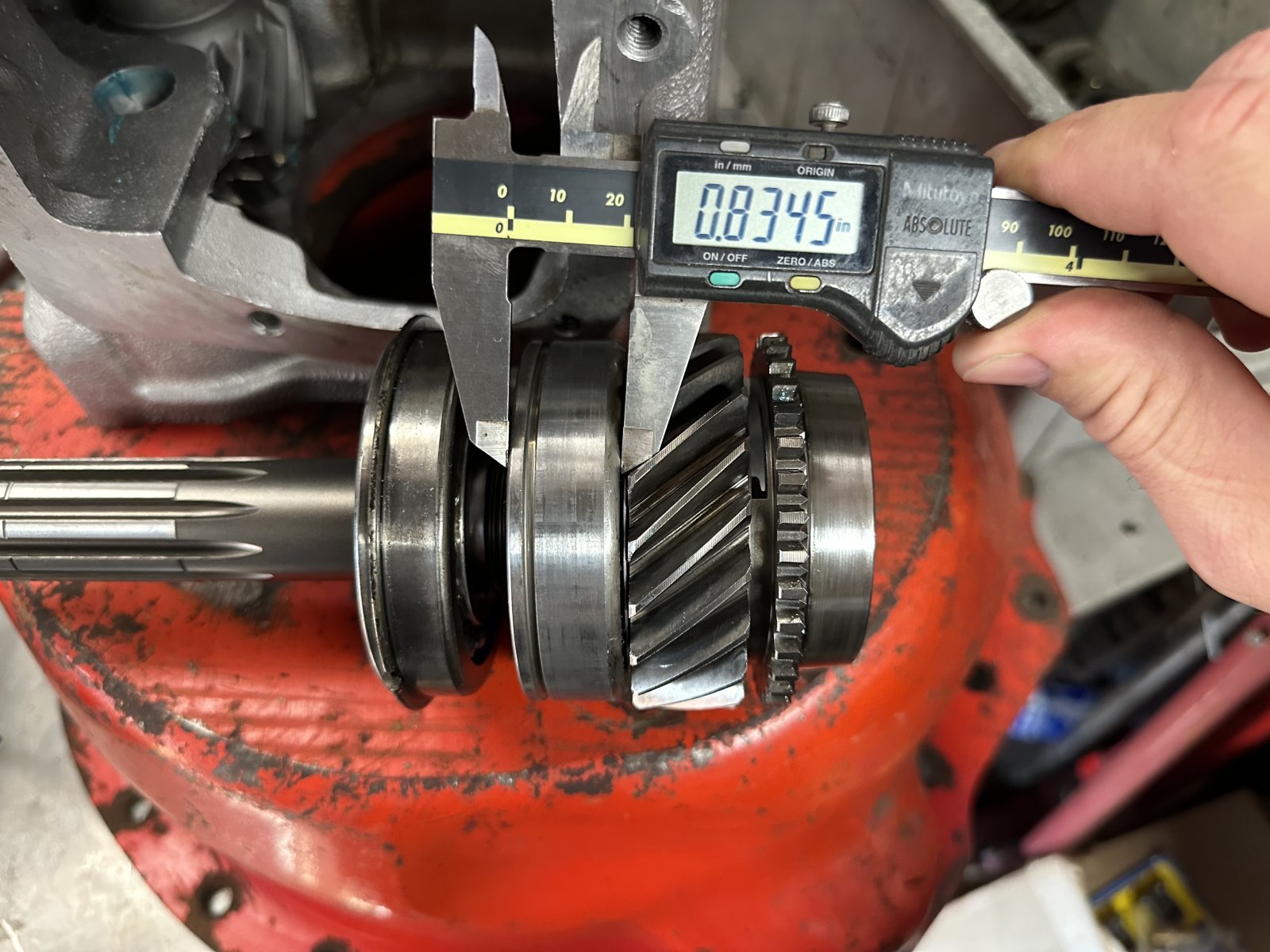

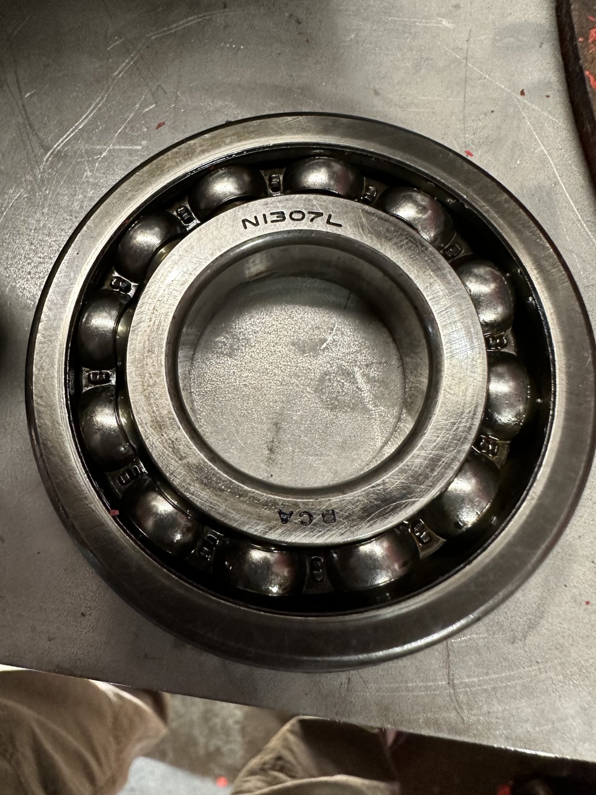

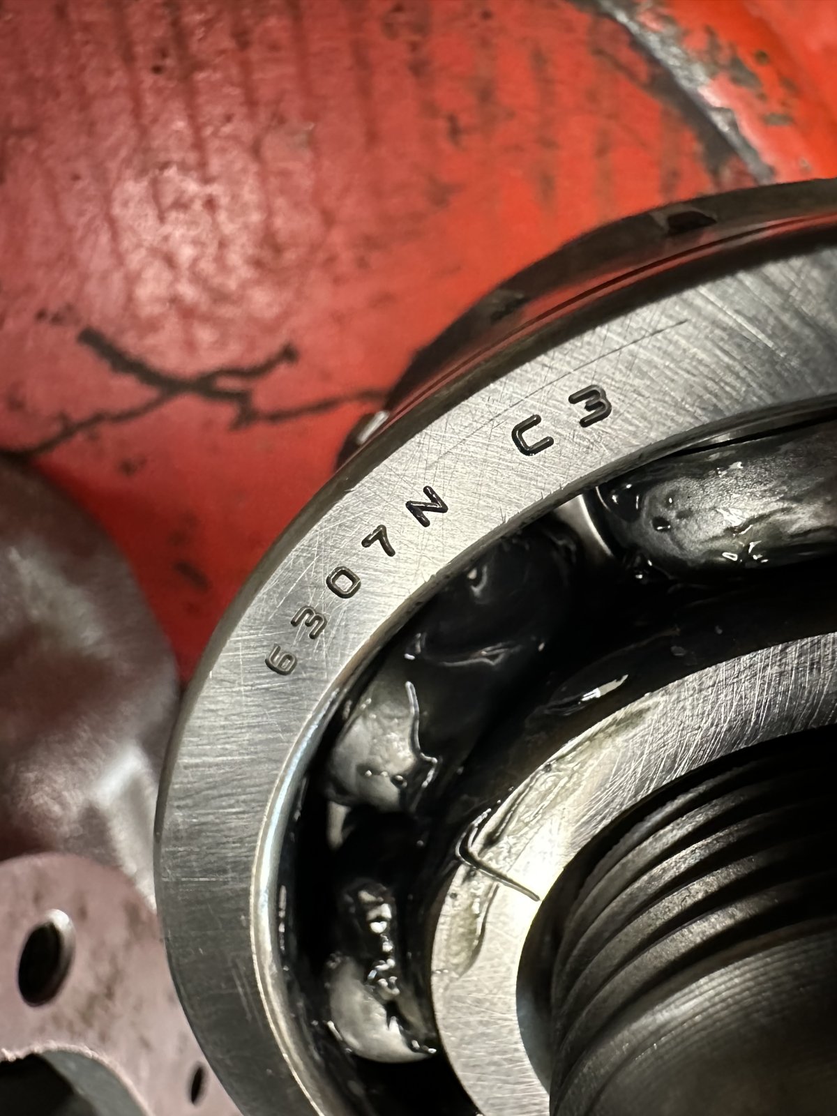

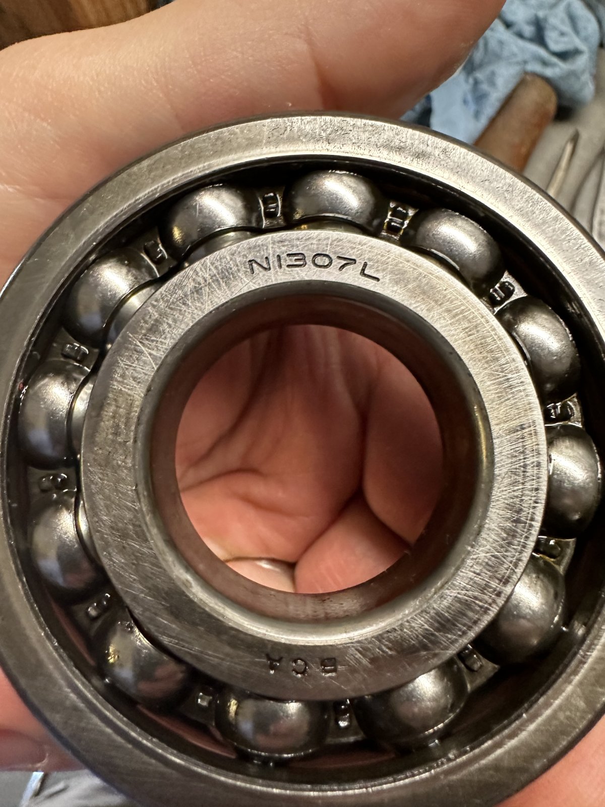

    I ***embled everything last night and my front bearing isn’t seating how I think it should. Everything is too long. I found another thread with a similar problem with an incorrect bearing from the same vendor I got my bearing from.
    https://www.jalopyjournal.com/forum/threads/muncie-help-needed.1237877/page-2
    I still need to tear it down and compare the new bearing to my original. I ran out of patience last night.

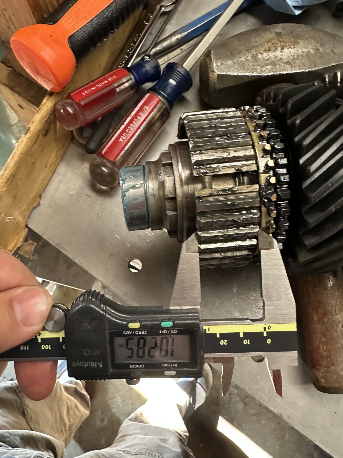

    I’ve either got the wrong thick bearing, messed up some sort of basic ***embly thing, have a fat early 3/4 hub (that one is used) or my new mid plate is goofy. I’ll tear things apart tonight and see. I also tore a gasket with my repeated ***embling last night. Yay.
    I need to spend some time with some bearing websites and try to find the specs for both the new and old.
  30. lewk
    Joined: Apr 8, 2011
    Posts: 1,080
    lewk
    from Mt
    The hub p***es the sniff test but the front bearing fails. I guess I’ve got to get a N1307L.
    3D3AE7AF-DD42-453E-8FC6-9BBF128E742E.jpeg EDBE4C73-2727-4825-A135-F0364288B84A.jpeg
    5C724A6D-E27A-4390-A285-E7FF9654D45F.jpeg 104554AD-3383-49B9-8A66-182FBF07C594.jpeg 5831B837-F708-482E-8228-CB013D2D0BA5.jpeg
    This is the same problem from the other thread and I ordered the part from the same reputable vendor. You’d think this problem would be better known.
