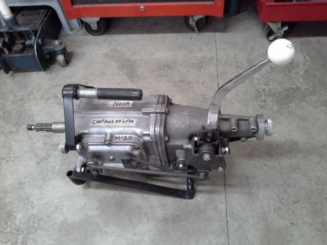

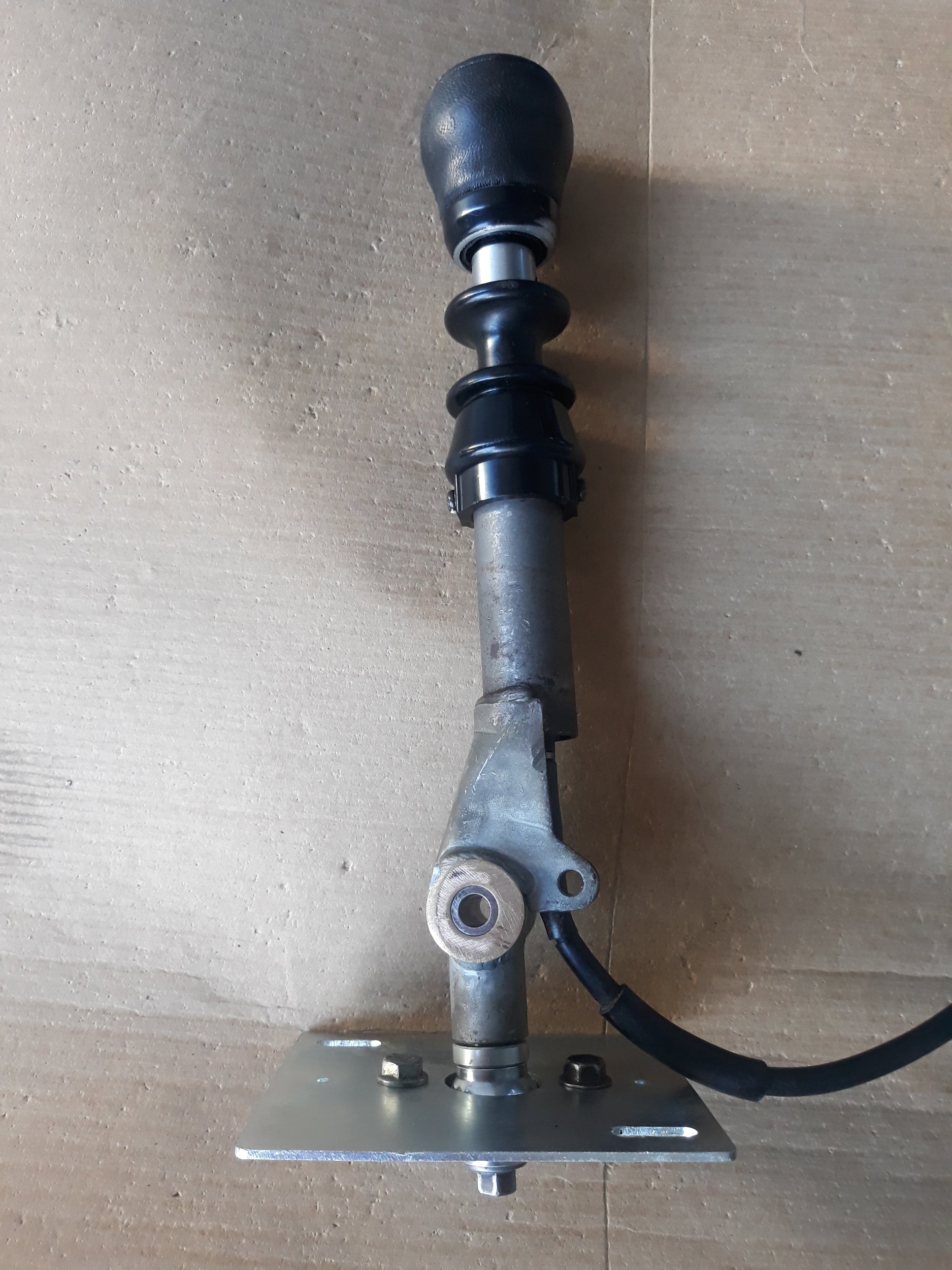

    Use a 3 speed shifter on a 4 speed, and a separate lever for reverse is the easiest.
    Or if you want to get creative , vulture a shift lever off a Subaru with the Pull up ring and cable down the centre of the lever.
    Weld this to a tab to bolt on to a hurst shifter.
    Then make a cable operated detent to lock out the reverse gate
    Here is a Subaru lever spliced onto an FR500C remote shifter [it was used to lockout 1st gear AND reverse on a T56R]

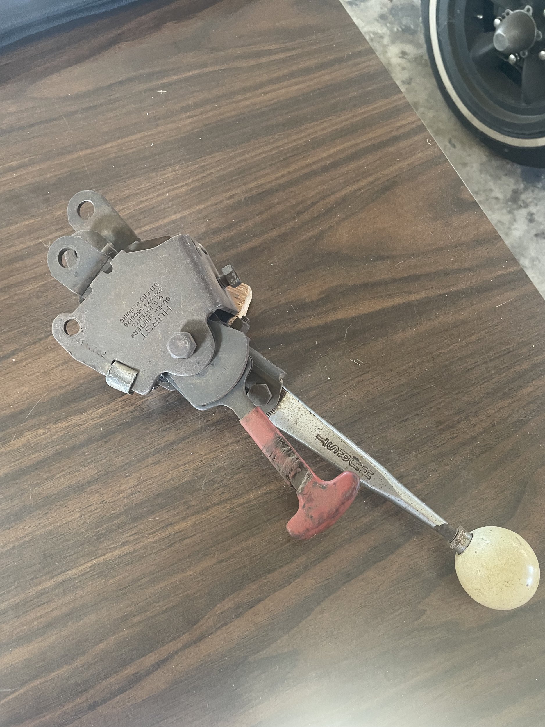

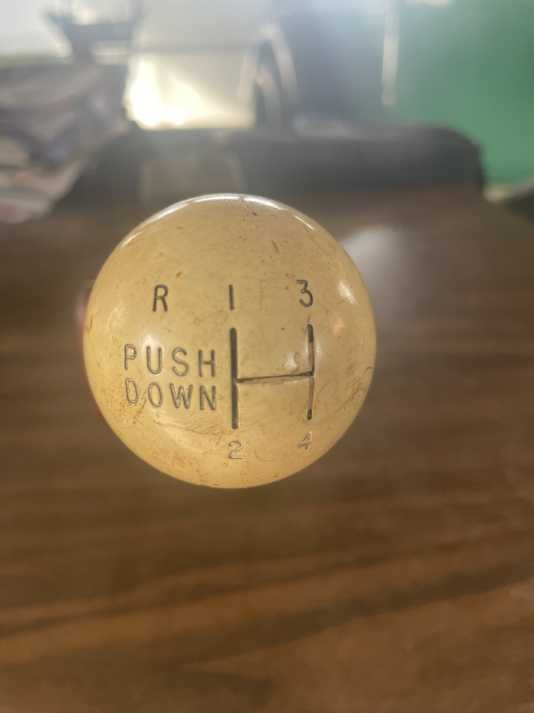

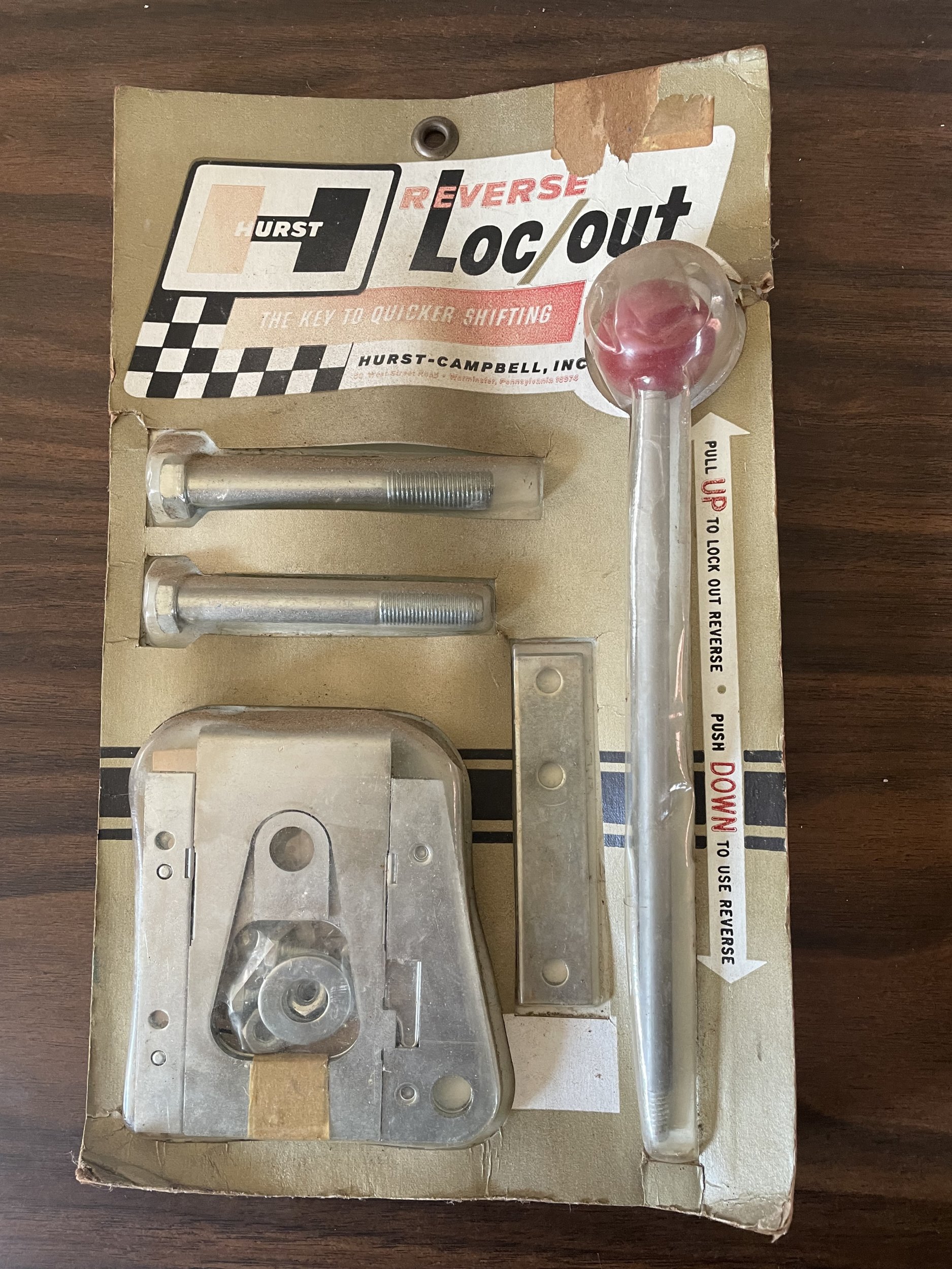

    You may find one of these , will solve your problem. Seems there could be something wrong with your unit, though. I have never had any issues with my good old Hursts, even without a lockout kit. IMG_3820.jpeg IMG_0248.jpeg

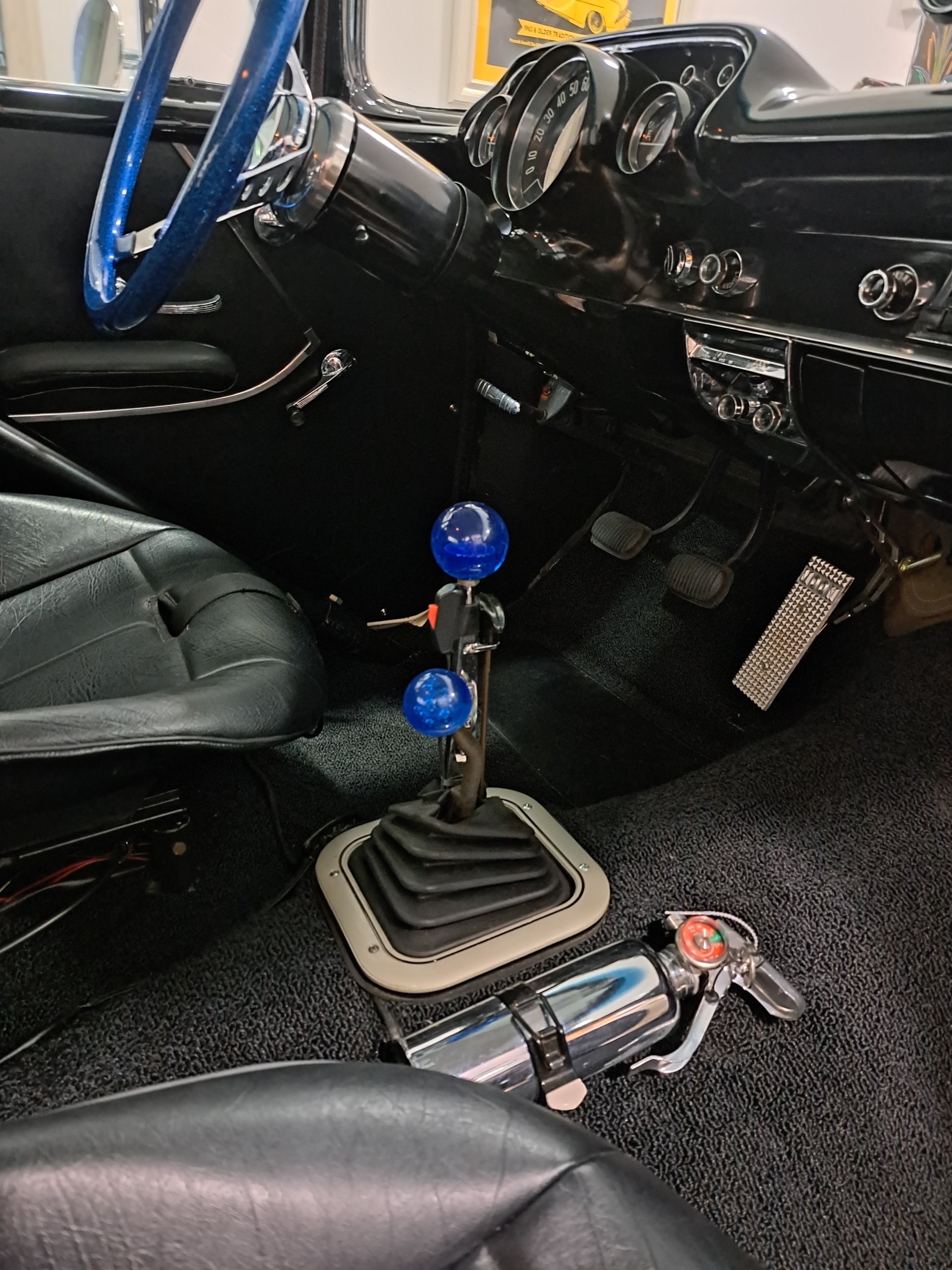

  8. DDDenny
    Posts: 22,924
    I can't see the possibility of that happening.
    Are your levers oriented like this?
    Deuces, Tickety Boo and Oneball like this.

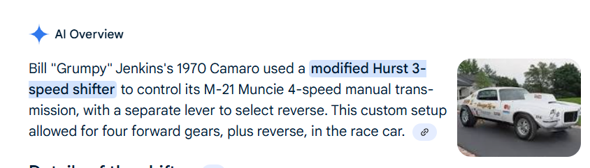

    As Mimi posted above , Use a 3 speed shifter on a 4 speed is the easiest.
    Grumpy Jenkins [have you heard of him? :D] used a 3 speed shifter on his 2nd Gen Camaro pro-stock

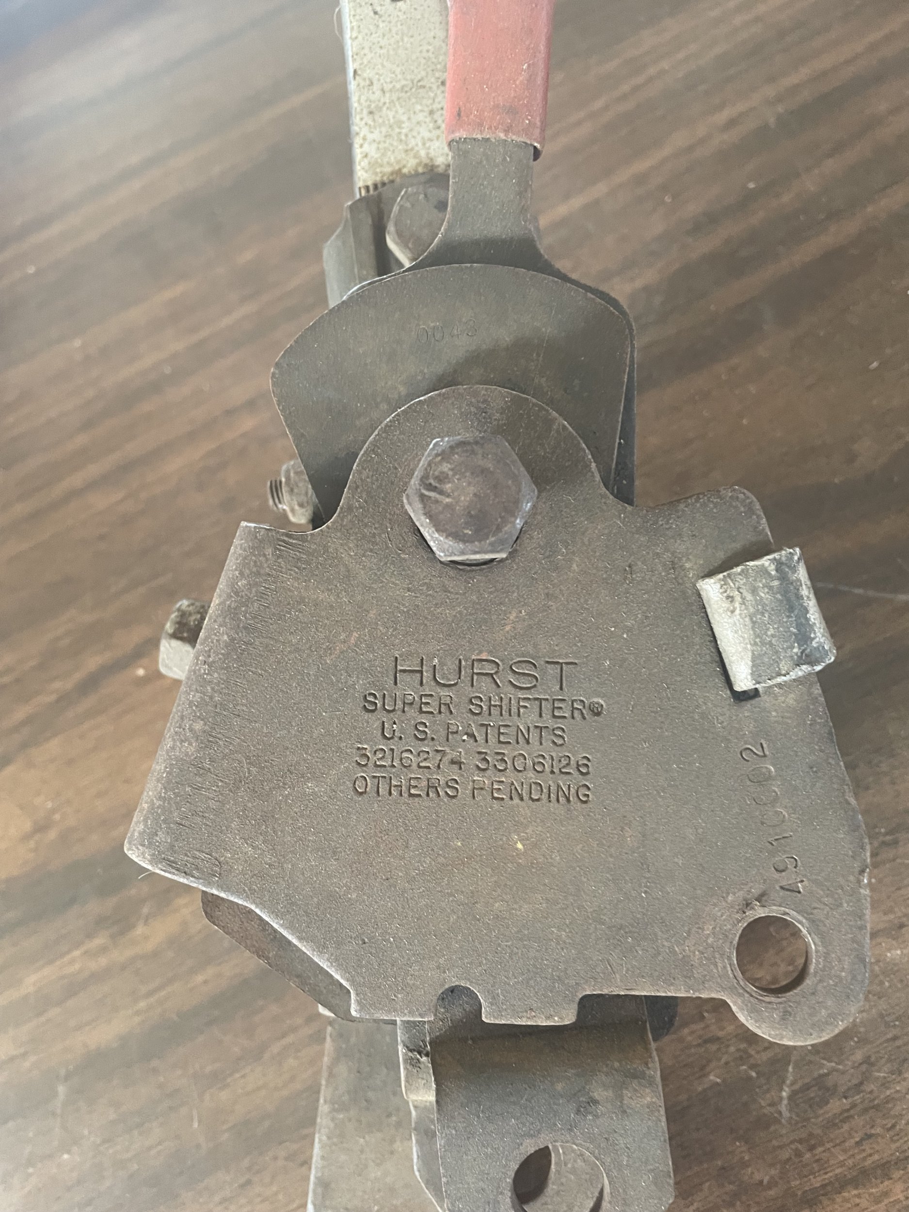

    The other Hurst designed solution, would be the 70’s era Super Shifter. This does the same thing as the original Loc/out kit. Mine has been around the block a few times, but you can get the idea. IMG_3821.jpeg IMG_3823.jpeg IMG_3822.jpeg

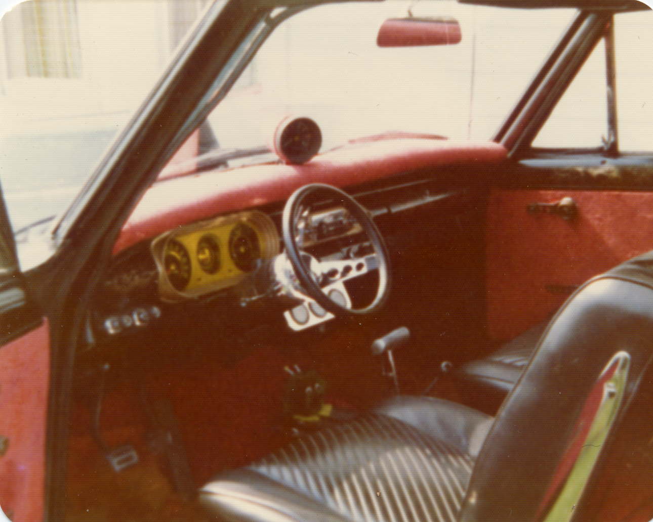

    Ram Rod, can't miss or hit reverse.
