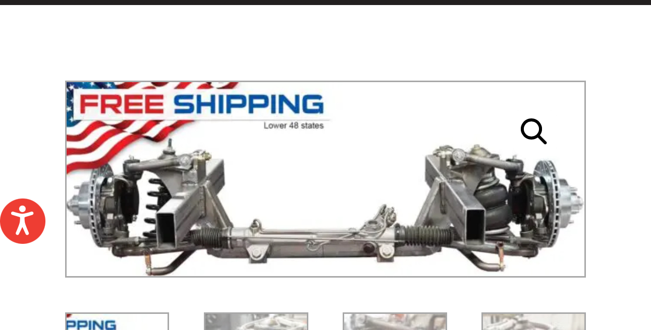

    Looking at options for a mustang 2 suspension for the 55 . Has anyone done one and increased the track width. Looking at a clip that will increase to 70” from 66” .

    So the thought was not to pull parts off an old car but buy a clip from TCI , I gather from other post that members don’t like this idea but make sense in what is gained in adjusting the caster and camber, clovers or air ? Options . I’m currently having clearance issues with my headers , that will be solved . If I could get a total rebuild kit for the front suspension, smaller steering box to mate up to my new steering column I may be good with what I have .
