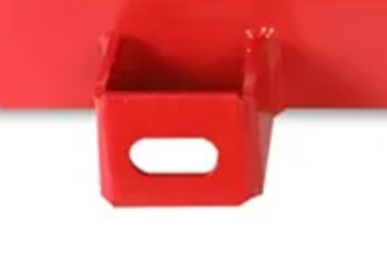

    The later T-Bird rack has two bolts, and about an inch-and-a-half-ish wider spacing towards the p***enger side.
    If you look at the crossmembers in many of these kits you will see that the mount hole on that side is slotted.
    This is so they fit original and later T-Bird racks.
    You should probably convert now, as the original racks are about gone from the world.
    Sources say that the outer two holes on the 3-bolt rack match the 2-bolt one.
    You might need to either make a new right side mount, or cleanly cut off and move the current one.
    P***enger side hole detail:
    The other side is in the same place, so only one side needs to be modified.
    You might also need a different u-joint, shaft modifications (cut shorter), and possibly different hoses.
