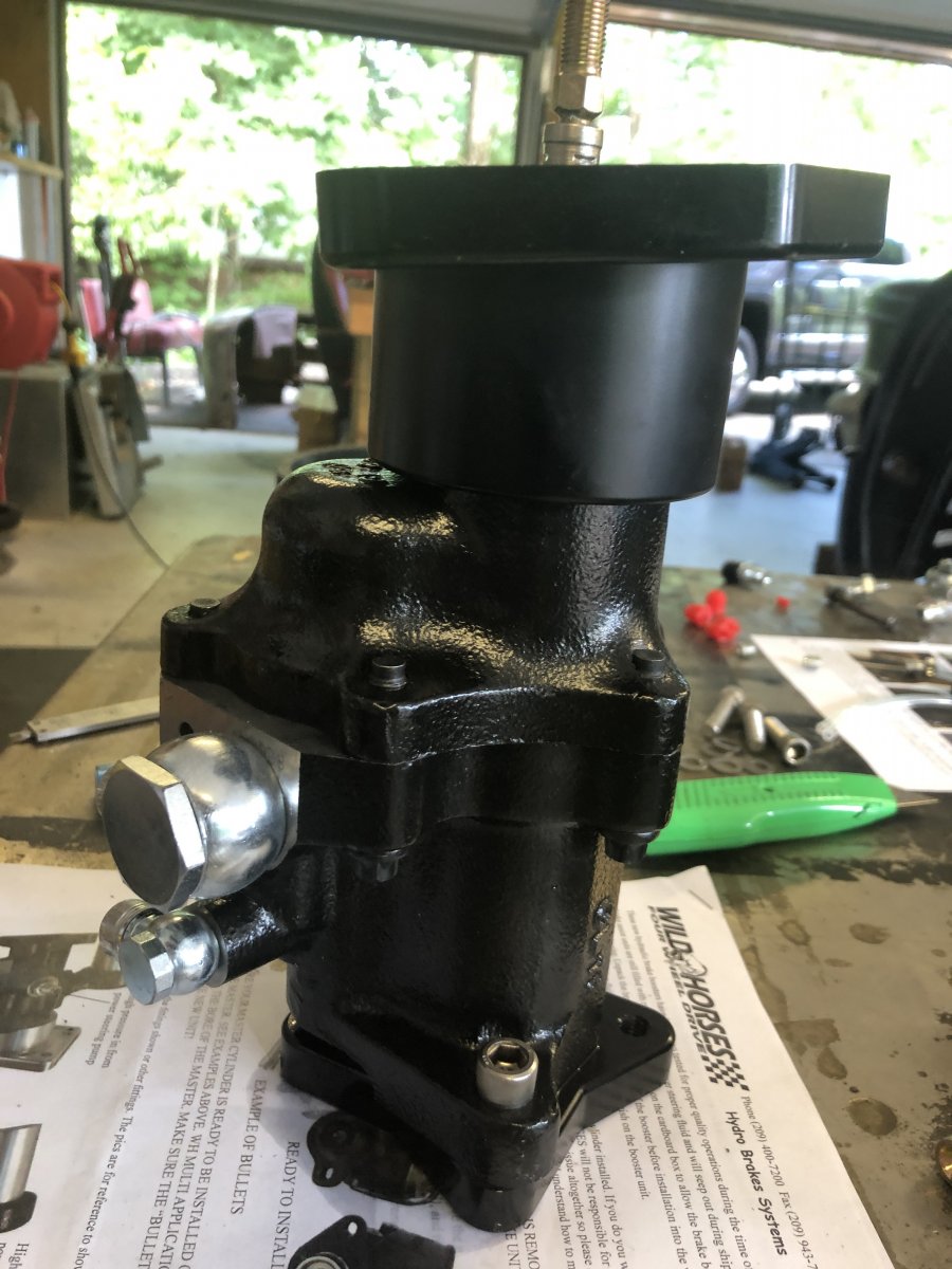

    IMG_5156.JPG IMG_5166.JPG i just went thru the exact same problem.....after months of head scratching i spent the money on a hydroboost setup....it works....best i can figure is the engine made 15lbs of vac at the booster, booster wanted 18.....once the hydroboost unit was on, it'll put you thru the windsheild.....all other parts were not changed at the install of the hydroboost

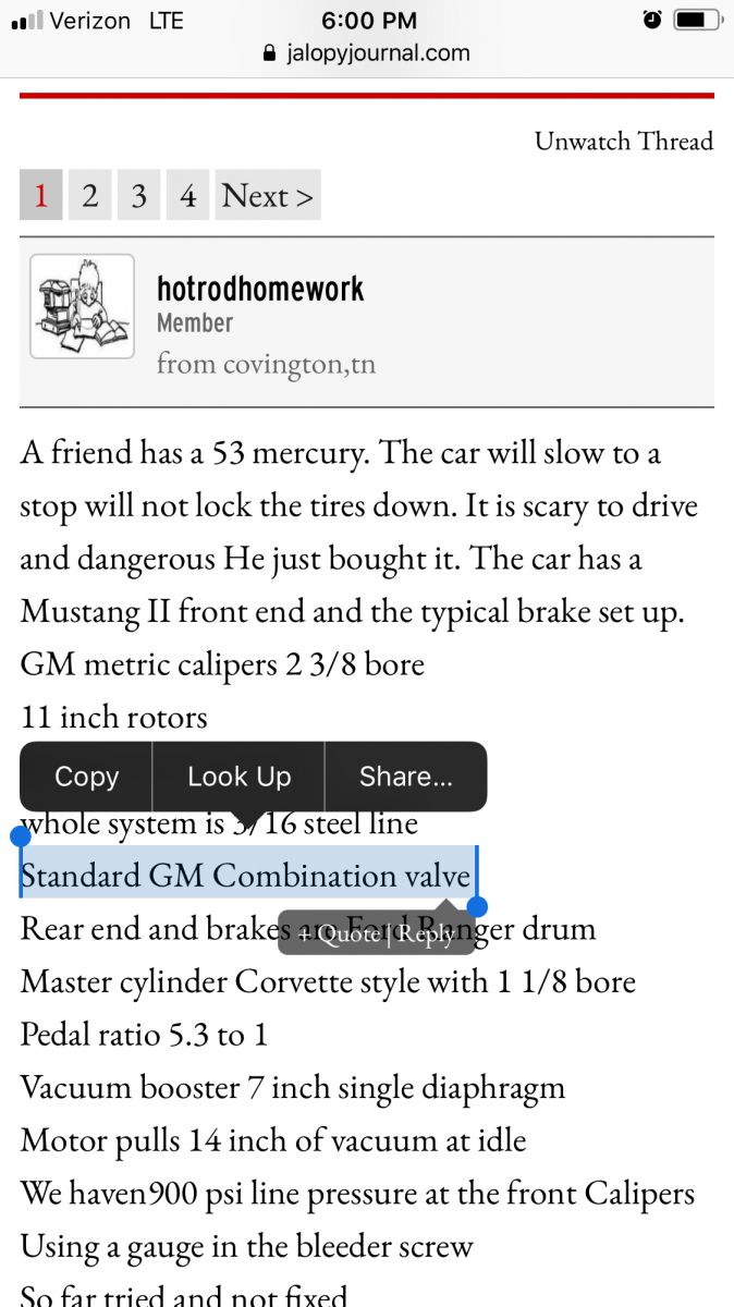

  19. This is what I'm thinking. Simpler is best for the application, I use a proportioning block on old cars. You don't need an advanced proportioning valve on a '53 Mercury.
    This is what I like to use, simple to set up and no moving parts inside... that I am aware of.
