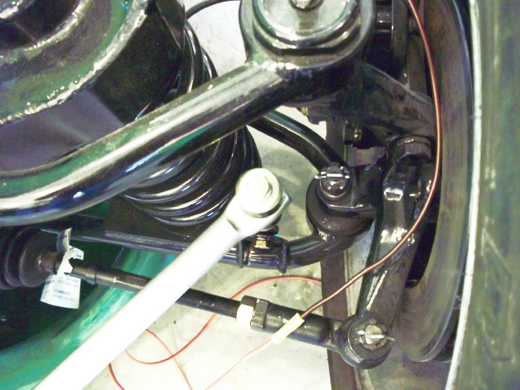

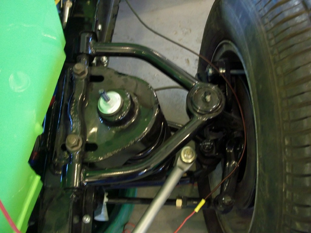

  10. Cut 3/4 of a coil out and re-installed the spring. Lower control arm is now "level" to the ground with the car on it's tires. This moved the upper arm so the top of the ball joint is level with the top of the spring tower. I now have about 7/16 inch clearance between the ball joint and the tower. That is with the t-bolts at the full outside limit. Should be just enough room to adjust the camber ( I hope).
    It was hard to measure the upper arm accurately with the bodywork covering it but, it is about 7 1/8 from the t-bolt center line to the hole for the grease fitting.
    Installed new shocks and these limit the down motion of the control arms. It appears that the limit is about 1 1/2 inches down. I fabricated some 3/16 steel brackets that will bolt to the crossmember and hit the lower control arm to limit the travel so the upper ball joint stays clear of the spring when the car is jacked up. Then I'll install shocks that wont be "topped out" at this length. I just don't like the idea of the shocks being the thing that limits downward travel.
    I'll post more pictures after the lower "stops" are installed.
    Thanks to all for their input!

  12. HooRay! Cutting 3/4 of one coil off the springs got the lower control arm level and gained over 1/4 inch of clearance of the ball joint from the shock tower.
    Adjusted the camber to +1 degree an still have over 1/8 inch clearance with the t-bolts near the center of the slot.
    The shocks still limit the downward movement to about 1 1/4 inch so I will try for some that are at least 1 inch longer.
    I install some 3/16 thick steel brackets to limit the downward movement when the car is up on a lift. See the pics.
    Guys, Thanx a bunch for the help.

    I hope I'm just seeing things, but double check the weld in the last picture just above and to the left of the bracket you bolted on...
  14. banditomerc
    Joined: Dec 18, 2005
    Posts: 2,511
    banditomerc
    Dittos,looks to be a hairline crack.better safe than sorry.:cool:
  15. Holy COW! You are correct. there was a crack in the weld. I guess I was fixated on the bracket installation not the weld. Since I did the install from "behind" the axle line I guess I never looked closely at the other side of the assembly.
    I attacked the area with a carbide tip on my dremyl to clean it up and then, with the welding rod sticking straight out from the handle I could poke it right into the crack.
    ZZZZZZZZZZZZZZZZZZZZit, 2 passes locked in the frame to the cross member.
    You guys surely save me a big headache or a catastrophy in the future. THANKS
    I did check the other welds and all look OK.
