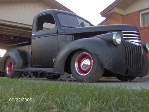

    Here is a pic of a Mustang II front end under a 46. The thing about these trucks is even with the fat fenders, they are still a fairly narrow truck. I've seen plenty of metric chassis, camaro subs, etc put under these and the tires practically stick out of the fenders. I love the fact that mine tuck so nicely under it and driving it everywhere now I've only ever rubbed the nose once on a speedbump and the tires never rub the fenders. It drives like a freakin sports car...
    And for what its worth, mine is a stock crossmember I cut out of a 74 Pinto, Heidts 5/8" Narrowed upper control arms and speedway springs.
    Scot
