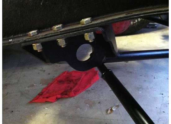

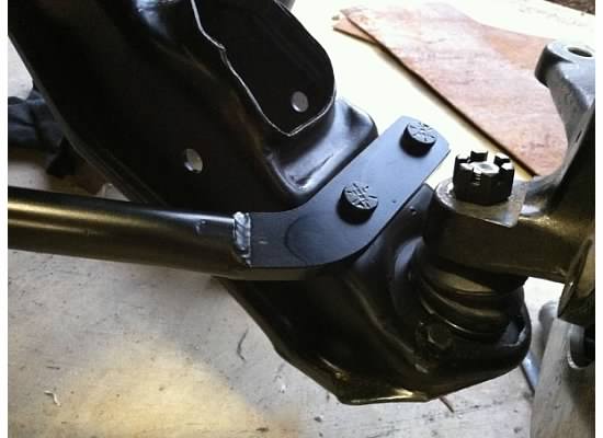

    Here are the photos. I know that I would need to tighten the bottom two bolts at the A-arm. Just don't know if I am supposed to "pull" the strut to make it work.
  5. gimpyshotrods
    Joined: May 20, 2009
    Posts: 24,376
    gimpyshotrods
    Lift the lower control arm up with the jack until the strut rod and the control arm are parallel, then tighten them up. You are below full droop in this picture.

    I know that, but it still didn't seem to align. I think its the MII vs Pinto condition.

    If they still don't reach after that, and the frame brackets for the strut rods are in the correct location, and orientation, then the strut rods are likely the wrong ones. Any chance that the strut rod brackets are turned around and switched side-for-side?

    do some google searches. I think the Pinto has less of an angle than the Mustang II struts. The Chassis Engineering catalog specifies this is a Pinto suspension mounting.
    I am sure you can heat and bend them to make them fit correctly.

    Thanks for all the info. I called Chassis engineering this morning and figured out the issue. CE requires PINTO struts, not MII struts. The pintos are 44deg vs the 52deg of the MII. Looks like I will be getting out the torch to fix them.

    Should I heat and bend that 1/4" plate or would it be ok to slice/bend/weld it back together? Seems like it would take TON of heat to make it work.

    I believe I would heat & bend them, don't cut & weld those unless you are a very experienced fabricator with knowledge of heat treatment. You will be surprised once you get them good and red hot how easily they bend that six degrees. Let them cool slowly at room temperature.

    Go ahead and heat it. Been done for years and as was said before, a little goes a long way.
