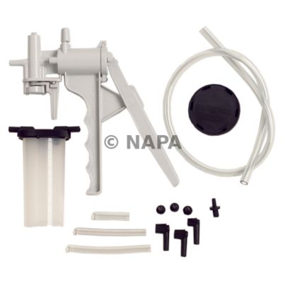

    Thanks, do you think something like this would work?
    http://www.napaonline.com/Catalog/C...l-Hydraulic-Systems/_/R-BK_7001008_0361146609

    I forgot to ask, if there is some air in the master cylinder should I try a vacuum pump tool instead? It's possible there is some stubborn air in the M/C, im not sure. I had installed it without bench bleeding even though I went through many bleeding cycles with the rest of the system. My guess is I got most of the air out of it but I can't rule that out.
