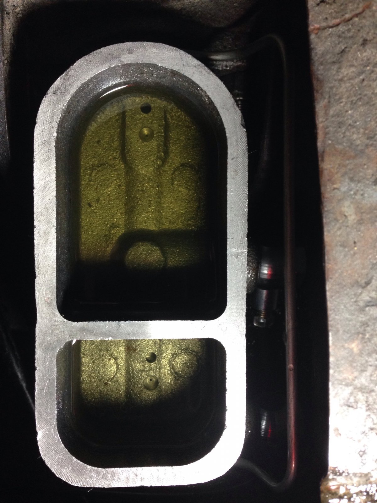

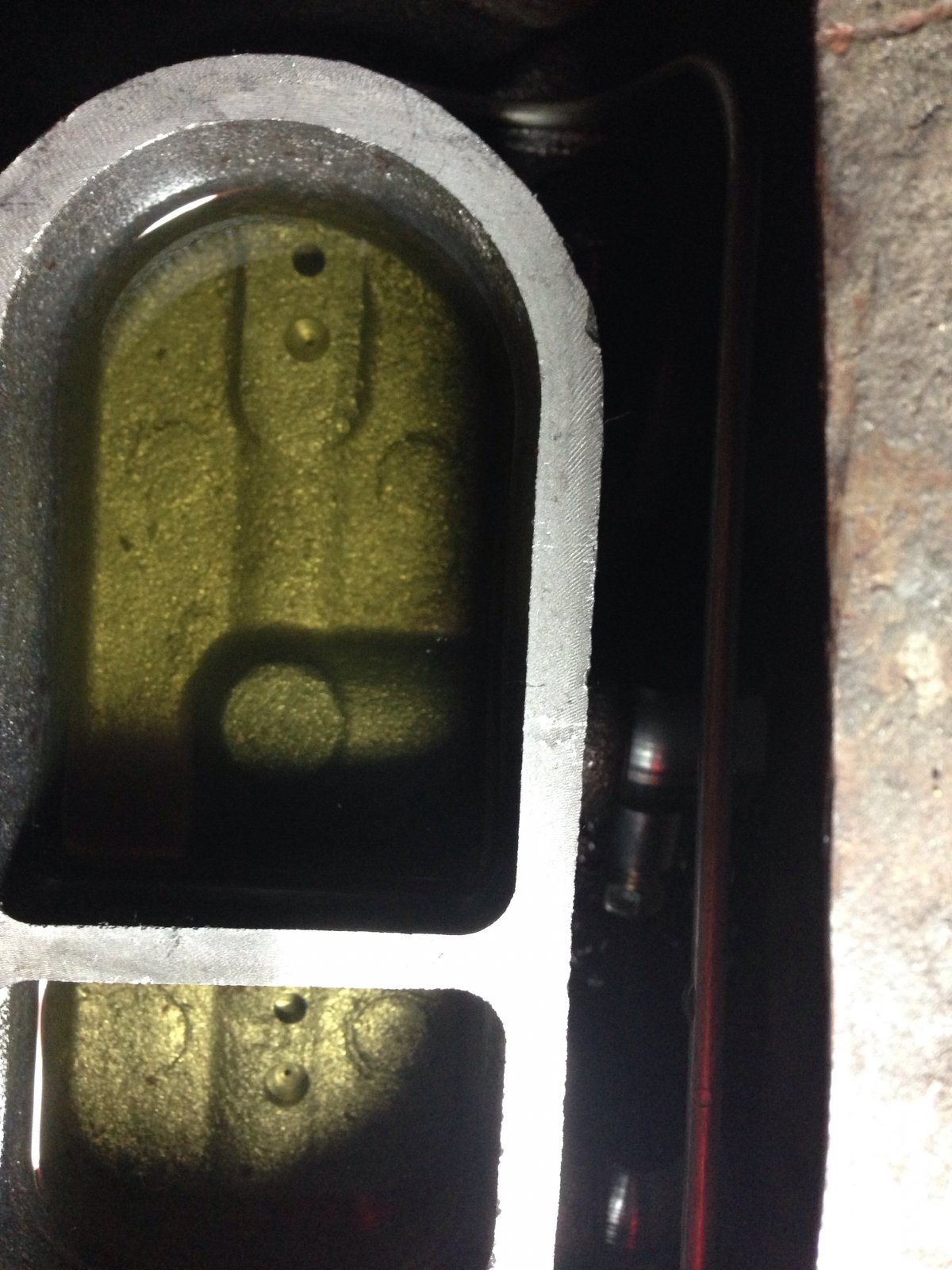

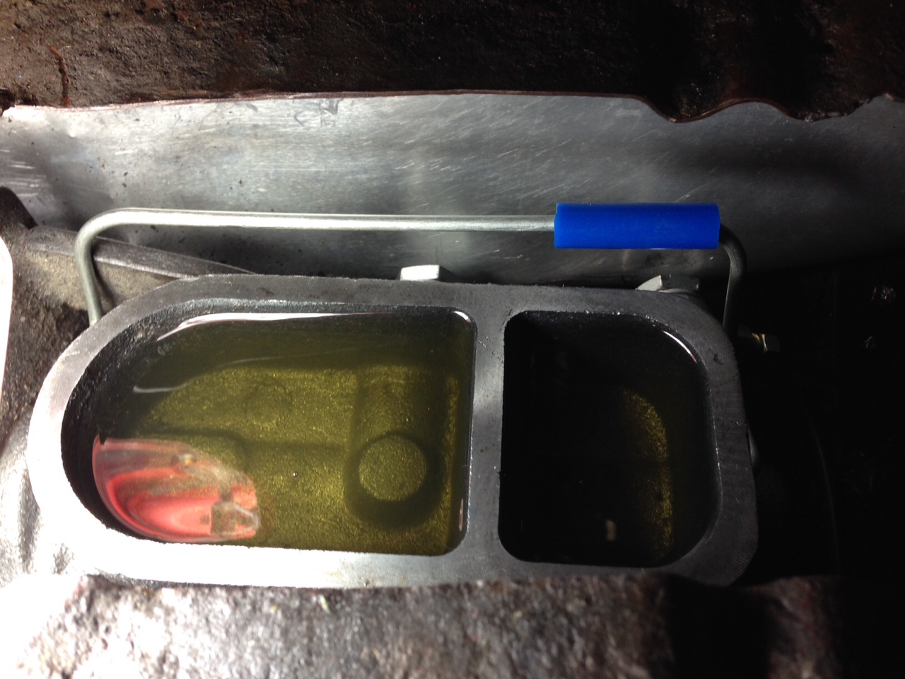

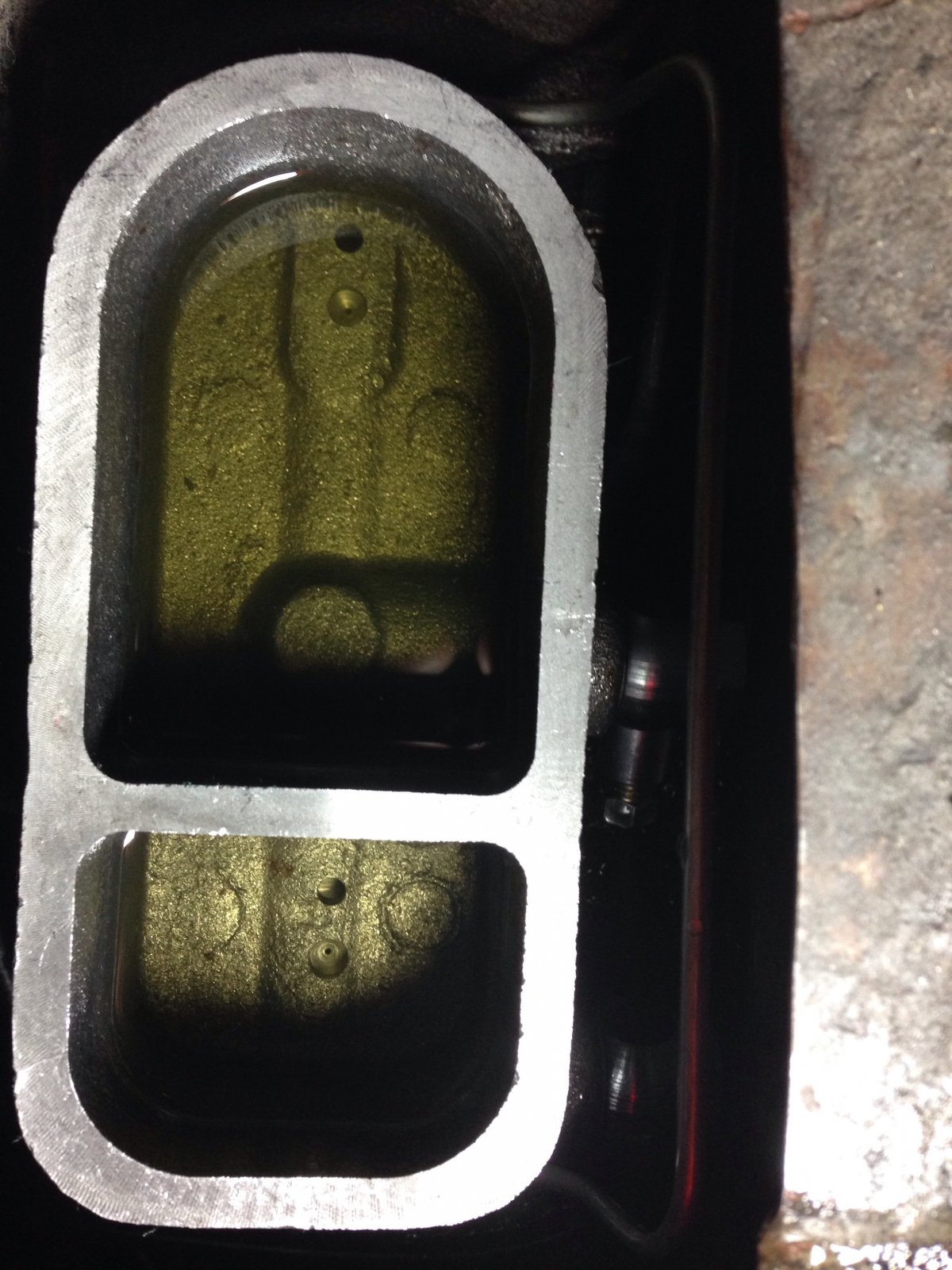

    Not sure if these photos are helpful? I can't remember what pedal position I was at in those ones.
  3. All master cylinders squirt out the ports in the reservoir, theres nothing you can do about it short of running a master cylinder with a remote reservoir. As the fluid starts to pressurize it's going to the path of least resistance, which is the ports above the cylinder, until the piston cups pass by and block them off. You can't block them off permanently because then the fluid wouldn't be able to drop as the brakes wear over time. Since you're having such difficulty I would consider taking the car in to a pro, especially when dealing with brakes, it's a matter of life and death.

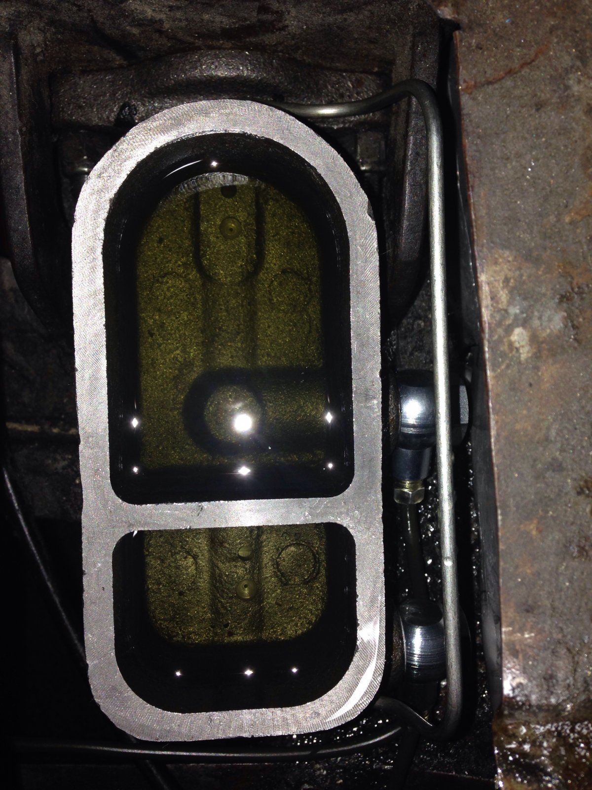

  7. 53CHKustom
    Joined: Jun 24, 2014
    Posts: 1,433
    53CHKustom
    The previous photos might be deceiving since the car is not perfectly level since my rear jackstands are a tad bit lower than the fronts. This makes the fluid look lower than it is from reflections. The fluid was at 3/4. I now filled to the top given the inclination of the vehicle. Below is a photo.
    The squirt is still there!
  8. rfraze
    Joined: May 23, 2012
    Posts: 2,009
    rfraze
    It will always be there. It just won't shoot up like a geyser. Let's see a video of it now.
