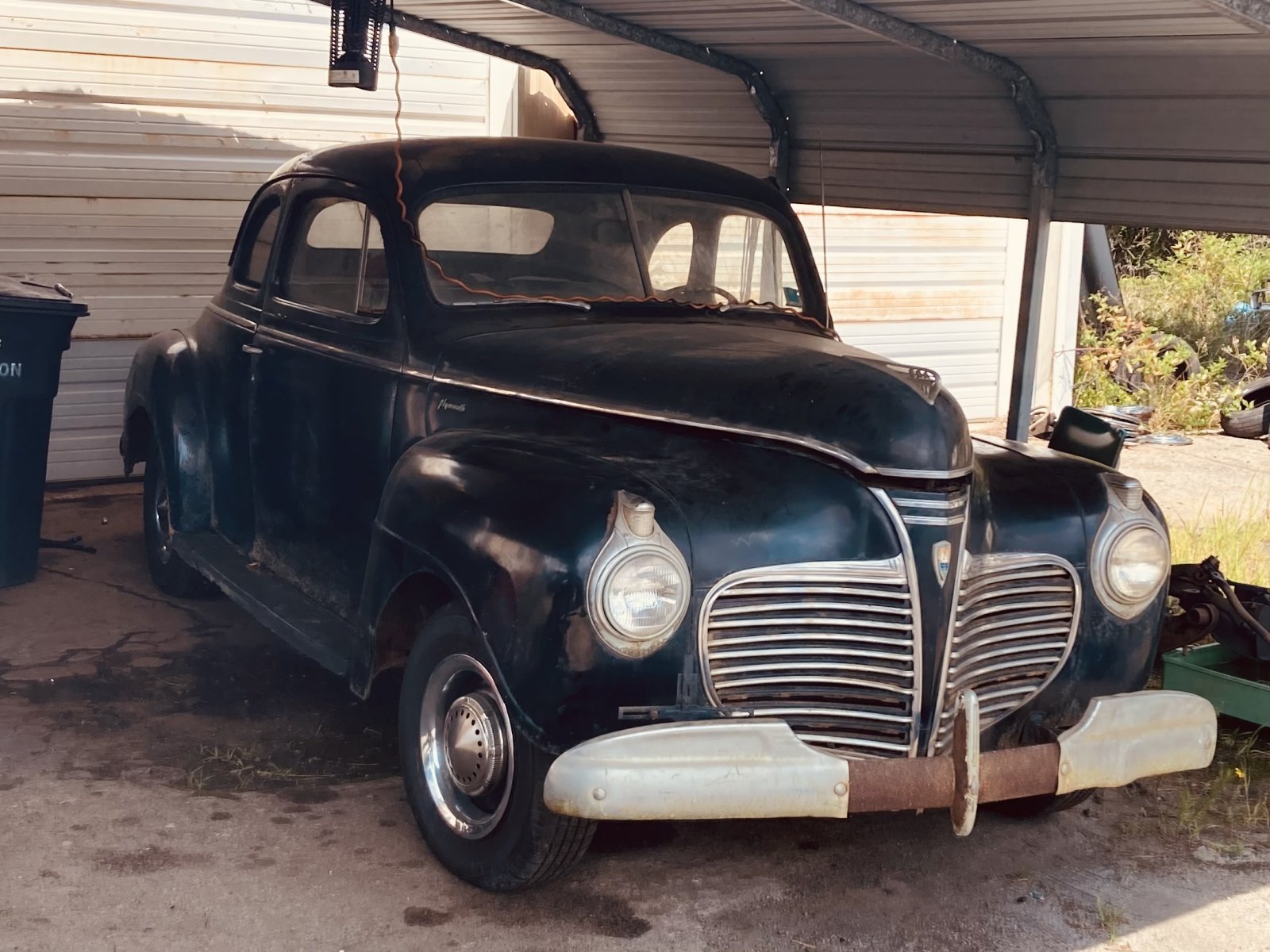

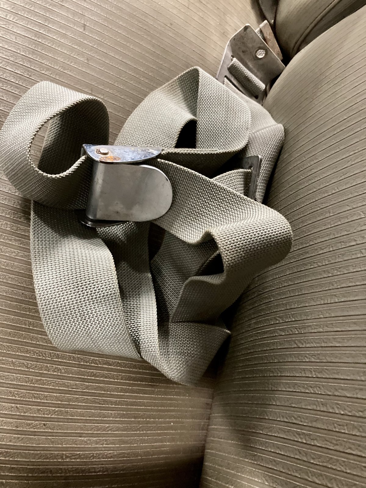

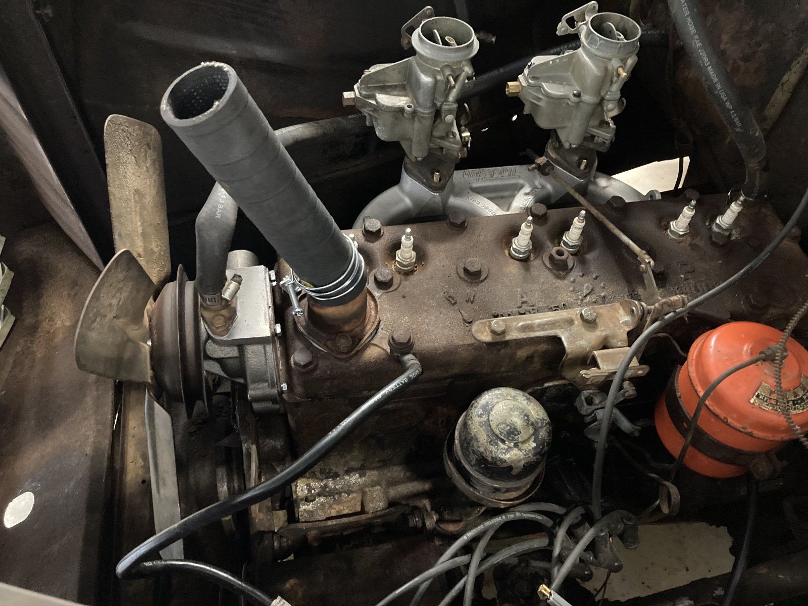

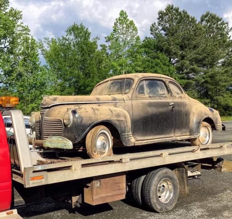

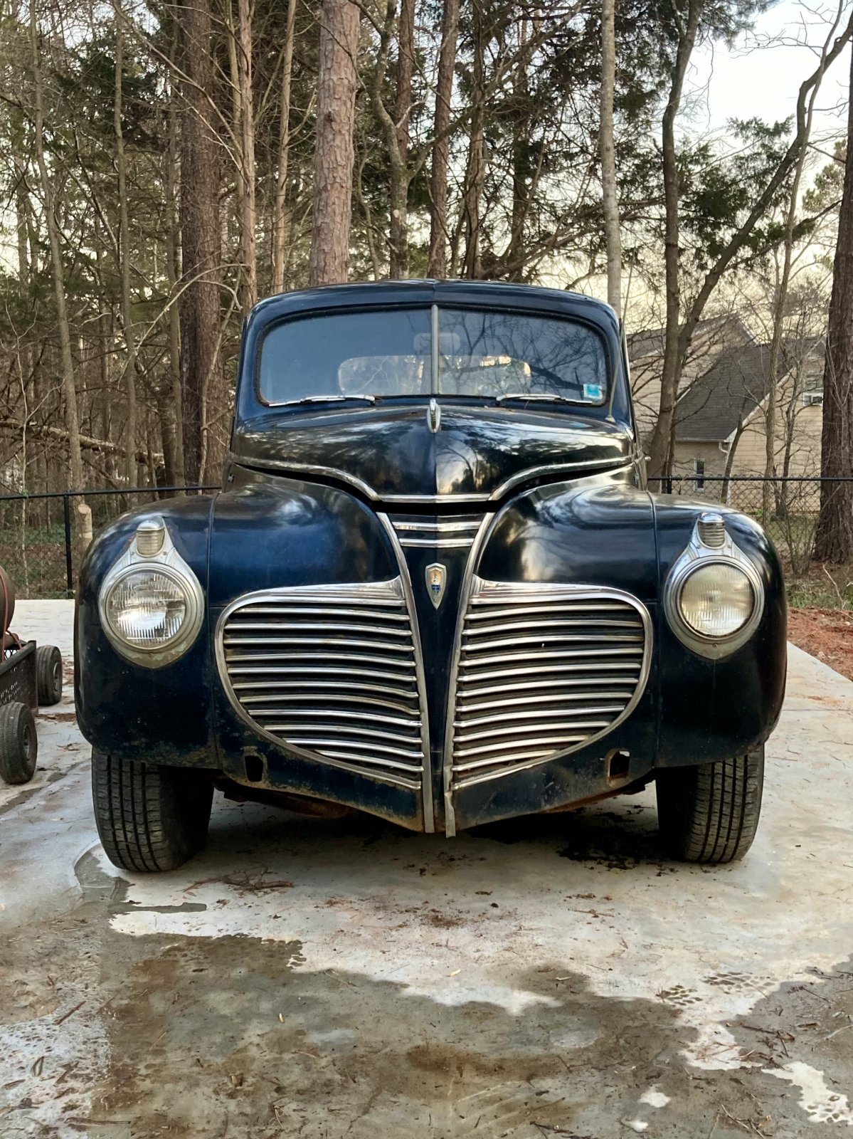

    Picked this thing up about a year ago from the guy who bought it out of a barn at an estate auction. I’ve been on and off hunting a pre-war Mopar for a few years now when this one fell in my lap.
    The car had been parked since 1970. Doing a little auto archeology and I found that the original engine had been replaced with a 218 in 1951 with a genuine Mopar crate motor. The tag is still on the block. The car was repainted once before in its life it’s original black color. The dash has a radio from a later ‘47-‘48 radio, I think. A Chevrolet heater hangs below the dashboard on the p***enger side. The seat and door panels had been recovered in what was originally a silver color vinyl. The front rubber mat, which was junk unfortunately, was from a ‘46+ Plymouth as well. The original 16” wheels and hubcaps were long gone, having been replaced with some later 15” wheels and full wheel covers.
    The guy that rescued it did little more than throw some tires on it and get it running halfway off of a lawnmower gas tank. All that was needed was new plugs and a fuel pump, however it wasn’t running well.

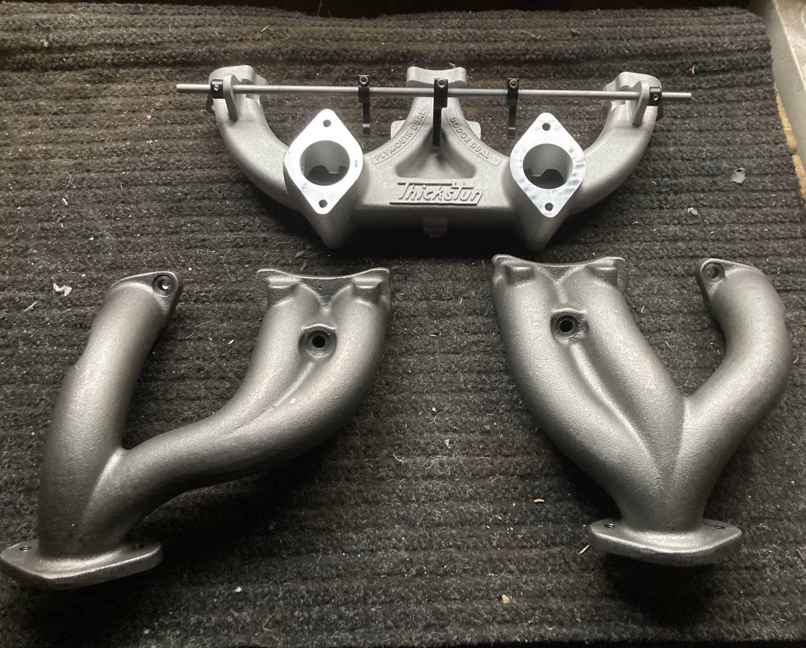

    I’ve done little work to it since acquiring it, as I’ve had other projects in the way. So far I’ve swapped in a Langdon 12v distributor setup, finned Thickstun valve covers, and a Thickstun intake with two matching ‘41 spec Carter Ball&Ball carbs. I’ve also replaced the water pump, and checked out the water distribution tube in the block, it was like new. I have spent a lot of time s****ing the dirt caked under the hood and suspension off of it, but definitely have more to go.
    Move also been collecting parts for it as well, which has been a lot of fun.
    Longterm, I want to keep it a fairly period correct car. I’m not wanting it to look like a car that somebody with money built, but rather a car that a high school kid may have put together back in the 1950s.
    Anyway, here are some pics… 98882768-043B-4CBE-930D-726FDF259722.jpeg 9E8EEEAF-A649-4945-AC5B-07A1A086BB58.jpeg 397E72FF-AF11-4AC6-B566-4CBBF57EAD49.jpeg 706DF176-B613-4895-AD31-FB4B3F24A3A6.jpeg 14C1C20A-CA79-4956-947A-6FC91545A0B5.jpeg 134EC104-E618-442D-B213-090922AA66F7.jpeg 835D56B4-912B-4381-88EB-C33BEF1180E7.jpeg 631ABF1D-9DBC-408E-B67B-617B025EF909.jpeg FBBD1FBD-A779-48FC-B8E7-376B7AAAA70A.jpeg D5B87B59-2F2D-4E15-AA3A-DE95946CC35F.jpeg ACB696CD-303C-4D7D-9A0D-3CF20137B9A5.jpeg 10BAA2E9-AD57-480C-A865-D2955F86D58A.jpeg 382B27DC-67AB-4CB8-87E2-5AF0814B1749.jpeg 4EC2CB8B-3CF0-4DFF-91BF-04CD2016DF69.jpeg 59C08BDF-E6D2-40FD-A62F-8F6902D301A2.jpeg 27E2A7E5-A7E2-417F-B3AB-DF45D8804C03.jpeg 510C53F2-83EE-4A8F-8B70-F8AFEB1B3FA9.jpeg C37CF1EF-11D4-42EB-AACD-972E290B99E9.jpeg 8658E560-421F-4934-A4ED-21F5FC923CED.jpeg 5864DD4C-9DEA-4E8D-857E-78A90D8DFE99.jpeg 76C85FC9-AB93-400E-9DE7-7B1D8A2281BC.jpeg 42672307-7127-4506-982C-BB1703B0212E.jpeg 41D1B480-EAD4-4EAC-BD3A-F93B6E2B635C.jpeg 345D165D-5AE5-4FEB-92F4-915B5D91EBE7.jpeg 7764BF13-E249-40EF-BA3C-DE78FB2689C6.jpeg 8DC2A5B1-F9DE-45CE-8315-EC7A46DDB938.jpeg 266C677B-C287-4DF8-B8B0-037F73D892BC.jpeg 065AAAAE-8B21-4D92-AF54-88940D307148.jpeg

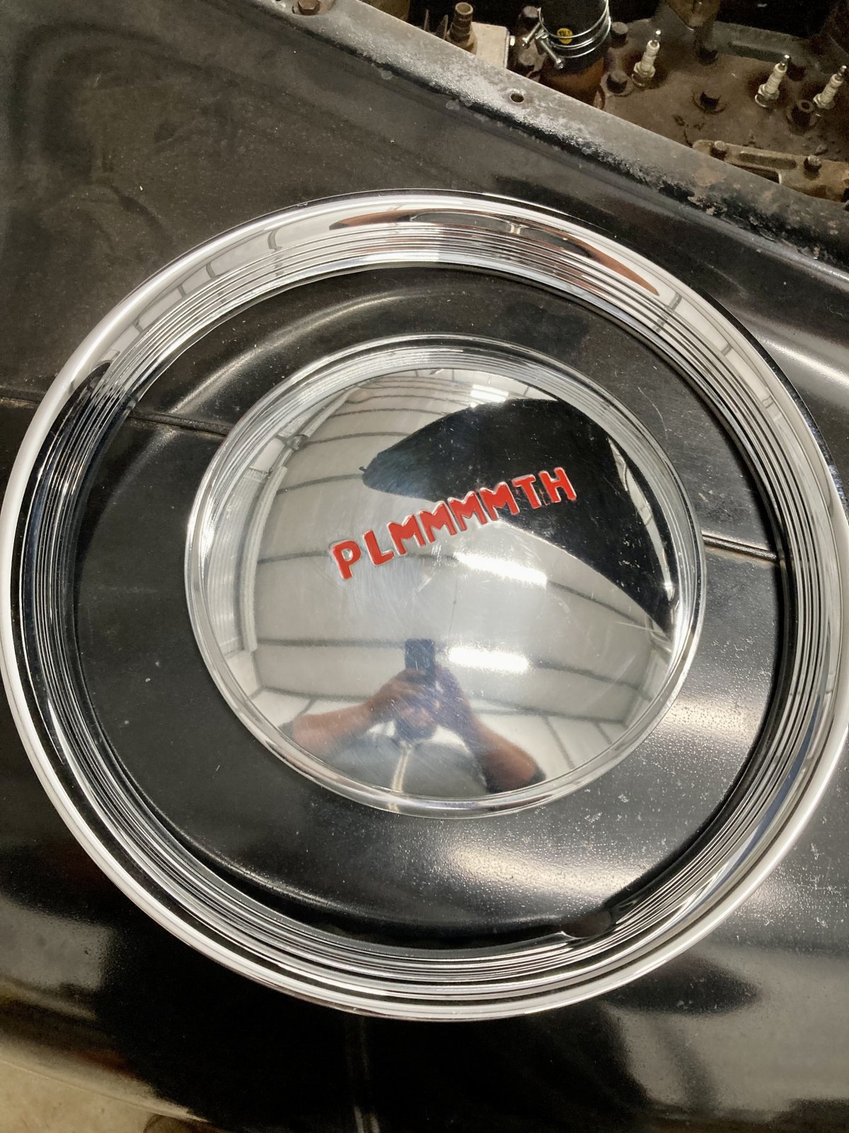

    And that Plmmmth hubcap would make a far out air cleaner lid!!

    So I have not gotten it running since the dual carb swap. It needs a fuel tank and I’m re-wiring the entire car.

    As far as the PLMMMMTH cap goes, I actually have a full set as well as the oem 16” ribbed trim rings and a set of 15” ribbed trim rings.

    That is a great score, that car is pretty sharp. I really like the
    THICKSTUN intake and exhaust manifolds and finned side valve covers!

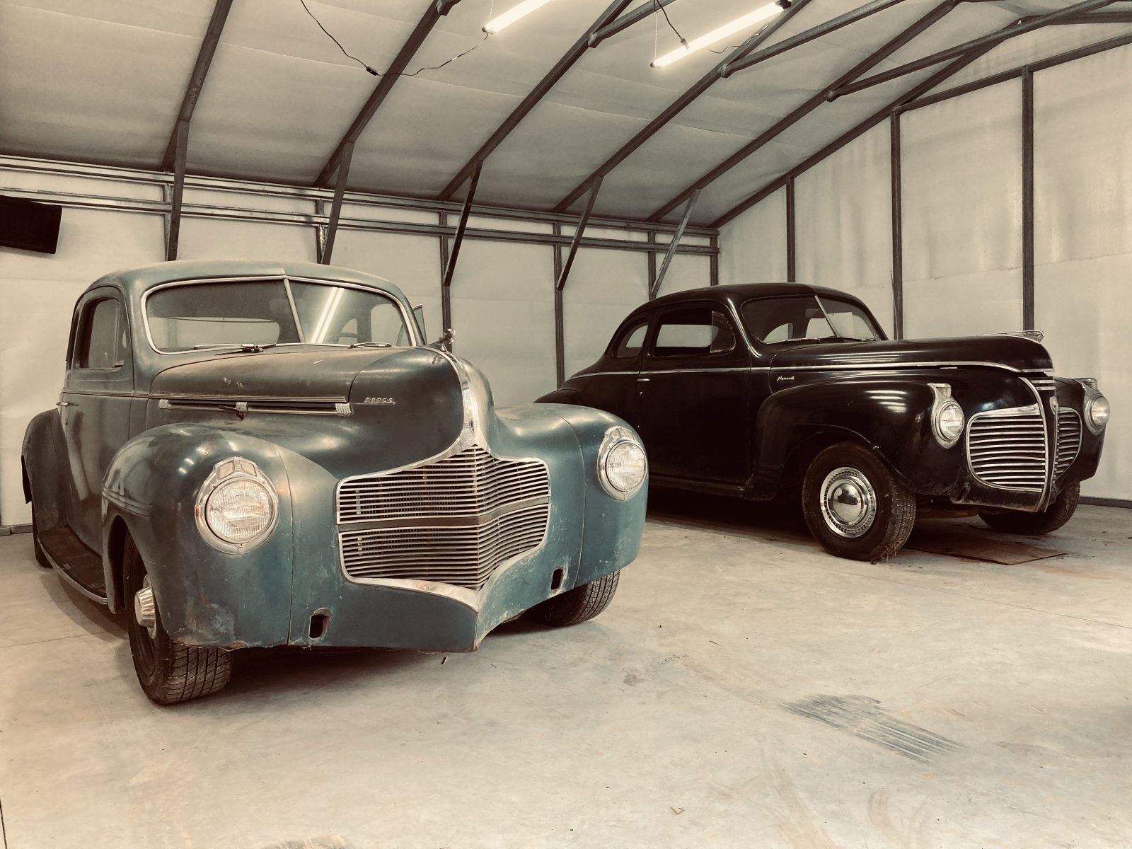

    The ‘40 Dodge is a good friend of mines. I tried to buy it for years, but he won’t sell it.
    it’s currently in the process of getting a 383/727 /8.75 conversion. I’m also re-wiring the car for him.

  22. ive never heard of a manufacturer misspelling their name on a hubcap before, id love to hear the story on these hubcaps.
  23. Tim
    Joined: Mar 2, 2001
    Posts: 20,281
    Tim
    from KCMO
    @The_Cat_Of_Ages “misspelt “ hub caps of all brands are aftermarket caps skirting copyright/trade mark lawyers.
    my favorite are the early ford caps that actually read fool
  24. thats amazing, so there have always been knock off wheel covers/hubcaps, i kinda want the misspelled ones for the novelty of it alone.
  25. BJR
    Joined: Mar 11, 2005
    Posts: 11,290
    BJR
    Yea repo caps have been made since the 30's and maybe earlier. Sometimes the name is misspelt or if no name on the cap, the logo will be different, but at a glance looks correct.

    I’ve been hunting a nice set of PLMMMMTH caps for years, finally found this set last year.

    I love the "PLMMMTH" hubcaps so much. I have also heard of "Food" caps.
