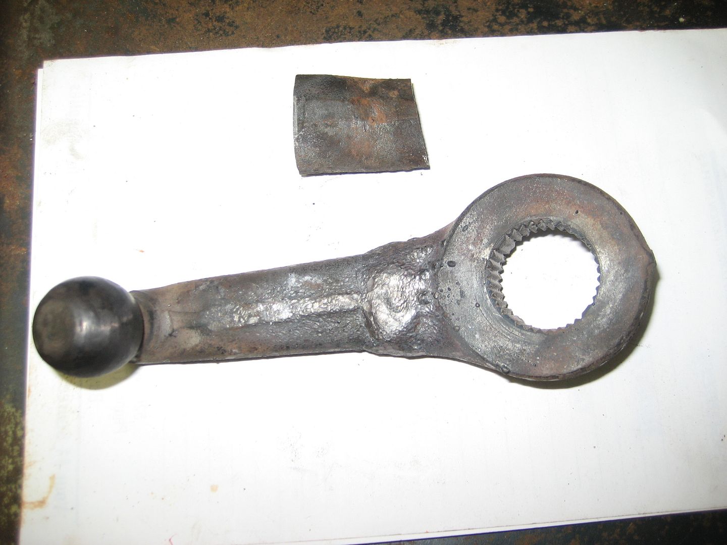

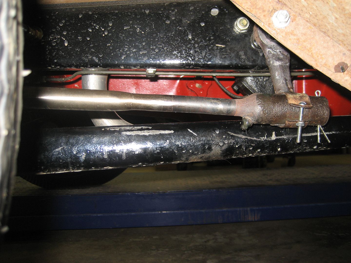

  19. I finally took the time to check out the steering problems I am having. The truck darts all over the place. It turns out it was a simple fix. The steering arm I installed has deep holes drilled and tapped in it and it bolts on through the top two holes in the spindles. I originally measured the hole depth and used a 1/2-20 x 1 1/2" long bolt. It turns out the holes are not tapped to the bottom and the steering arm was not tight to the spindle and was just slightly loose causing the truck to wander. All I did was run a bottom tap in the holes. Now it is 50% better. Next I am going to fix the drag link's funky angle.

  22. Here are the pictures of the correct steering. It drives so much better now. I eliminated the bump steer.
    BEFORE
    AFTER

    Joined: Nov 11, 2005
    Posts: 1,274
    Rob Paul
    Great steering fix tech!!
