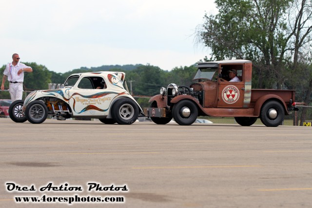

  5. Here is a pic my wife took of me pulling Falfasnightmare's Shiftmaster 55 down the return road at the 2012 Meltdown Drags. Proof that it is a work truck.
