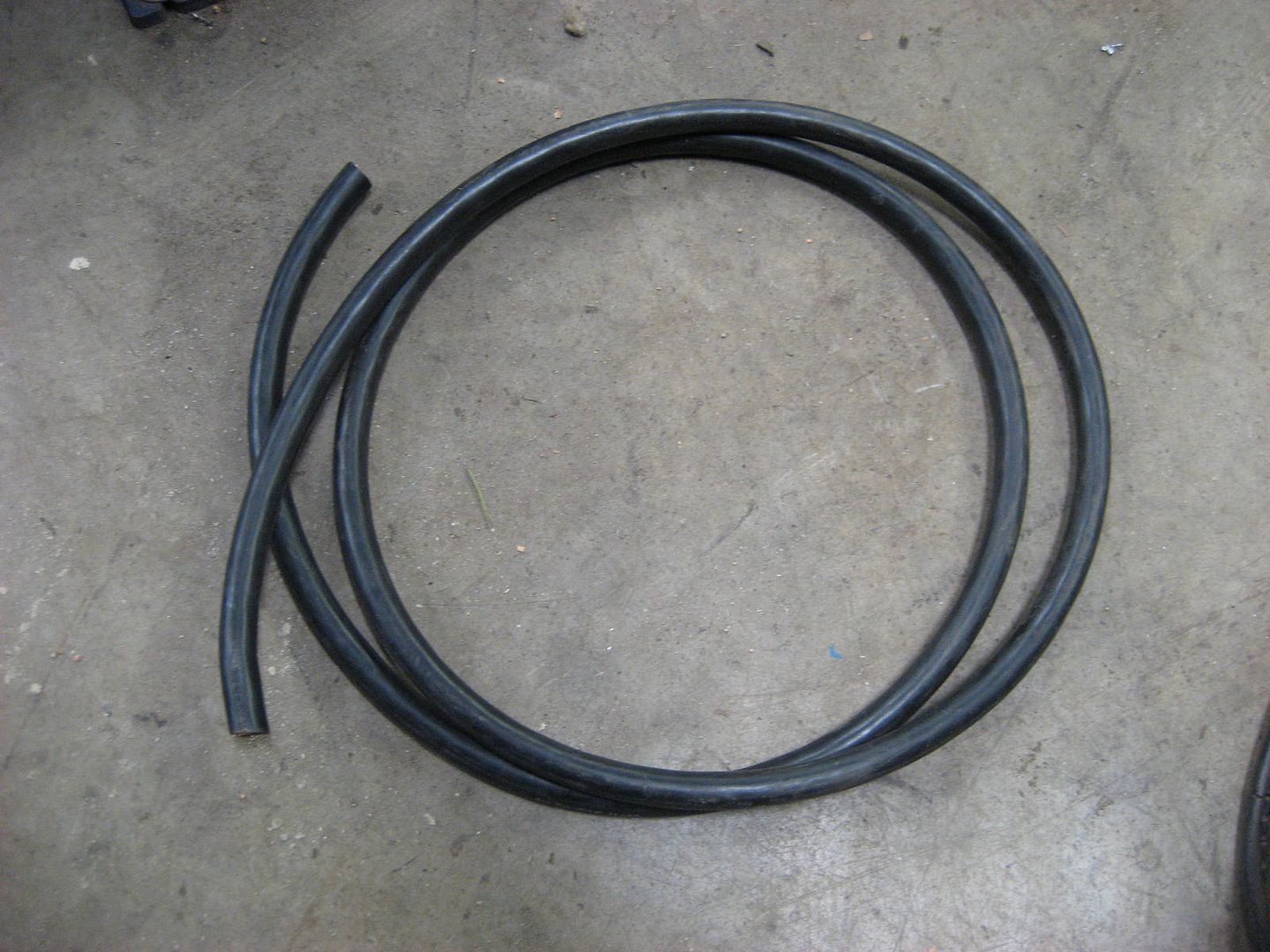

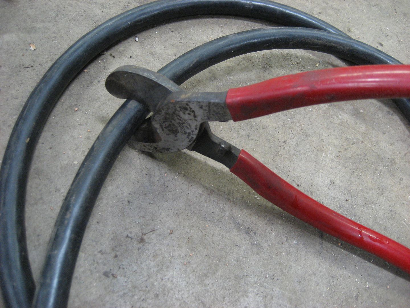

  13. Tonight I made up the battery cables. I used 2/0 wire.
    loped to size
    cut back the insulation
    slide on a piece of heat shrink, and a terminal. This one is for 5/16" stud size
    crimp
    slide up the heat shrink and heat up
    and bolt on
