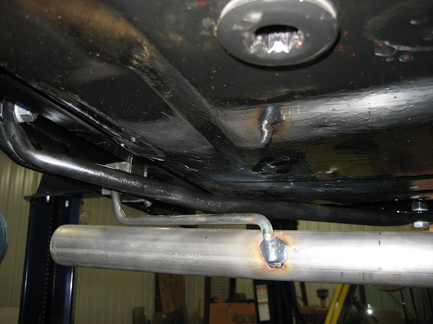

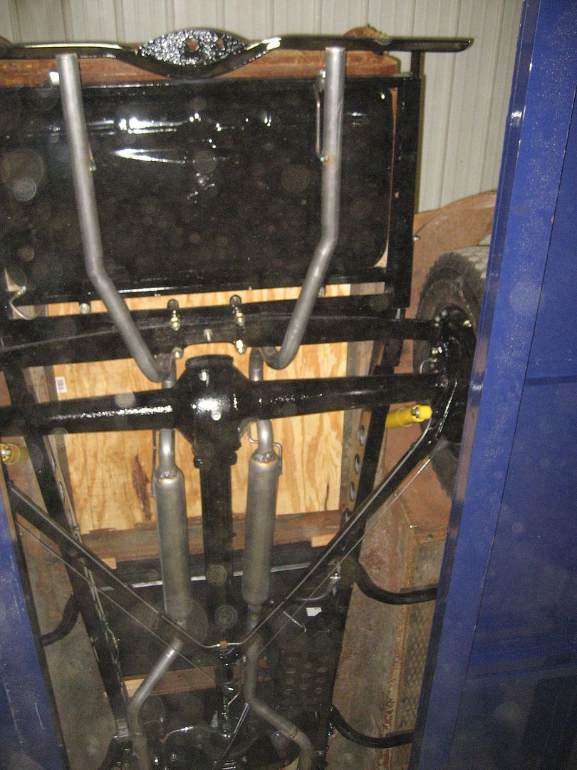

  8. Here are some underneath pictures of the chassis showing the exhaust. There really is not very much. The guys did a good job. Plus they gave me a really good deal.
    They could not find any flanges so I made a pair out of 1/4" flat stock.
    I just got done sweeping when I took these pictures. You can see the dust in the air!

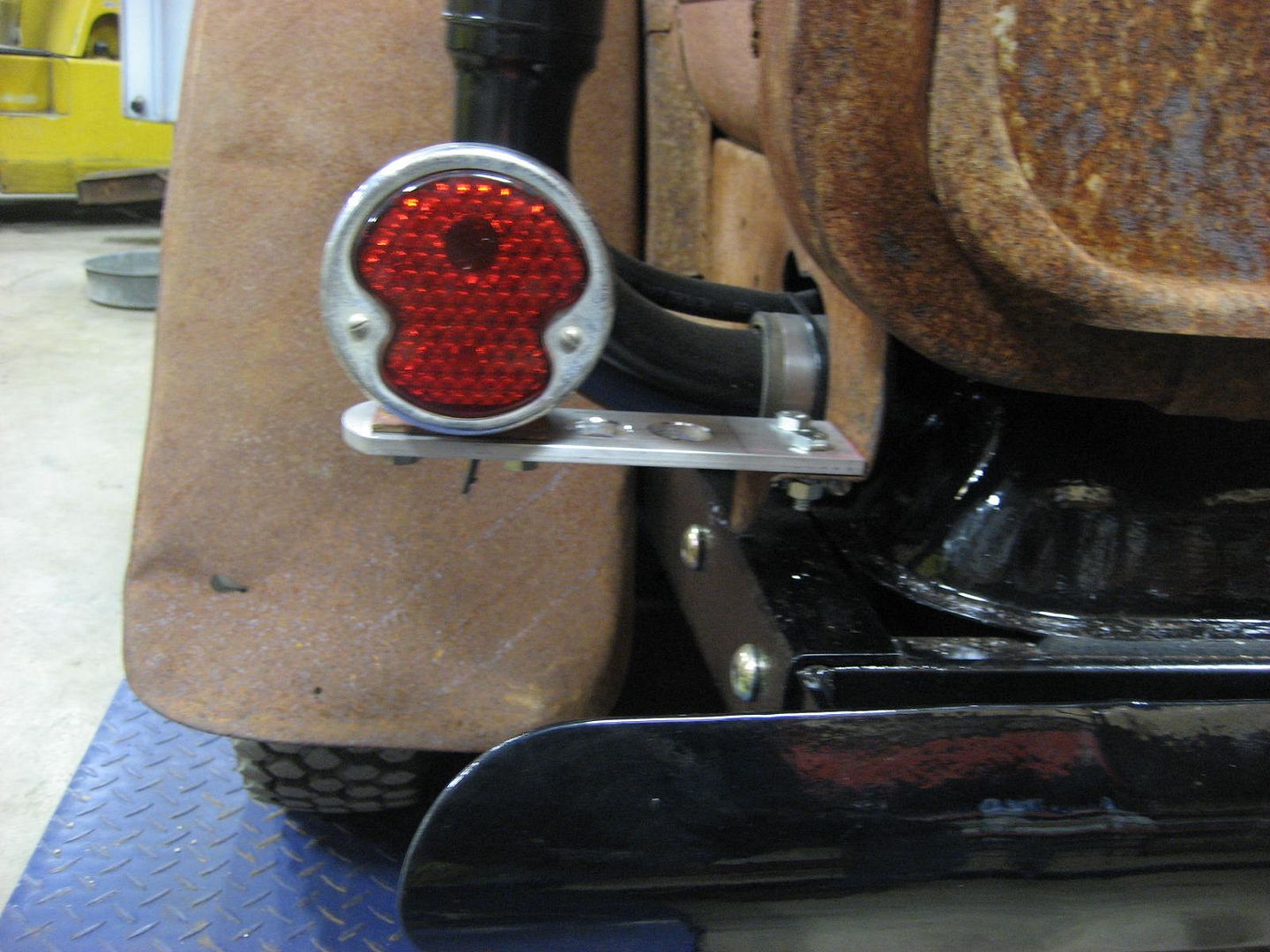

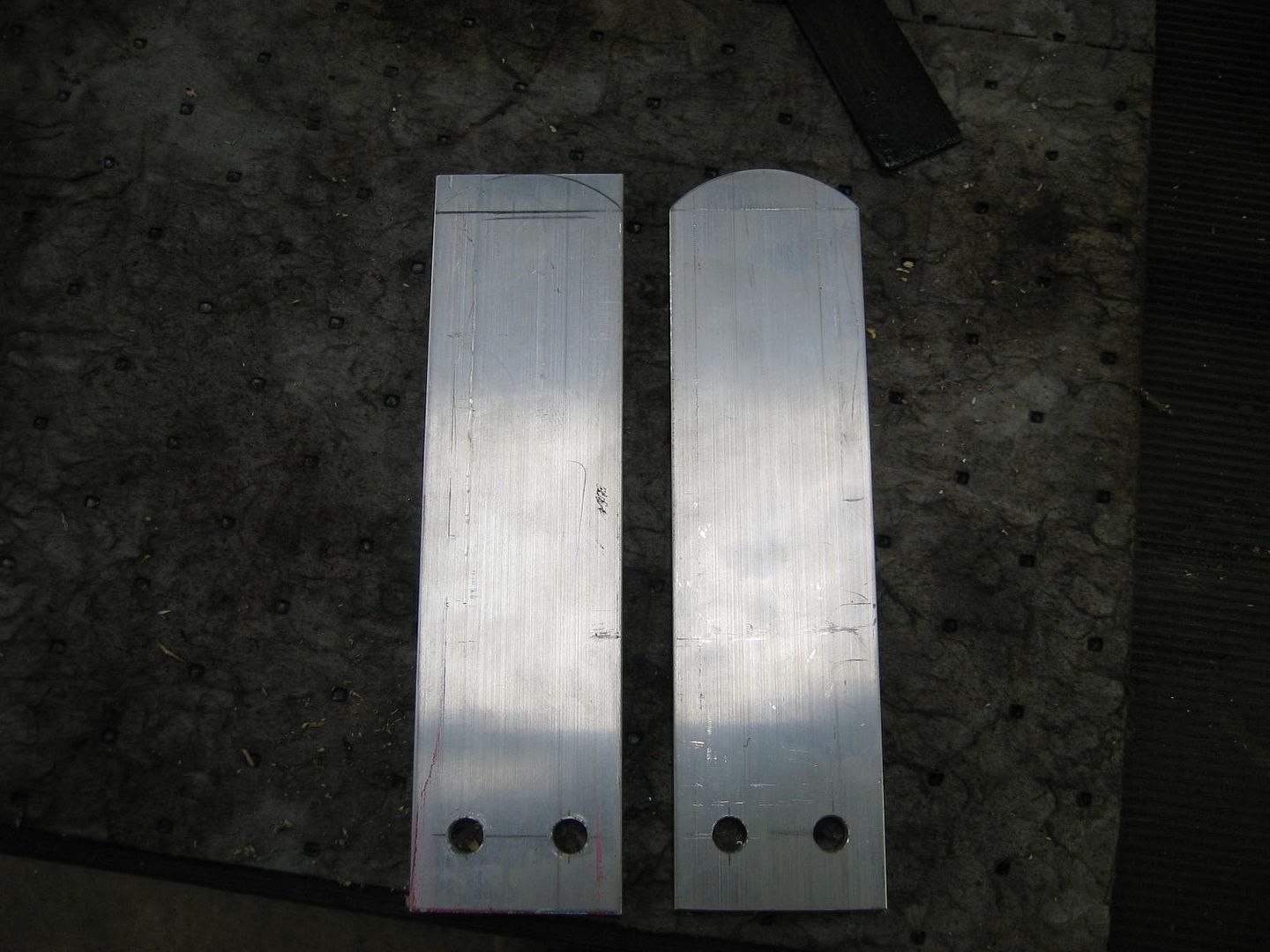

  9. I have these tail lights from my 48 Ford firetruck. I was saving them for this truck. I made some brackets but they didn't work out so I made another set out of aluminum. I am going to paint them black yet. I am not sure if I like them yet. I am going to add another 1" hole I think between the box and the first one. I think painting them black will help.

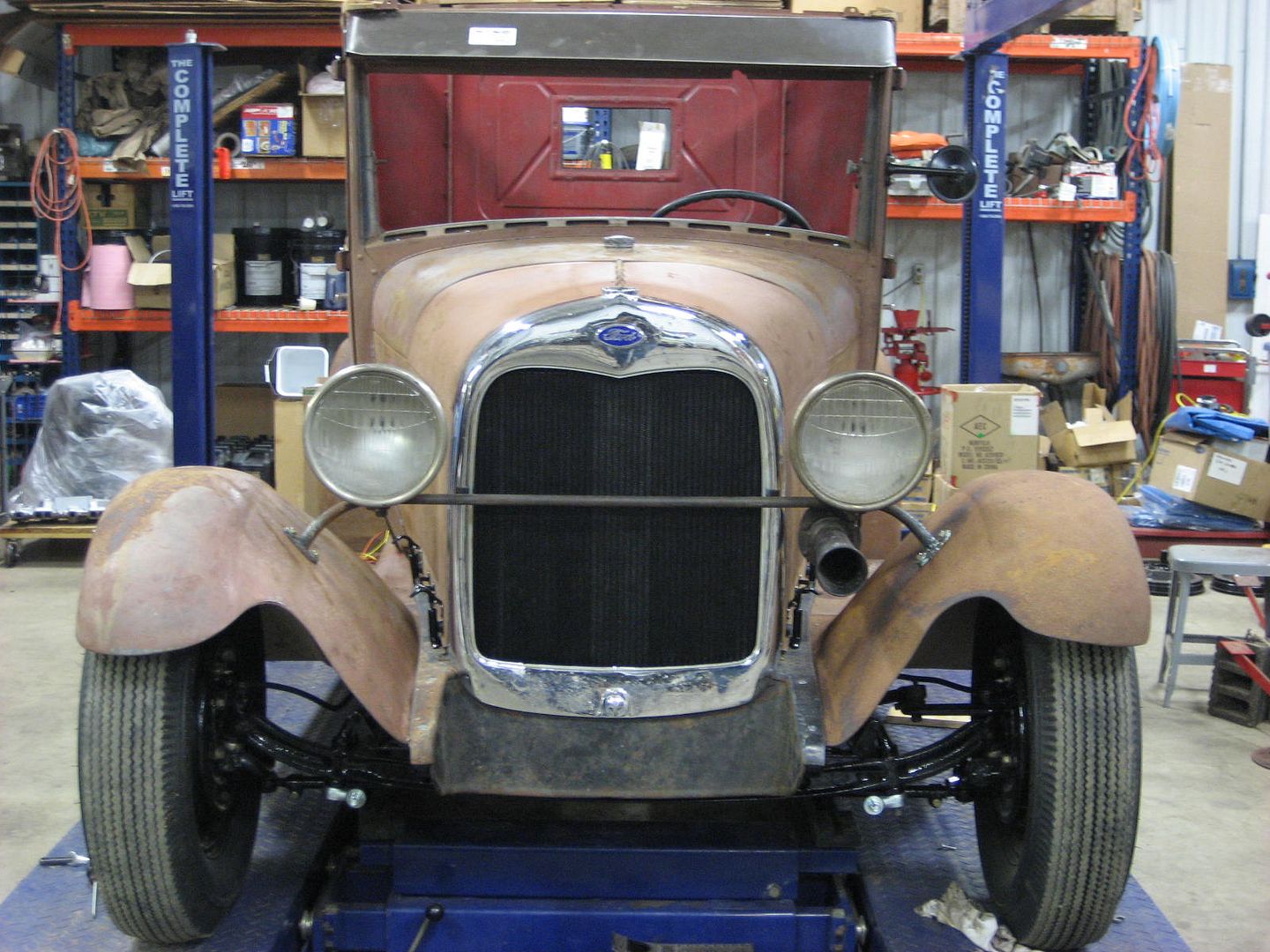

  27. On Monday night I took my dad for a ride up the road in the truck to see how it worked. I immediately noticed a steering issue. When I accelerate the truck was all over the road. The front tires rubbed on the fenders going over the slightest bump. Other than that is was a blast. It runs good and has plenty of power.
    Here is the right front before

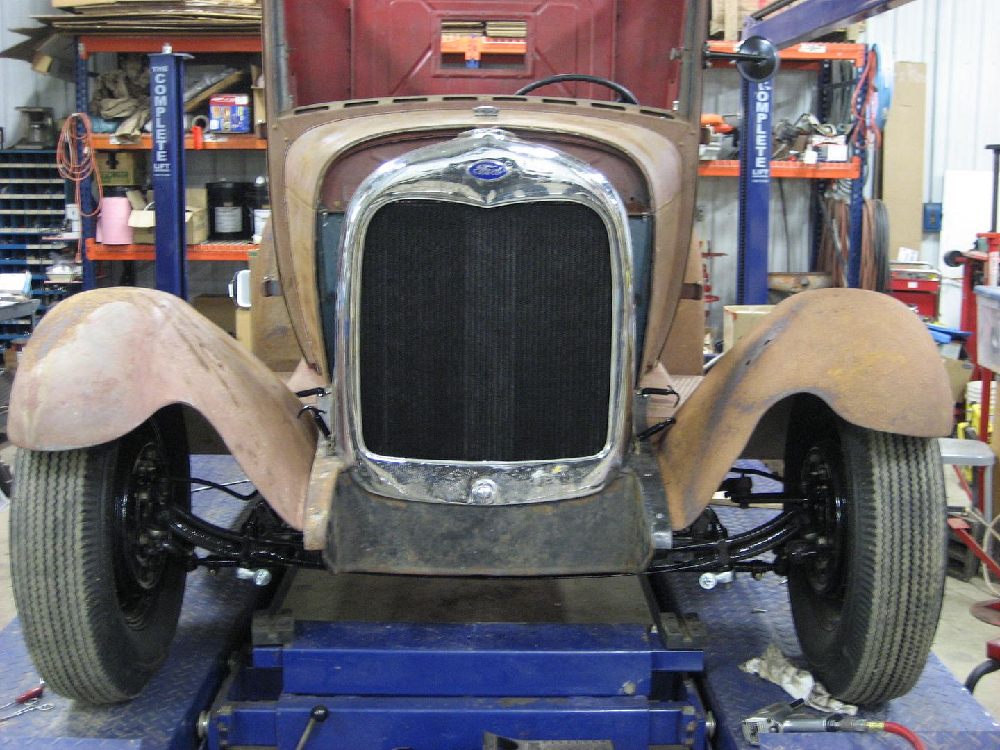

    Tonight I had a few hours so I took apart the front end. I pulled the leaf spring out and unreversed it. I removed the top small leaf spring and put it back together. I raised it about 1 1/4". I like the low looks but it is not practical.
    Here is the after picture. It did not change the appearance much.

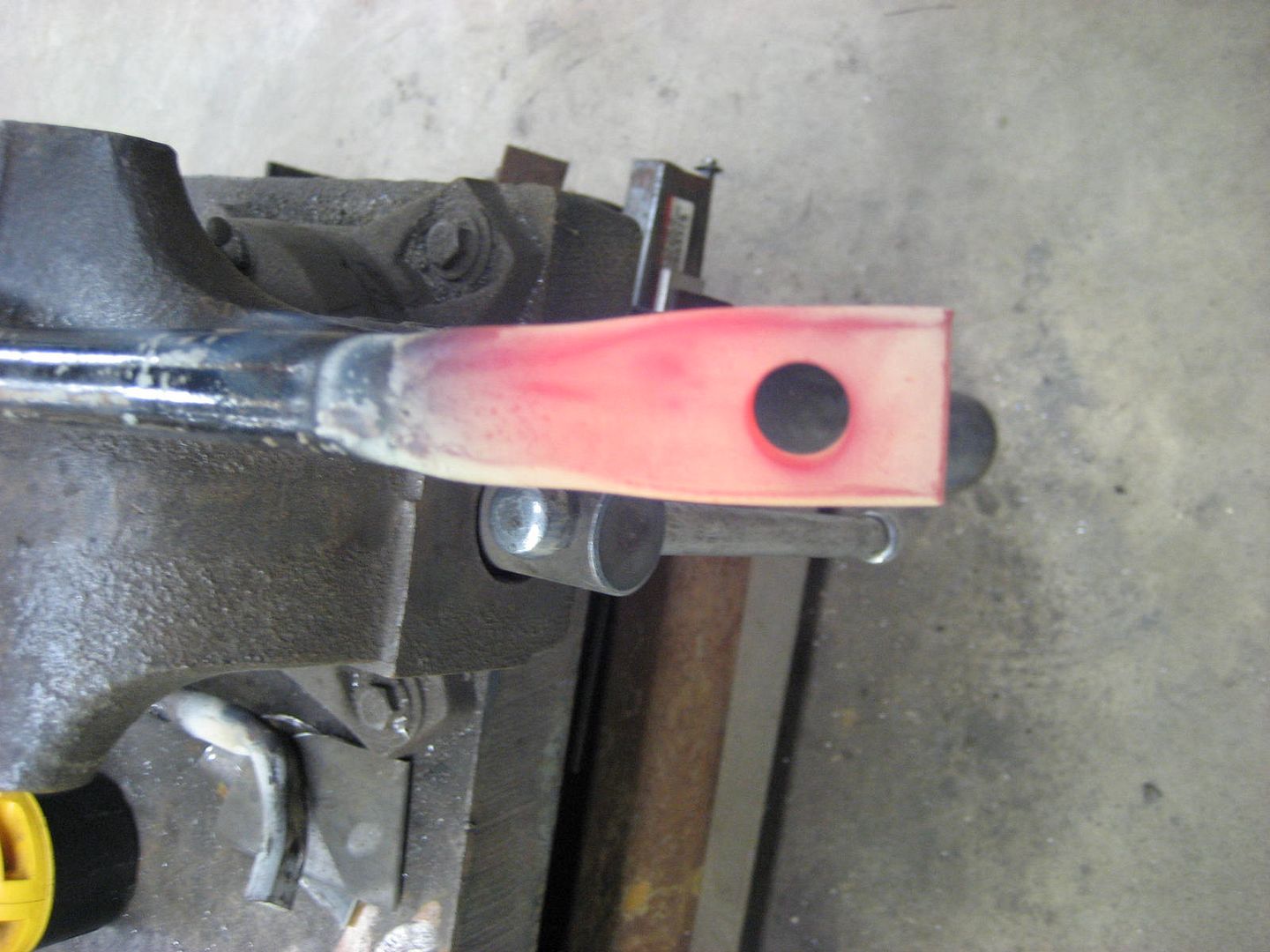

    Here is how I re-arched the spring. I learned this trick here on the Hamb.

    The solution was easy. I put a new tie rod end on and I got a new steering arm. This one is 1.25" longer and it eliminates the tire hitting the draglink and wish bone. It has no flex at all.
  29. Here is a side view from today. It is hard to tell I raised the front end 1"
