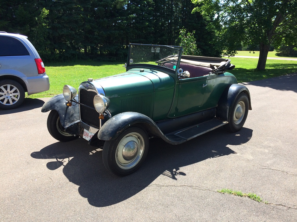

    IMG_2864.JPG IMG_2866.JPG I have had this car for 1 year already and it has been a steep learning curve. It is a build from the late 50s I think. I have it running pretty well on the 3 97s with a progressive linkage. I have been a bystander for many years on the H.A.M.B. and decided I need to step up!

    Wow, nice roadster! Do you have any more pictures of it?... it looks like it's got all the right parts and a great stance!

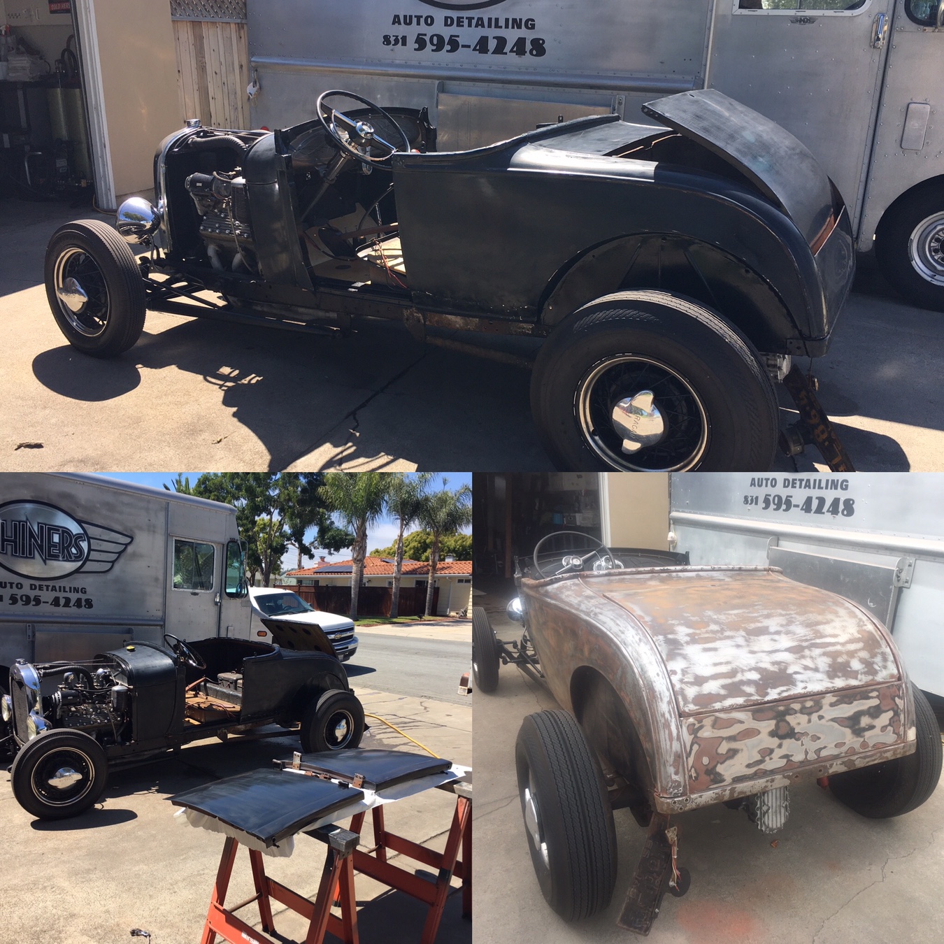

    [​IMG]Here are some pictures from working on my bushed paint job. I really wanted to try to keep what I do to the car similar to how they would have done in their garage back in the 50s

    Lots of inspiration here. I know there is a thread on here about brush painting

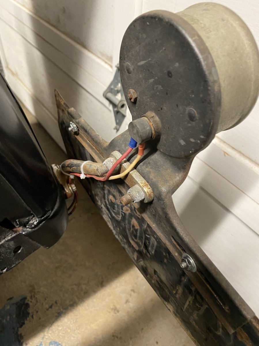

    Here is a pic of the mounting bracket. I am not sure what it is off of but someone recognized it. I can not remember what they said.

    That's how the tail light was mounted on the early 1928 bodies. Looks like the bracket has been modified (shortened) somewhat. By '29 they were mounted on the fender. No outside door handles was another '28 feature.
