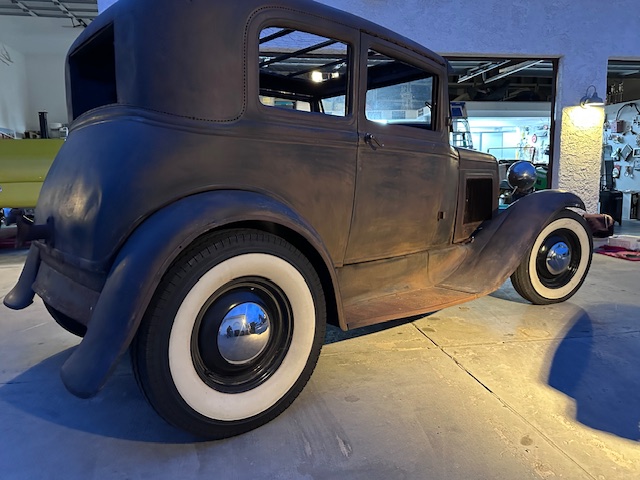

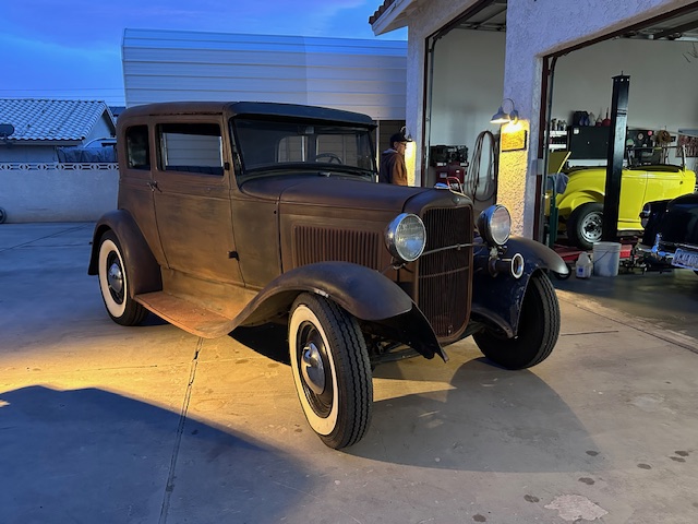

    A COUPE , OR SEDAN???

    AND , THOUGH I'VE NEVER SEEN ONE that wasn't slant, THEY ARE ALL SLANT WINDSHIELD???
    Right???

    Neither. It's a Victoria....... somewhere in between the two.;)

    how do you tell a 32 commercial grille from a 34??? and is there a differance??

    The '34 grille is almost 3" deeper (sides) than a '32 and the '34 has provisions (holes) for a stainless trim band around the bars. The grille on your Vicky is definitely a '32. Also, Early 1930 Vickys didn't have a slant windshield.

    Post some photos of the sunvisor, and how it was attached, they never left the factory with one.

    thanks for the post ,...and the head lights???? commercial also???

    That one has the slant windshield Also note that it has two rather than three door hinges.
    As for the coupe/sedan Ford listed them as the Victoria Coupe.
    Stogy and ALLDONE like this.

    I believe that commercial headlights had painted buckets and car ones were stainless steel.

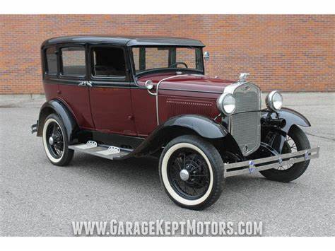

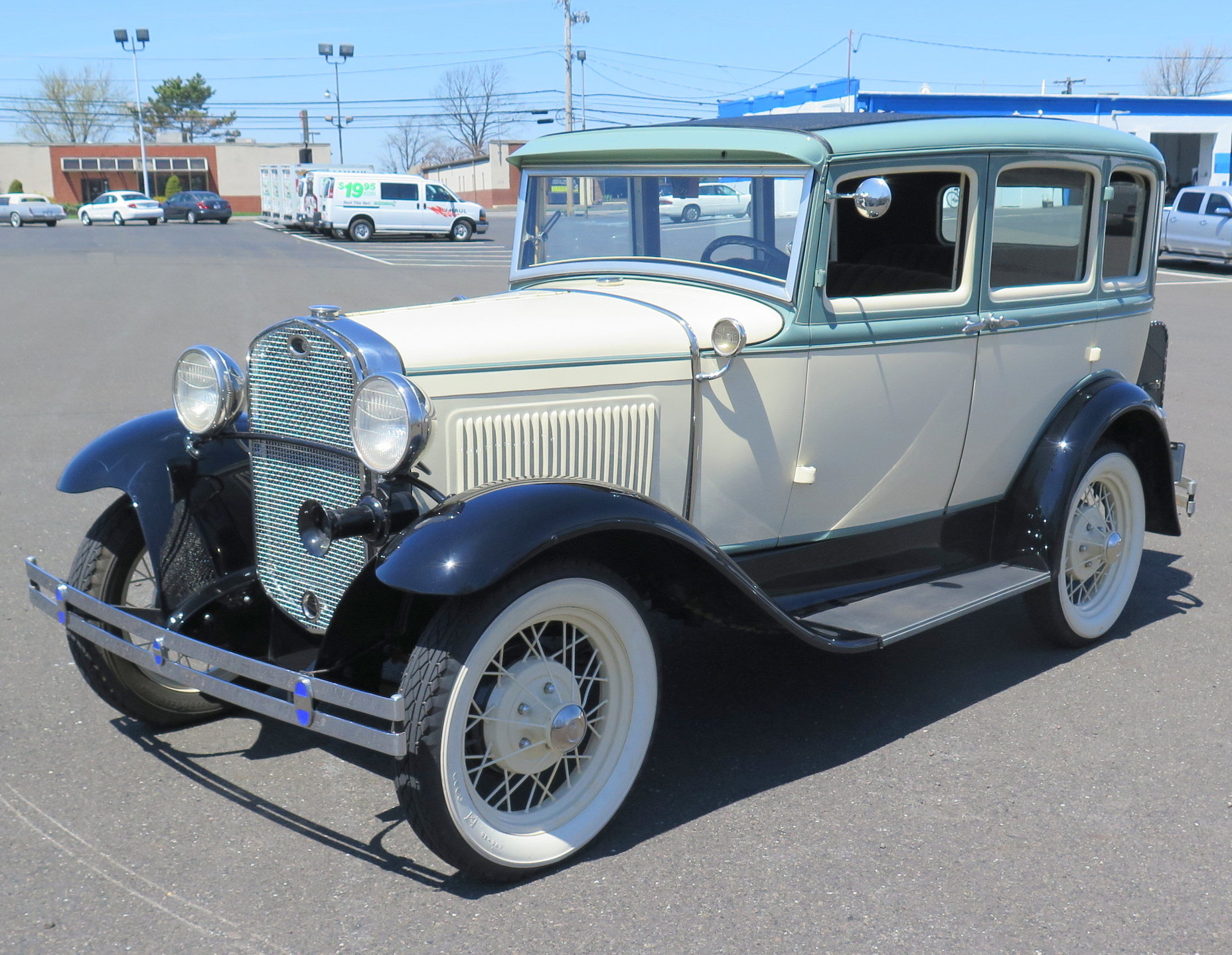

    Here's some pics of some Slantwindow sedans (same cowl as a Vicky) WITH visors. Not sure if it was a Ford factory option, or an aftermarket accessory.
    Nailhead A-V8, Stogy and Outback like this.
