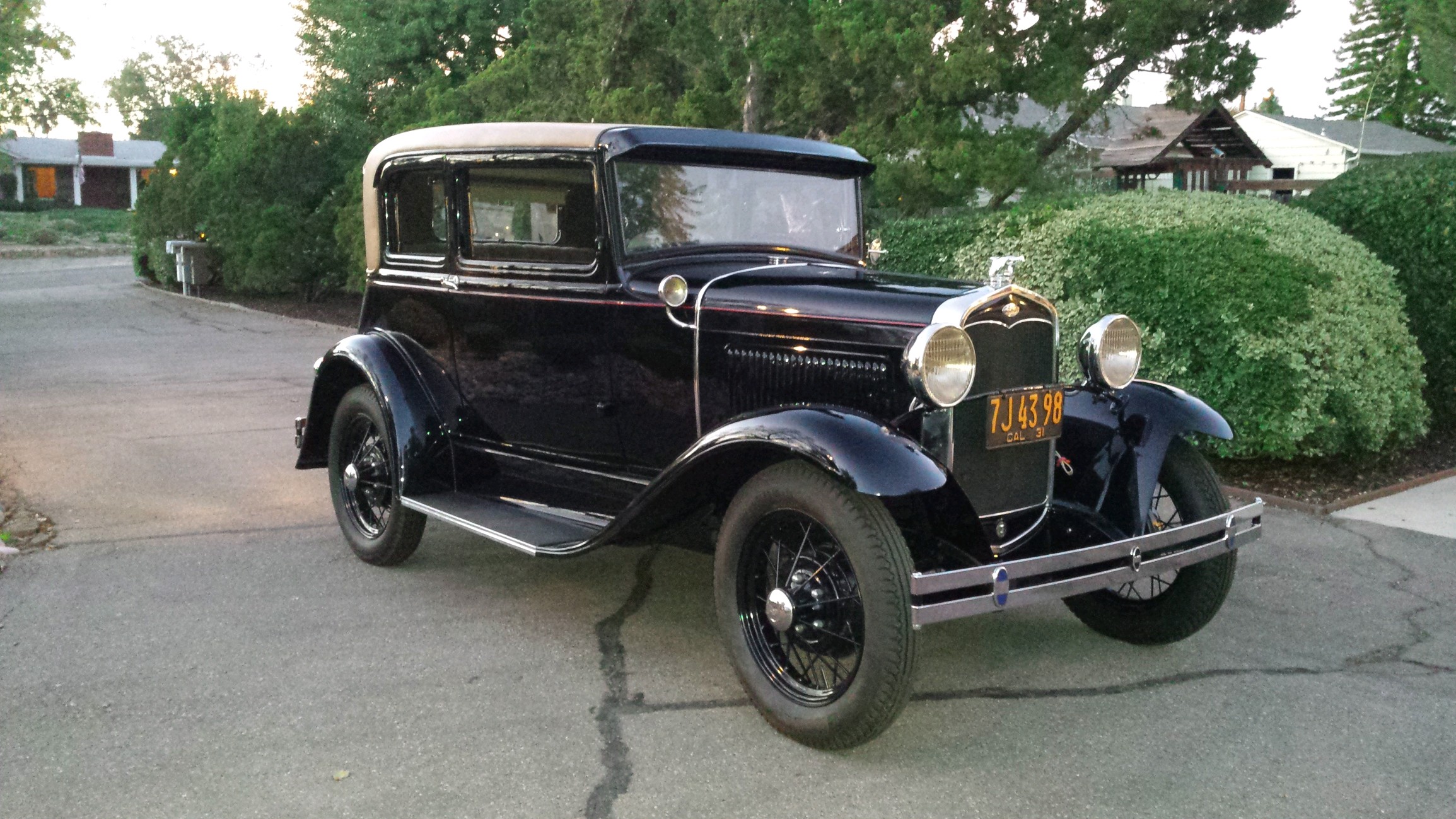

    Coupe and sedan have three door hinges, Victoria has only two.

    I don't believe this to be true. Show me a photo of a factory 1930 Victoria without slanted A-pillars and it's ***le and I'll eat my words. In fact, some would argue that there's no such thing as a 1930 Victoria, although published Ford production numbers would contradict that. The argument is that all Model A Victorias are 31s because they were introduced mid-year 1930 and therefore ***led as 31s.
    I have, however seen cars that were made up from sedan/coupe cowls and doors with Victoria quarters and rear bustle. One example that comes to mind is a HAMB build from 15 or 20 years ago called Agent Orange I believe. Here's an under construction pic – note the three door hinges:

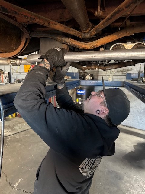

    so this morning, I'm looking at the exhaust hanging with bailing wire... and leaking.. and thought... I can't have exhaust like this on my car when I own a custom exhaust shop... and looking over in my A stock pile....there's the header I bought a while back... so I think, I should
    put on this car.... and build a split exhaust system with ho made lake pipes.... next I figure, I should just load it on the trailer and take it to the shop... both the welders I made are down there... so of I went...
    Stogy likes this.
  16. ALLDONE
    Joined: May 16, 2023
    Posts: 4,041
    ALLDONE
    75642662904__202E5C07-BC09-47B6-A729-983EC416892E[9460].jpg 75642664186__0F75B91B-6FD7-4600-8754-604B64F8D637[9461].jpg 75642665257__46451697-2A2B-493F-A3F1-6C77D8C9FD5F[9462].jpg 75642667501__24661252-A4B2-47CC-AC38-D699422B25EB[9465].jpg 75642837922__D3A81A48-C68A-448A-9F38-A9A6EF7A88E5[9451].jpg 75642839229__09295F8E-97CD-40CE-95B7-C801D228178C[9452].jpg we made a little exhaust chamber to split the exhaust into duals...21/4 in and two 2'' out, put a flex pipe, and ho made lake pipes out of 2'' aluminized tubing... i didn't want new chrome... so this was my best idea... I like it so I guess that works...

    made some slotted hangers on the plasma table.....
    and had to bend the pipe around tthe battery box... 5 hour job....
