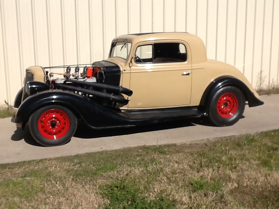

    This is my 34 buick series 40 three window coupe traditional hot rod,original 233 cu inch straight eight.I have owned her for over 20 years now and everything was custom made for the engine in my machine shop by myself.I had it out driving around yesterday and thought I should post a picture.:eek:

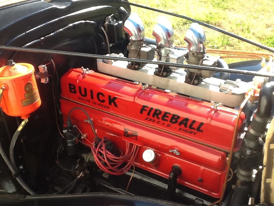

    Engine picture

    Very cool! I like to see out of the box traditional hot rods:D Jim (55willys)

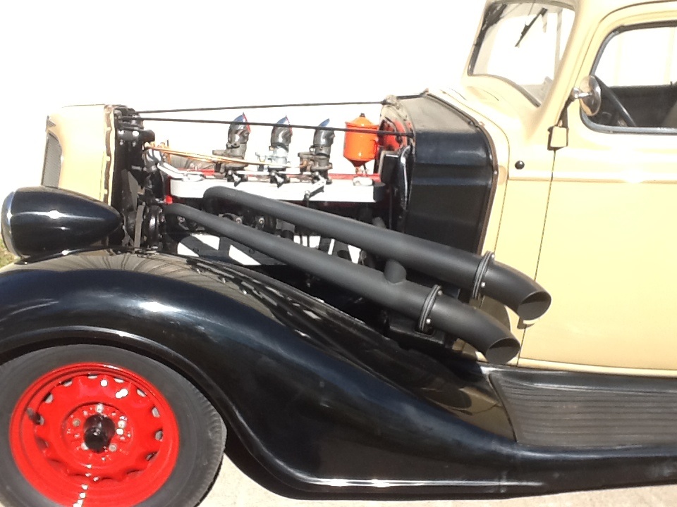

    My lakepipes!

    Don't see many GM products this close to stock. This Buick rocks! Love it!

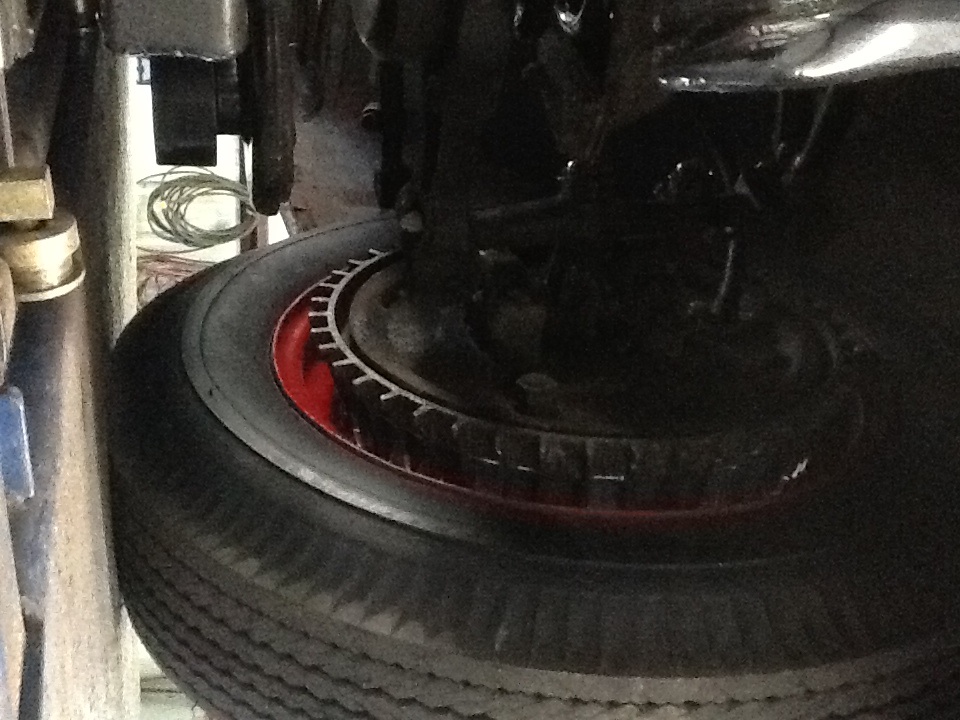

    The brakes are still oldskool cables but with 12 inch buick aluminum finned drums adapted

    That thing is killer.... I also would like to hear it. Manual brakes with finned Buick drums.... bet that's a first. :cool:

    That's really nice. Impressive that you hot rodded the original engine instead of a later 248 or 263, as almost anyone else would've.

    I am very fortunate to own a small machine shop with a boring bar,sunnen rod machine,vertical mill etc. to do all the work like cutting the Babbitt out of the rods for inserts and so on.Most people think I am nuts for keeping the little 233,thank you for your kind words.
