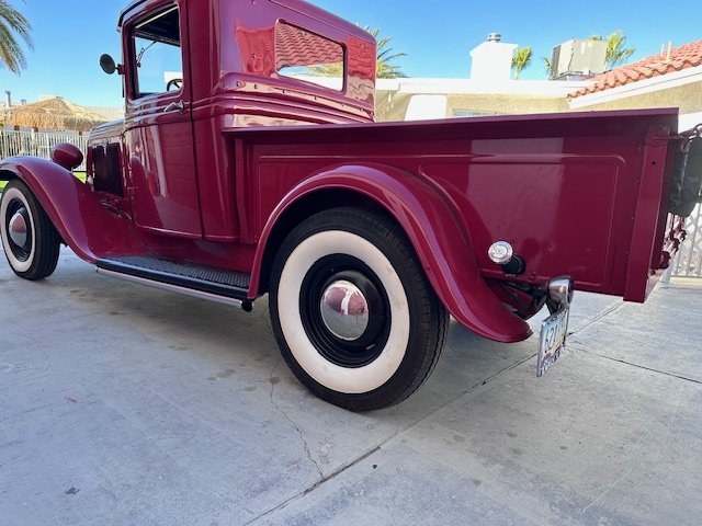

    Pretty cool little truck,.. all restored .. TRD 85 hp V8 Flathead.. juice brakes,.. syncro trans.. I put the 7.50 & 5.90 white walls...gonna get lowered a little and dual lake pipe exhaust...

    I don't know why the color looks like it does...truck is red as an apple in real life...

    Clean little 34. I love the 32-34 pickups more than coupes.
    it’s the camera, my 33 pickups color has always looked funny in photo. Camera’s always picked the color differently.

    I figured it out,... the red truck makes the reflection of the white house look pink...

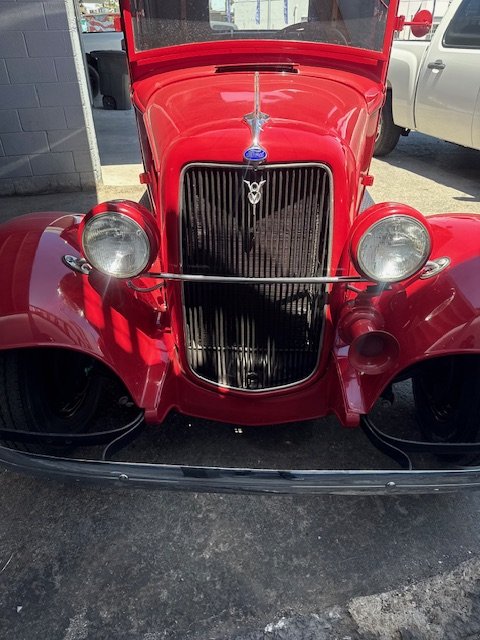

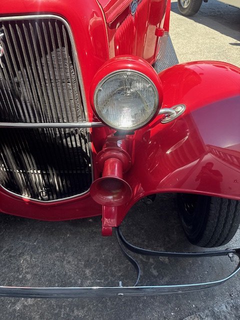

    got the lights done... whacha think???...

    I know, I know, the right way to do this is to spend 3 or 4 hrs rounding up the stuff to make a jig ...then spend another day trying to heat and bend a the drops to match..and hoping it fits...and hope that the bar doesn't collapse or that you ruin the head lite bar and have to get another one.. then spend another day buffing it ....
    so opted for the ordering one on line shipped to my door for 130 bucks..did have to cut the center and rotate it to clear the grille... then 2 little welds and done... also had to fab the horn bracket to be able to keep it on the lite bar..

    Steve, that looks MUCH better. As for making parts instead of buying, I've been making/modifying parts for my cars ( OT and Hot Rod) for as long as I can remember. Same as my Dad. Nowadays the parts you buy are most likely offshore and they just don't have the same "FEEL" as old stuff. Thats just my way of doing it, everybody's different. Anywho I think it turned out great. Mitch

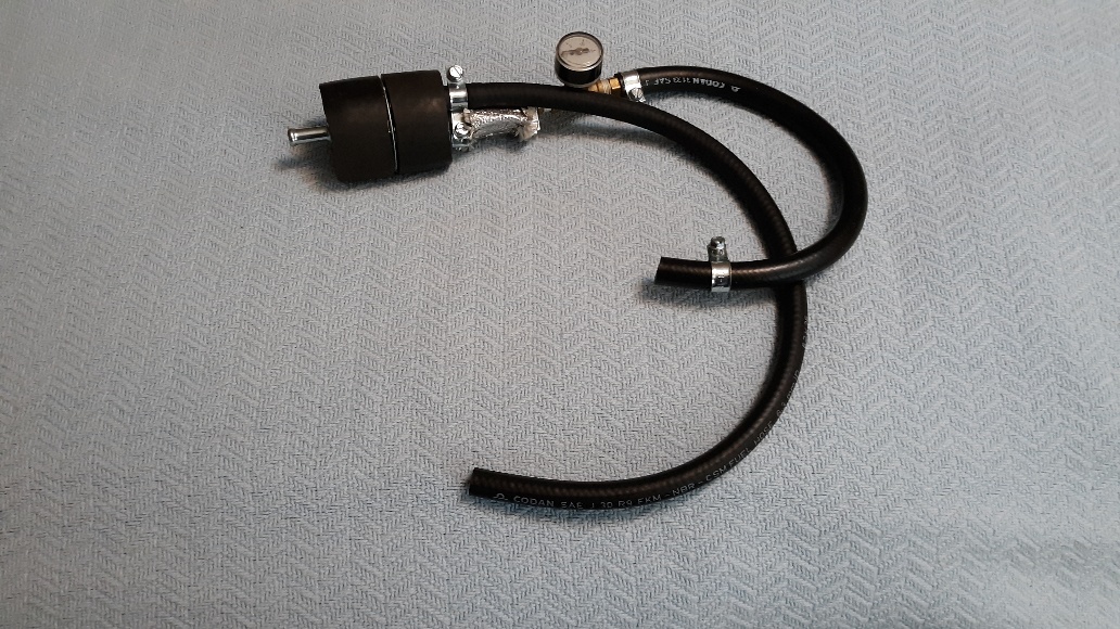

    Maybe consider using a fuel filter that has a vapor return port
    WIX-33040 - 5/16" in/out: 1/4" return
    This filter is mounted just before the carb, the filter body is insulated with radiator hose. The 0-15 PSI dial gauge is on the input side of the filter.
    EDIT: The 1/4" return port must be at the top.

    does the vapor return to the tank?

    Yes, the vapor and a small flow of gasoline return to the tank. This keeps the fuel circulating. I return it to the fuel filler tube (1962 Volvo PV544), just below where it protrudes out of the rear fender.
